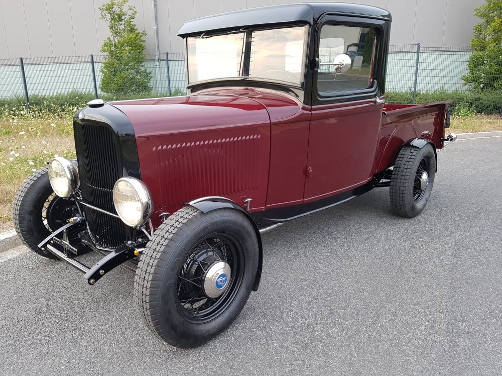

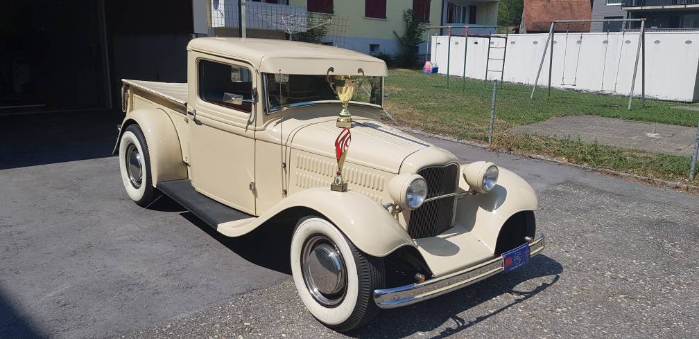

    Here's a comparison with the last 1932 Ford pickup I built.
    Two totally different styles based on the same original truck. 20180805_145919_resized.jpeg 20180807_182517.jpeg

  13. loudbang
    Posts: 40,351
    Here is a view without that reflection.

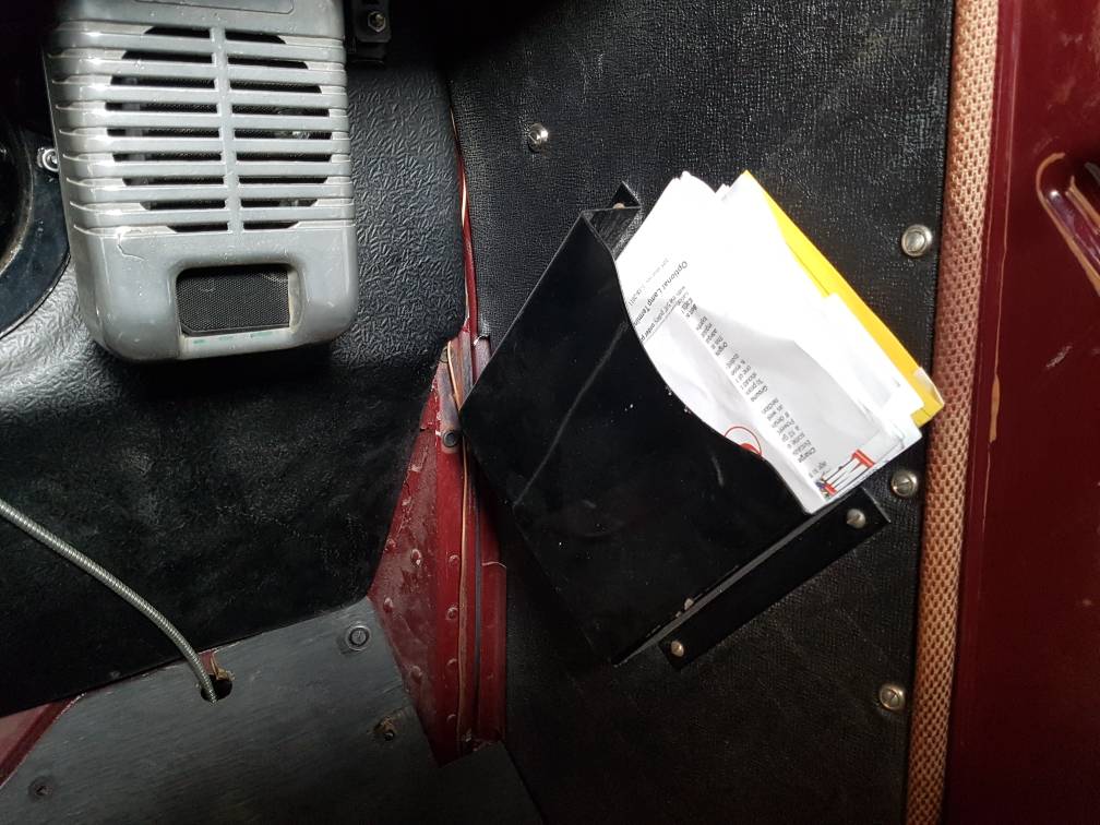

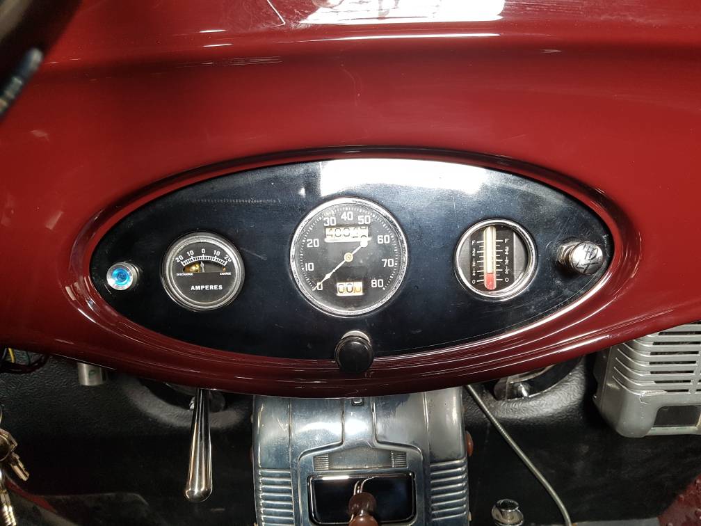

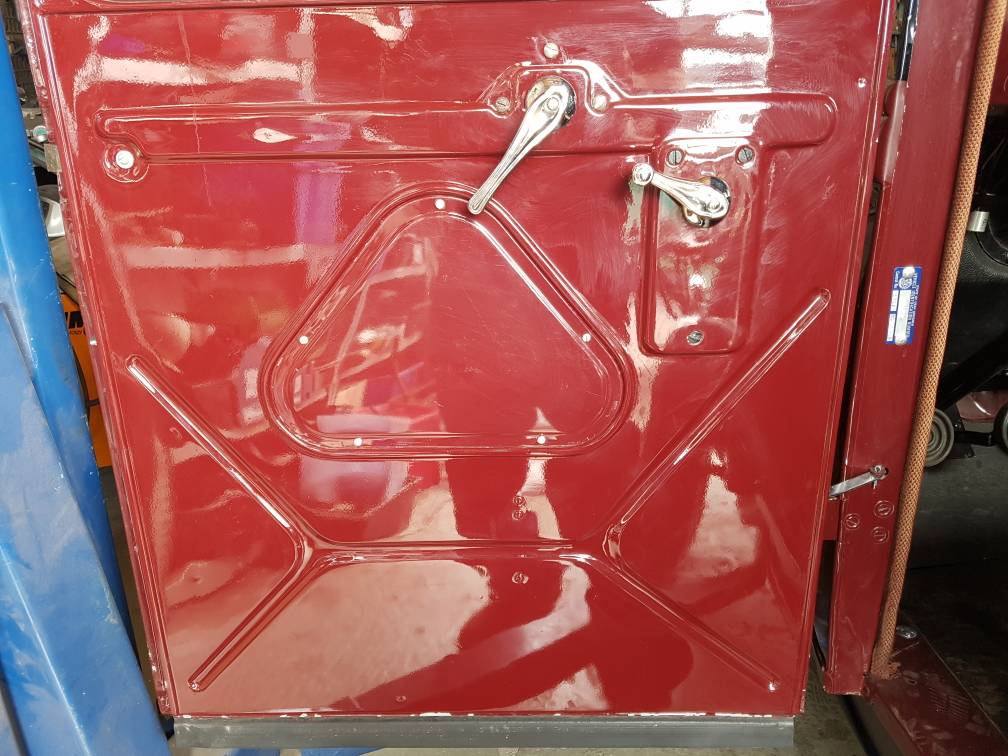

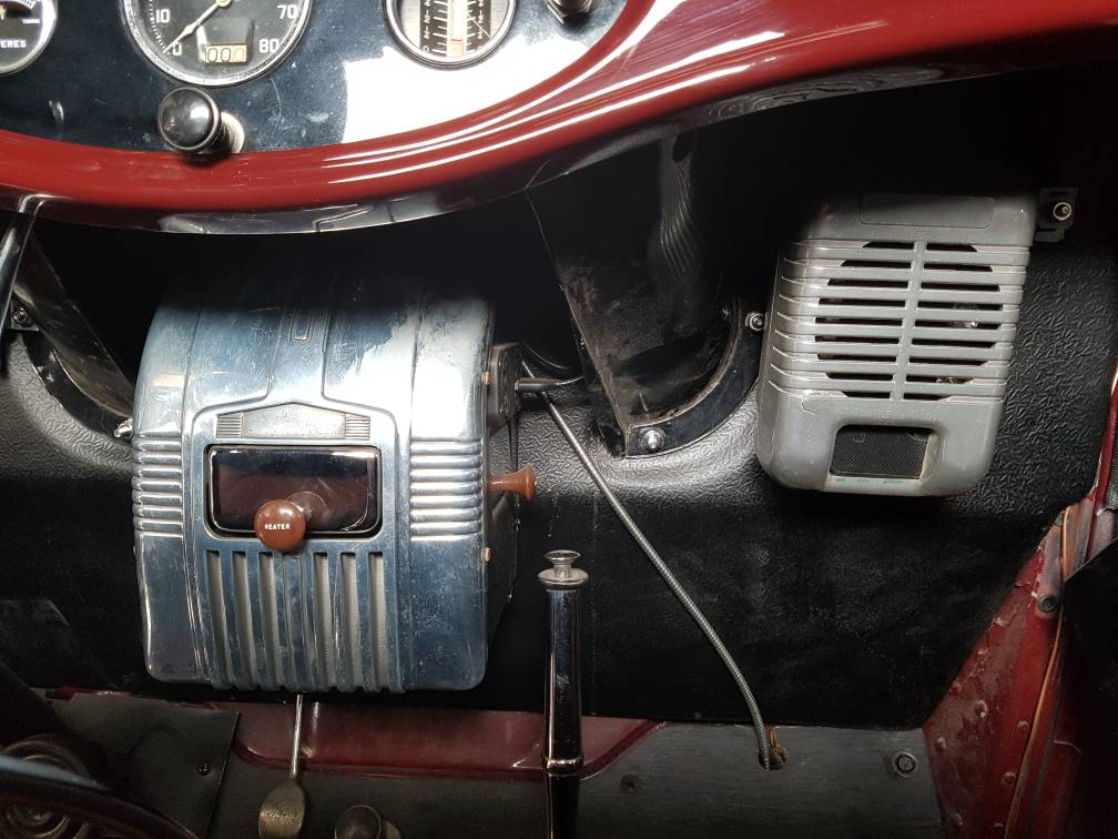

    Here are some interior pictures showing the original instruments including a working fuel gauge. (Thanks to Sheldon in France), the 1930s accessory heater and 1950s drive-in cinema loud speaker which is fitted with a Bluetooth speaker so you can play your favourite 1950s tunes.
    Also fitted is an original despatch pockets on the p***enger kick panel.
    The final picture shows the untouched, never welded 1932 doors. So beautiful I decided it'd be a sin to cover them up with interior panels. 20180808_130229.jpeg 20180808_130239.jpeg 20180808_130247.jpeg 20180808_130312.jpeg 20180808_130324.jpeg

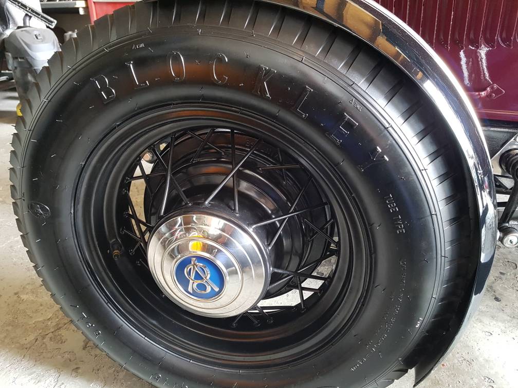

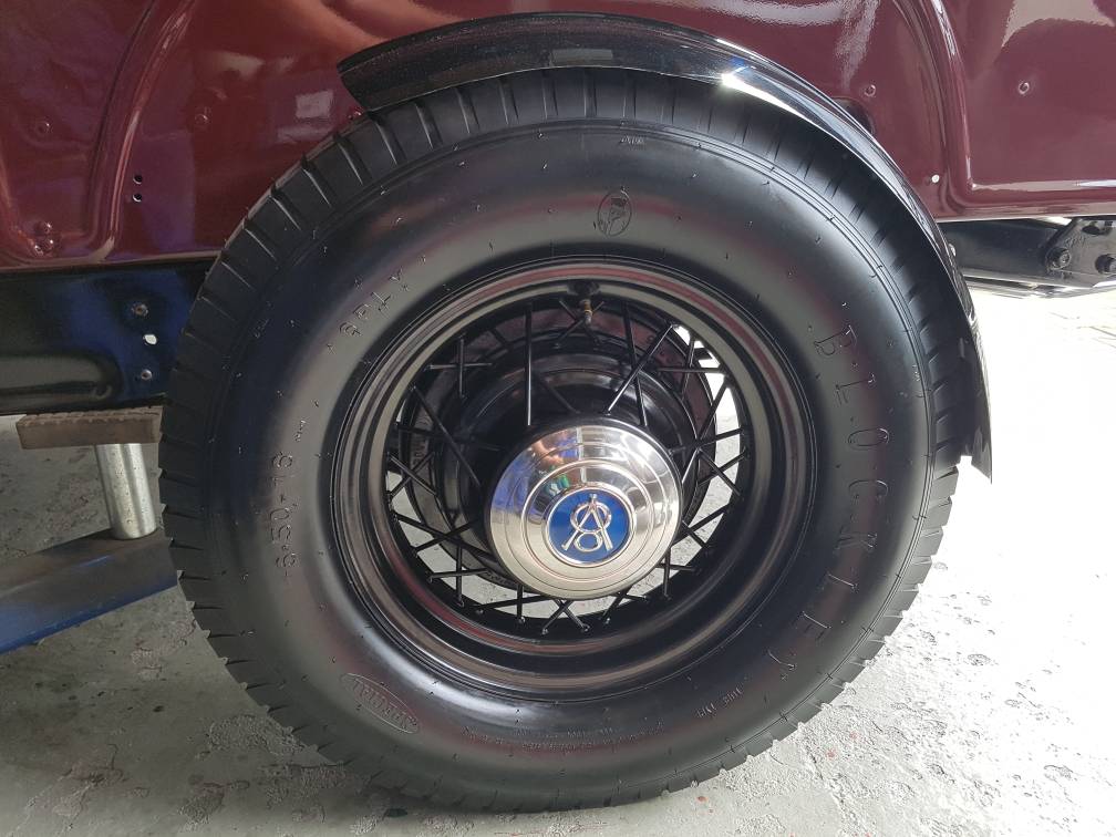

    These are the Blockley tyres from England, cleaned up with silicon. 5.50s up front and 6.50s at the rear. They're DOT rated to 130mph which should be enough;-)
    The wheels are 1935 16" Ford wheels, powder coated black and fitted with 1932 Ford V8 hubcaps.
    I fitted Dynabeads to the tubes so I don't need any ugly weights on the rims.
    The front fenders are made out of a 1930s spare tire ring. Make unknown. The rears out of new tractor fenders. All are removable and made to fit very close to the tire. 20180808_130355.jpeg 20180808_130412.jpeg

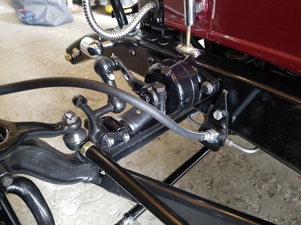

    This picture shows the Bob Drake 1932 Perches and Bill Stipes Houdaille shock absorber. Behind the shock I used Bob Drake 1946 front brake hose mounts, mounted upside down to locate the stock 1940 hoses which I sourced from C&J.
    I can recommend C&J for 1940 brake components. There quality is much better than others.
    The spring is a #1001L from Super Slide. Brings you really low on a stock 1932 front crossmember.
    The sling shot steering arm is from Superbell, reprofiled to follow the curve of the axle. Front axle is a dropped 1932 original I-beam located with unsplit bones.
    I wrapped the springs with accessory Model-A spring protectors.
    The shackles are reproduction 1932. You need two pairs per side because the reproduction spring eyes have the same diameter as the perches. The shackle bars are powder coated and the nyloc nuts replaced with castle nuts and cotter pins.

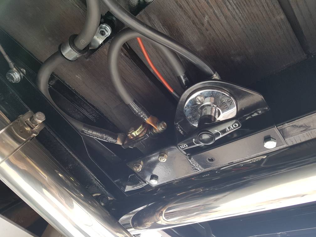

    Here are some pictures of the rear end. Legal ******* photos.
    The rear axle is a late 1932-34 located on a flattened 1932 rear spring, again covered with accessory Model-A spring covers. The shocks are Bill Stipes Houdaille.
    The battery sits in a tray which hangs off the rear crossmember and bed. The starter relay is rear mounted so that the long cable to the front is only live when starting. I also fitted a battery cut off switch which is good insurance against fire.
    The stainless steel exhaust is hard mounted and goes through the holes in the rear crossmember as original. 20180808_130536.jpeg 20180808_130546.jpeg 20180808_130600.jpeg

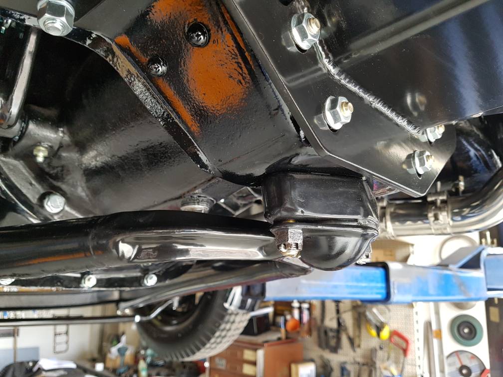

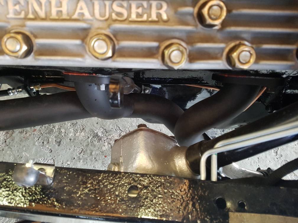

    Underneath the truck are the ch***is strengthening legs from Industrial Ch***is Inc. I always fit these to stock '32 ch***is. They also offer an opportunity to mount the mufflers, which are Smithys.
    I had to drop the rear of the wishbone 1" to get clearance to the 59A-B oil pan so I made up that extra mount of of s**** steel and an extra wishbone cup.
    The exhaust was welded together out of pre-bent sections, the welds ground flush and then polished.
    The 1940 Ford master cylinder is from Wagner. The torque tube is a shortened 1933-34 as I couldn't find a stock late 1932 torque tube.

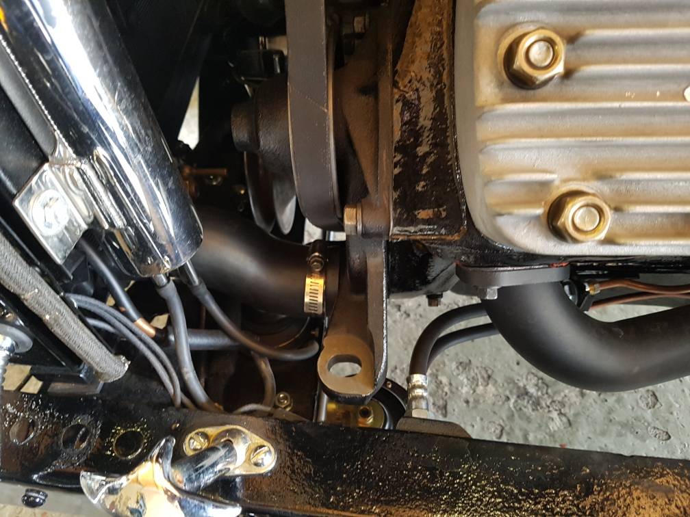

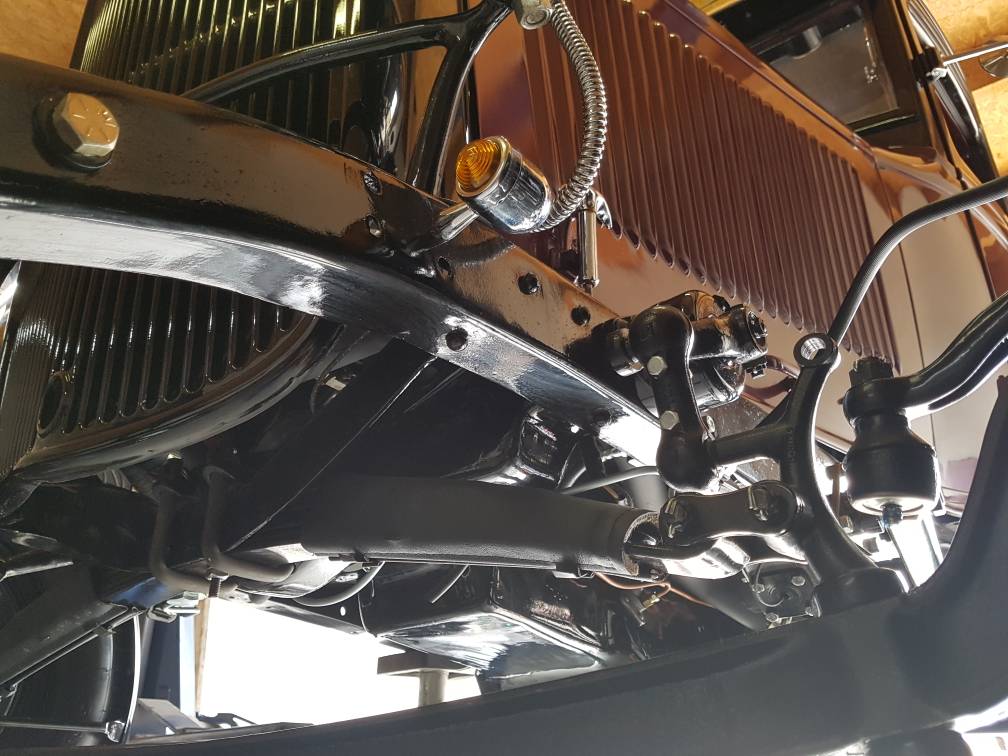

    Moving on to the front. I retained a stock 1932 front crossmember which gives you motor mounts.
    The Super Slide #1001L spring gets you as low as you can go. So low, I had to reverse the front U-bolts.
    The radiator is from Br***works. Expensive but the best. I used a Spal electric fan to keep the truck cool climbing the Swiss Alps, which this truck will soon call home.
    The horn and front directionals are both 12V motorcycle items. 20180808_130654.jpeg 20180808_130709.jpeg 20180808_130753.jpeg

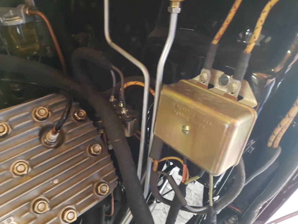

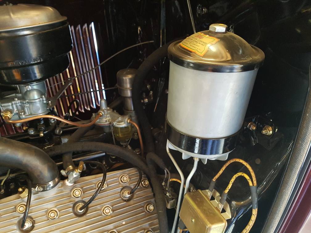

    Here's a little peek under the hood. It's a 59A-B V8 fitted to a 1939 transmission. I fitted Offenhauser heads and a new Stromberg 97 from England. The air filter is an original 1946 oil bath filter.
    The coil is from Bosch. The generator is a new alternator disguised as a generator.
    I fitted a remote oil filter on the firewall and a NOS 1950s headlight relay below it.
    The water pump engine mounts just hang in the air. The engine sits on stock 1932 front mounts.
    I painted the F1 steering box silver to try and reflect the heat from the header. Headers are Speedway economy.
    The fan is a large Spal which I imported from the US only to find it's actually made in Italy. 20180808_141544.jpeg 20180808_141621.jpeg 20180808_141637.jpeg 20180808_141643.jpeg 20180808_141707.jpeg 20180808_141713.jpeg

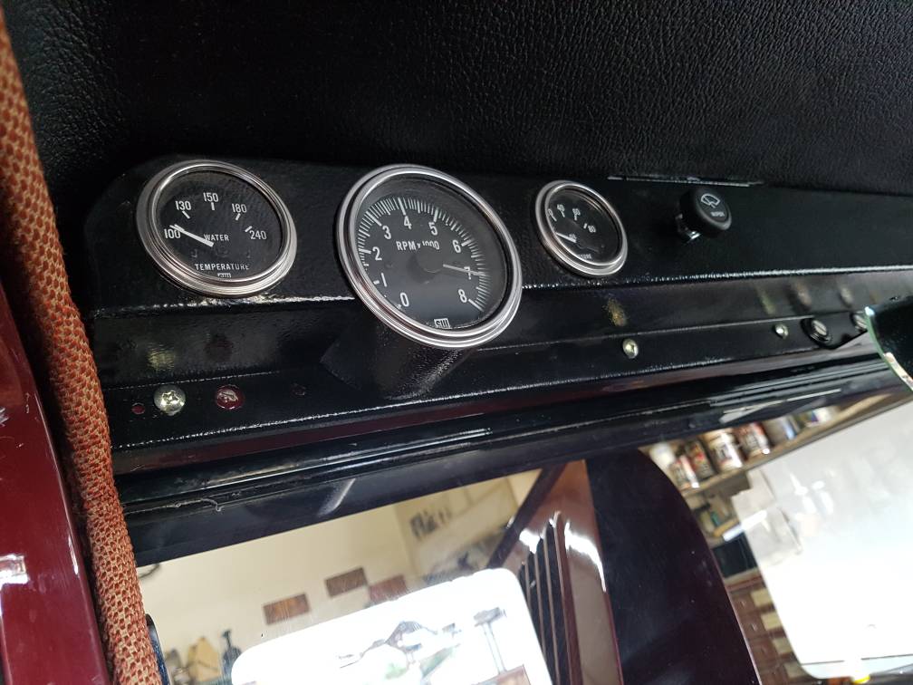

    We wanted to fit a few extra instruments but I couldn't bring myself to cut holes in the stock 1932 Ford dash panel. I mean it's survived 85 years. Who am I to go messing it up.
    So I built this header panel out of a piece of metal shelving for the extra SW instruments.
    Stewart Warner have the best know name in instruments. Really famous especially amoung hot rodders. For that reason I find it a shame that their quality is so poor. Made in Mexico without any good engineering. I fitted the tach and wired it up as instructed but the tach needle bounces all over the place. Even when it momentarily stops bouncing all over the place it's still reading approximately double. SW really should build in the necessary circuitry to deal with all eventualities. I'm running a stock 1946 distributor with points and a blue 12V Bosch coil.
    Added to that, neither the oil pressure gauge or the water temperature gauge run correctly from stock Flathead senders. You have to buy the SW senders too.
