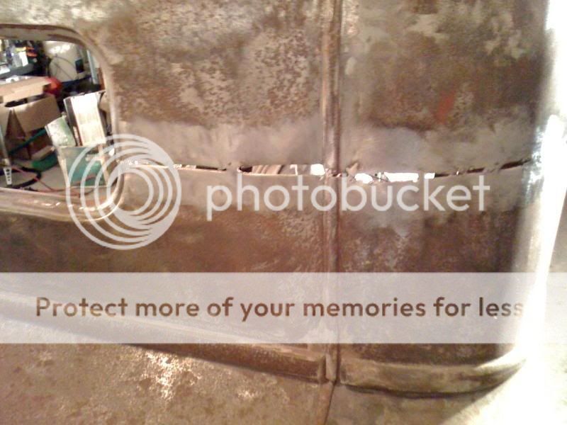

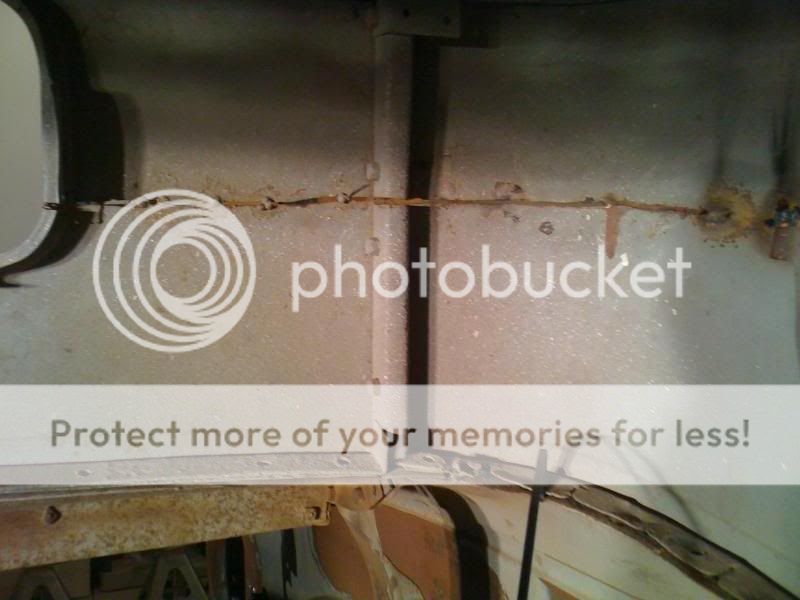

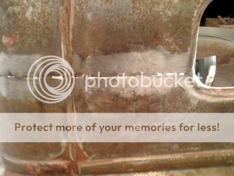

    I decided to clean the surface rust/bondo, etc away from the chop area. I already knew the chop wasn't done very well, but boy I didn't realize it was this bad. I think whoever chopped this thing used a dull hacksaw or something. For your viewing pleasure below:

    Any ideas on the best way to "fix" that horrible chop job?

    BONDO!!!(just kidding)
    The way I'd deal with it is to brace as neccessary and remove a 1 or 2 inch strip around the top to get rid of the ****,then replace with a strip of fresh steel.Kind of re-choping it without losing height.

    Thats sure what it was full of. Looks like they just tacked to top down where it would touch and slapped it full. At least its pretty straight.

    I still have the sections from the doors and quarter windows and rear window that I cut out of mine. If you want them they're yours. You could just cut the bad **** out and patch in what I have..

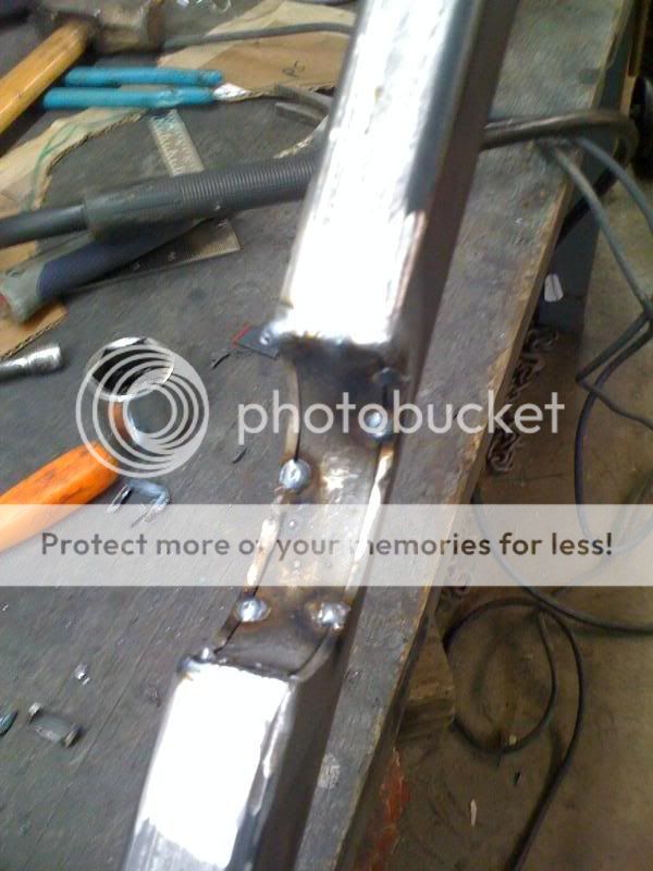

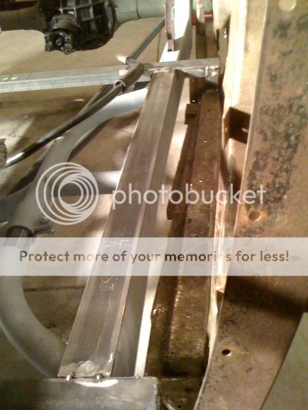

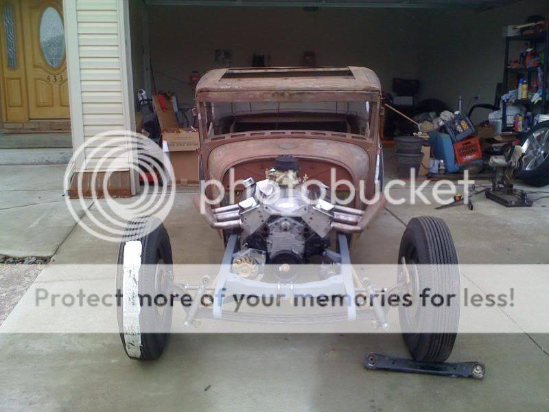

    Been a decent week to work in the garage. I got a bunch of work done last night and today, pics below:
    More work on the subfloor:
    I modified this piece to give me ladder bar clearance at the "Z":
    Test Fitting the Seat:
    More floor:

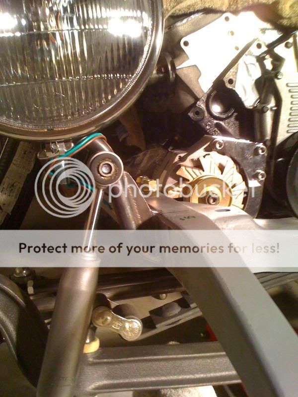

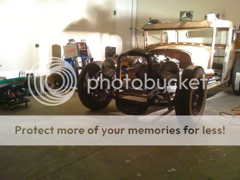

    Headlights finally arrived, I spent about 6 hrs trying to get these on right. I used the P&J's combo mount, '34 commercial lights: The headlight stands were a PITA to install,
    Tire rubs:
    After cutting them down some/grind/tack,measure,tack,cuss.......I finally got them close, the "socket" the "ball" of the headlight sits in will require some heating/bending to get the headlights down a bit, they are to high:

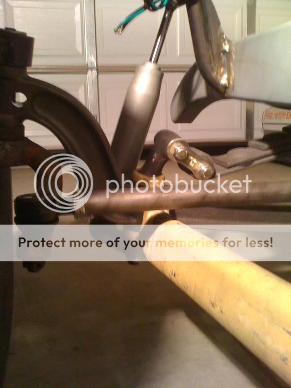

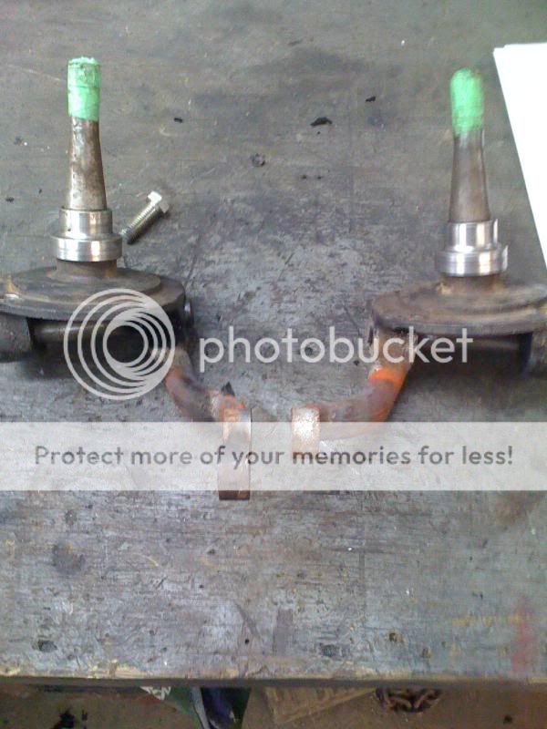

    Heated/Bent the spindles, tierod is on top of the bone, I needed a little more clearance for the engine/frame:

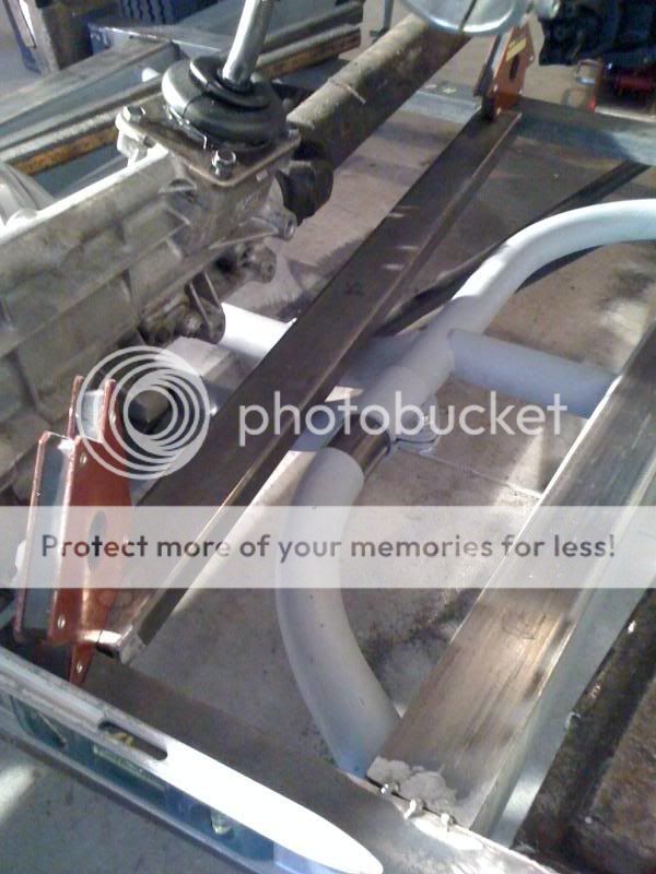

    Finally got the driveshaft cutdown/installed:
    Grill insert should be here tomorrow, radiator and gas tank are on the way. Gonna try to finish up my steering, build the driveshaft loops, and rest of the floor this weekend.

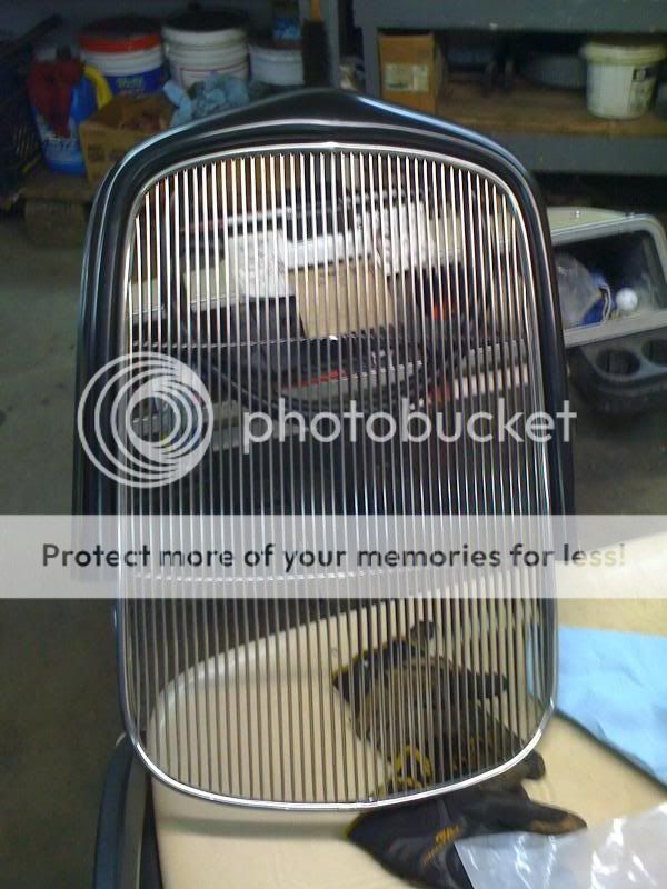

    Got my Dale's Insert in, chopped the grille shell:
    Grille Shell/Headlight mock up:

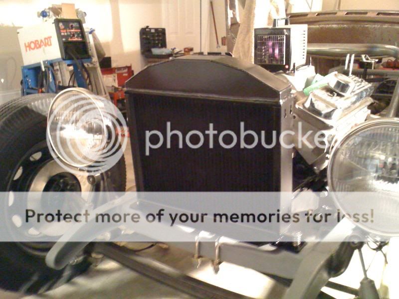

    Radiator finally came in, custom aluminum by Geary Portell in MO:
