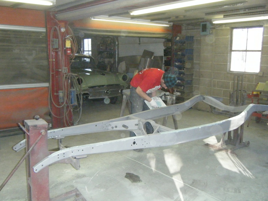

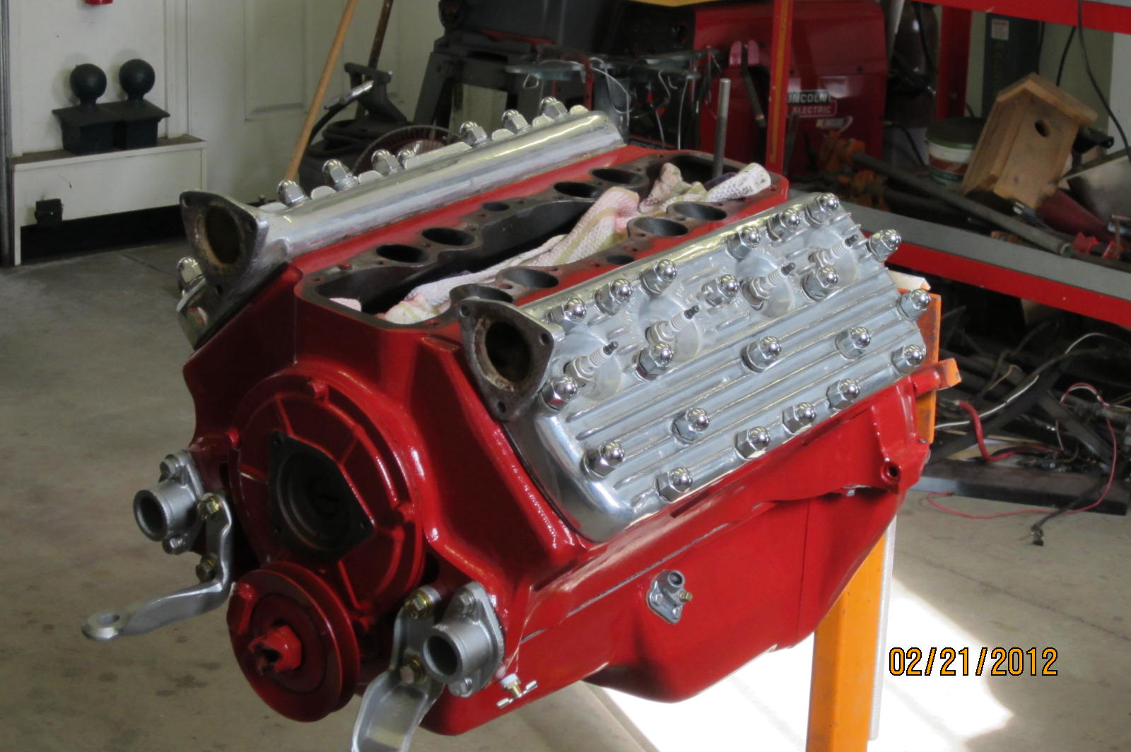

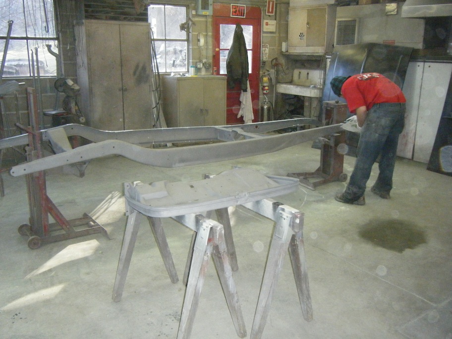

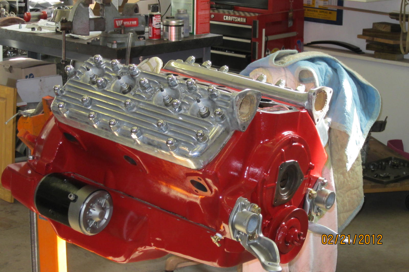

    Got the motor near ready for paint today! Parts everywhere:D Frame is getting there at Ted's shop.:cool:

    That's looking good, what are you using for primers & paint?

    2 coats transtar epoxy primer/sealer, three coats urethane filler primer, blocked, then two more coats of filler primer. will finish with PPG dcc urethane black.

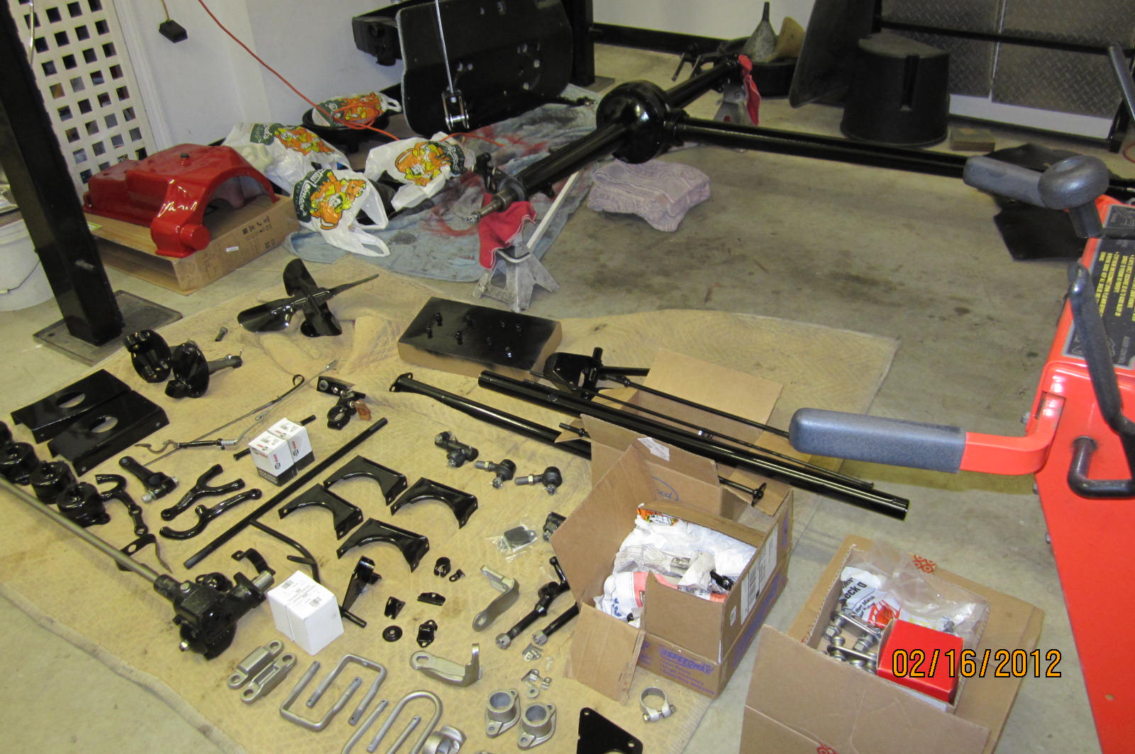

    Frame and motor painted and just about everything else! Now if we can keep the F%#&'n Cat off the frame it will be good!:cool: Ted did a good job on the frame for a relative:eek:

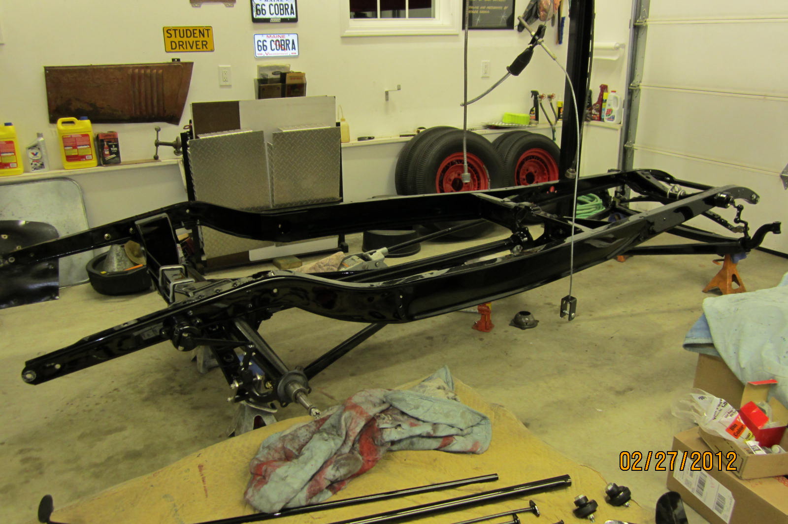

    Well we woke up to 4" of snow today! :mad: But Tater,Don and I got the frame home anyway (oh Ted drove the truck:rolleyes:) Just kidding! Thanks Guys:cool:MB

    Just wondering about the front crossmember, looks like a bolt in, why not rivet it in before the paint went on?

    It is bolted in with rivet like bolts. That is how it was and allowed for painting between frame and cross member. picky picky:rolleyes:

    Went to help carry a roadster body into Ted's shop this morning. (not mine) He is doing a patina paint job on a 32 Brookville body. Forgot camera.:( Came back got the front end in today! Also did some fab for a spring spacer. Got all the shocks on.:cool:

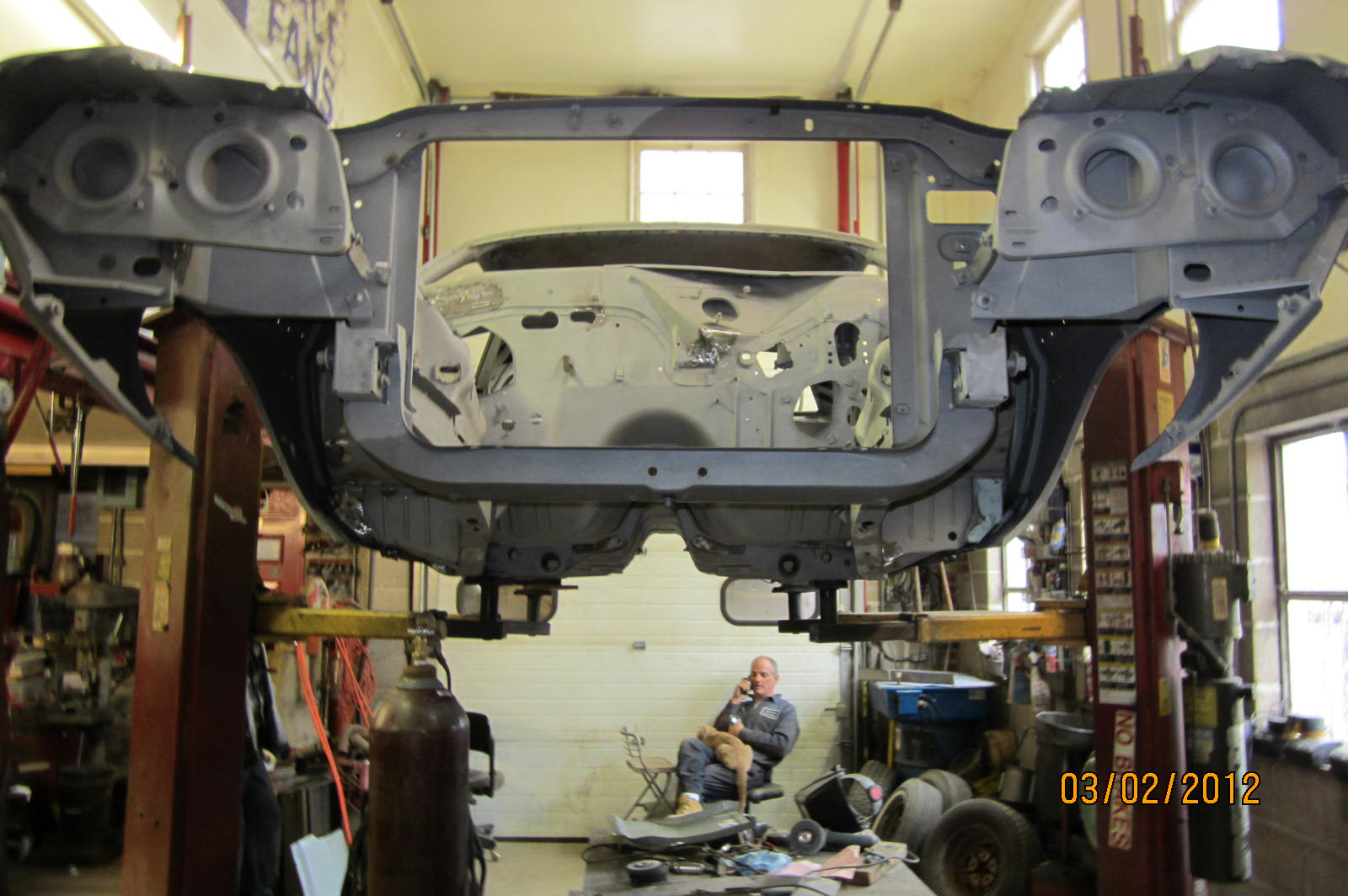

    Took a break today from running brake lines and went over to Ted's to see what he was up to. Roadster body belongs to fellow HAMBer and is undergoing a patina paint job.:cool: Major Mopar project on lift! I think Ted is spending too much time with the Cat.:eek: Anyway we discussed what we were having for dinner and I went home to my project:rolleyes: All in all a good day!
