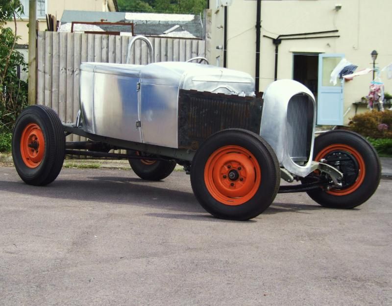

    Still been working away on the race car in between the other stuff.
    The other week when the sun did shine for an afternoon I wheeled it outside the gate onto the road to take a look at it from all angles and from further away than I can see in the confines of the garage.
    The rear end does look a bit odd without the fuel tank and with it being so high due to the chassis not being stepped, but, you know, I quite like it, gives it that early dirt track car look.
    A quick mock up with the hood top from the roadster again, a proper one will be made later, and time to take it down for final welding and painting.

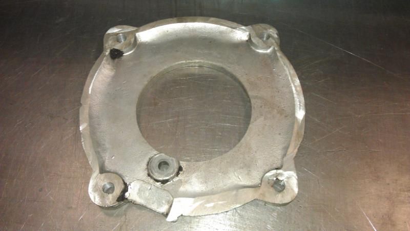

    First bit was to get the cast truck type adapter, not sure exactly what years or model, I'm sure someone will know.
    You need to make a center locator as the snout on the gearbox is much smaller than the hole on the adapter. For this I took the original Volvo bell housing and cut the mounting flange off.
    It was then turned in the lathe so that it was about 3mm thick apart from the center bit that would locate in the center of the truck adapter.
    Lay it on the adapter and drill and tap the four mounting holes for the gearbox.
    and on the inside you can see how it all locates.
    Just need to bolt the box onto the adapter and that bits done.

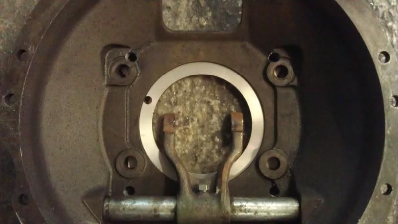

    So, gearbox and clutch mounted just the throw out bearing left to sort.

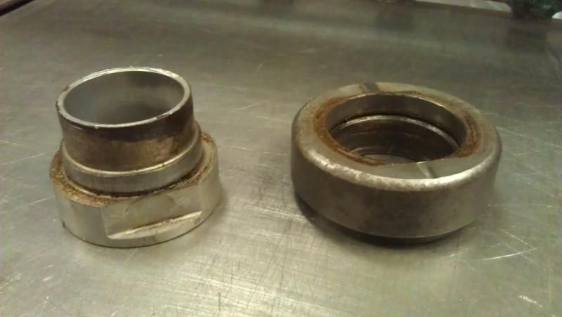

    This was done by taking the Volvo bearing and housing and mating it to the Ford fork and bearing housing.
    This is the Volvo bits as a whole and with the housing pressed out.
    And with the bit I want to fit it to.

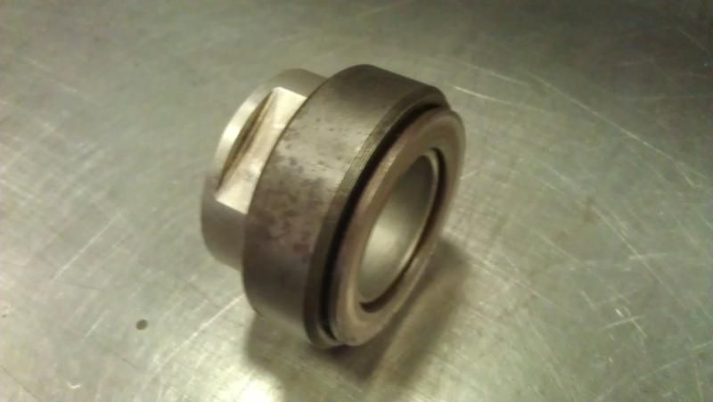

    The first thing to do was turn the Ford part down in the lathe to make it shorter and also to open out the inside to take the ally part from the Volvo.
    Only a small amount was taken out and hopefully not too much as to make it weak.
    Then the ally Volvo part was pressed in.
    That was it, really simple, took a bit of time working out the measurements but a simple way of doing it.
    These following pics are not great due to operating the clutch arm with an adjustable spanner with one hand and trying to take pics with the other while trying not to pop a bollock.
    With the bearing****embly right back
    With the bearing taking up the end float. There is about 1/8" free play. You can see the gap between the fork and housing.
    And finally with the clutch fully disengaged
    Going to put a spring on the housing just like on a Ford box to keep the fork in contact with the housing.
    I have tried the clutch with a spanner and it seems to work well, can't turn the gearbox, press the clutch in and I can turn it. Won't know completely until I get to drive it but confident it'll be fine.
