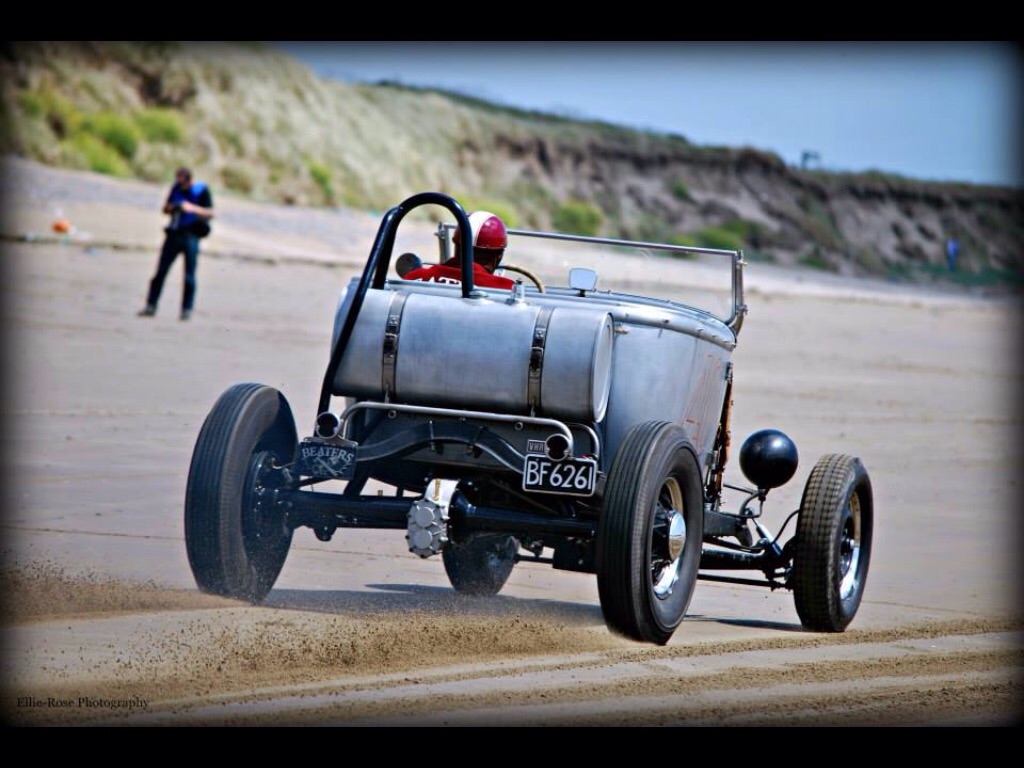

    So with the car all up and running it was time to make the run to Pendine. It ran great! 3.20:1 gears in the back made 70mph really easy and the motor never missed a beat.
    On the sand I didn't do as well as I'd hoped but given the troubles I'd had only a few days earlier I was happy with the 97 mph I ran.
    Picture by Subsculptures
    Pictures by unknown, but thanks whoever you are.
    Again on the way home, in the ******* rain, it ran great, with the only problem being a water pump sprang a leak just as I got home, which although a bit of a ****, it couldn't have happened in a better place.
    Water pumps are an easy fix, just more money.

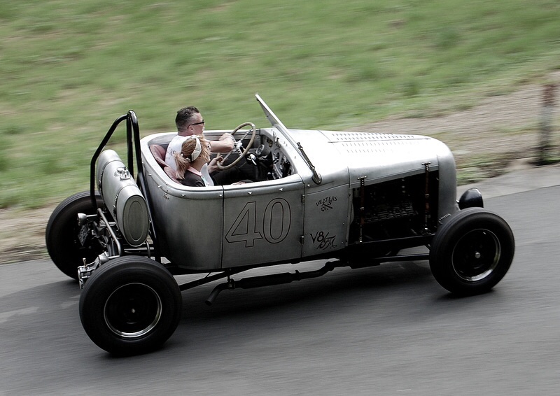

    Next up was Gow. Hosted by the VHRA at Prescott. This is an amazing event. We get to play on the hill all day, as many runs as you want. No helmets or race gear, can take p***engers too. I'd been up the hill many times so knew it reasonably well. I fitted 4.11:1 gears in the back and went for it. ****** hell the car was fast up the twisty track. I recorded a unofficial time of 54 seconds with the stopwatch on my cell phone, some 3 seconds faster than my previous best. I was really happy with that. So on the second run I took my daughter for a ride, but had trouble finding second gear on the steep tight left hander which kind of spoilt the run. Then, on the third run its ******, ******, ****** again. More problems with third to second gear saw me stopped on the track not able to find any gear. I rolled the car off into and Marshall area so as not to stop others using the track, and with the engine off I found second gear, and trundled back to the pits.
    Picture by unknown, but thanks whoever you are.
    With the top off the gearbox it appears my heavy handed fast changes had broken the selector plate. Good news was I had a spare, until I broke that too! So that was that for the day so retired to the bar to watch the others having fun.
    Towed the car home and made a stronger selector plate, which so far has been fine.
