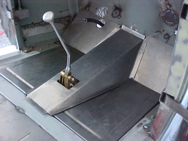

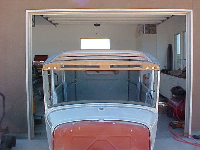

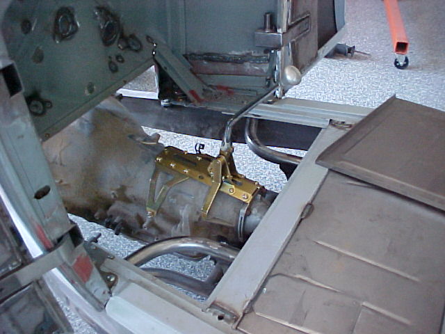

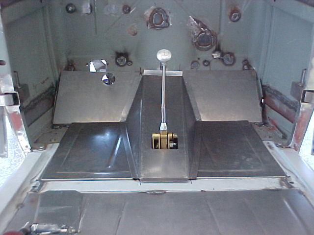

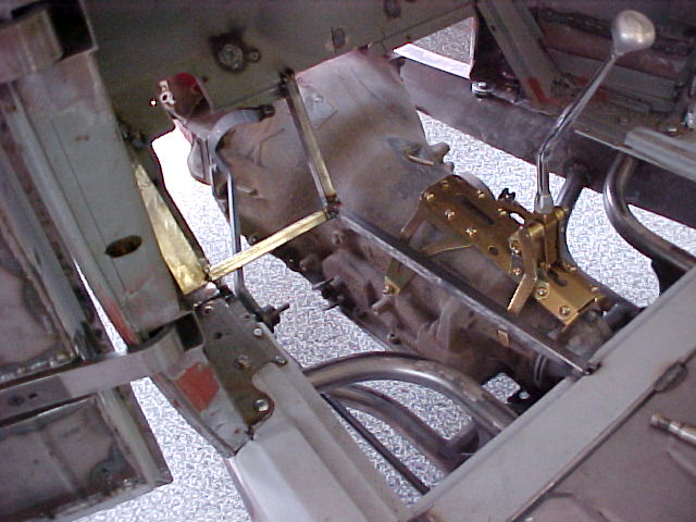

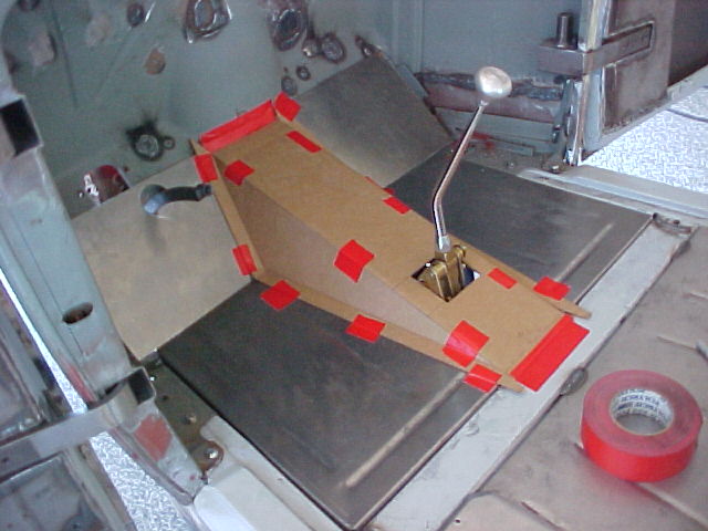

  19. Dave L
    Joined: May 27, 2007
    Posts: 232
    Dave L
    from Idaho

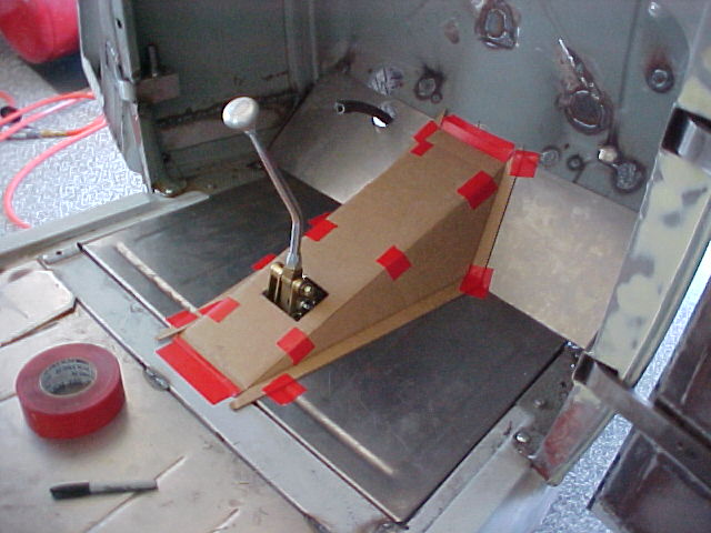

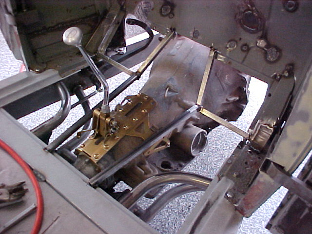

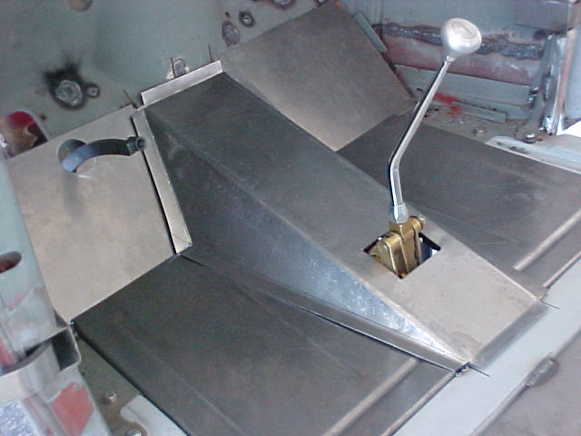

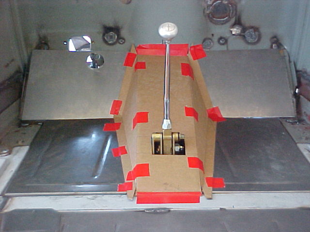

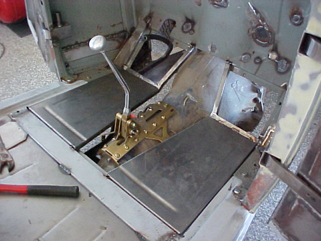

    got a little more done on the sedan:
    top wood kit installed and rolled it outside to clean garage.
    and got the front floor started:
    did mock up for Trans Hump:
    and trans unit made, just need to weld in
    gaining on it...
    thanks for looking,
    Dave L.
  20. why weld the tunnel in
    it could be difficult to get the shifter out if you do that
    just seam seal it and a few screws
    tk

  22. Dave L
    Posts: 232
    Dave L
    from Idaho
    Your right Tub, got to thinking about it and decided to screw it...

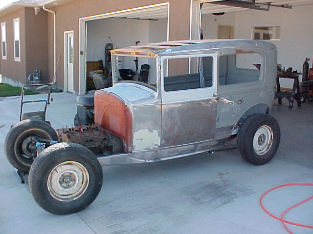

    Well Its been a bit, so thought I would give and update on the Sedan:
    Got the Top Lowered:
    Finished product:
    I would have rolled it outside for pics, but its raining....
    Thanks for looking,
    Dave L.
