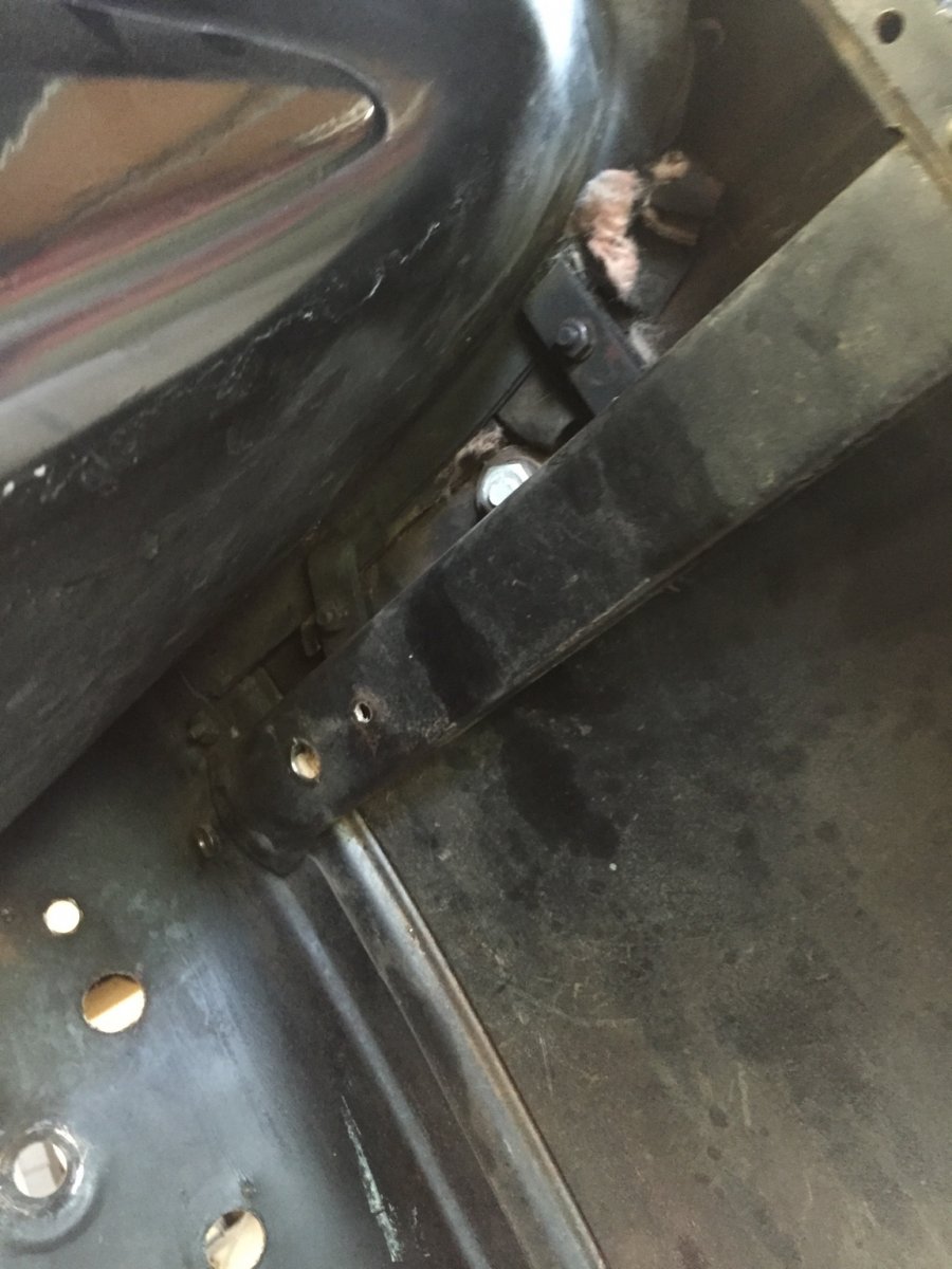

    Just removed mine last weekend. I have a 31 coupe so I don't how different it is but here are some pics
    Remove the screws on the top of the firewall. There are clamps up under the cowl that hold the tank in place too. Then there's a small molding in front of the windshield which has to come out. Then the whole cowl lifts out. The clamps ImageUploadedByH.A.M.B.1466293732.599280.jpg

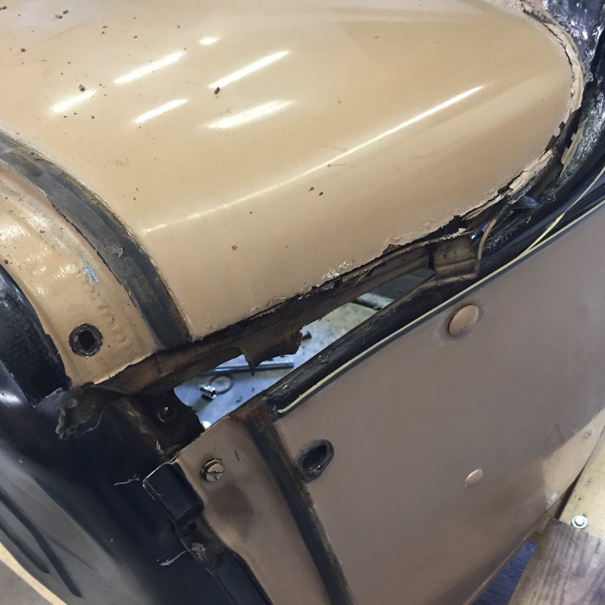

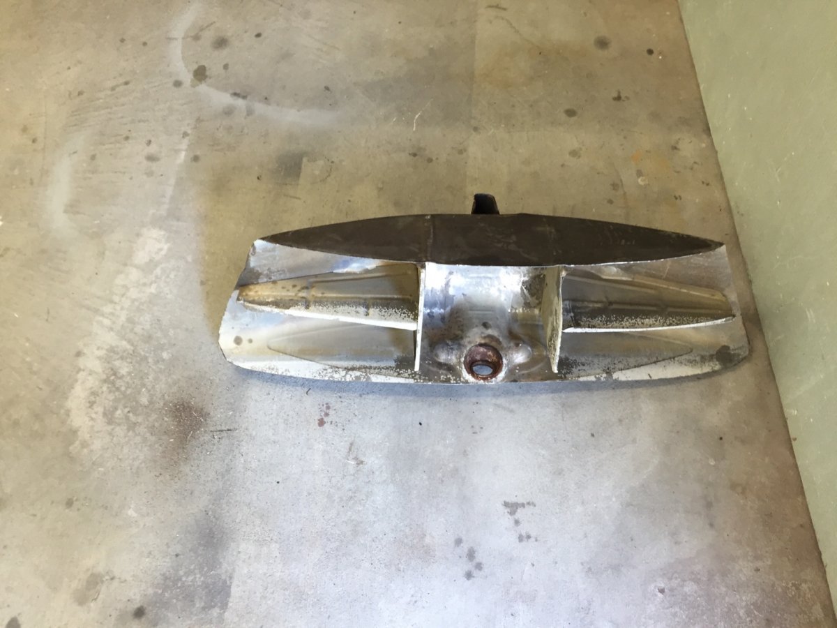

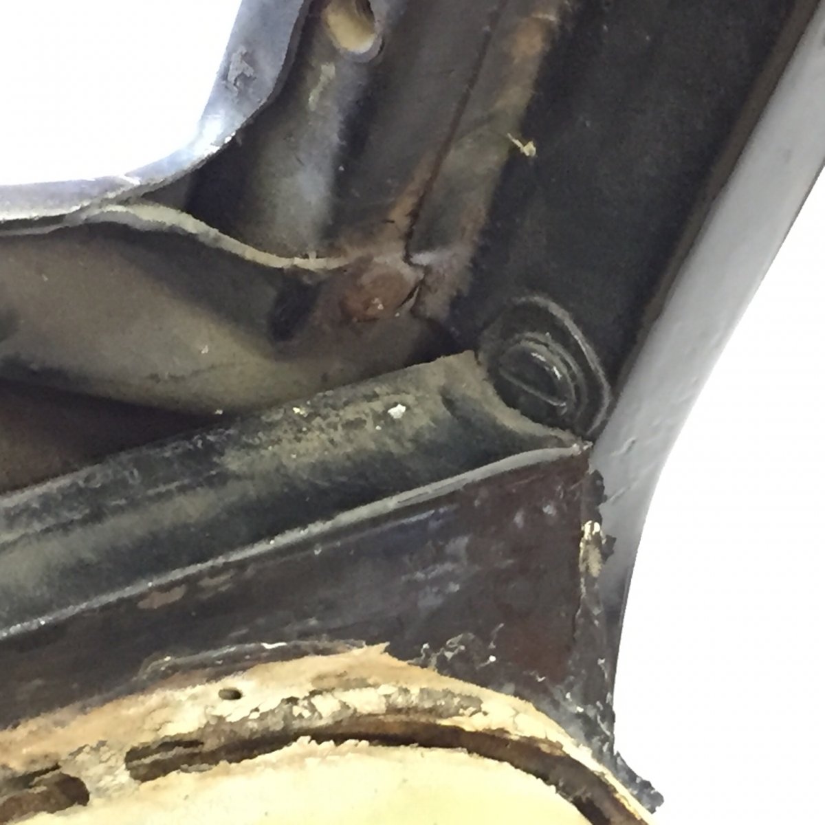

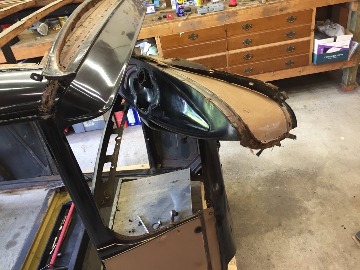

    Lifts out ImageUploadedByH.A.M.B.1466293920.058108.jpg ImageUploadedByH.A.M.B.1466293952.573980.jpg
    Again this is a 31 coupe so I don't know how different yours is. Just to give you an idea of what the inside looks like: ImageUploadedByH.A.M.B.1466294067.114759.jpg
