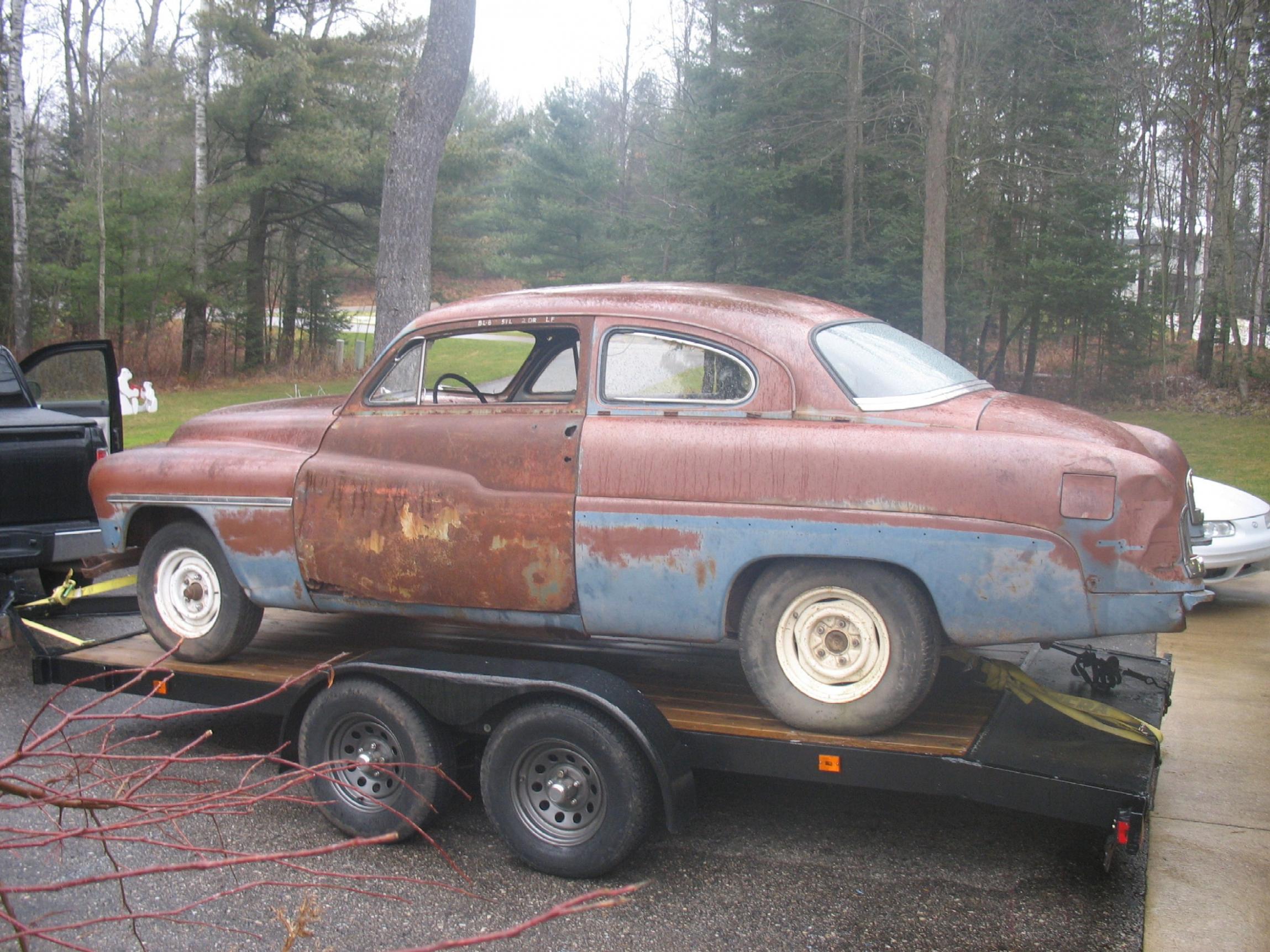

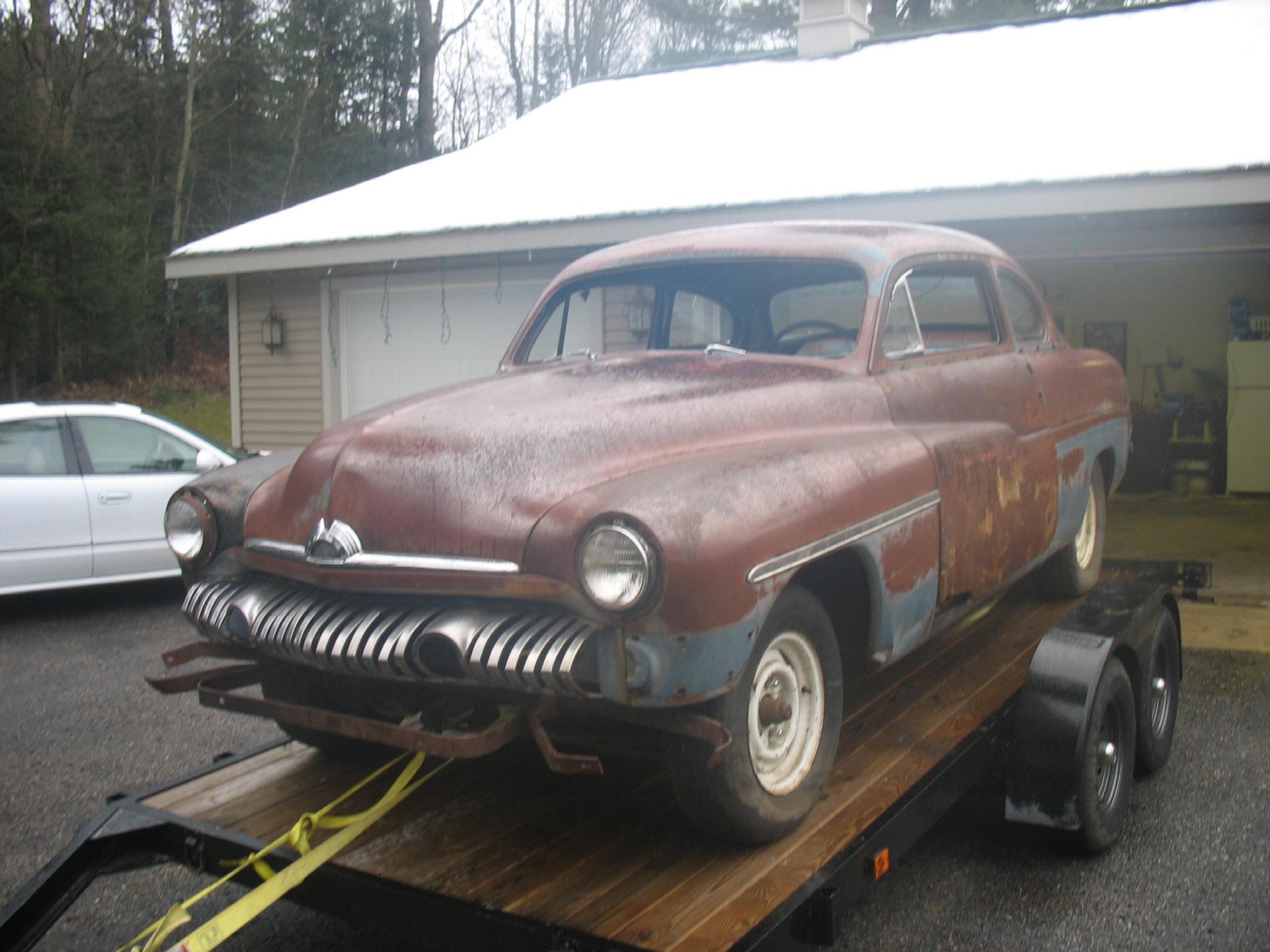

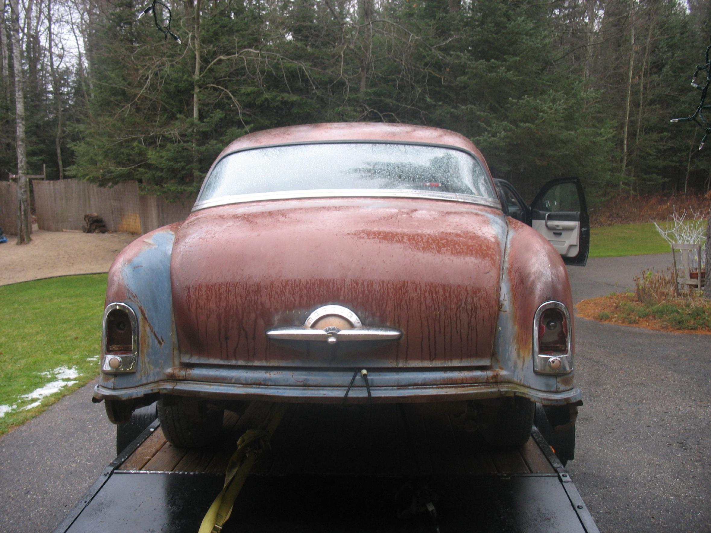

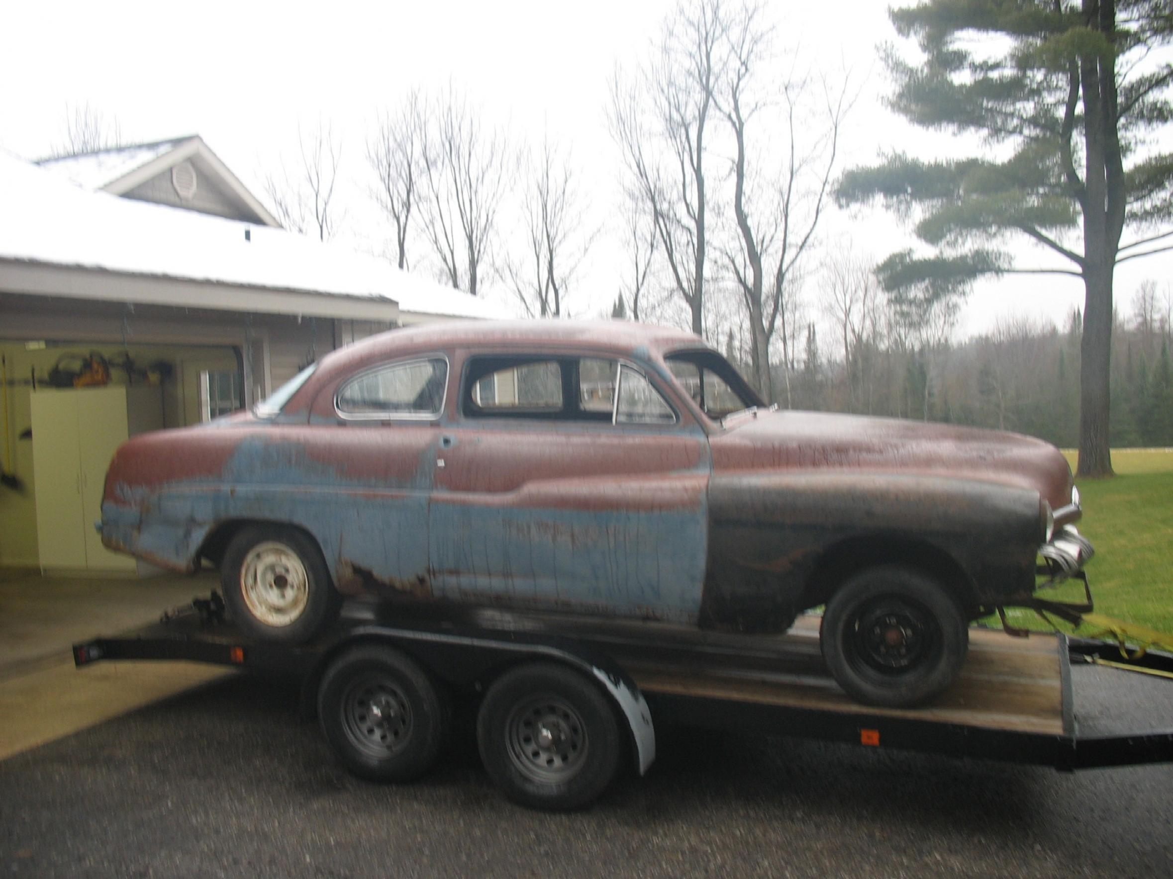

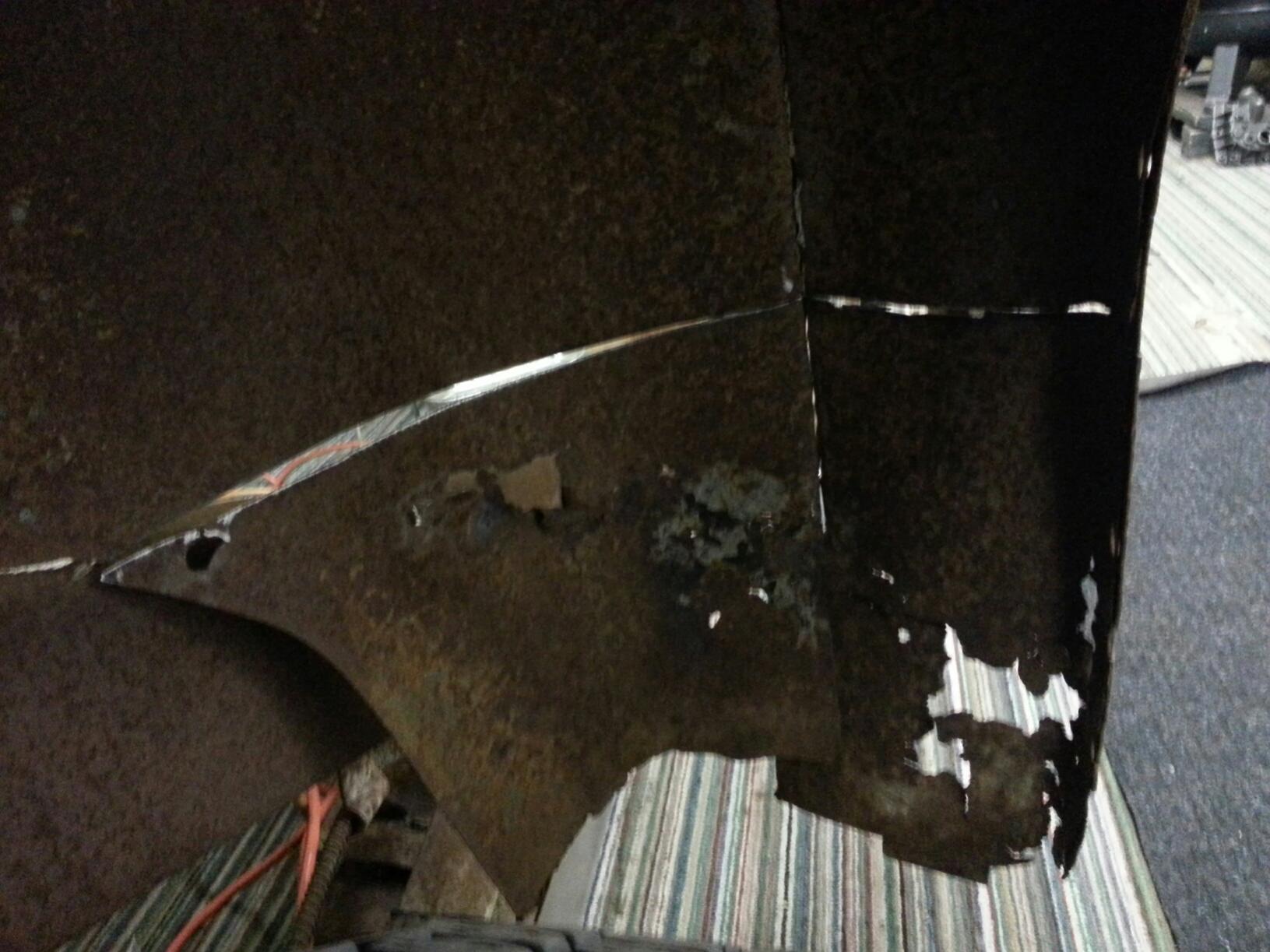

    I have owned this car since 1994 when I bought it in Rapid City S.D. we have hauled it to Kansas City, Northern Michigan and many other cities over the years. We now live in Wyoming and with my watching and reading the H.A.M.B. for a while now and a neighbor who has volunteered his help it is time. The body is fairly solid except the rockers, trunk pan and floors. I have cut out the passenger side rockers along with some of the rusted areas and am in the process of making some repair pcs. now. I will post some more pics when a little more progress is made my plan is to have the floors and rockers replaced by the end of this year. I will be using the original frame and finding a flathead, lowering it down and keeping it unchopped. I want to thank everyone on the H.A.M.B. for the inspiration to get me started.

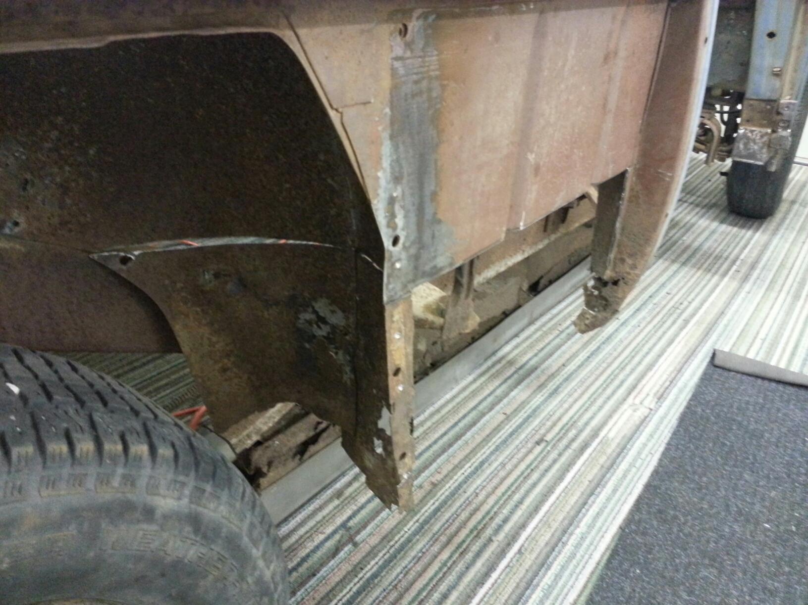

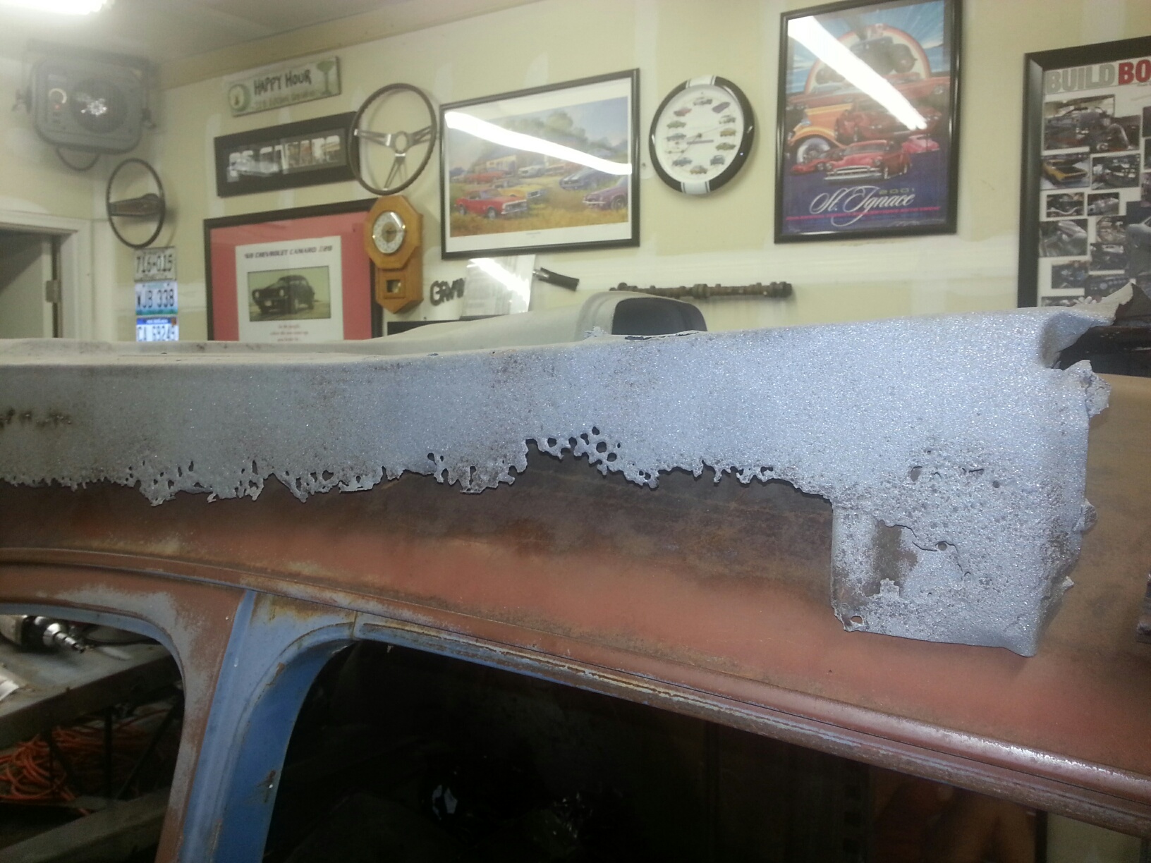

    thanks everyone for the comments as I said earlier I have started to cut on the passenger side a bit. I have taken off the outer rocker and cut out the inner. If you follow the A pillar down to where it connects to the inner rocker I am having to cut that up a bit and replace the bottom 4 inches. The bottom of the B pillar that is underneath the outer rock is pretty much gone also. I have been talking to Matt Townsend on this part and I think he can fab that part for me. I have a little rust to cut out in the rear wheel well also where it connected to the floor and seat pan.
    I am hoping to have some of this cut and fabricated this weekend and will post some progress pics.

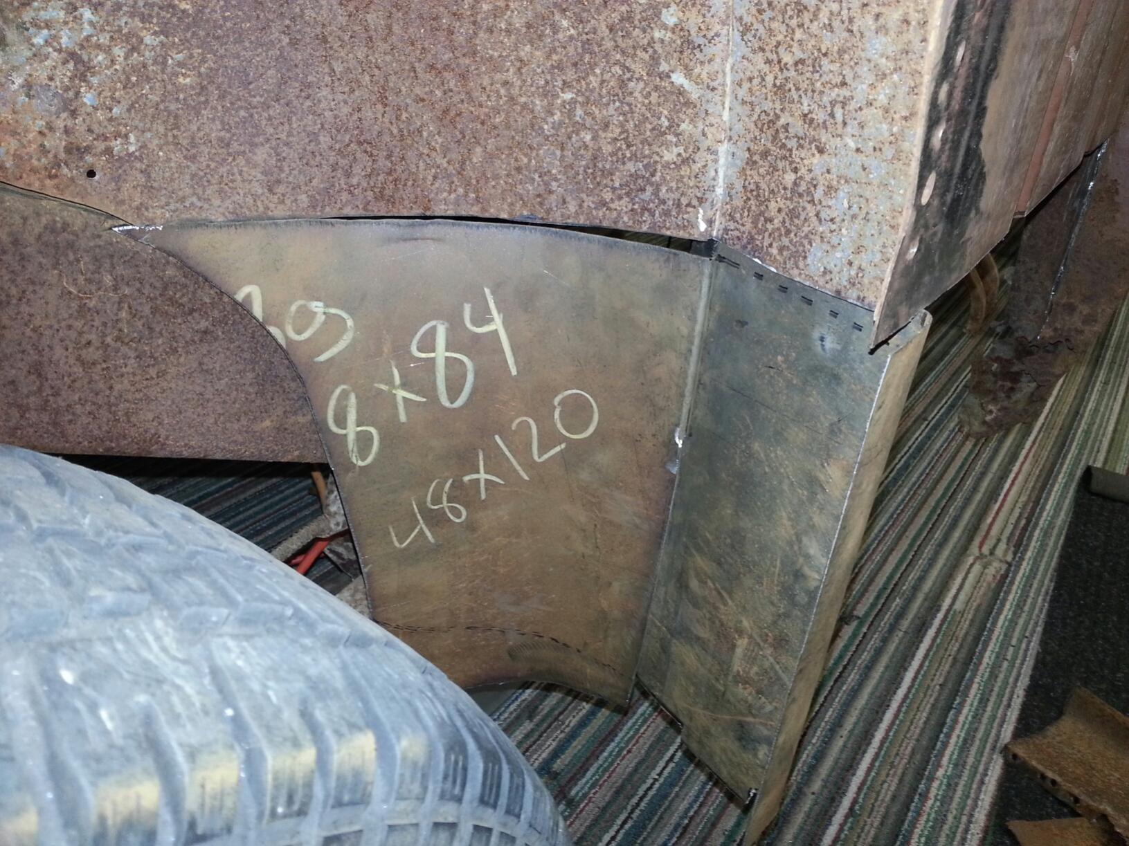

    Cut out the rear wheel well rusted areas this morning pounded and shaped the new metal for about an hour. Still a fair amount of forming and tweaking to do and I should be able to tack it in place. I don't think I did too bad considering I just have a 5" vice a grinder and a few body hammers? I bought a Miller 211 for welding and have been practicing a bit with it.

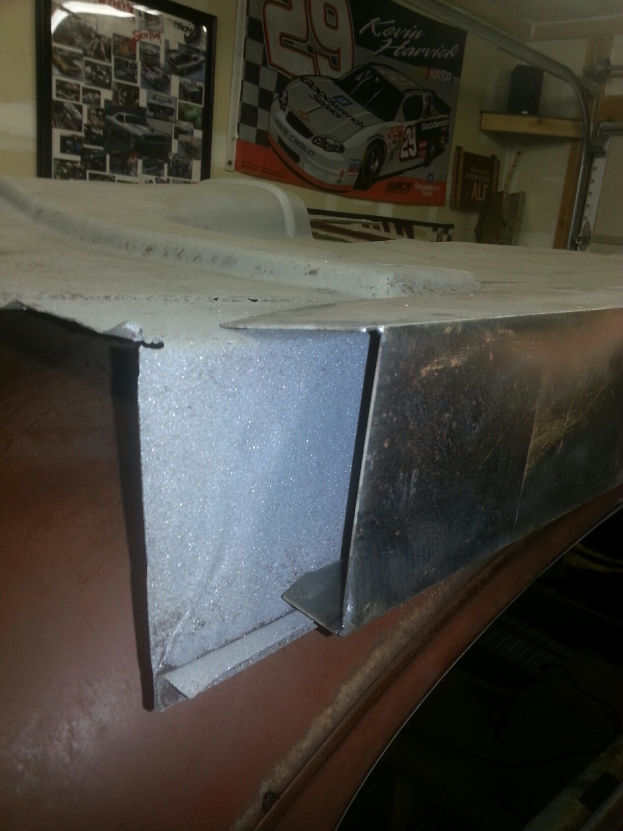

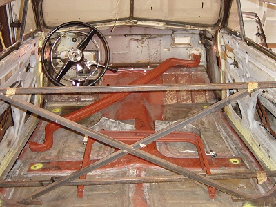

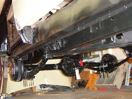

    Hello to all! Summer is over and the Merc is looking like it needs attantion again. I spent the summer gathering parts thanks to Matt Townsend I am very close to installing the new rockers and floors. I am looking for input on how others have installed the floor to rockers. The original floor pans came down at a 90 degree angle and were spot welded to the inside of the rockers. I have a floor pan out of a donor car and could probably repair the rusted out areas enough to make it look original. Is this worth the time and effort or would it be ore feasable to make a back cover plate for the new rockers and weld that to the new floor pans? I have tried to look into this in a few other threads but have not found this exact subject matter. I have attached 2 pics trying to show my question.

    How far have you got with your rocker replacement. I am doing my own ones at the moment. they seem to be as rusted if not worse than your ones. It took me a while to unpick it all and figure out how it was supposed to look.

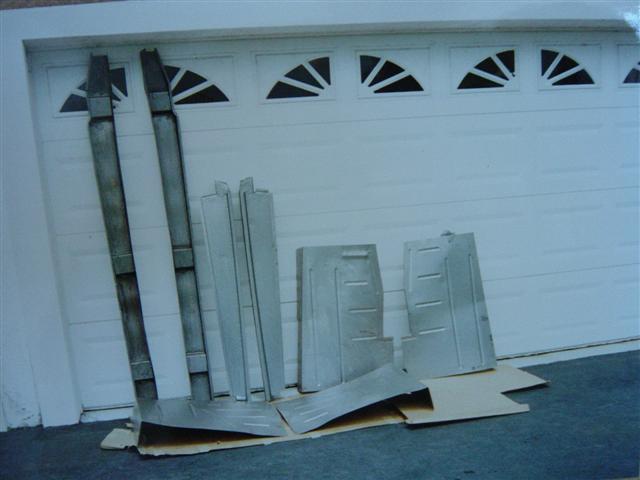

    I have been working on mine for a while now and understand what you mean. It seemed like everytime I started in an area of rust it led to another area that was worse. It finally came to an end but I had taken off the outer rocker, inner rocker, cut part of the rear wheel inner fender out, cut into the lower A pillar, had athe bottom of the B pillar fabbed, scrounged around for a year or so to find a good rear seat pan and had Matt T. make me a set of floor pans. My inner rockers were totally shot so I went to Green Mtn and bought a nice set. I am fabbing the front A pillar bottom area right now and plan to have this complete by next weekend. Lots of time on my part trying to figure out what sequence to do the process in as this is my first attempt going this far into the process.

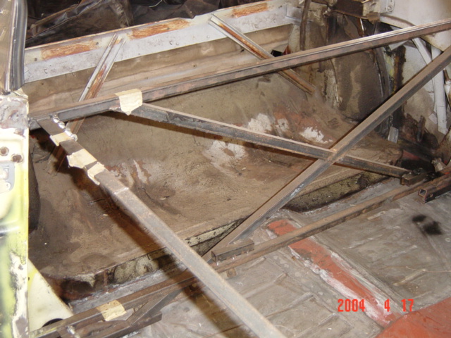

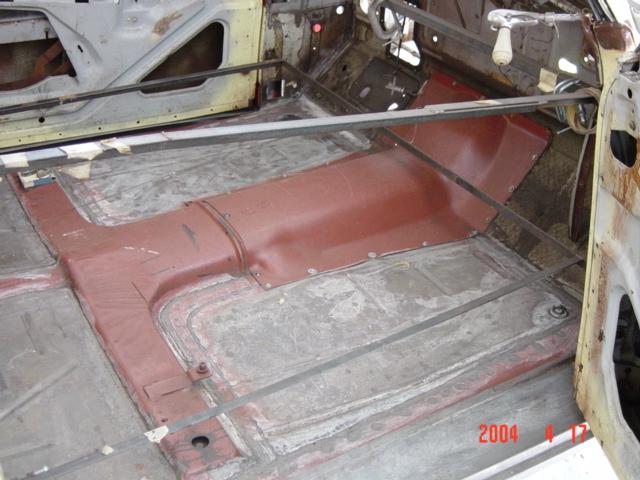

    RE: "Lots of time on my part trying to figure out what sequence to do the process in as this is my first attempt going this far into the process." Doing one side at a time on my Merc I first cross braced the door opening and the distance between the A and B pillars so they wouldn't move when I cut out the inner rockers since they control the door opening width and door gap.Then I repaired the bottom of the A and B pillars on one side of the car.. Then I tack welded the inner rocker in place and checked the fit of the outer rocker. Then I finish welded in the inner rocker on one side of the car. Then I did the same on the other side of the car. Then I welded in the outer rockers. Then I welded in the floors. I am sure others can offer differing ideas as to sequence as my Merc is a convertible. Repairs were made with the doors removed but the cross bracing was done with the doors installed.. I bought all my repair sheet metal pieces from Green Mountain in 1996. Hope this helps. I wish you all the best with your Merc.
