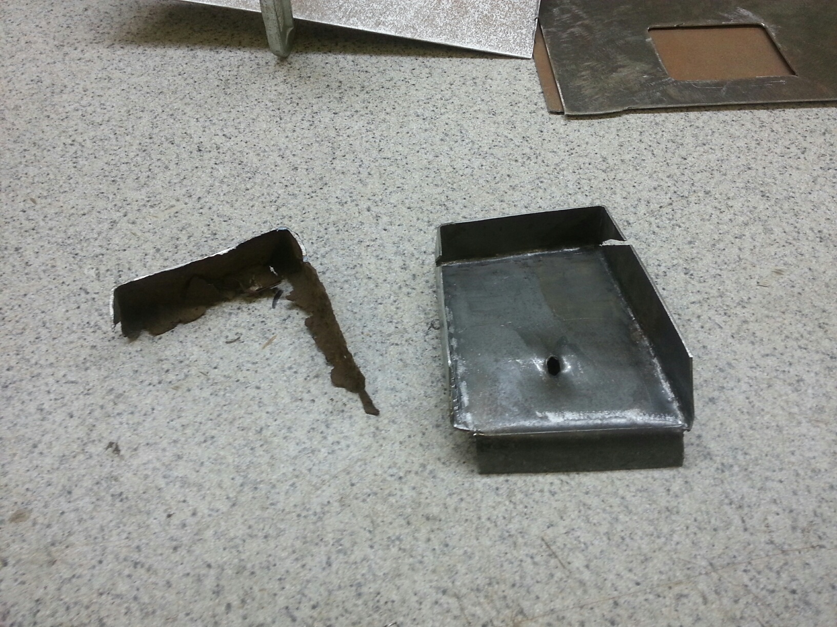

    Well after receiving my parts from Matt Townsend and his artwork it got me going on doing some of my own. the bottom of my A pillar was gone so I fabbed a new inside bracket. I am now making the new sheet metal pieces that wrap around it. I know I need a few more tools but so far my grinder 4" bench vise and body tool hammer set seems to be working.
