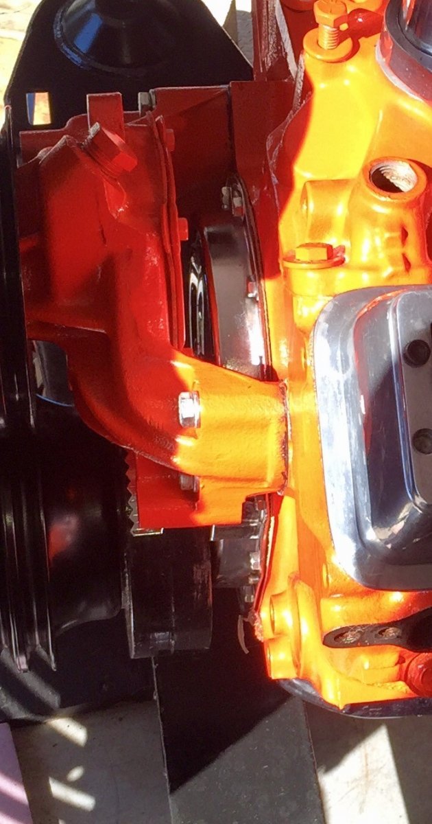

  23. WP38
    Joined: Jan 23, 2015
    Posts: 268
    WP38
    Well just an update, The timing mark on the balancer is about 30 degrees to the left of the top dead center ( piston stop) from the metal marker. So as mentioned I think maybe the harmonic balancer rubber has moved. A timing light wouldn't work this far around . Does this require me to replace it or is it acceptable to drive with the new timing mark I placed on it? At least the distrubtar is in the correct spot. Thanks
  24. You went both ways with the stop , made two marks and then split the difference, right?
    Some of us have been saying this right along .You probably have a stock dampener with an aftermarket cover (obviously). You could change one or the other, but if you're using the current timing tab to indicate TDC, just use your new mark and a dial back light to set your initial and total timing.
    Pretty sure your dampener ring didn't move. It can happen but usually stick shift, race car stuff.

  25. gimpyshotrods
    Joined: May 20, 2009
    Posts: 24,401
    gimpyshotrods
    This could still be a parts mismatch.
    An early timing tab on a late engine makes for 30°.
    Please post the engine code. It's on the pad in front of the passenger side head.
  26. WP38
    Posts: 268
    WP38
    14010201 on driver side ,thanks
  27. gimpyshotrods
    Posts: 24,401
    gimpyshotrods
    No, that's the one from the back of the driver's side head.
    We need the one stamped into the pad in front of the passenger-side head.
    About all that indicates is 1980-1985.
    31Vicky with a hemi likes this.
  28. WP38
    Posts: 268
    WP38
