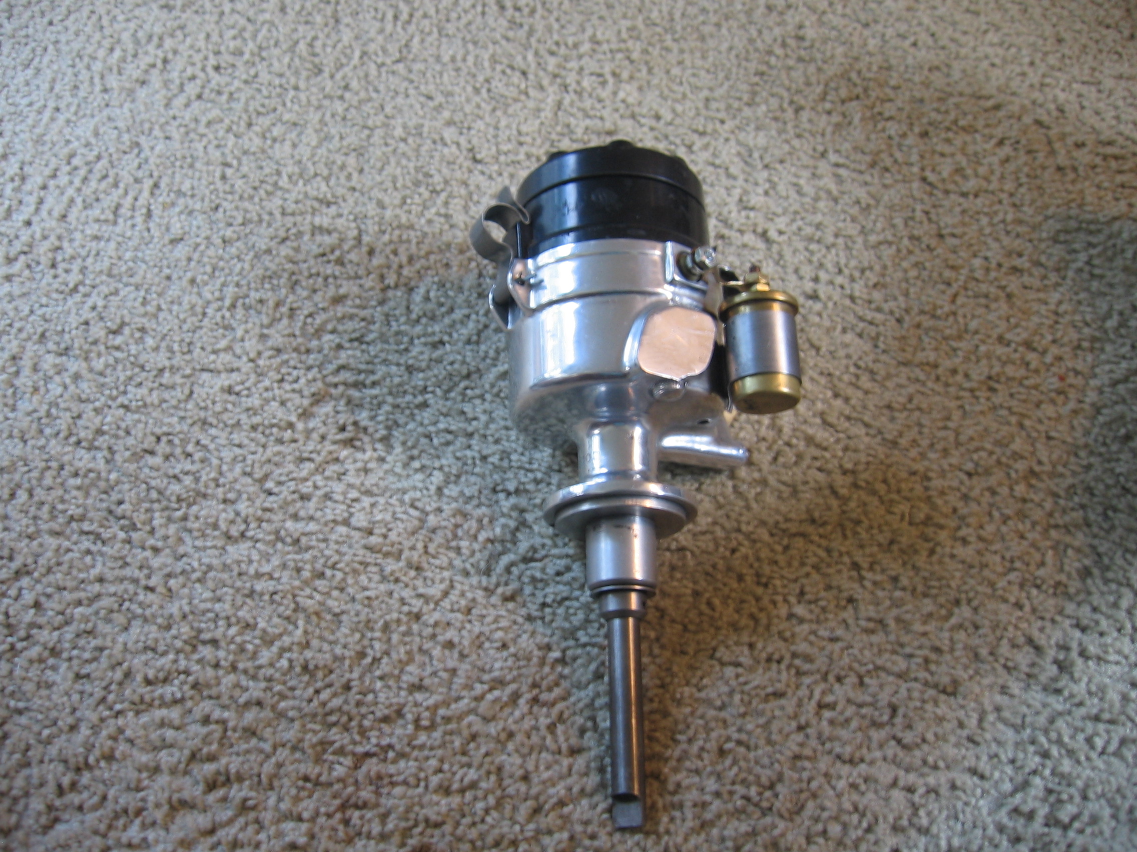

    Though I don't have dual carburetors, I am using the stock load o matic distributor with the vacuum disconnected and the advanced mechanism wired, so it does not move. I have my timing set at 20° and it starts and runs awesome. Stock 6 volt starter with a 12 V system. Just something to think about before you shell out a million bucks for a distributor.
    clem and Bandit Billy like this.
