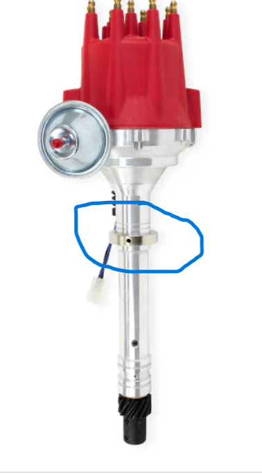

    AScreenshot 2025-06-10 112500.png some MSD distributors have an adjustable lock collar around the stem. If that is loose it could be the cause....
    tb33anda3rd, swade41 and pprather like this.

  30. OZCAST
    Joined: Oct 12, 2020
    Posts: 279
    OZCAST
    Good call! I’ll check that right away. Thanks!
