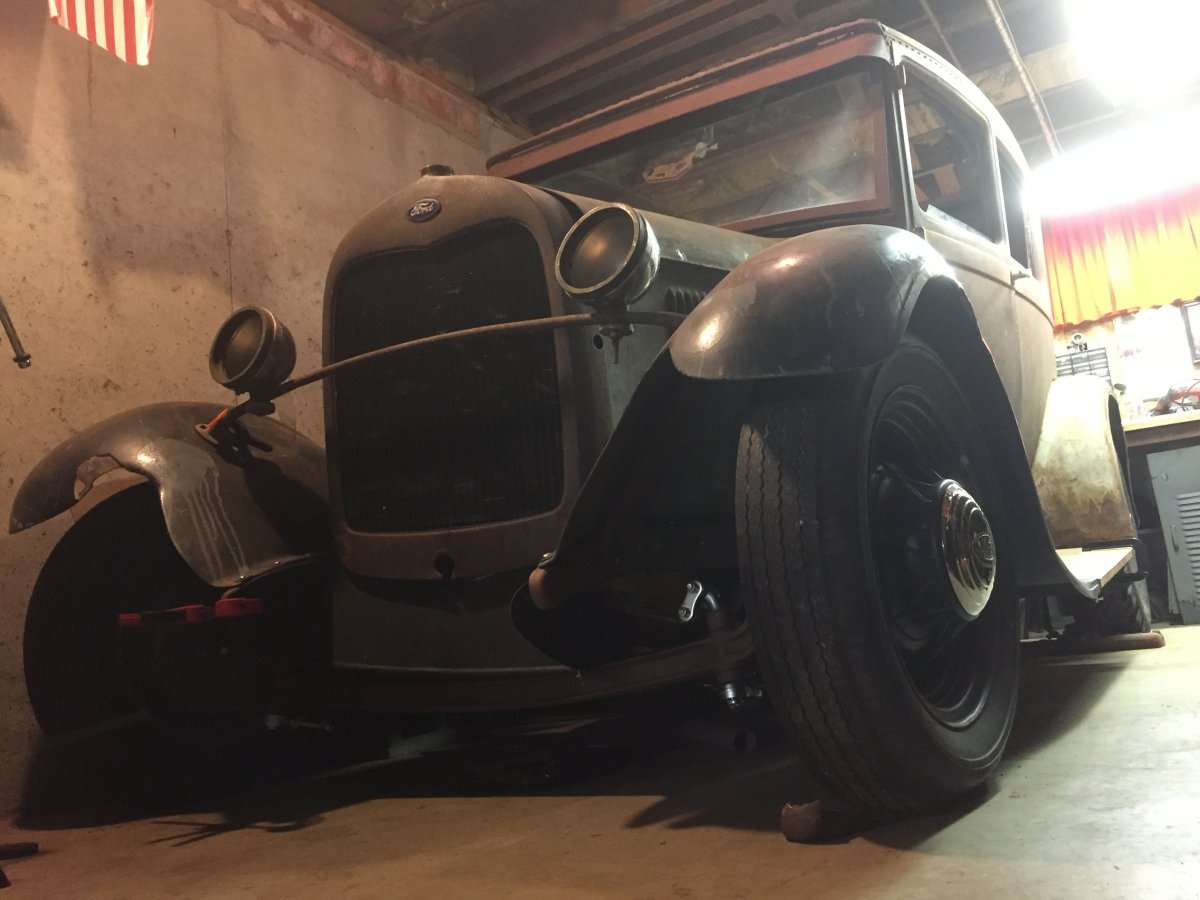

    Rear fender back on with a brace under it now, hub caps and some to small but better than cardboard mock up lights for you all.
    man that headlight bar needs dropped something feirce. Might switch to a 28/9 bar depending on which one I think I can get the most drop out of

  2. The headlights are way up there for sure but that can be remedied. The sedan looks real good, way better now than mine will ever look for sure.

    Undropped headlight bar!!!! Leave em up there. Looks better than dropped IMHO

    eh I'm not feeling them tall. I'm thinking a 7 inch light - which is about and inch and a half bigger than these- located about 3 inches lower than this. Roughly where my cardboard ones sat. I actualy messed with hanging them off the bottom of the bar instead of dropping it but it looked pretty silly.
    I'll get the actual lights before I start messing with stuff but the head lights have gotta be in the "right" spot for me or a car just falls on its face.
    I toyed with doing individual headlight stands off the rails but I fear the fenders would be a little floppy with no headlight bar tying them together.

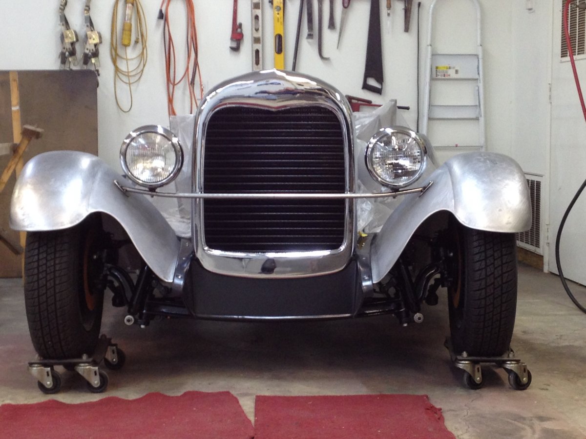

    The black coupe that Tardel and Ryan did had individual light brackets. Look at the build thread maybe it has pics of how he did it 1485399916351.png

    Man I love that car. And I totally forgot that it has split stands! I took a ton of photos of it when I saw it in Joplin I'll have to go back and review them.
    The headlights are sitting pretty close where I'd like them, hell most of that car is pretty close to where I'd like it lol.

    Eh...I dunno, Tim. That's a nice looking coupe but a model A ain't a model A without a headlight bar IMHO.

    As hard as I like throwing stuff around I feel like it needs the bar haha.
    A flat bar would nearly put them in the right place, may end up making a new bar all together we'll see this summer. Baby's getting closer every day

    Especially a full fender Model A, as the headlight bar is a major part of fender support

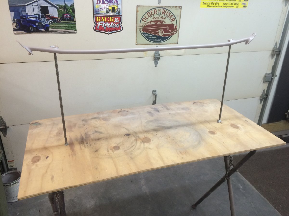

    I made this h/l bar from scratch. Speedway has the h/l cups in steel or stainless and the rest is solid 5/8 bar and flat strap welded up and smoothed. The headlites are guide 904s.

    @jakesbackyard that's pretty much what I had in mind lately and the photos help drive it home!
    Also thanks for the heads up on the headlight cups, it'll keep me from cutting up something just to get the cups.
    Might cut up a flat 28/9 bar to get it flat or might fab one all together. Probably a lot of mocking up in store for me
    Any 3/4 front shots of the car together?

    Somebody makes one shaped like this but not for 28/29. I can't for the life of me find a pic now. I always liked the look. Here is a pic of mine at a better angle when it was just spotted together and one when I primed it. No way to get a bolt in the bottom hole so I welded in a stud for a pin. Used a carriage bolt in the top hole. I put a slight dip in the bar similar to the one I always liked.

    That subtle curve is nice. I had wondered about the bottom hole. I've seen others weld a nut into the bar end and bolt it from the inside but the stud and pin idea is clever.

    And you've got the sockets for the lights welded to the back side? Would make it easier to make than putting them inline.
    Cool thanks again!
  24. jakesbackyard
    Joined: Feb 13, 2007
    Posts: 957
    jakesbackyard
    from ND
    Yes. The cups are welded on the back side. Seemed like the easiest way to keep the "smile" in the bar. The bucket is not as deep on 904 headlites so they don't interfere with opening the hood.
