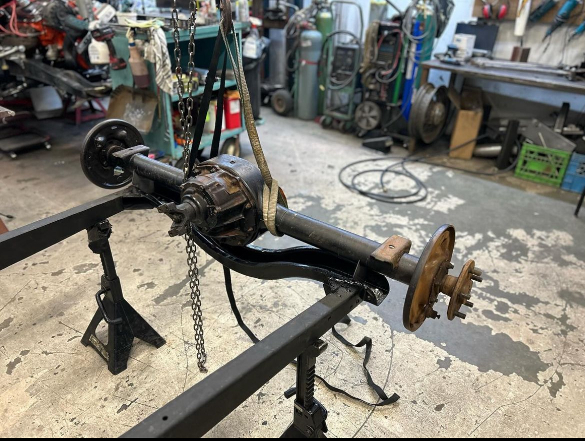

    Either I am seeing it wrong to there is very little travel between the frame and the axle.
  7. Tim
    Joined: Mar 2, 2001
    Posts: 21,548
    Tim
    from KCMO
    You can space them out to make them taller and dial it in.

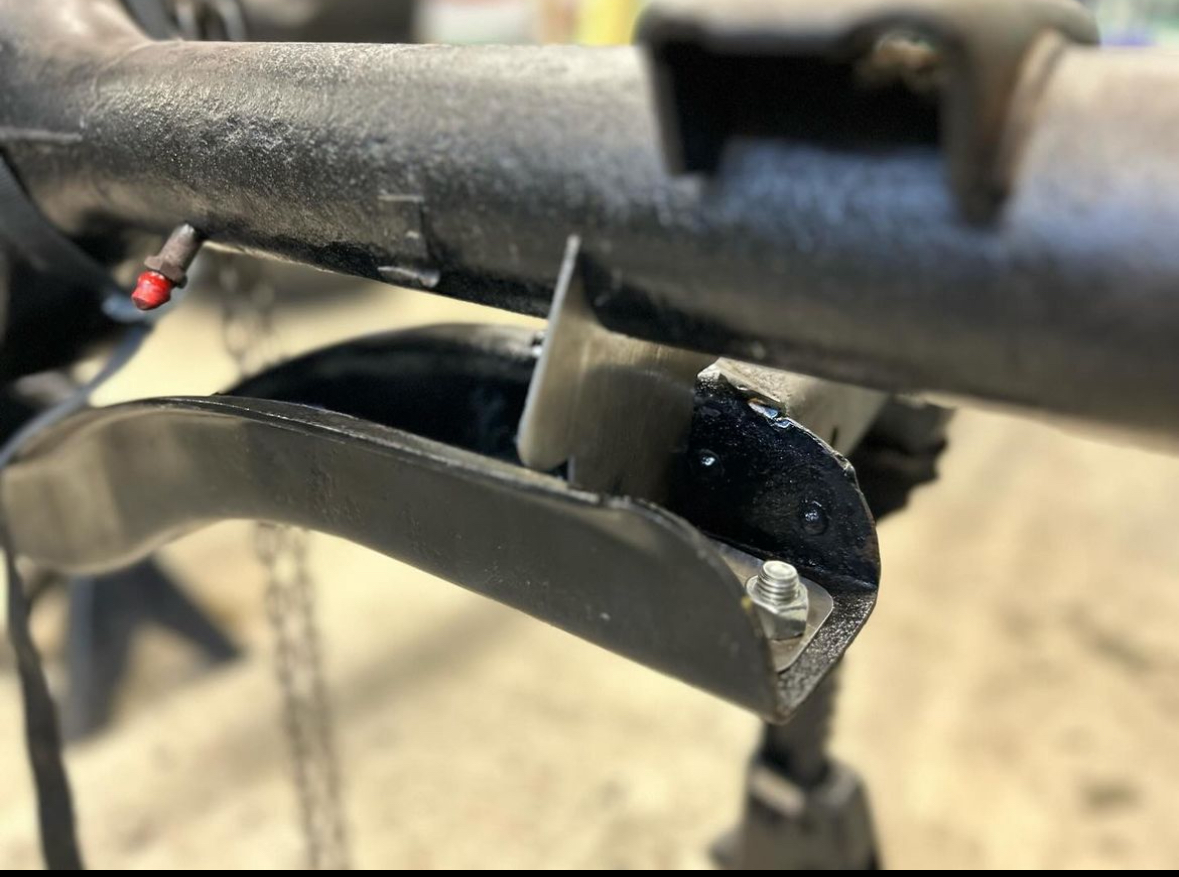

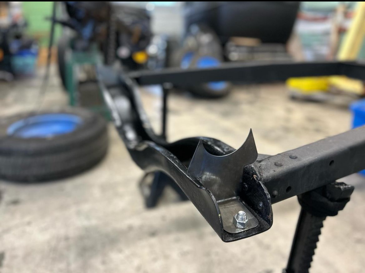

    @Six Ball the bracket end up about 3” from the bend to the center of the arch that the axle tube sits in.
    Measuring that same space I’m sitting around 4.25” and my 8” does not have 3” axle tubes so I think I’m going to buy like 9” of 2x1 box tube, weld a cap and nut in one side and cut a V on the other side.
    sit the V on the axle tube and I’ll buzz a little tack on it to keep it put. Seems easier than stacking up spacers under/ above the bracket.
    I could in theory clear the fenders being another inch lower but i like the heavy rake the car has right now. If I go with 1/4 spring in back I could set it up initially in the middle of adjustment so I could always drop it down a little or lift it up some if they sag.
    I feel like @BigJoeArt springs settled some over the first summer so sitting a hair high to start doesn’t sound bad either
