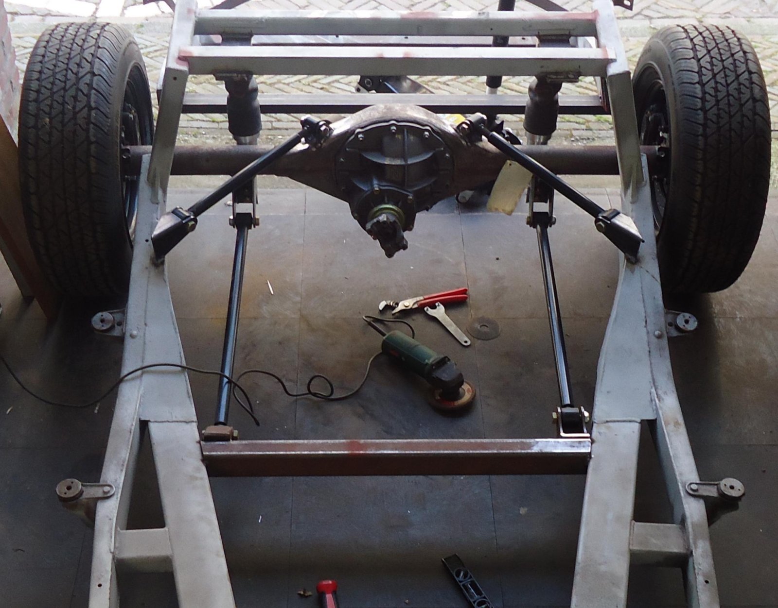

    I'm thinking about a triangulated 4 link sorta like these but using the quarter elliptics as the bottom links. So there would be no coil overs and no panhard bar. DSC01338.jpg 2011-11-13_15-00-18_75.jpg

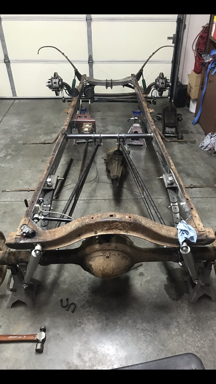

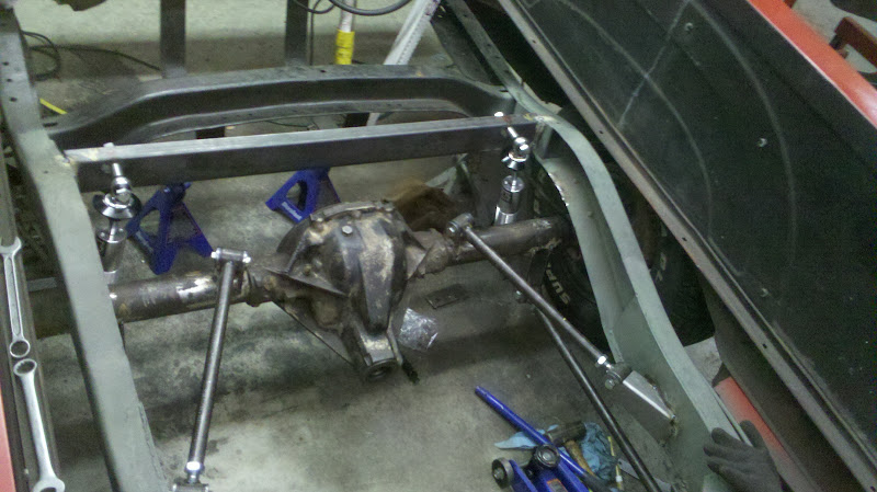

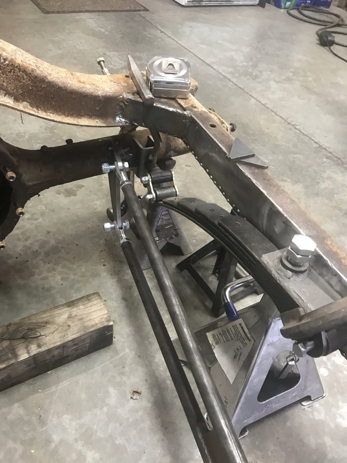

    I’m largely going copy @Primered Forever set up other than the spring hangers on the axle tube. IMG_3112.jpeg IMG_3111.jpeg IMG_3110.jpeg
    should get a good look at it in a few weeks at Pete and Jake hopefully. I’m gonna crawl under it with a camera and tape measure lol

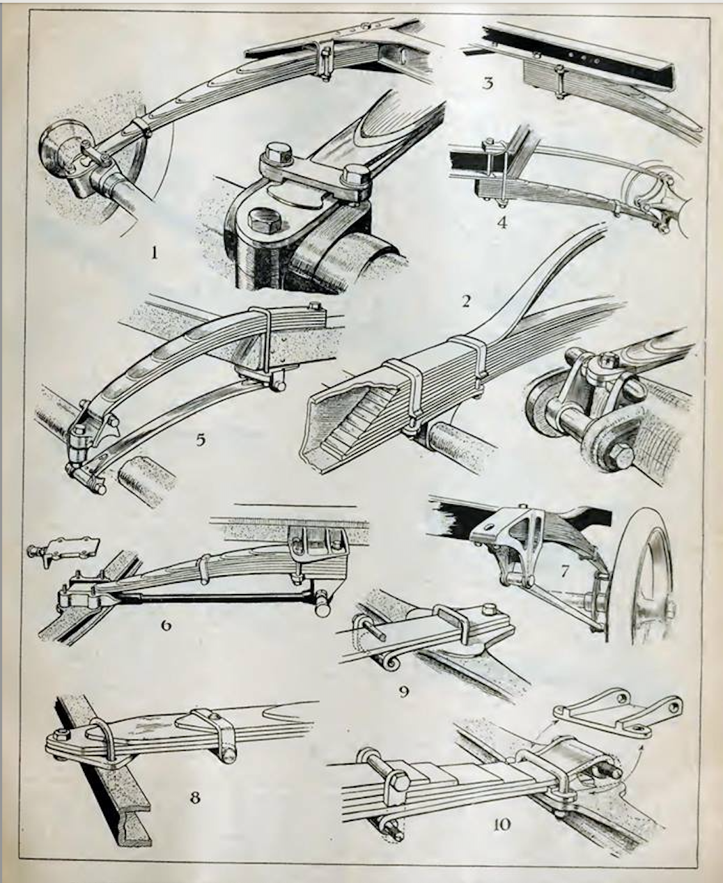

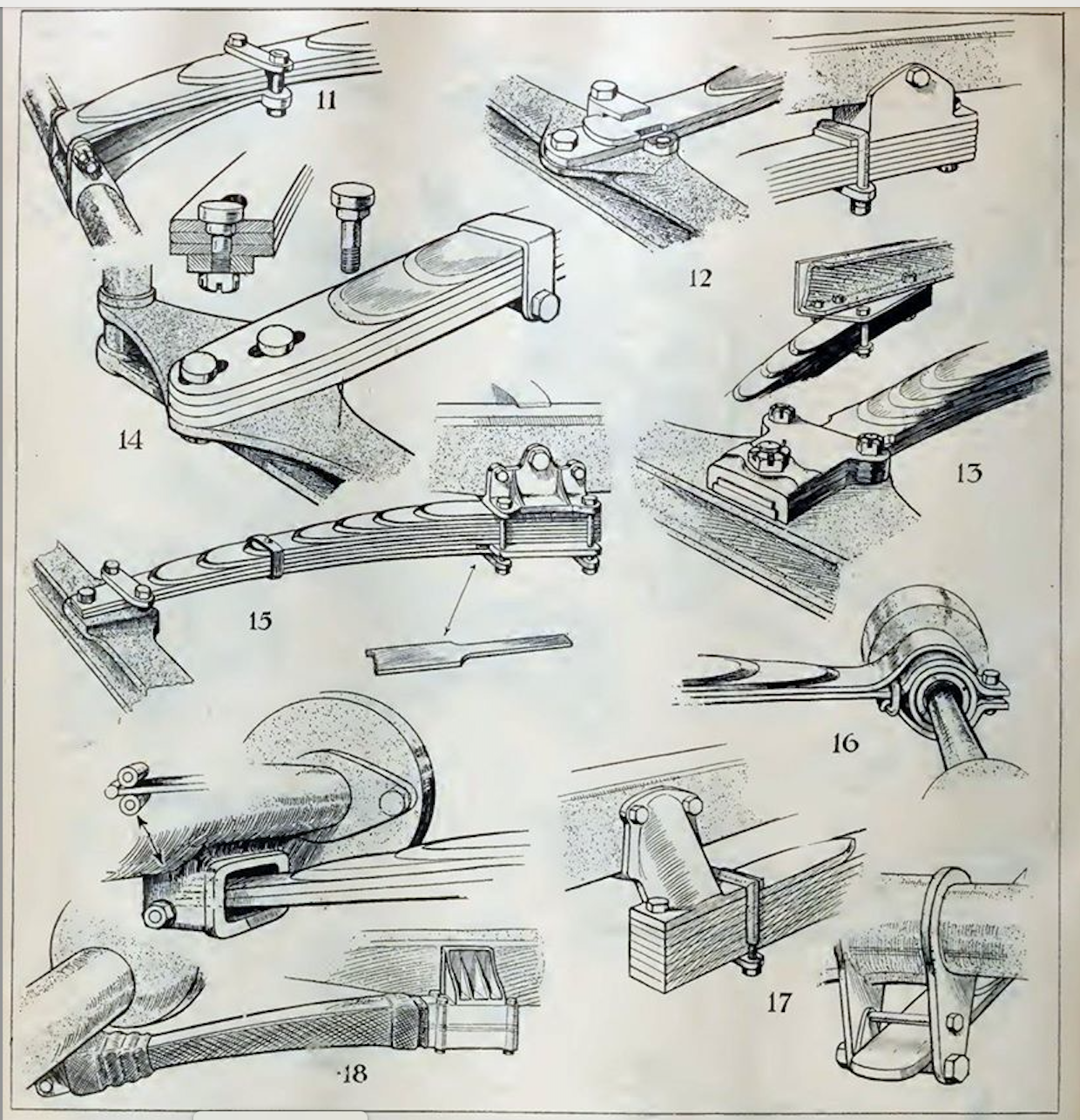

    There are a few threads bouncing around about them being used as lower links. And I have seen a few built like six balls illustrations where the leaf has no eye and just rides in a box or pocket of sorts. I’ve seen similar stuff with torsion bars done.
    I’ll crack a book today and see if there’s any relevant info.
    winduptoy and Six Ball like this.
  15. Six Ball
    Joined: Oct 8, 2007
    Posts: 7,243
    Six Ball
    from Nevada
    I was able to clean up the pictures. There are options but how well they work is a question. I need to measure a main leaf and see how much the length changes.
    brEad likes this.

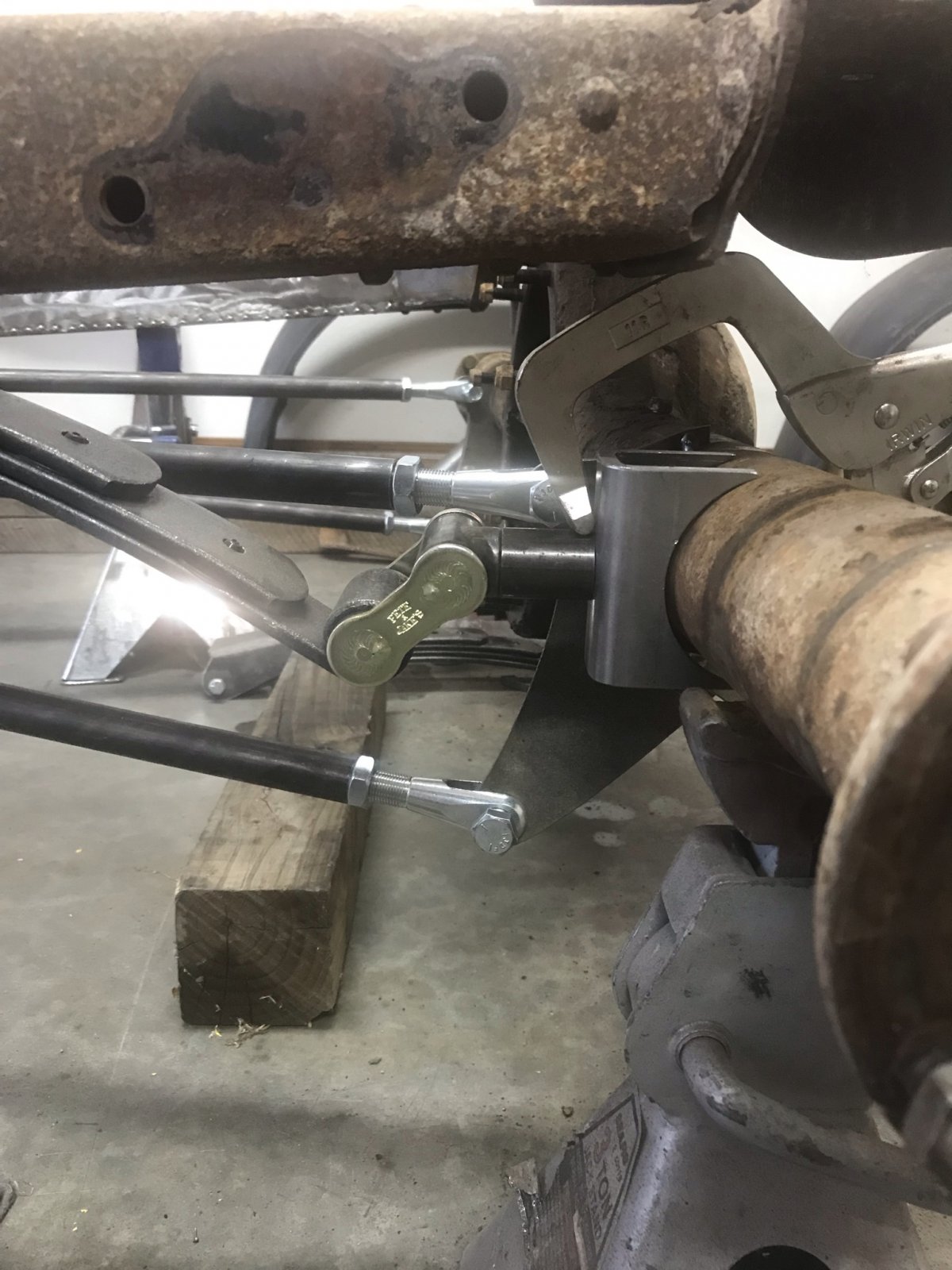

    I haven't read all comments/responses, just what Joey tagged me in.
    Since I didn't use shackles in my triangulated rear quarter elliptical setup, I have broken a mounting bracket where the spring eye bolts to the rear axle.
    A 'Johnny Joint' inside the spring eye is an option I've considered to allow articulation with less binding. I've also considered adding shackles, ditching the triangulated links and adding ladder bars + panhard bar. Like the photo Tim posted earlier of Primered Forever's setup.
    brEad, BigJoeArt, Six Ball and 4 others like this.

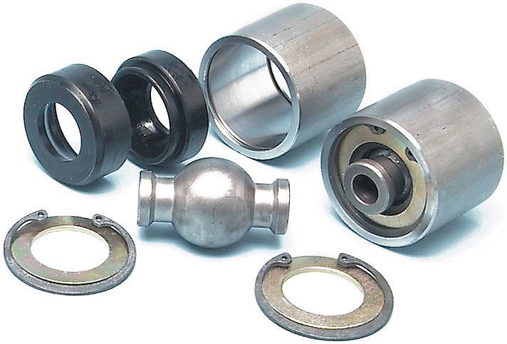

    Thanks Malcolm. That is great information about a quality build. Could you explain the "Johnny Joint" please?
  24. BigJoeArt
    Joined: Dec 12, 2011
    Posts: 1,104
    BigJoeArt
    *quote from a motor trend article* "The Johnny Joint is a ball-and-socket joint, but instead of steel, the ball is encased in a urethane socket. The Johnny Joint is a Currie Enterprises innovation and is named after John Currie. This style of joint has become very popular and “Johnny Joint” has almost become a generic term."
    Rock Jock is john Currie's company (of currie rearend fame)
    its generally a more articulate, and serviceable joint.
    brEad, winduptoy, Six Ball and 5 others like this.

    They also make a Johnny Joint shackle mount. Likely a good option to use with the quarter elliptical / ladder bar setup.
    brEad, BigJoeArt, Thor1 and 7 others like this.
