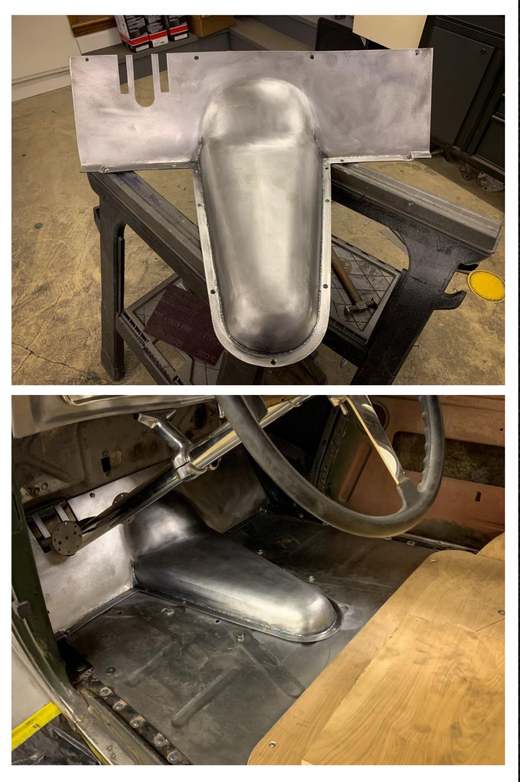

    46 is still fighting me so I put a blanket over it and went back to the A.
    Everything g on a car is a set of dominos so what may appear to be 6 different projects on the A I’m working on I’m kinda seeing it as a whole.
    since the motor has to come up to clear the steering that changes a lot of things. So I started playing with ideas for the trans cover and floor
    The drivetrain is getting raised just shy of a can so I figured they’d make for a good spacer on my cardboard floor.
    I bent a clothes hanger to copy the top shape of the trans and bell housing and stacked it all up to see where it lands IMG_4110.jpeg IMG_4111.jpeg IMG_4112.jpeg IMG_4113.jpeg IMG_4114.jpeg IMG_4115.jpeg

    As of now I think that’s my favorite idea, a trans cover that is part of the toe board and comes out together. I can make that with metal easy enough I think.
    The flat part of the floor I think I can run some additional legs off the tube subframe to hold a piece of 3/4” marine plywood as originally planned and the legs along side the trans can get drilled and threaded or nutserts. Then the trans tunnel flange will completely over lap it and you won’t even see it.
    still toying with distributor clearance ideas which may have to tie into this same area of the firewall/ toe board.
    I’ve got the ladder bars and cross member on the box siting next to the car but I need to get the drivetrain in position before I start messing with that stuff.
    lots of picking away at it lately. Even if most of the work is mental. But eventually the work will be hammer forming :)
