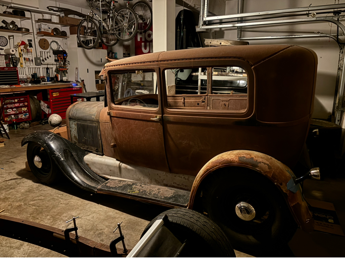

  4. Tim
    Joined: Mar 2, 2001
    Posts: 21,586
    Tim
    from KCMO

  8. Tim_with_a_T
    Joined: Apr 30, 2011
    Posts: 1,817
    Tim_with_a_T
    Stance is perfect. Me likey. Not helping my "no more projects" rule as I browse Marketplace for 28-29 sedans...
    redzula, brEad, Six Ball and 3 others like this.

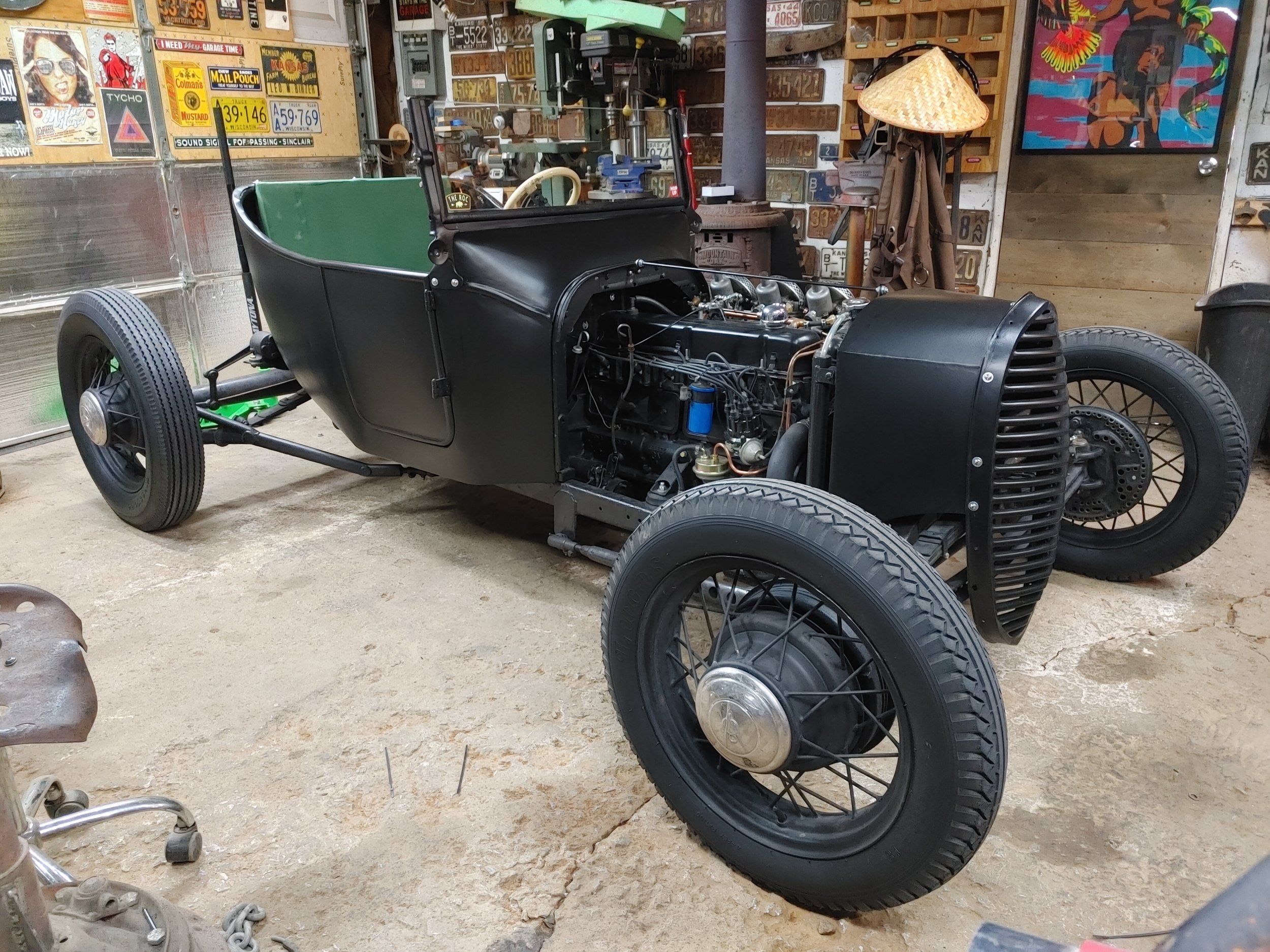

  17. RodStRace
    Joined: Dec 7, 2007
    Posts: 10,929
    RodStRace
    Really nice runabout! Hope he gets the sweat back out, it shows.
    You should post that pic and some more over in the Love For T thread.
    Tim and Six Ball like this.
  18. Tim
    Joined: Mar 2, 2001
    Posts: 21,586
    Tim
    from KCMO
    Even has bright *** headlights hidden behind that grill!
    Six Ball likes this.
