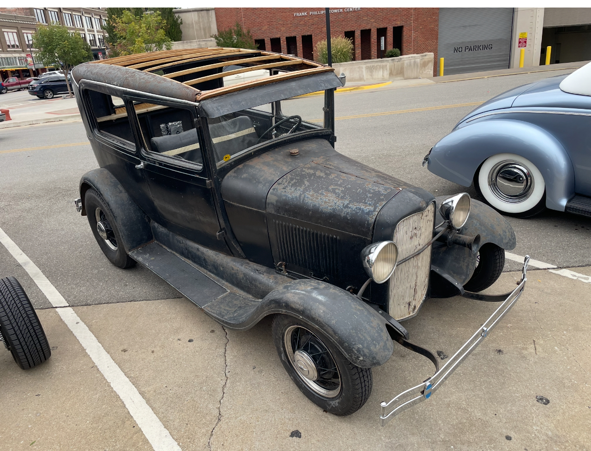

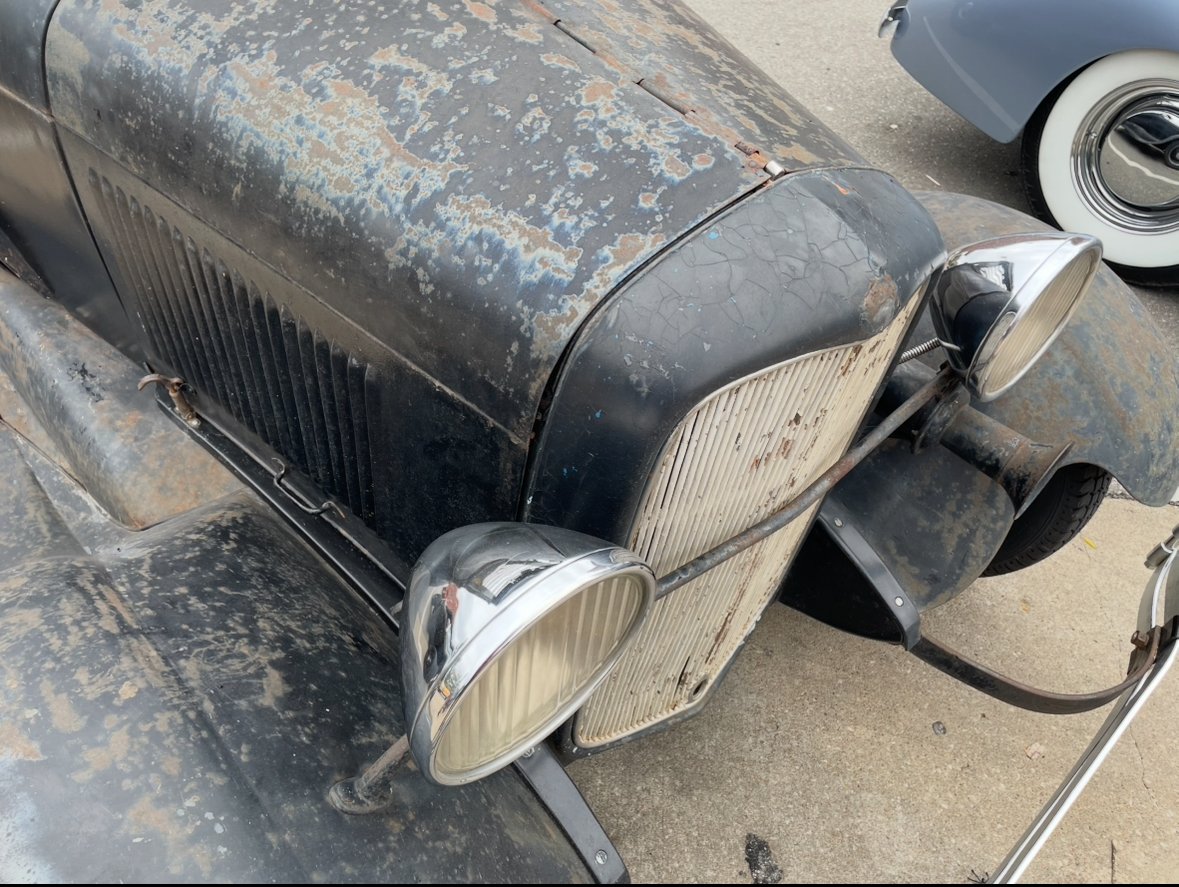

    On more of a plan C note has anyone seen a 32 shell on a 28/9 kinda like this but with the grill sectioned to be closer to a stock height grill? I like the shapes of a 32 grill shell but the opening being that tall compared to a 28 really changes the proportions to me. Curious what bringing the bottom up and putting the stock splash apron in place might look like. IMG_8284.jpeg IMG_8286.jpeg maybe I’ll photo shop it this afternoon
    brEad, Thor1, Six Ball and 1 other person like this.
  30. 05snopro440
    Joined: Mar 15, 2011
    Posts: 3,020
    05snopro440
    Can't say I have. This was a friend's build and I agree a section with a splash pan would help.
