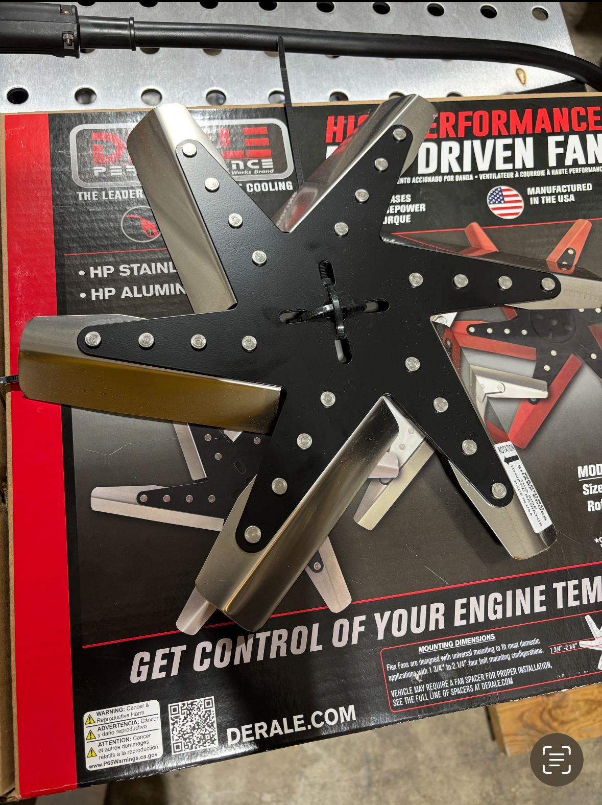

    got delayed by the weather but the fan showed up today. I bet it’s no more than 1/8” thick, I need to enlarge the center hole and then I can mock it up. Just need the shop to get above freezing. Maybe next week. IMG_8408.jpeg

  19. Seeing your new fan made me laugh. I got a 13" Derale fan two days ago. I put it in place and now know that I'll need a one-inch spacer to move it forward so that it doesn't conflict with the crank pulley but it looks like a good fit. I wanted to have a larger fan but really couldn't go much larger than 13" without taking out the transmission cooler lines. I'll see how well it cools and, if necessary, fabricate a shroud to pull air through the upper one-third of the radiator.

    Yeah I’ve yet to mock it up but I’ve got my fingers crossed. I think I could “in theory” fit the 18” but went with 15”. Seems a pretty standard size and I had concerns about an 18” fan swinging into who knows what, or compromising spaces for hoses and etc. should be above freezing Sunday so we’ll see!

    Well sitting it on the water pump pulley I’m gonna say I’ll have room. IMG_8423.jpeg also saw this Stude powered hotrod I think @Stogy found online. IMG_8421.jpeg
