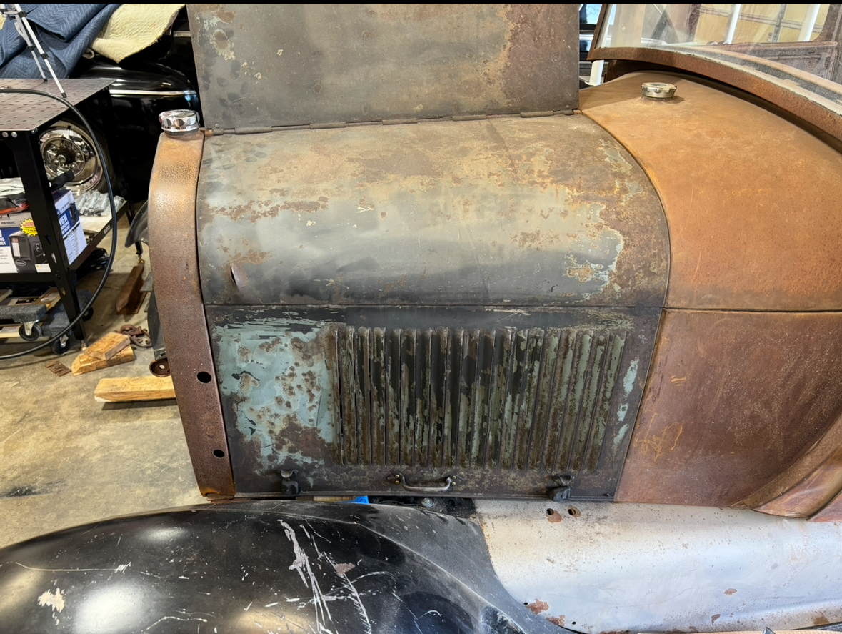

    Alright contacted @Stogy about Stude parts and made it to the garage this morning! I used some lube, a step bit, and a caliper to get the fan drilled out to Stude size. I didn’t have a size that was exactly right so I drilled to the closest under sized option and then hand filed the last 1/16” to fit the pump going on the car. IMG_8461.jpeg took about an hour, still got a mess to clean up tonight.put the pulley on the pump and fit again IMG_8462.jpeg still good so I put it on the stuck pump on the engine IMG_8463.jpeg looks good! I think the pulley needs shimmed forward to clear the pump housing but it’s minimal to get it to align and I think I have some shims on hand. IMG_8464.jpeg i need to adjust a few things but I think I’m going to land at just over 1/2” clearance to the radiator both top and bottom and the fan landed pretty dang close to center of the radiator. IMG_8465.jpeg this is why I wasn’t to concerned about the ugly flex fan. Standing directly to the side of the grill shell you can hardly see it… and I’m running a full hood most the time. IMG_8466.jpeg the pump isn’t big at all so I think I’m going to rebuild the stuck one and throw it in the go bag. Won’t find one at Napa!
    next step will be tacking some braces and putting the cowl top back on to fit the hood and start on motor mounts.

    Man, that worked out pretty slick I think!

    It needs some tweaks but yeah I think it worked out pretty good! I think this summer I’m going to buy some more files. Something about hand filing something for an hour itches a part of my brain in a good way lol

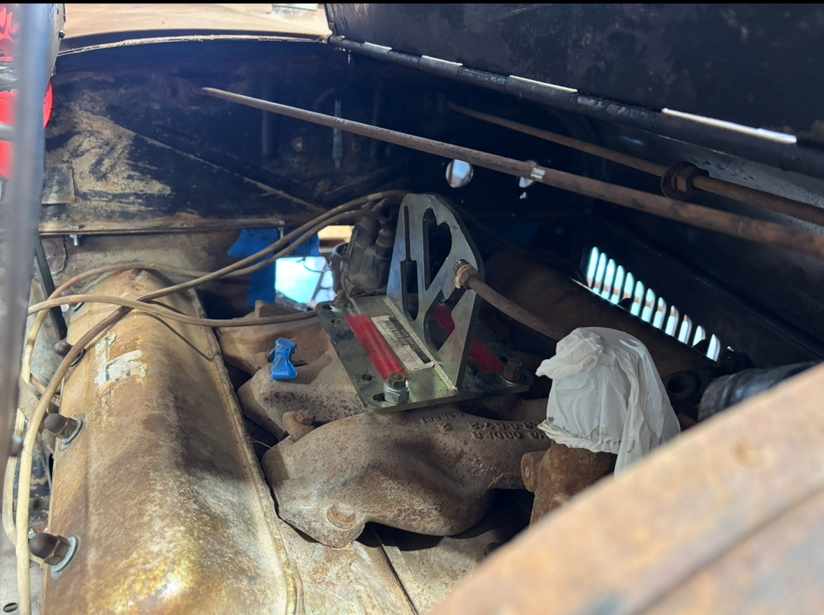

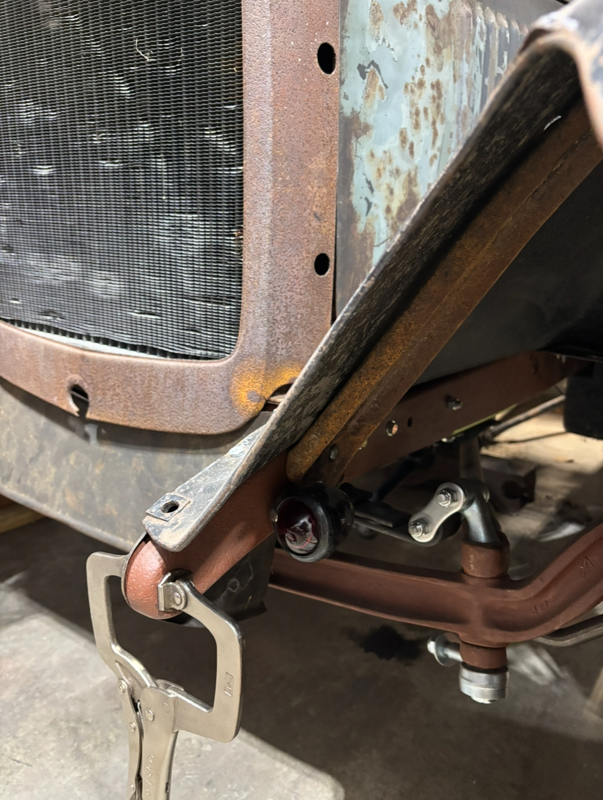

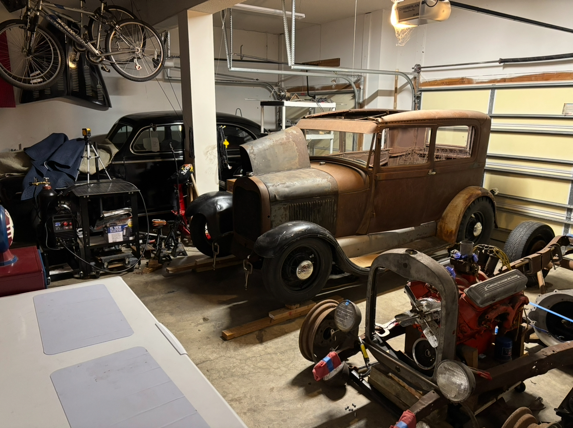

    Well I went and cleaned up and started mocking up engine and trans mounts this morning. IMG_8488.jpeg Wouldn’t you know it the hemi mounts are now pretty much dead on!
    The motor side needs to be a different width to work with the tabs on the Stude. Either going inside or outside etc. and I think one more hole but dang I didn’t expect them to be so on the money! I still need to experiment and see how much squish I’m going to see when I sit the engine on them. Shouldn’t be a hard thing to do.
    IMG_8489.jpeg On the drivers side the frame mount may need to be clearanced or narrowed to clear the steering box. It’s very close I’ll bee to further mock that up.
    anyhow there’s todays update.
    I’m back and forth between measuring a ton so that the engine lands in the exact same spot after the mounts are done. And finding some way to hold the engine in place with the motor mounts unobstructed so I can just built them in place.
    Be a good time for a motorcycle hoist I could sneak under the oil pan lol
    maybe I can make a wood stand that holds the engine by the oil pan flange? That seems simple enough

  8. Tim_with_a_T
    Joined: Apr 30, 2011
    Posts: 1,782
    Tim_with_a_T
    Look what @Bandit Billy made for his wooden engine cradle - that should give some good inspiration!

  9. Tim
    Joined: Mar 2, 2001
    Posts: 20,796
    Tim
    from KCMO
    @Tim_with_a_T yup that’s the basic idea. Get everything square and level and then sneak that in there to keep it put.
    we’ll see.

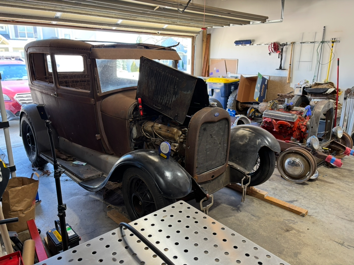

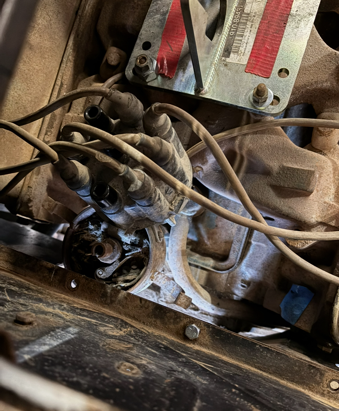

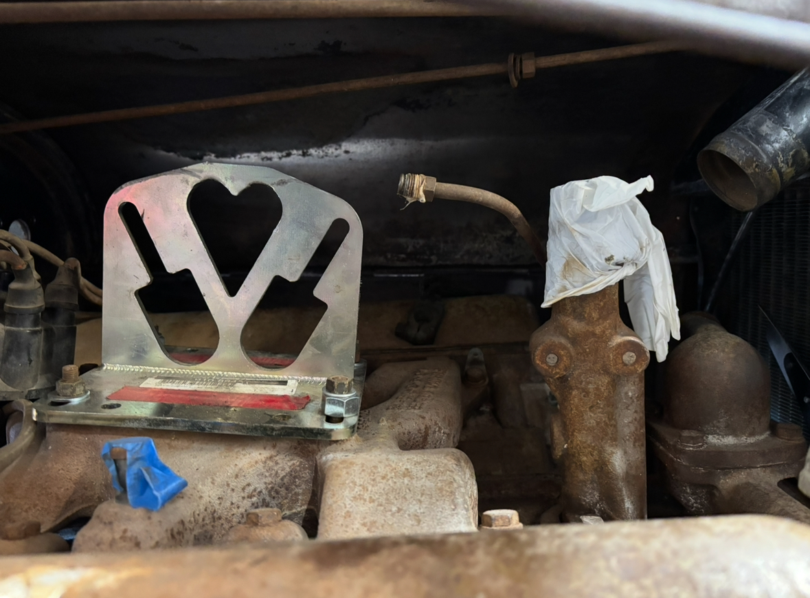

    Alright got it back together! I can’t believe it actually fits lol. This should look wild with just hood sides on, that’s always been in my head as an option.

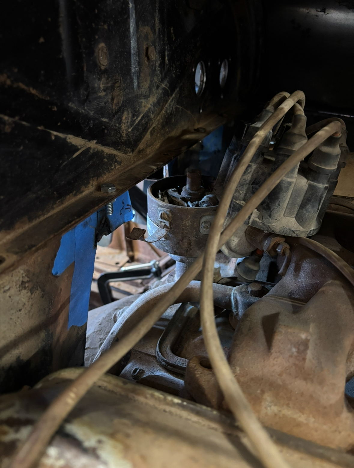

    IMG_8509.jpeg IMG_8510.jpeg Really the distributor needs less clearance than the edge of the bell housing does.
    I’ve got the section I removed from the firewall and have held it up a few times. I’m back and forth between weather I’ll use that piece manipulated to fit the space or just make a whole new panel. I think I’ll make one from cereal box cardboard and then see how close the existed piece of metal I have is or isn’t. IMG_8511.jpeg IMG_8512.jpeg ive got about 4 inches from the top of the carb to the radiator stay rods. Should be plenty of room for a good filter, I may need to pull the entire threaded rod instead of just the wing nut when removing it. I think some dirt track cars use a little dzus style fitting. That could also be an option IMG_8513.jpeg trying to get everything parallel I moved the bottom of the radiator forward. This entire time I’ve been just lining up the holes in the radiator feet with the holes in the crossmember. Well scoot it forward and put the hood on and dang if that hood doesn’t line up perfect. I’ll figure that all out later I guess. But for now gravity and the stay rods are keeping it in place fine. IMG_8514.jpeg IMG_8515.jpeg wall to wall engine! IMG_8516.jpeg im really looking forward to emptying the shelves and putting all the little do dads and trinkets back on. IMG_8517.jpeg good stuff.

  15. 05snopro440
    Joined: Mar 15, 2011
    Posts: 3,239
    05snopro440
    Just sitting there in your last photo it looks darn good.
    I'm amazed how little issue the distributor clearance to the firewall looks to be.

  16. Tim
    Joined: Mar 2, 2001
    Posts: 20,796
    Tim
    from KCMO
    Yeah it was a lot of dancing around to get there that’s for sure. I think once i have the filler piece made I’m going to tack it and then pull the motor and trans and then put it back in just to be sure.
    sometimes because it can land in in that spot doesn’t mean it’s got a good path to that spot
    And if it looks good now wait til the front isn't on a stack of 2x4’s!

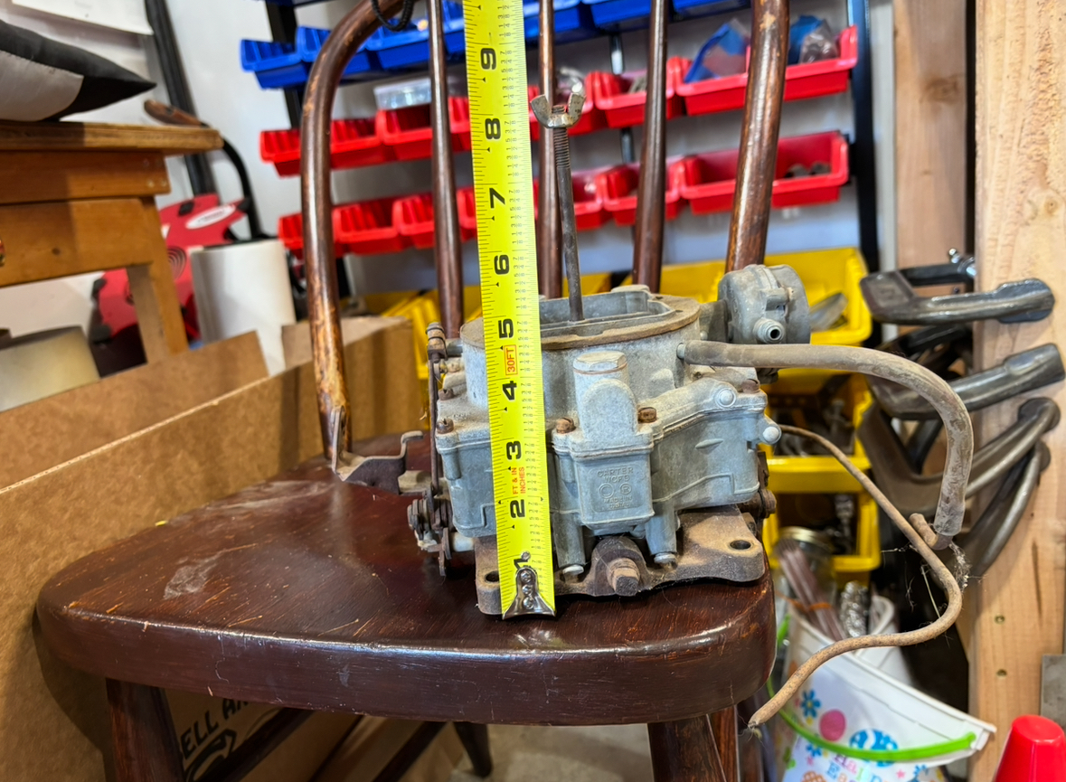

    grabbed the 39 and went for a quick look just now. IMG_8662.jpeg told ya it was close! IMG_8663.jpeg looks like a full 39’ would be to long. My hand is more or less where the knob need to be. IMG_8664.jpeg basicslly where that last bend up begins IMG_8623.jpeg gonna say that’s pretty dang close!
