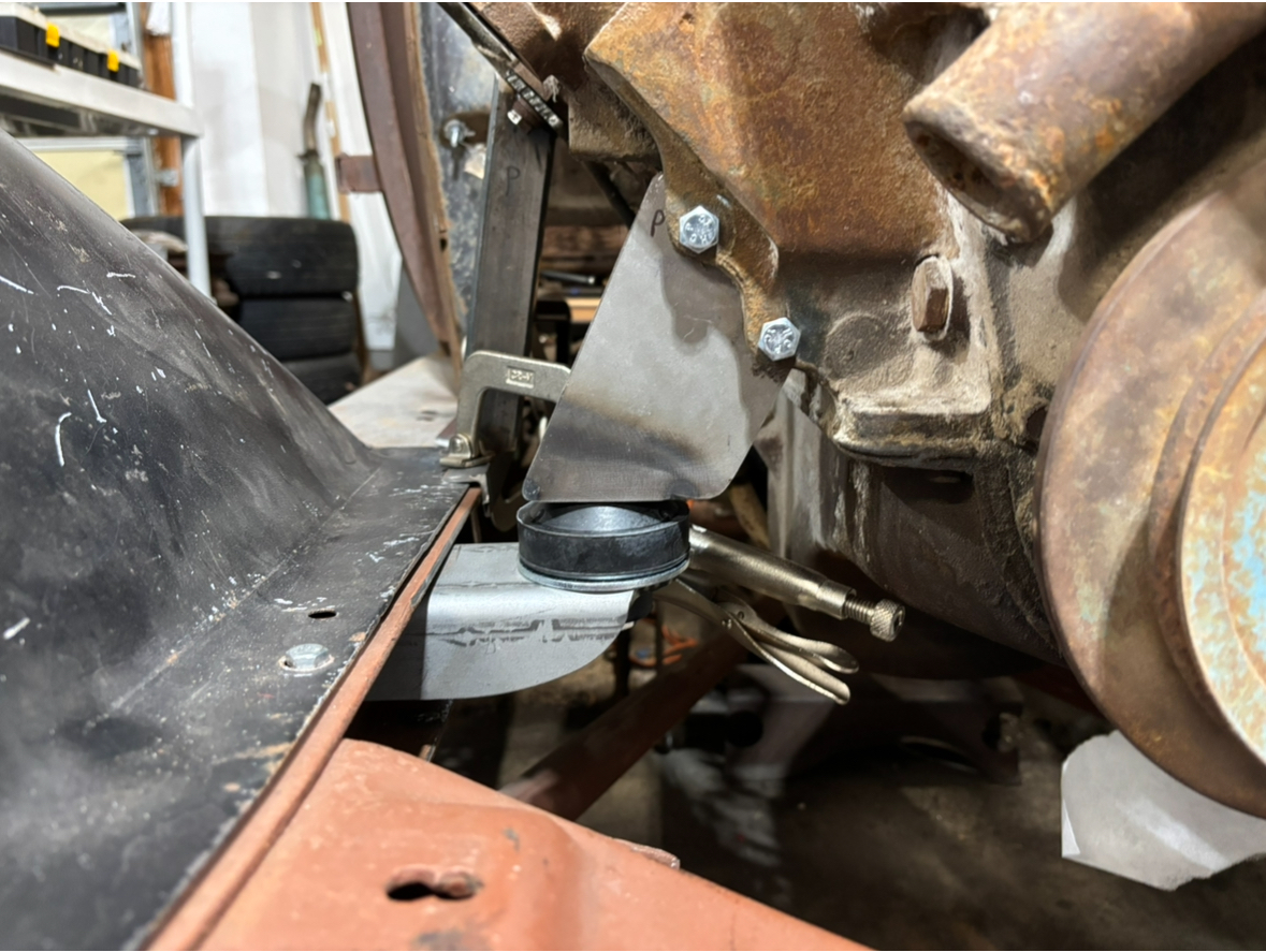

    Took the long way around and got the old frame
    mounts off and this morning a friend made my mock up mounts out of metal.
    Got home and mocked one up, drivers side needs some caked in oil/clay cleaned off the block and then I can get that one mocked up as well.
    I think I need to tweak the frame mounts or consider my options for mounting them some more. That’ll be the next step after I clean the rails up for welding etc.

  15. Tim
    Joined: Mar 2, 2001
    Posts: 21,585
    Tim
    from KCMO
    Did a little t******* and got them both fitting great. There’s a little casting , and a slight radius that the mock up pieces didn’t seem to care about that metal does. Got it sorted, both sides bolted on with the frame sides clamped on. P***enger side is pretty much there. Just needs the frame cleaned then tack it all on.
    Drivers side the steering box and steering box mount are VERY close so I’m gonna have to fiddle around with that a little more. But feels like there is room to get in there with the mig and make them hold.
    then once they are good I move on to the trans mount!

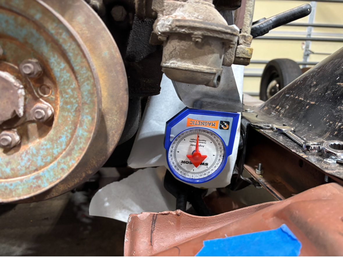

    Well this morning I cleaned up a little more and got the p***enger side motor mount bolted to the engine with new hardware that’s the right length to fit after taking a flap disc to the spots that got trimmed last time I messed with this.
    put a normal - read not a nylock- nut on and everything landed perfectly. IMG_9102.jpeg that photo has no clamps and just snugged the nut to keep it all together. Frame side is up against the inside flange and pushed all the way to the frame web. IMG_9103.jpeg The drivers side wasn’t so easy. I removed the interfering steering box bracket bolt and it’s very tight but I don’t think anything needs cut. But when trying to bolt the halves together there was some alignment issues.
    The hole in the motor half was nearly a 1/4 inch or more further from the frame than the p***enger side.
    after measuring everything side to side for twenty minutes I found everything very even and level. I was stumped until I decided to stick a level on the bottom of the engine mounts and found the drivers side was off 3 to 5 deg! There’s a little wiggle room when bolting these on I losened all the bolts up and pushed and got 2 degrees closer. I think I might need to file a hole just a hair or maybe find a dance putting it on and it’ll be level. The mounts are the same side to side but the amount of “off” that would create this amount of off could be just a teeny bit here and there that you’d never be able to eye ball.
    either way with the mount leveled out it should close my 1/4 gap and I’ll get the frame side mocked up.
    then it’ll get some strong tacks and I’ll move on to the trans mount

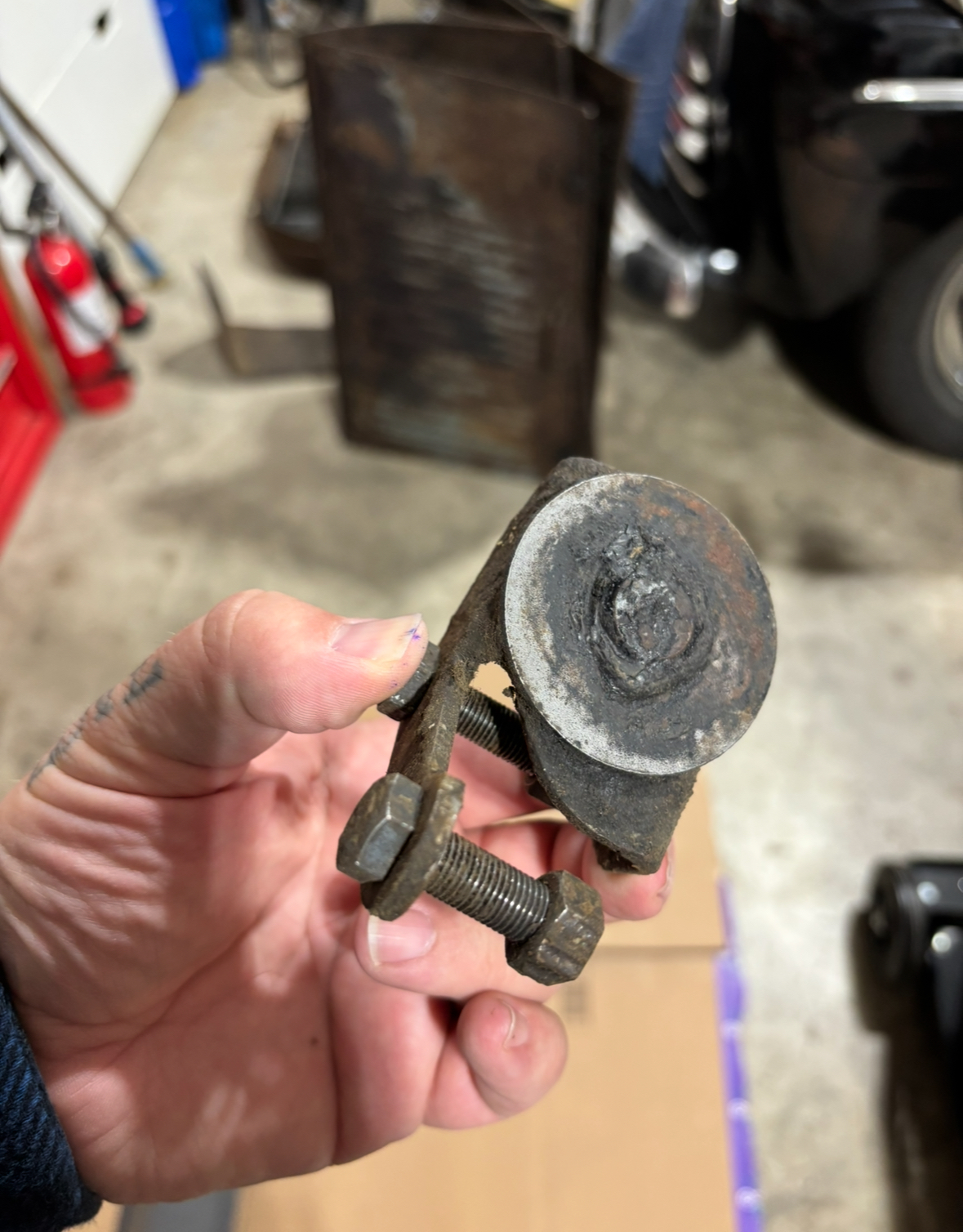

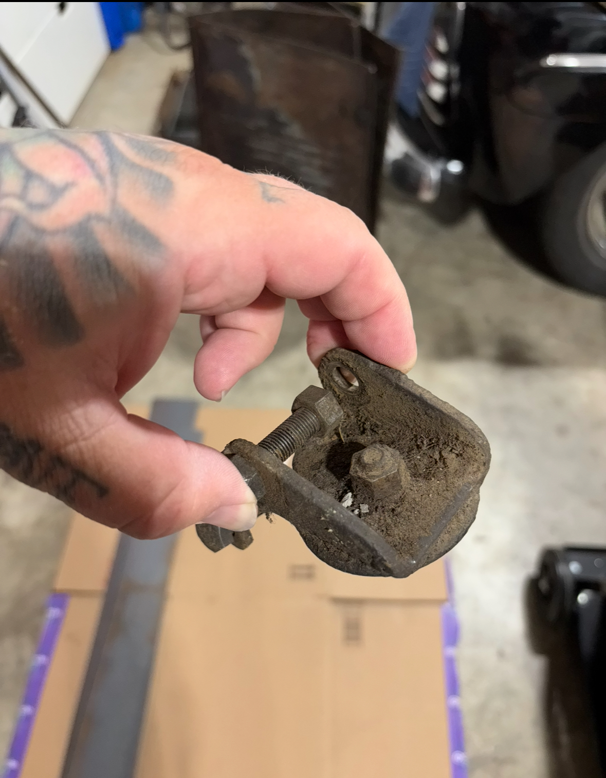

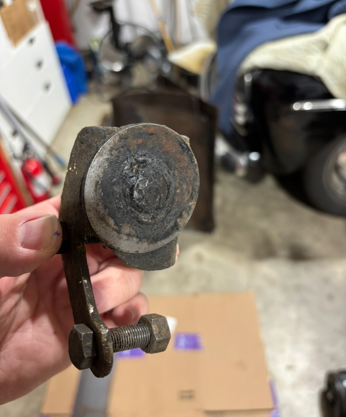

    Guys I’ll have to take a photo of what flimsy trash the stock Stude mounts are lol. A big dog could chew one apart.

    That is why the stock mounts pulled apart. They didn't have a through bolt like the Ford mounts. Top & bottom bolts are part of a rubber sandwich.

    Yeah I’ve got one torn in half on my bench I’ll take photos when I get a chance. Even the metal is pretty thin

    That’s the rub with the stock ones they aren’t bolted through. Check out how shallow that shank went into the rubber! IMG_9110.jpeg IMG_9109.jpeg IMG_9108.jpeg And that metal is maybe an 1/8 thick even with all the oil and **** caked on it. I’m really surprised I’ve never heard of these pretzeling up. Probably because they aren’t very long so you can’t get to much leverage on them.

    Oil leakage is why the rubber mounts fail, they get soaked and soft. I've never had one totally fail in over 50 years of Stude ownership but keeping them dry is a real challenge cause the felt oil seal on the crank on the timing cover will leak and then oil blows back all over both sides of the engine.
