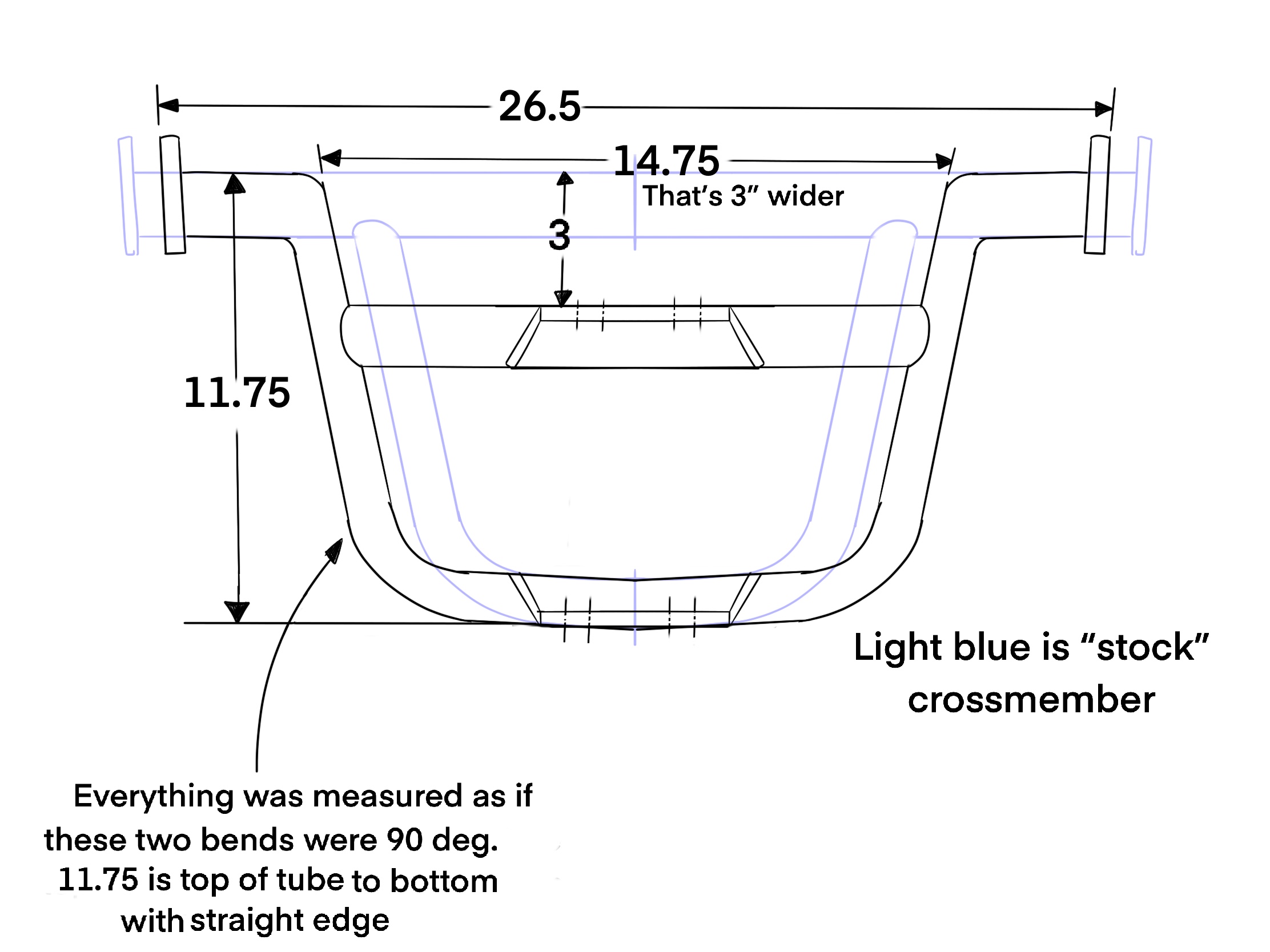

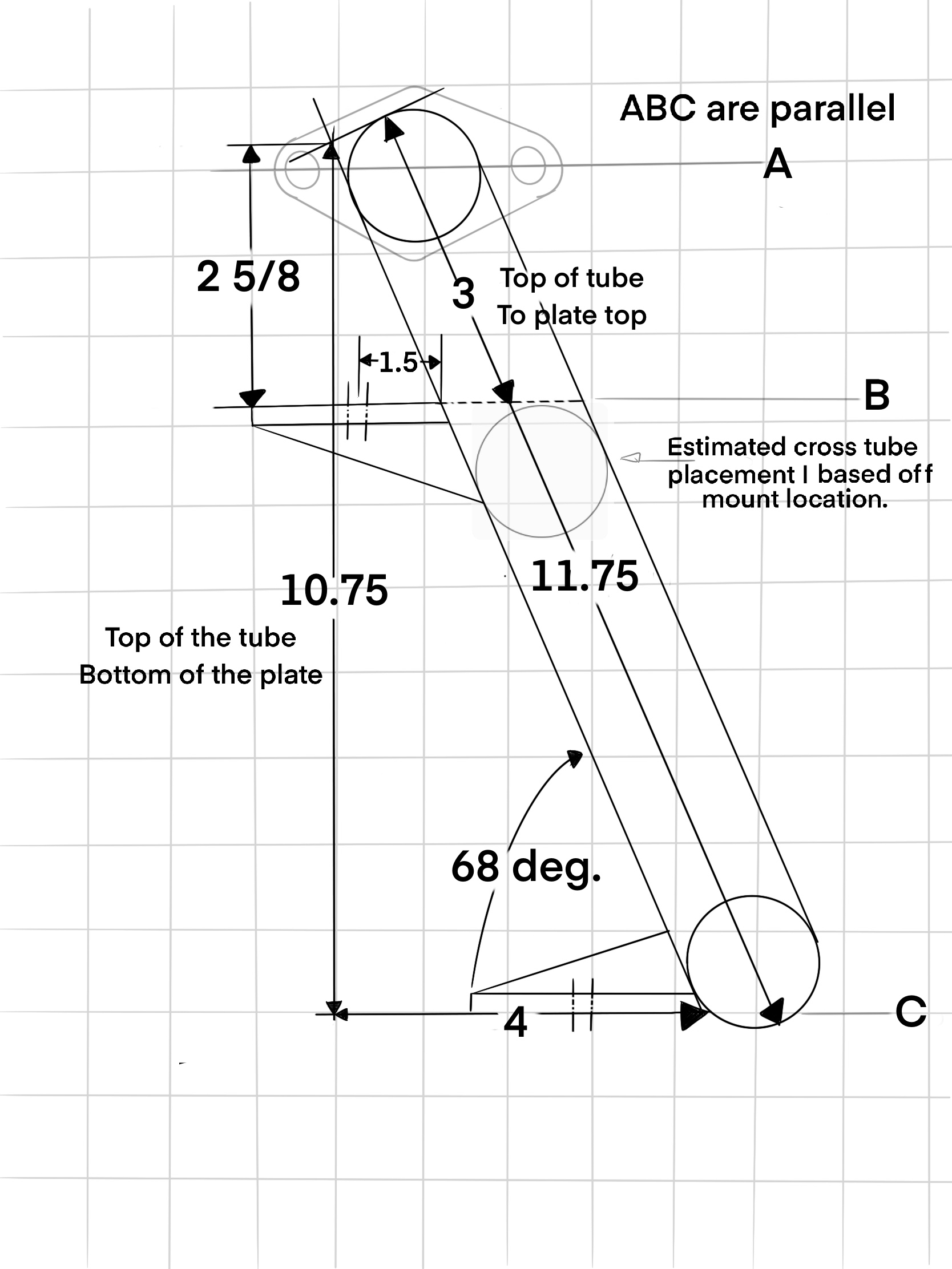

    Ok a little progress which sets me up for some real progress!
    few weeks ago I was up to my armpits in trans/ wishbone mount mockup, measuring and scheming. This is what I came up with. Untitled_Artwork.jpeg Untitled_Artwork.jpeg and now I’ve got it this far ready to fit and mock up in the car before welding solid. 76832831780__F926CD02-C05C-49F4-BD99-54DAD7FDA3FC.jpeg after it’s in the car holding the drivetrain I’m going to move onto ladder bars and then rear springs. I’ve been figuring that all out the last while and I’m thinking it should move fairly quick :)

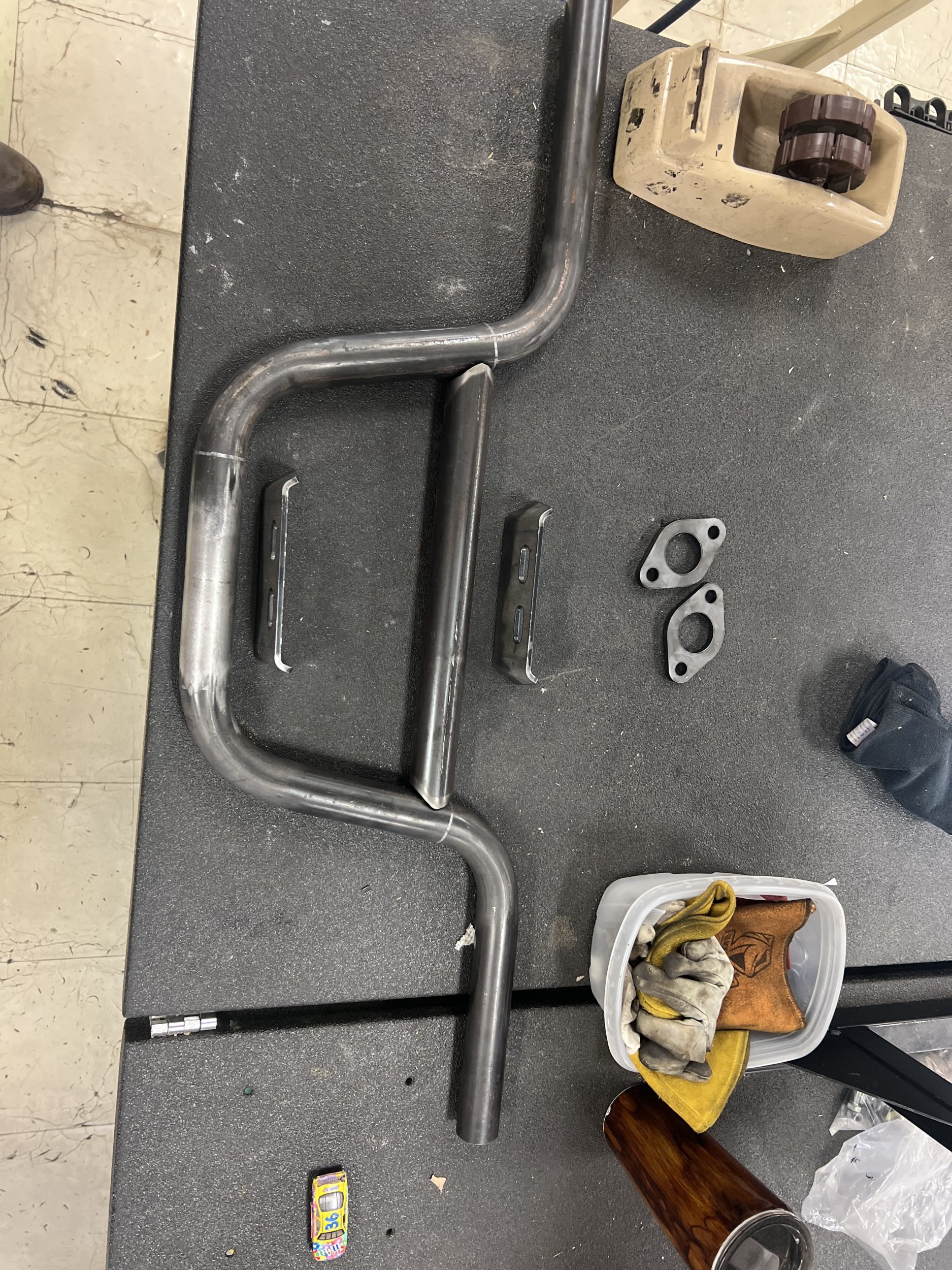

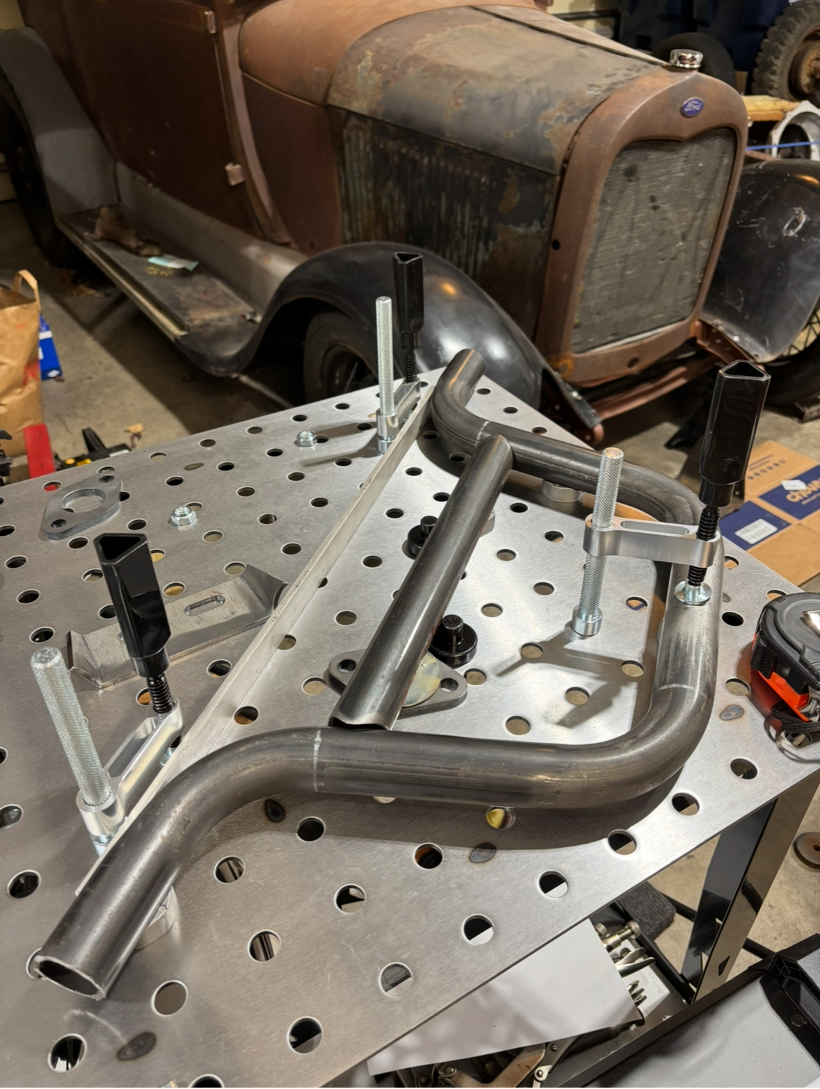

    IMG_0303.jpeg Got the width narrowed down enough to mock up but wide enough to have a lot of wiggle room with placement should my initial measurement be off or plan needs tweaked.
    Got the cross tube where it’s supposed to be and tacked. I’ll add the pads and mock it up on the car next.

    Nice table
    Six Ball and Bandit Billy like this.
  27. Tim
    Joined: Mar 2, 2001
    Posts: 20,384
    Tim
    from KCMO
    Thanks I really like it so far :)

    I have welding table envy
    Tim and Six Ball like this.

    I have one of those still in the box. I think I got it when you mentioned in earlier in this thread. I'm thinking I may just attach the top to one end of my ch***is table if I ever get to where I can see it.
    Tim likes this.

    It’s pretty light duty comparatively to a “real” fixture table but it’s perfect for what most of us are doing
