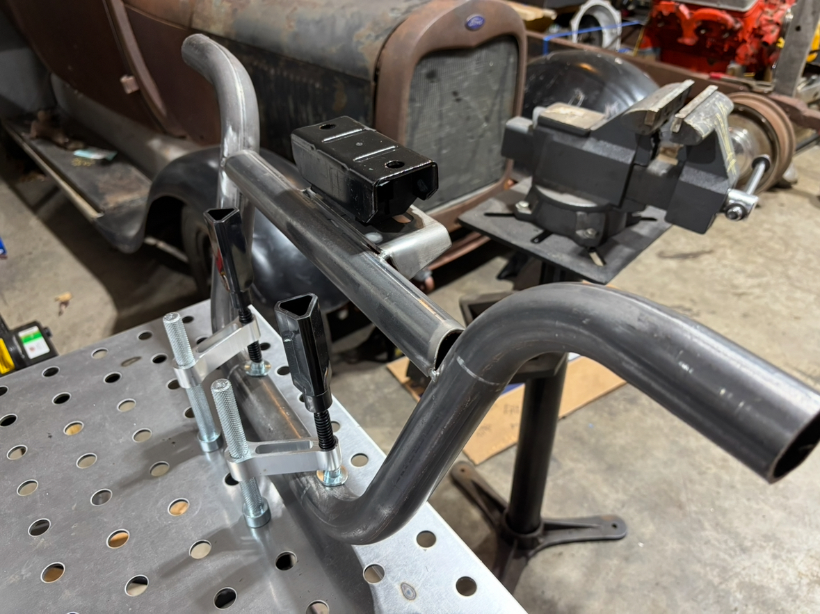

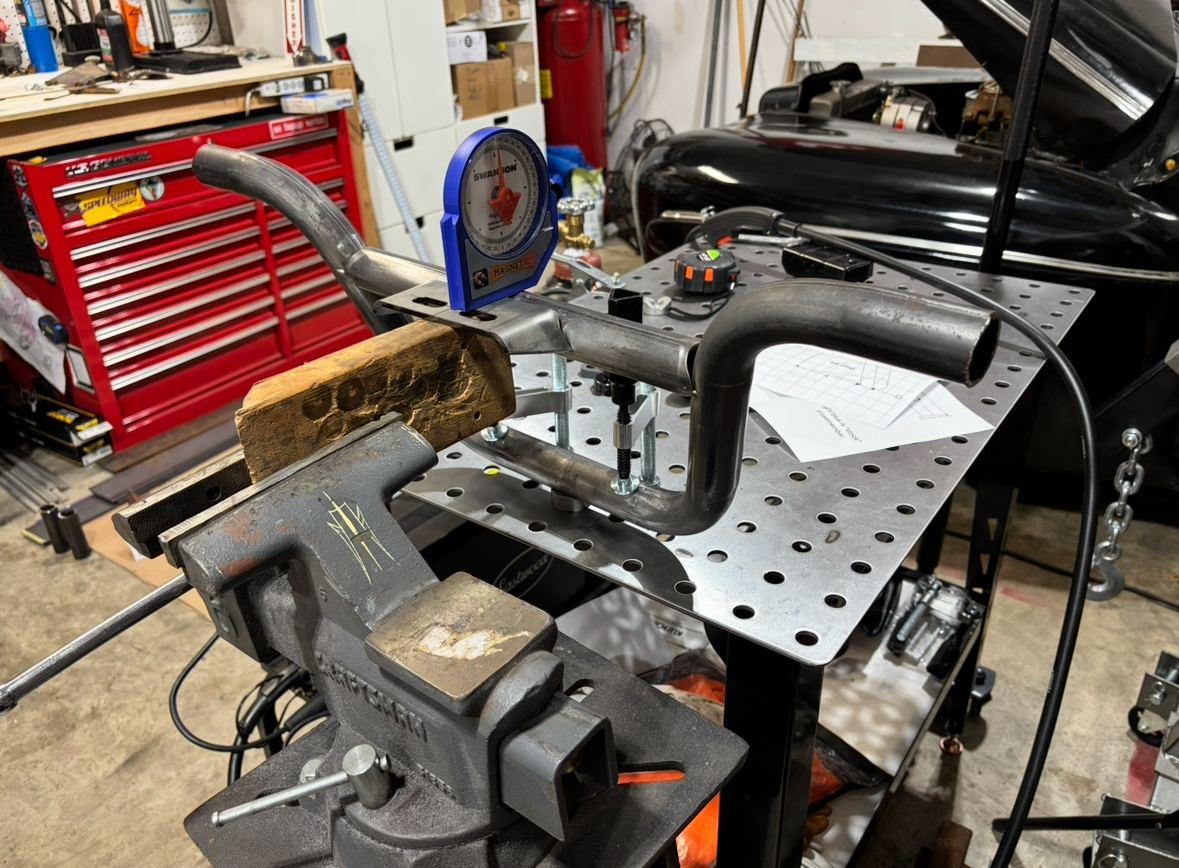

    Quick little update IMG_0336.jpeg got 99% of the bits and pieces I was still needing to swap the new rear axle and suspension home. Still need rear shocks but they are coming. Also got a fresh turned for the car. The one on it I had Pork and ****** narrow for me as a mock up for ever ago. It’s worked fine but it was never intended to be a real tie rod so I’ll probably prime and paint this and put it on next chance I see.
    I also am pretty dang close to final fit checks and welding for the trans/ wishbone cross member. I’m waiting on a buddy to modify the bracket I have to fit a wish bone ball and then I’ll get it on there and check it at as well.
    once it’s all on the money I’ll get the end flanges set. Everything cleaned up and welded solid.
    IMG_0338.jpeg This things pretty small. That t86 is pretty short and using the tail end mounting location puts it pretty for forward in the rails. I want to say after accounting for boxing plates and their placement this is only 27” wide over all.
    Feeling good.

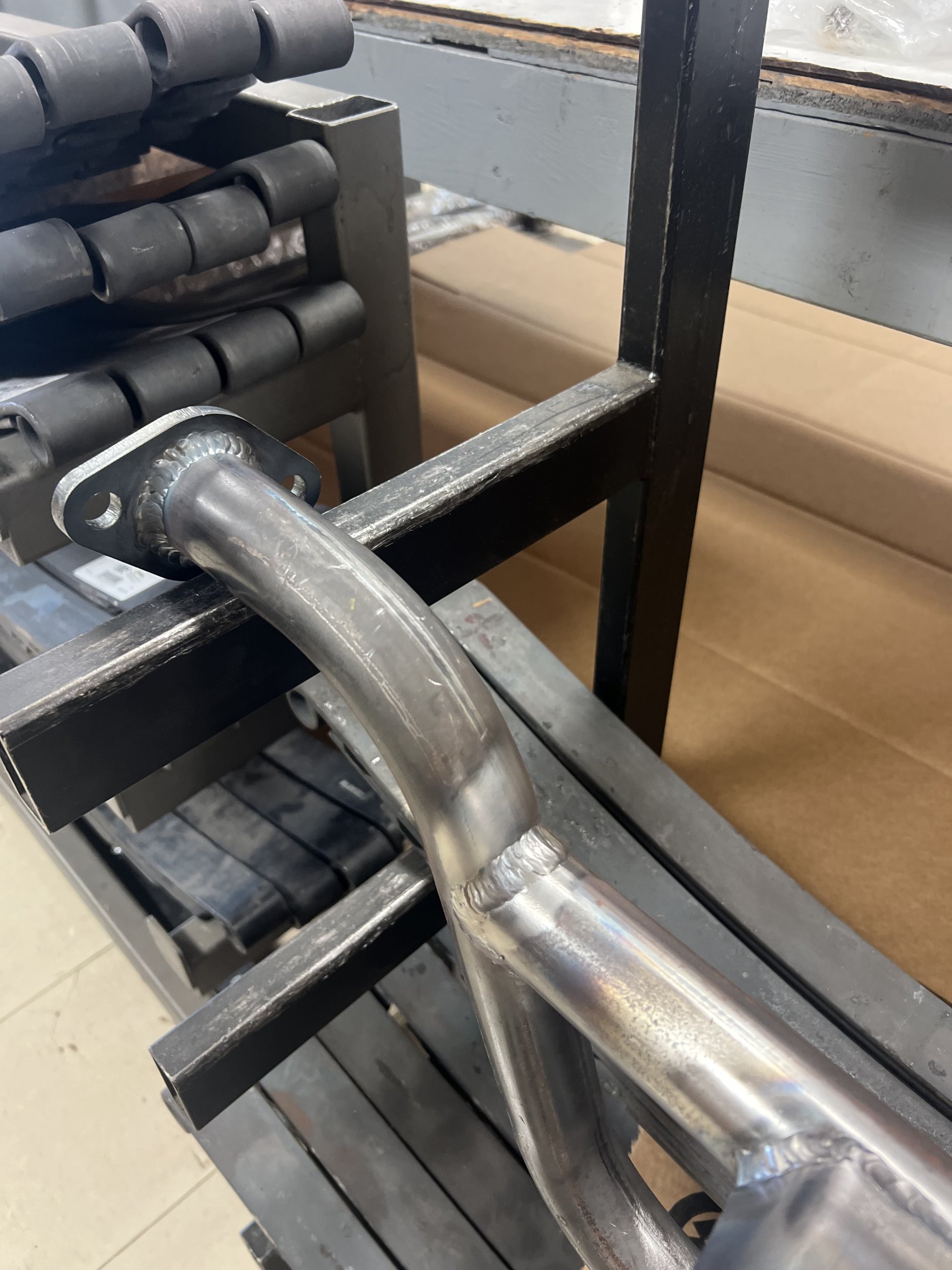

    Little sneak peak until I can go pick it up. Had a friend weld it up nice and stout. 77377392534__A58F9BCC-B218-4477-8B8A-0C92B9125F1E.jpeg you could build hot rods with out friends but it seems like you’d be missing out on a lot doing it that way.
    Also grabbed some shocks for the rear of the car!
    next on the que is get the parts car home for the roadster project and then get this crossmember prepped, primed, painted and bolted to the car. I’m really looking forward to this drivetrain being held in place with something other than stands :)
    Then we are onto ladder bars which should go pretty quick comparatively. I’m jonesing to see this thing outside again… and sweep under the car lol

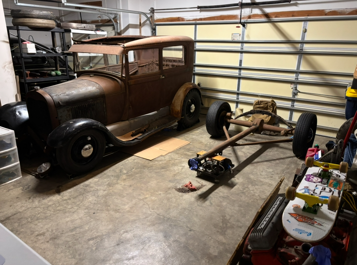

    Alright quick status update. Got the parts car for the roadster in and back out, still fussing with some of those parts and some 46’ stuff but with the school year about to begin I should have considerably more garage time available soon.
    Model A plan is currently to get the trans cross member painted and bolted to the car. Shouldn’t be a big deal. Clean the frame rails, clean the cross member, paint the cross member, trim some small boxing plates to bolt the cross member to, punch holes in them, weld nuts on them, put it all together and tack to the frame.
    Remove comical towers of jacks, stands, wood blocks etc. easy peasy right lol.
    after that is sorted I’ll move onto to swapping the rear axle and installing the ladder bars.
    I think the biggest time investment there is going to be measuring where all of this is going to land on the rear axle.
    I packaged it as minimalistic as I could come up with but it’s still going to be a spring hanger, ladder bars mounts, shock and pan hard bar clearance all between a pretty narrow rear axle.
