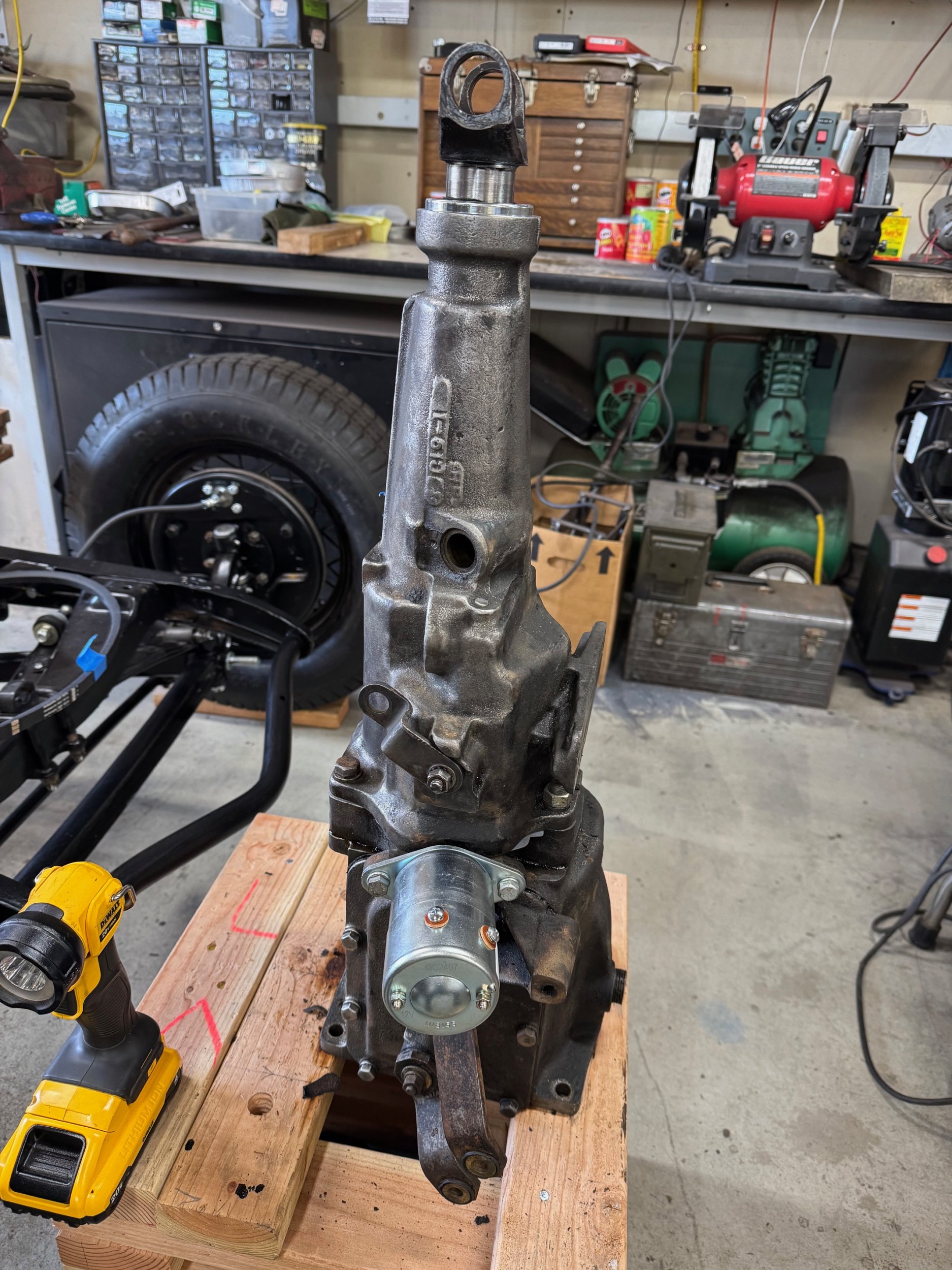

    @Six Ball surprising how little info I’m finding on the yokes. For as many vehicles that used these over drives I can’t find much talk about that specific bit.
    I was really curious if I could remove the bolt on yoke and swap a slip yoke in. That would simplify a fair amount.
    maybe I just havnt figured out the right search words or “stude speak”

    I sifted through a lot of stuff this afternoon and found a video of someone taking a bolt on yoke off a ramble with this trans/over drive and the end of the shaft is threaded. So the yoke is not held on with a bolt into the center of the shaft like a th400 some times has.
    So I think you’d need to get the exactly same trans, over drive and other parts combo except with a slip yoke and then swap that shaft into your existing trans/overdrive set up.
    Im thinking for trans parts, a slip yoke, u joints and a drive shaft that $280 for a slip shaft with joints sounds like a much better deal.
    Though I am thinking that they probably don’t want you installing them at their full extended length so the one I found in the previous post is going to be to short. I’ll have to sort through a driveshaft website or something and find a donor that’s longer that I can cut down.

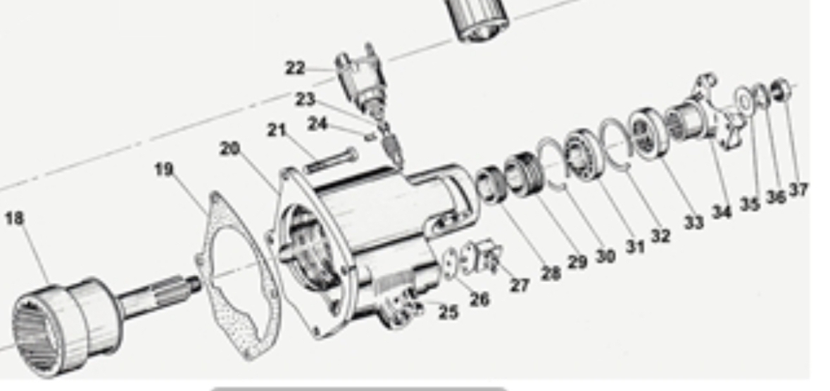

    I have an OD trans from an early 60's Lark V8 that has a yoke for a driveshaft (attachments). It looks to me like your trans could be from a C/K body Stude that used a 2 piece driveshaft or a truck as you said. stude od 1 (1).jpg stude od 2.jpg

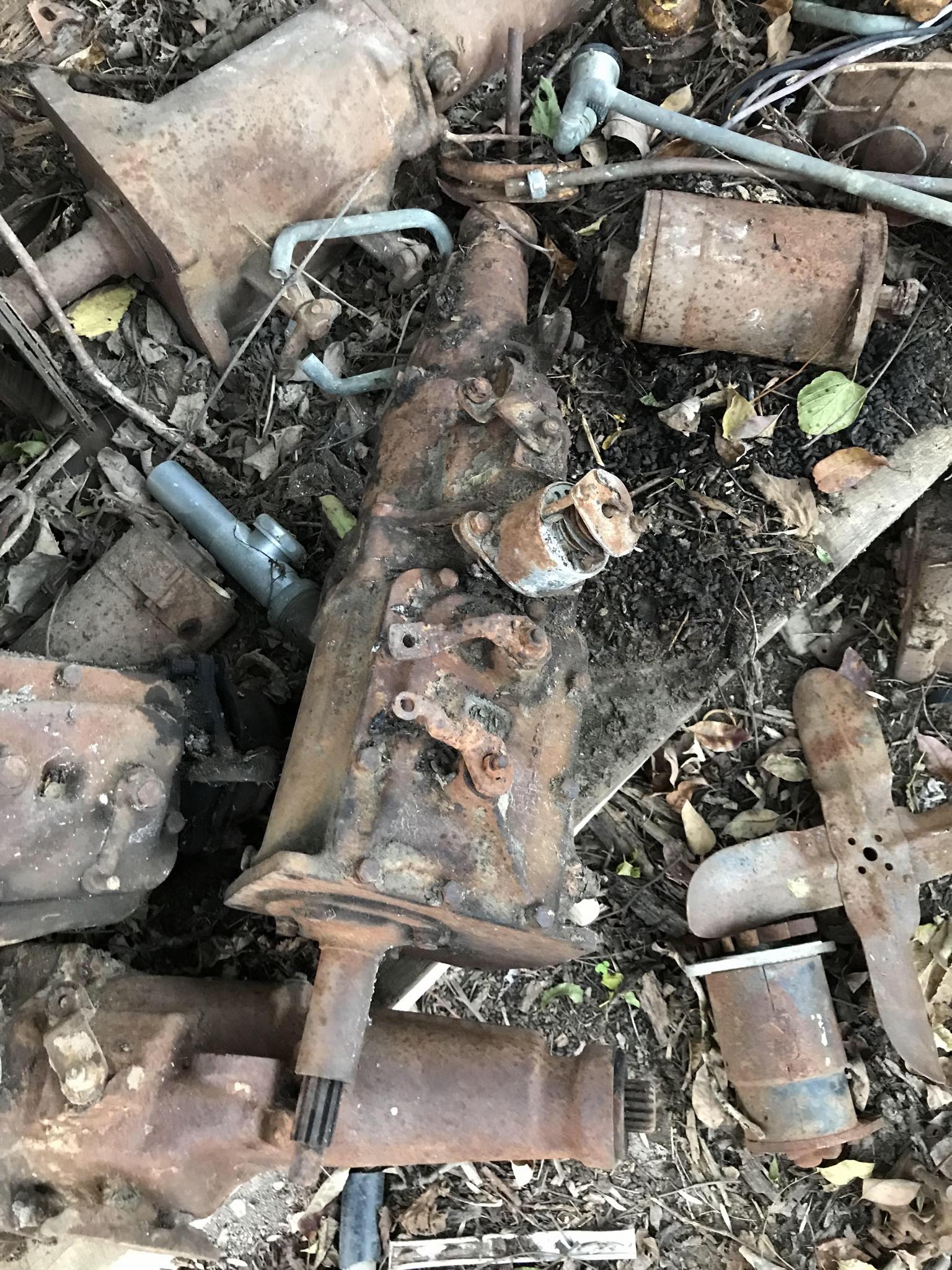

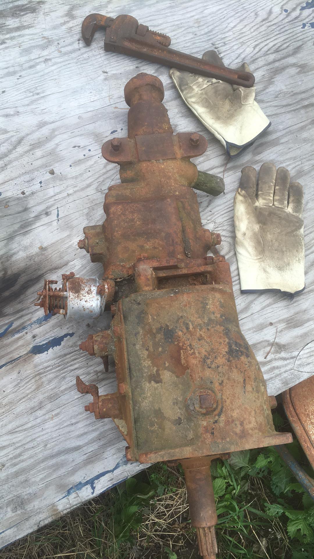

  19. So wait would early flathead 3 speed with od transmission parts help? I actually have access to a couple

  21. I'll message my buddy. He had like two or three of them
    Stogy likes this.
  22. I may have a pic. I know they'd need love so definitely parts transmissions
