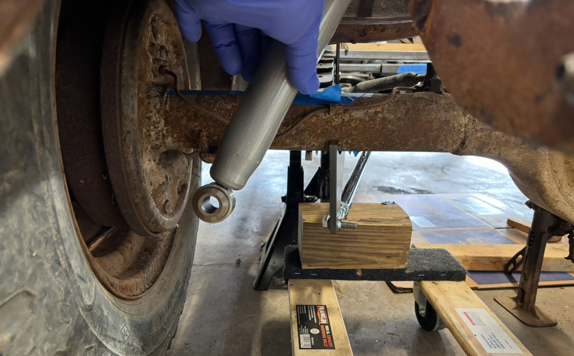

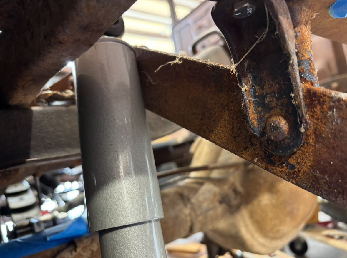

    My original plan of shackle mounted lower shock mounts is not going to work. There just isn’t room. But I think this latest idea will work. I’m
    On idea 4 or 5 for lower shock mounts lol. The ladder bars, spring mounts, shock mounts, pan hard bar all want to be in about a 5” space.
    Being careful to make sure nothing will hit each other and you can get hardware out of each thing with out taking something else apart to get to it. Some times it’s unavoidable but most the time I think there is a way.

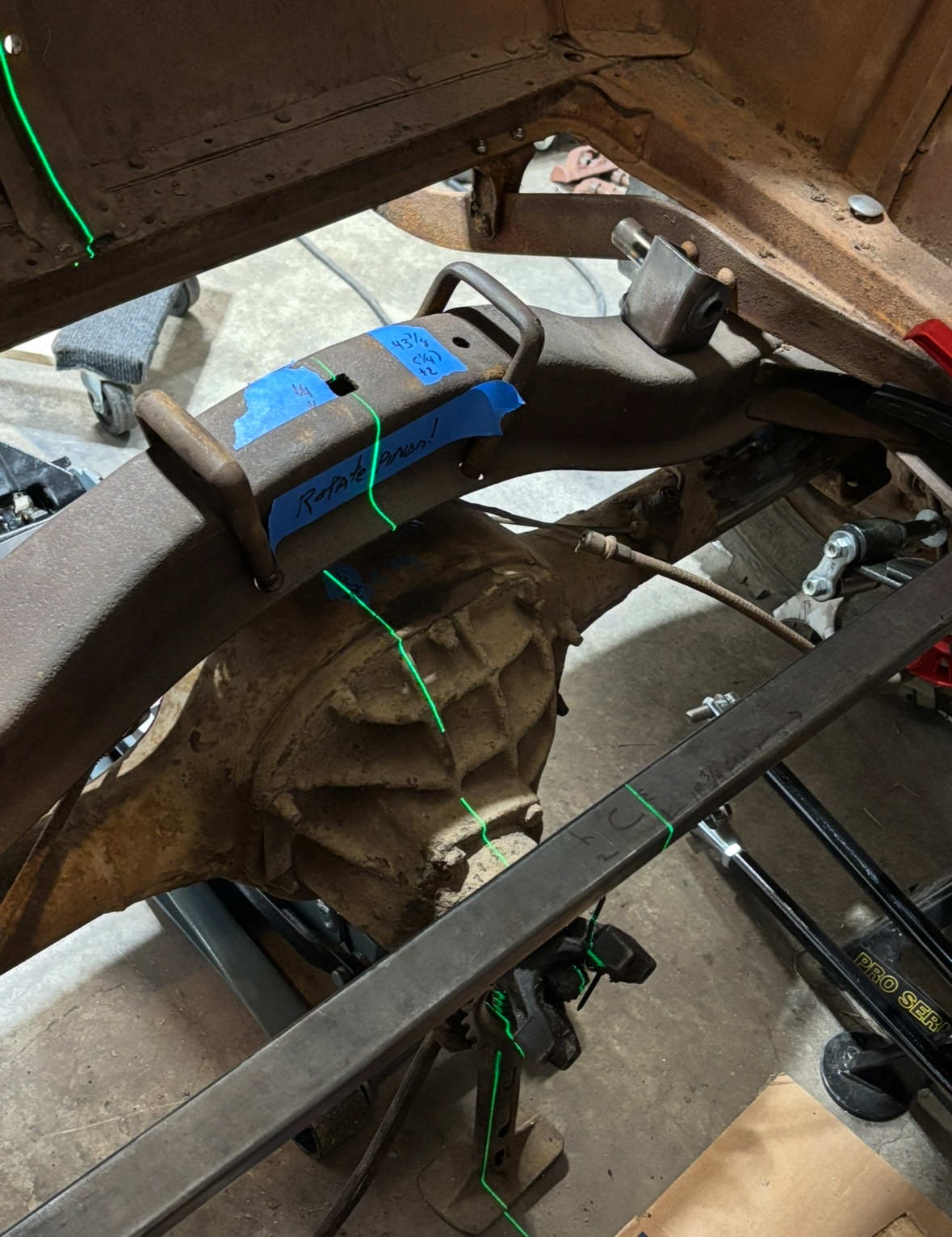

    Alright update with photos!
    I think I got about 15 hours in this week and I’m maybe a day away from really being somewhere. And maybe two from having this end wrapped up. IMG_2244.jpeg the four bar and 1/4 spring axle brackets got mocked up on the p***enger side a few times. Making sure they cleared threw full range of motion and I can remove hardware with out havjng to move anything else.

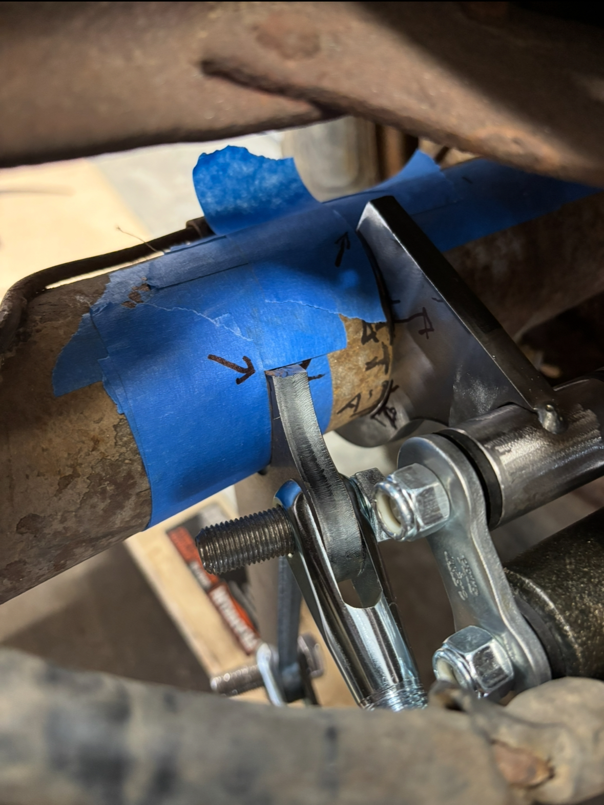

    I need to change to a normal shackle as the idea of a lower shock mounted off the extended stud in the shackle won’t work. There just isn’t any room and if there were it’s to high up anyways. When I do this I’m also going to swap the flat side of the shackle towards the ladder bars. It clears with the nuts with more room that appears in the photos so I figure with the nuts on the other side I should be set. IMG_2245.jpeg IMG_2246.jpeg when I grab the different shackles I’ll exchange this pan hard bracket. Ended up with one for a 9” not an 8” but it’s good enough for a mock up. Looks like it should work just perfect. Nice and horizontal and threads the needle wonderfully. IMG_2247.jpeg IMG_2248.jpeg IMG_2252.jpeg this is my current thought on shock placement. I really wanted them on the front side but there’s only so much room. If I was really dead set on a clear rear view I could have used lever shocks, mounted the lower end of a tube shock off the ladder bars bracket or even laid the tube shocks flat and used a pivot. What I decided was to run them in the back as clear and simple as I can. There’s no need to over complicate it when there’s an easy option.
    info use a bracket similar to a 50’s Chevy pickup mounted to the existing spring pads I can snake the shock between the body and the rear bumper mounts to a mount welded to the top of the rear cross member and land around 20* which seems pretty acceptable to me. I may have to re work the bumper brackets for clearance but I think I’m going to end up cutting them up a little bit
    To change how they mount anyways so that’s no issue. IMG_2249.jpeg Pulled the axle out and cleaned / made brackets and the tube and put it back together with both sides mocked up. Spent over an hour getting the wheels centered in the wheel wells- glad I made so many registration marks for my laser level! I also spent a lot of time getting the axle centered in the ch***is which was a lot of frustration. Every time you tweak something it all moves a little bit somewhere else . I can see where ch***is table with a fixture to hold the axle solid in relation to the frame would be a real time saver. Maybe in the future I’ll build some stands that bolt on in place of the wheels? That could be a good work around as well.
    IMG_2250.jpeg So there we are ladder bars and quarter elliptic springs aaaaaaaalmost done.
    I think I’ll have about another day in making sure everything is exactly correct and tacking them in place.
    Then I’ll take the axle over to a buddy to tig the brackets all on 100% nice and solid. He does this work all the time so I feel a lot better about having him doing it and knowing it’s correct.
    once that’s done I suppose I’ll gather hard ware, put the axle in the car and get the pan hard and the shocks on.
    Im going to get the correct height tires swapped into these steel wheels as well.
    probably another week of work if I’m being hopeful. But the back will primarily be done then.
    It wont look any different but I’m really looking forward to the next time I get to push it back outside. Hopefully with the rest of the front end work done it’ll be a little easier endeavor than the last time.

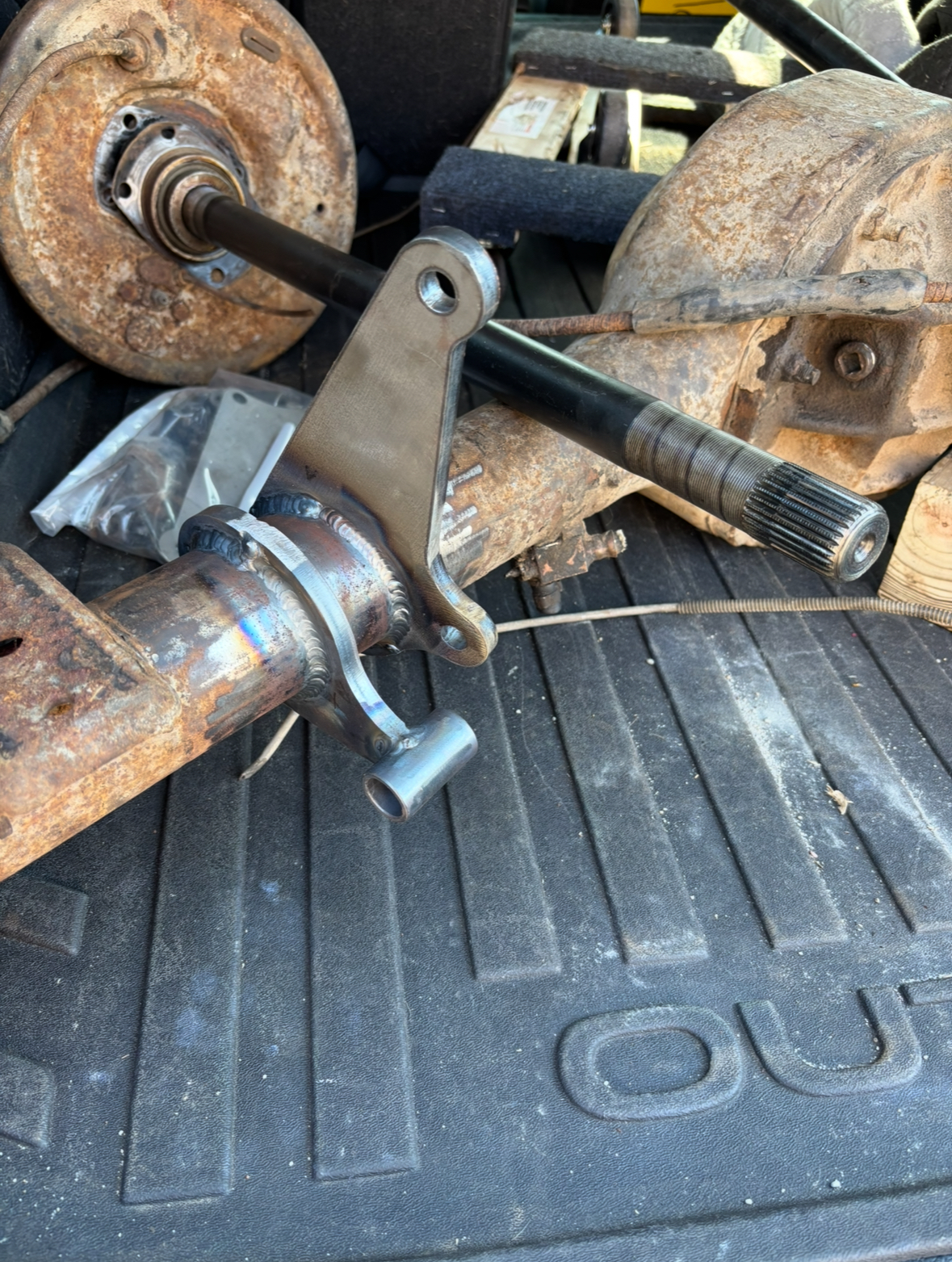

    Decided it was as close to right as it was gonna get and got everything tight and tacked it all.
    got the big half of the spring hangers and ladder bar mounts tacked to the axle and the boxing plates that mount the spring hangers temporarily tacked in place. IMG_2293.jpeg muscling the rear into my daily in the morning and taking it to a buddy to tig it up nice and strong.
    He’ll probably have it done before I have another garage day available. Then I’ll put it back in and get the back half ****oned up. I’m feeling like this is really a turning point and once it rolls and steers like it’s supposed to the rest is the down hill.

    Well the axles done! Didn’t even get the tie downs out of the car yet lol. Gonna go grab it Friday

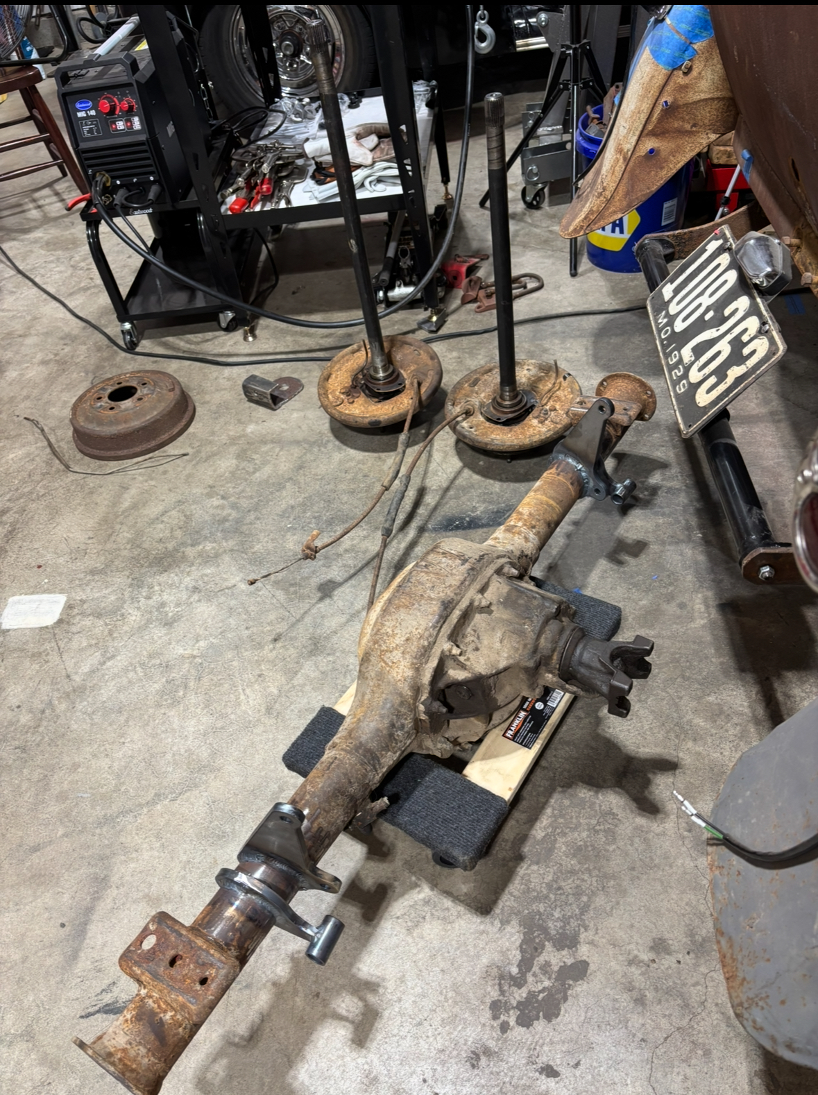

    IMG_2332.jpeg Picked the axle up this morning on my way to work. It’s not on the way in any stretch of the word but a guys gotta do what a guys gotta do lol.
    he pulled the axles and mostly drained it to weld it up. I’ll take the opportunity to clean up the backing plates and axle ends and get them in some primer before it goes back together.
    It’s going to come back apart for some 4:11’s but who knows when that’ll be so I’ll dump some gear oil back in it in the mean time just for peace of mind.

    Sure is a lot easier to move around with the axles out! IMG_2356.jpeg got it unloaded. Got about a week until I can fuss with it. But it’s a big step forward :)

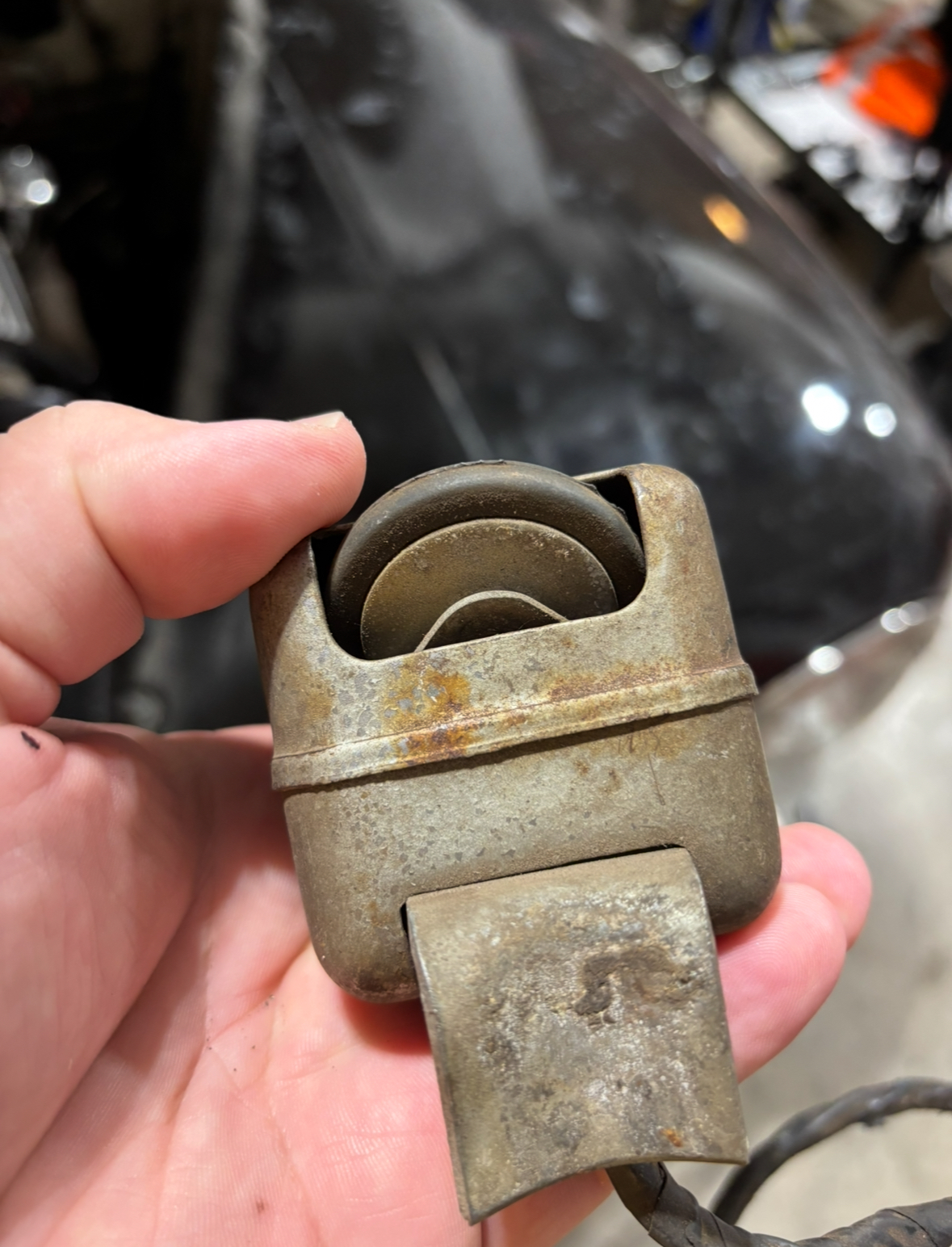

    On the note of optimism I saw in my binge reading of his champ car build @THE FRENCHTOWN FLYER had made a list of what he got done on the project at the end of the year.
    I’m a list guy but they are rarely one that looks back. I think that’s a great way to end out the year. Once it’s all on paper you can see that you did in fact get a lot done!

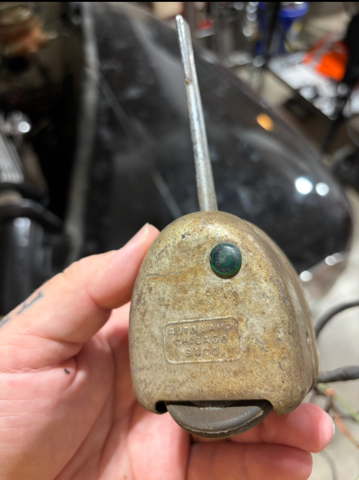

    Since I'm posting switches this is my turn signal switch. Pretty neat little self canceling unit. I believe I’ve seen guides on rebuilding them here on the hamb but from the looks of the wires there’s a good chance it looks ok inside. Guess we’ll see when the time comes. Anyone mess with one of these before? IMG_2464.jpeg IMG_2465.jpeg IMG_2466.jpeg IMG_2467.jpeg
    winduptoy, porkshop, Thor1 and 4 others like this.

    Neat! From what I can tell
    They are 12 volt and wire pretty much like the switch in my 46. I’m ***uming anyways considering every 9000 diagram shows a switch that looks more like my chrome one in the 46 than this one lol.
    I was curious what kind of bulb it uses but I guess if it works it works and if it doesn’t maybe it’s got a marking I can search and find a replacement.
    visually the plan is to clean it up, polish the lense and arm and paint the body. Everything else is gloss black but part of my brain is saying this would look cool in gray hammer tone.
    haven't mocked it up I hope the wheel will work with the 4 spoke I have on it.

    How many wires come out of this switch? I had to use a trailer adapter on a model A that was using 37 taillights so both didn't blink when using the turn signal.
    winduptoy, porkshop and Six Ball like this.
  30. Tim
    Joined: Mar 2, 2001
    Posts: 20,428
    Tim
    from KCMO
    I believe seven?
