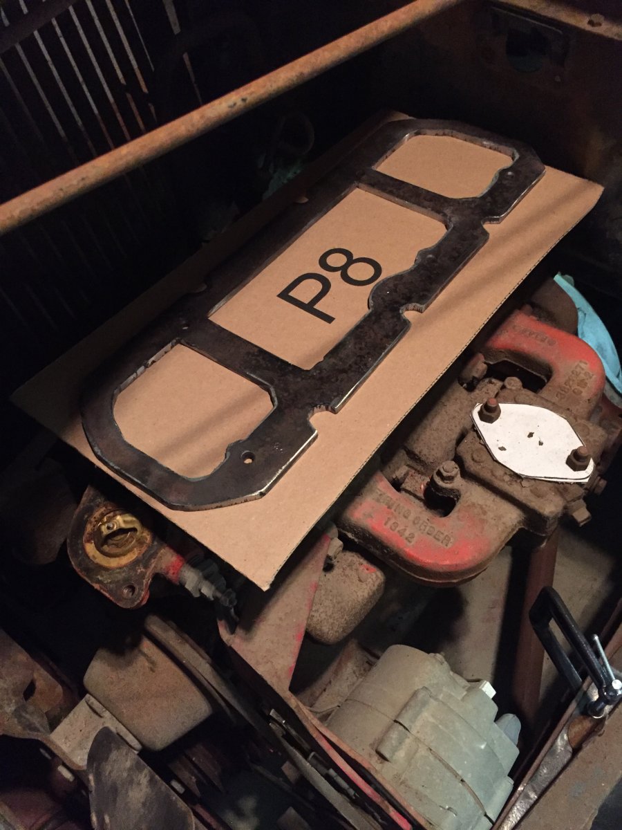

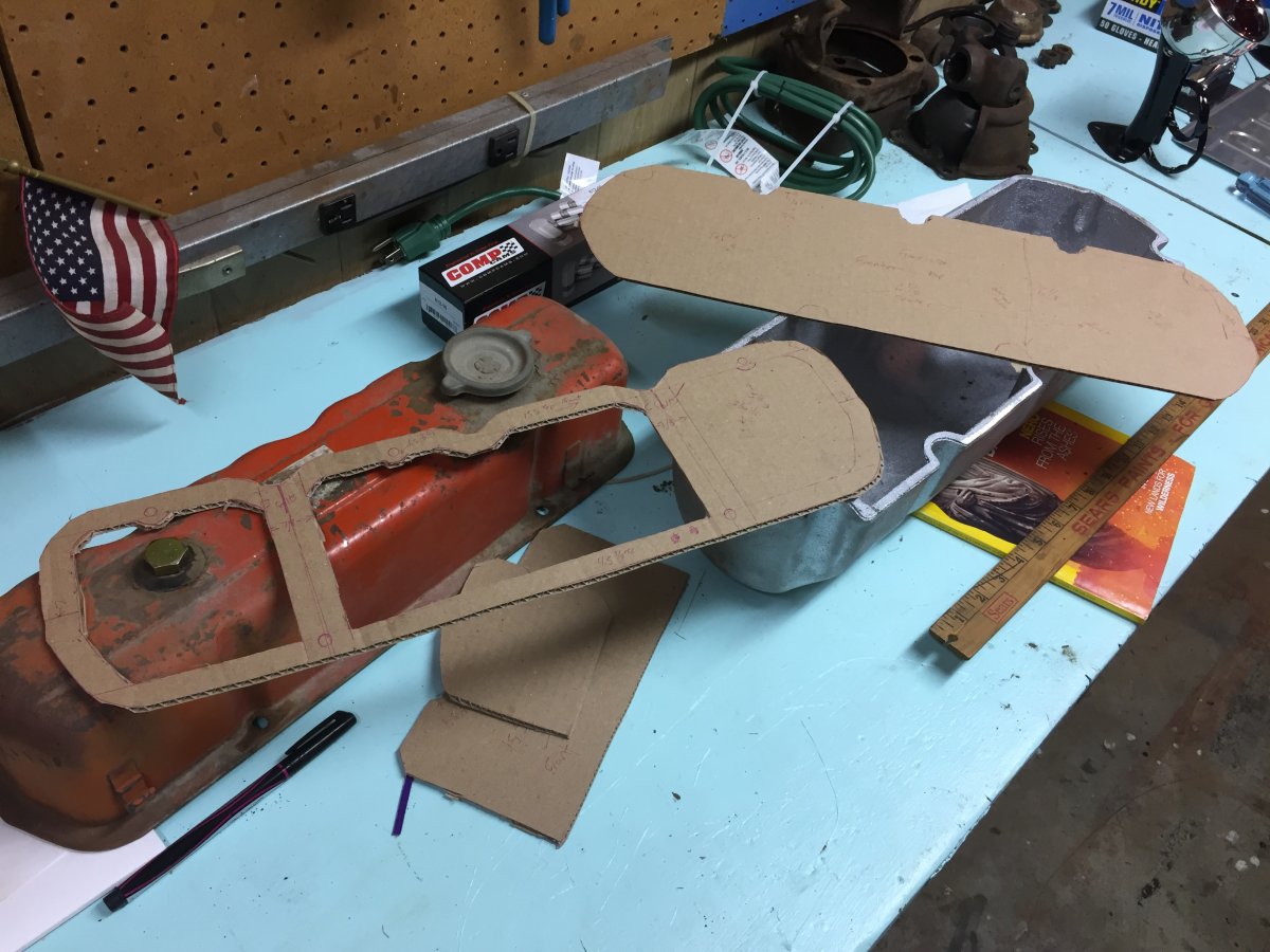

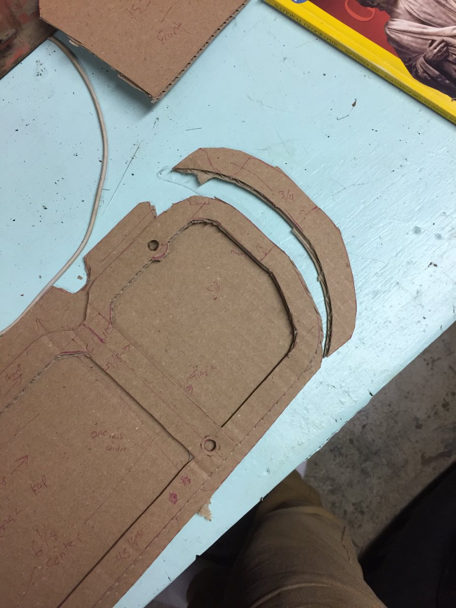

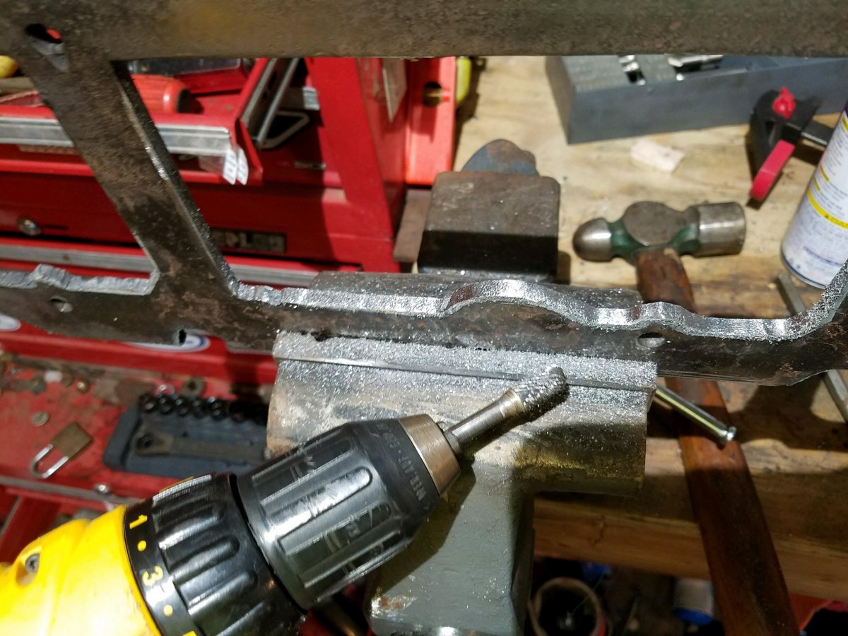

    Ok so I'm not done with it but it's turning into a lot of photos so I'll post them and you can get the jist for now.
    IMG_8195.JPG IMG_8164.JPG IMG_8165.JPG IMG_8169.JPG IMG_8118.JPG IMG_8120.JPG IMG_8121.JPG IMG_8500.JPG IMG_8502.JPG IMG_8325.JPG IMG_8326.JPG IMG_8327.JPG IMG_8328.JPG IMG_8329.JPG IMG_8666.JPG
    waxhead and Tuck like this.
  7. Tim
    Joined: Mar 2, 2001
    Posts: 20,782
    Tim
    from KCMO
    Ok those loaded out of order so I guess I'll explain a little.
    1: make cardboard template of each valve cover foot print
    2: lay them on top of each other and make a single one
    3: bolt it on and realize the fronty needs to be 3/4 shorter
    4: make a new cleaner one from stiffer thinner material
    5: mark it all out on 1/4 plate
    6: use a cut off wheel
    7: use a torch
    8: clean it up
    9: test fit and figure out how much of the water neck/ thermostat housing your going to have to grind off. It's supper beefy and even the stock tin valve cover s****es to fit on. These are what I ***ume are BBC rocker arms and don't leave a lot of room for dancing around.
    Post hamb drags the plan as of now is cover the motor and prune the bits that are in the way. Then test fit the plate and refine it, further clean it up. And then take a band saw to my nice Frontenac cover and cut it in half about 4/5 to the front and remove a 3/4 inch and stick it back together.
    Weld a nut on the cross overs in the plate we are making, drill corresponding holes in the cover. The idea idea is to permanently bolt the plate to the head and the. Sit the cover on top, then thread some all thread in from the top and spin a wing nut on to hold it together.
    There's more to it but that's the jist.
    I can't install the threaded sections and sit the cover down over it because of the way the motor is tucked back into the big divot in the fireball . So that's why the procedure. I'll probably slot the top of the all thread so I can crank it down with a screw driver before I wing nut everything.
    Dannerr, redzula and Tuck like this.

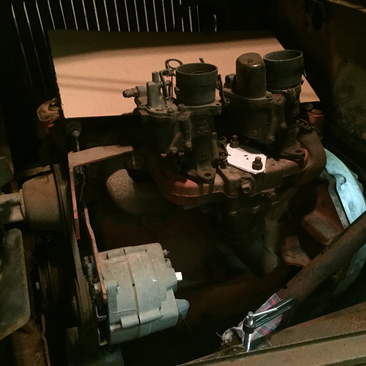

    910CED92-9BEF-4B74-96C3-95EE81D987CB.jpeg Not much new. The 46 got banged up some so I’ve been focusing what time I have in the garage on getting that back together.
    Did bring home some more parts though and start mocking them up a bit.
    Got some hanging pedals for the clutch and brake, leaning towards dual 40-8 masters instead of the Chevy truck stuff, the correct pressure plate for the swap, a hopefully better hood a steering column and box and a few other Knick knacks.
    I shoved the 38/9 truck column and box into the car and it seems like it should fit perfect but I need to cut the tank out of the cowl to clear the column support before I know for sure.
    And I need to replace the subrails before that or at least get it braced up.
    Just pickin away and day dreaming

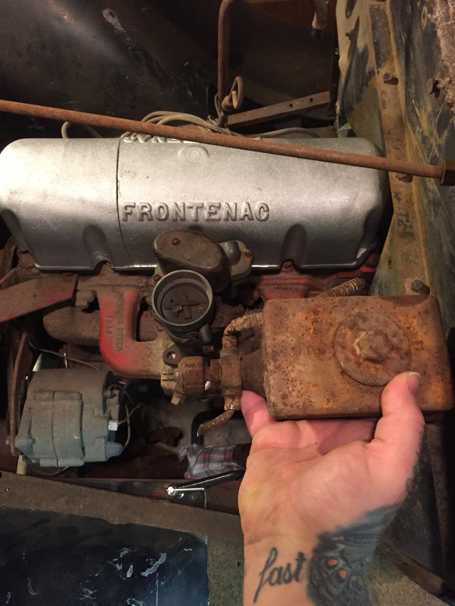

    Little photo update of not much other than thinking.

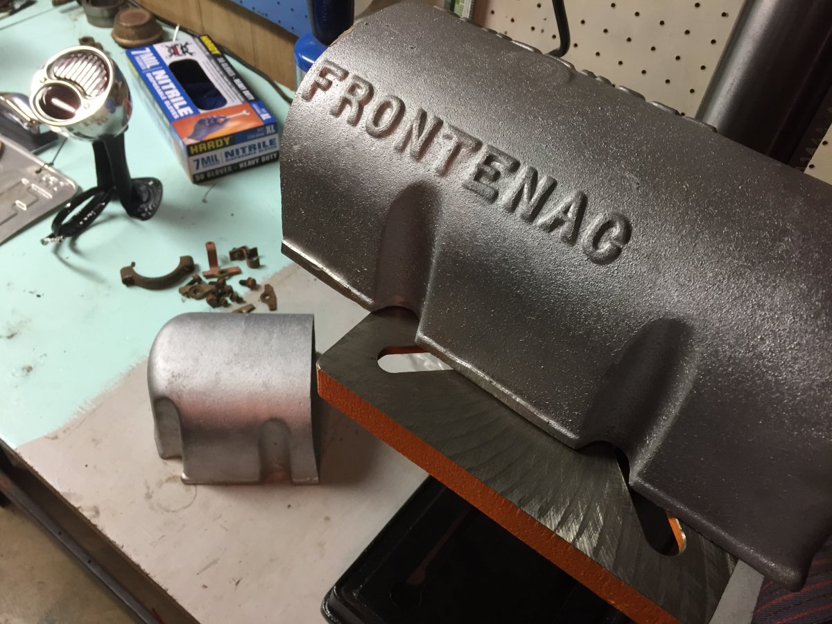

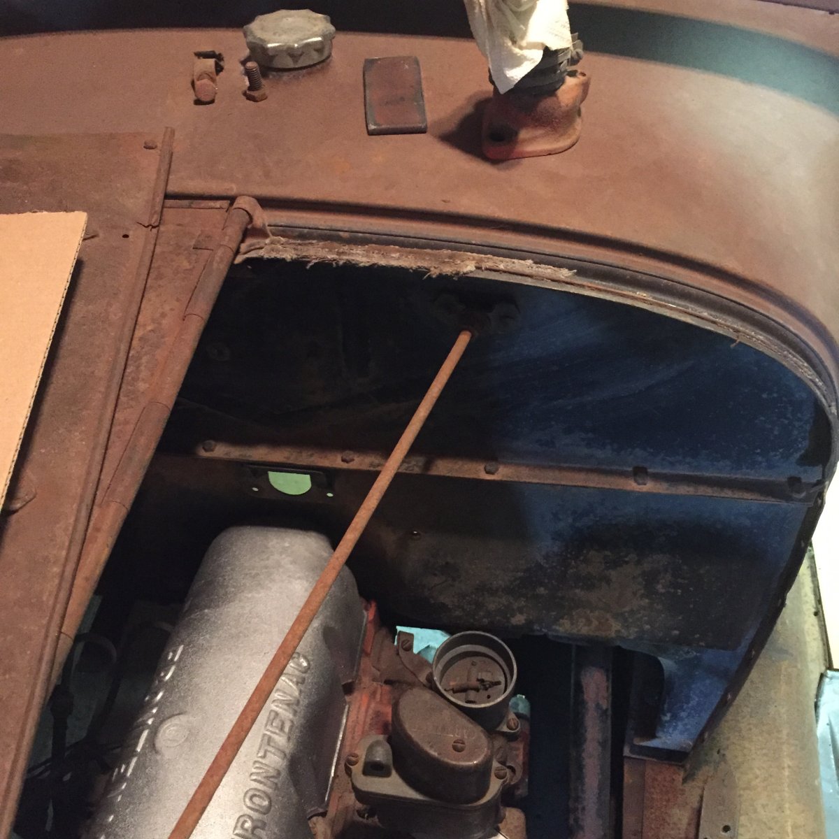

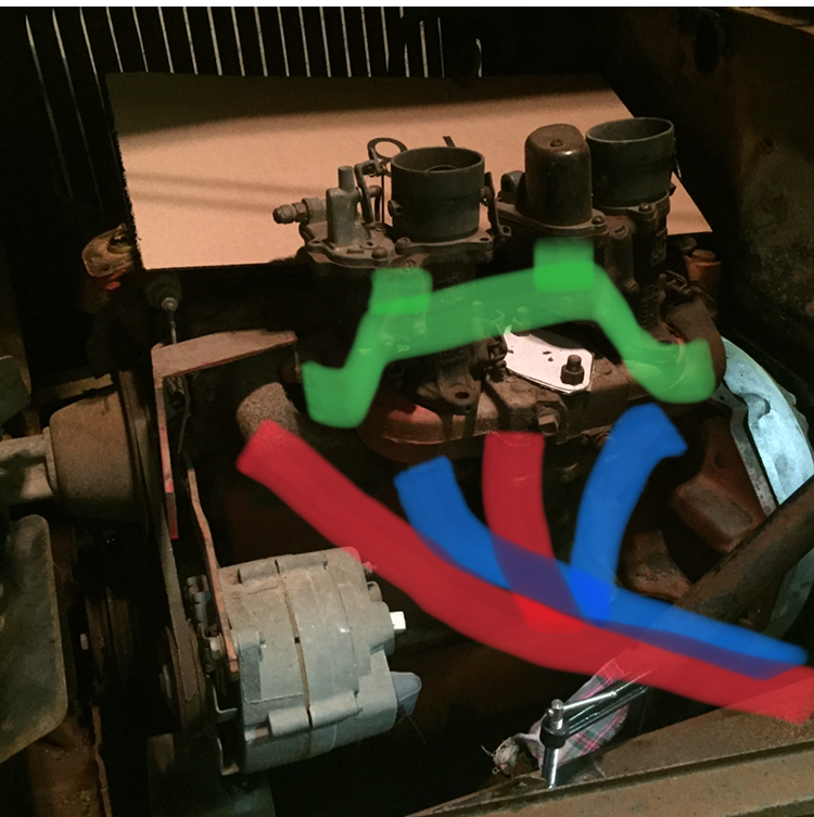

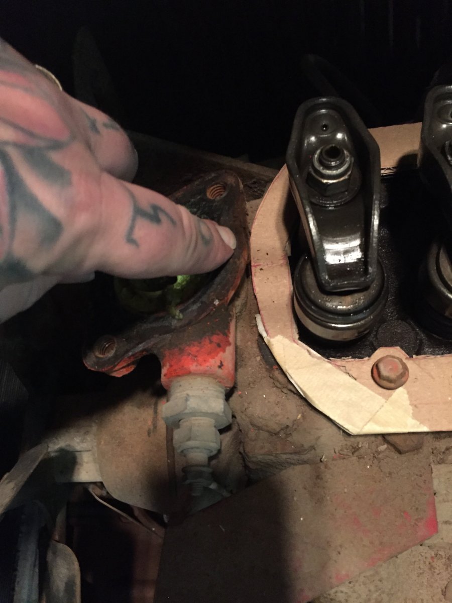

    Valve cover adapted keeps getting whittled to fit, I chopped the cover in half to get over the scary part of fitting it and that’s about all the physical progress that’s been made. Unless I hadn’t mentioned putting some dropped tie rod ends on the steering arms to clear the wishbone...
    Anyhow real quick ramble while the baby sleeps. I’ve been really trying to accomplish the same ideas with everything I do on this build.
    Make it simple, make it strong, make it easy to work on.
    So I foresee a ton of mock ups in my future. If the cover fits the motor but I can’t remove it with the motor in the car or with out removing a bunch of stuff then the only person to blame is me.
    I want to be able to remove the master cylinders, exhaust, intake, valve cover etc with out removing anything else. Or having to remove something so I can get at a bolt.

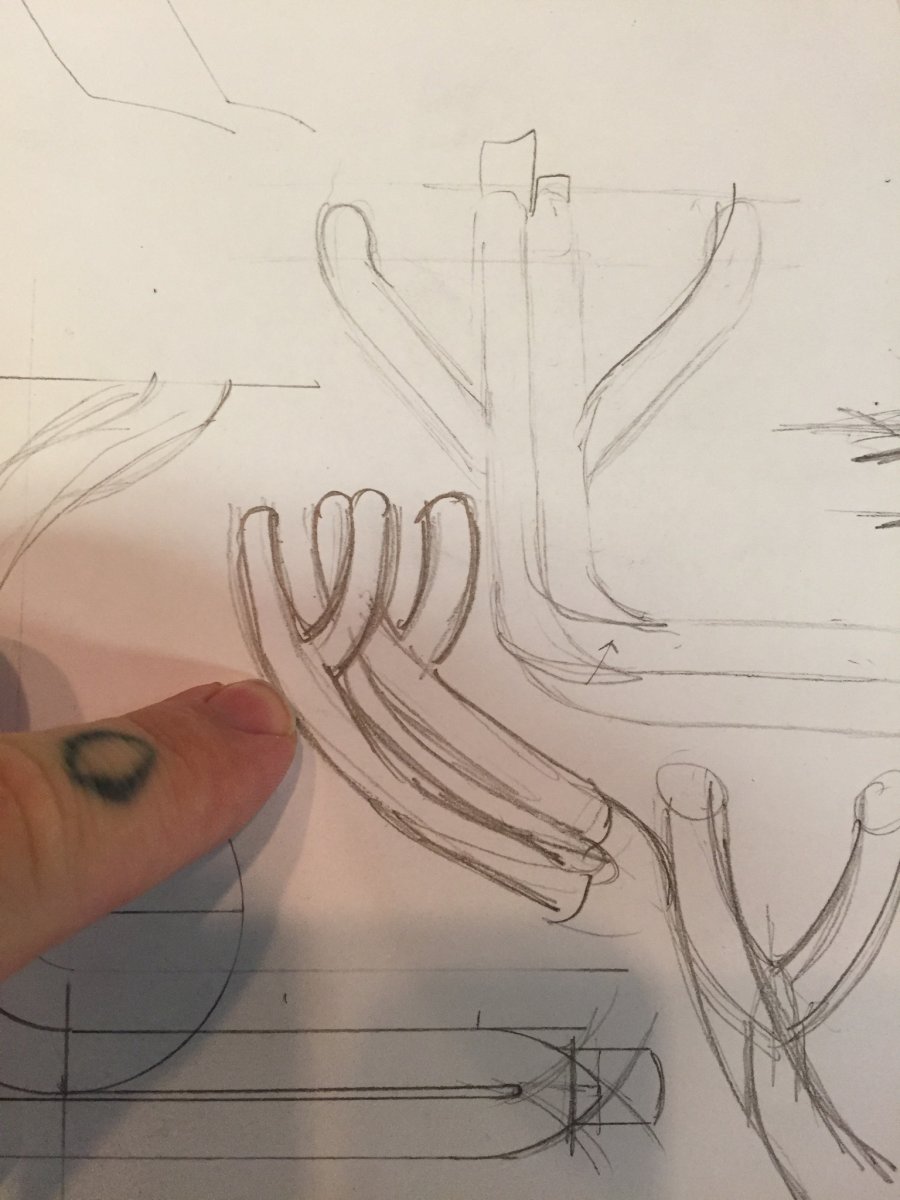

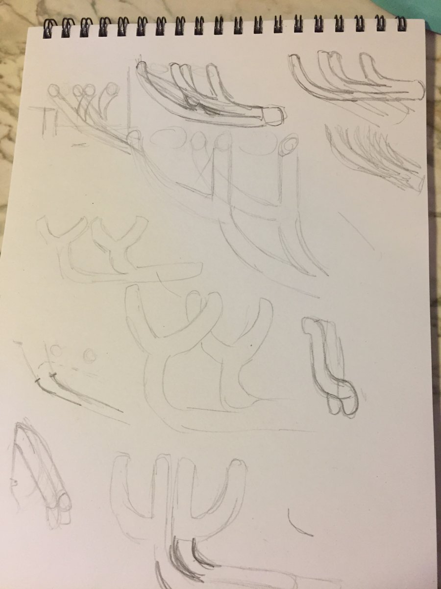

    Anyhow here’s are some photos of stuff cut up and scribbles/ inspiration photos of headers and intakes F5CA401E-7EF7-44AD-B079-CAB2C65B737D.png 987B3F7E-916E-41E0-A86E-561300AF5A8A.jpeg this is actually an idea I wanted to get on paper before it got lost to memory lol

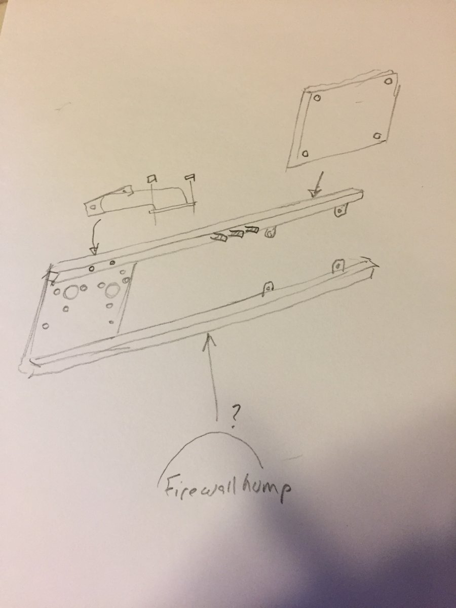

    It’s two lengths of 1x1 square tubing that would run along the top half of the firewall from Cowl side to side.
    On the drivers side a piece of 1/4 plate is flush welded with the back side and is drilled and tapped for my knock off ansen pedal set up and for the 40-48 masters. So I can bolt the pedals and masters on with no nuts and not have to worry about duct taping the nut to the firewall while i try to screw a bolt in.
    Thought about doing a beveled/ counter sink to help start the bolts even.
    Above that you see two threaded holes that the above drawn dash/ steering column brace would bolt into
    On the p***enger side are 4 tabs with captive nuts or threaded holes and a 3/4 price of marine grade plywood would bolt to it. Maybe little threaded top hat inserts in the wood so I can skip a washer?
    The fuse panel would bolt to that wood and it would all tuck back to the firewall nicely
    The studs to the center are threaded lugs for grounds. I figure I can weld or even cable to ground this structure all to the body and frame so I don’t have to question a good ground source
    Add to that I can add threaded holes or tabs to mount my pivot for throttle linkage or pedal. From inside or outside the firewall.
    The hump I drew below indicates that the 28/9 firewall does have a big bulge I would need to work around. It’s not a totally flat firewall.

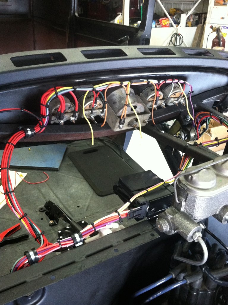

    Im also considering using some weather pack type connectors to make some wiring a little easier to keep clean or remove parts.
    mainly thinking for all the gauges. I could wire the entire dash all nice and neat on the work bench, locate a connector in the appropriate spot and then bolt the dash in and plug the wiring in. Bam it’s done and tidy.
    It does mean one more connection in the line that could be an issue later but I think the percs probably out weigh the possible issues.
    Anybody have any experience with that sort of product?

    Obviously; it is your choice; but adding connectors, etc seems like way overkill and just extra work; since the wiring itself on a basic hot rod is so simple.

    We use mostly Deusch connectors at this point for a good connector that is sealed. Our application is, however, a little more severe than what is on most cars since it is on equipment that gets used in environments that are prone to more dust and/or water intrusion than most cars would see.

    I’m mainly thinking for the dash. I’ve got big hands and behind the dash of a model A is gonna get real cramped real fast. So if I can wire all the gauges and lights on the bench, put it in the car, and just plug it in that seems like a good idea.

    Just wire it before you put cowl top on; chances are you will never have to touch it again. If you did, it would only have to be a single component, whether it be a bulb, gauge, or switch.
    Dannerr, brEad and kidcampbell71 like this.

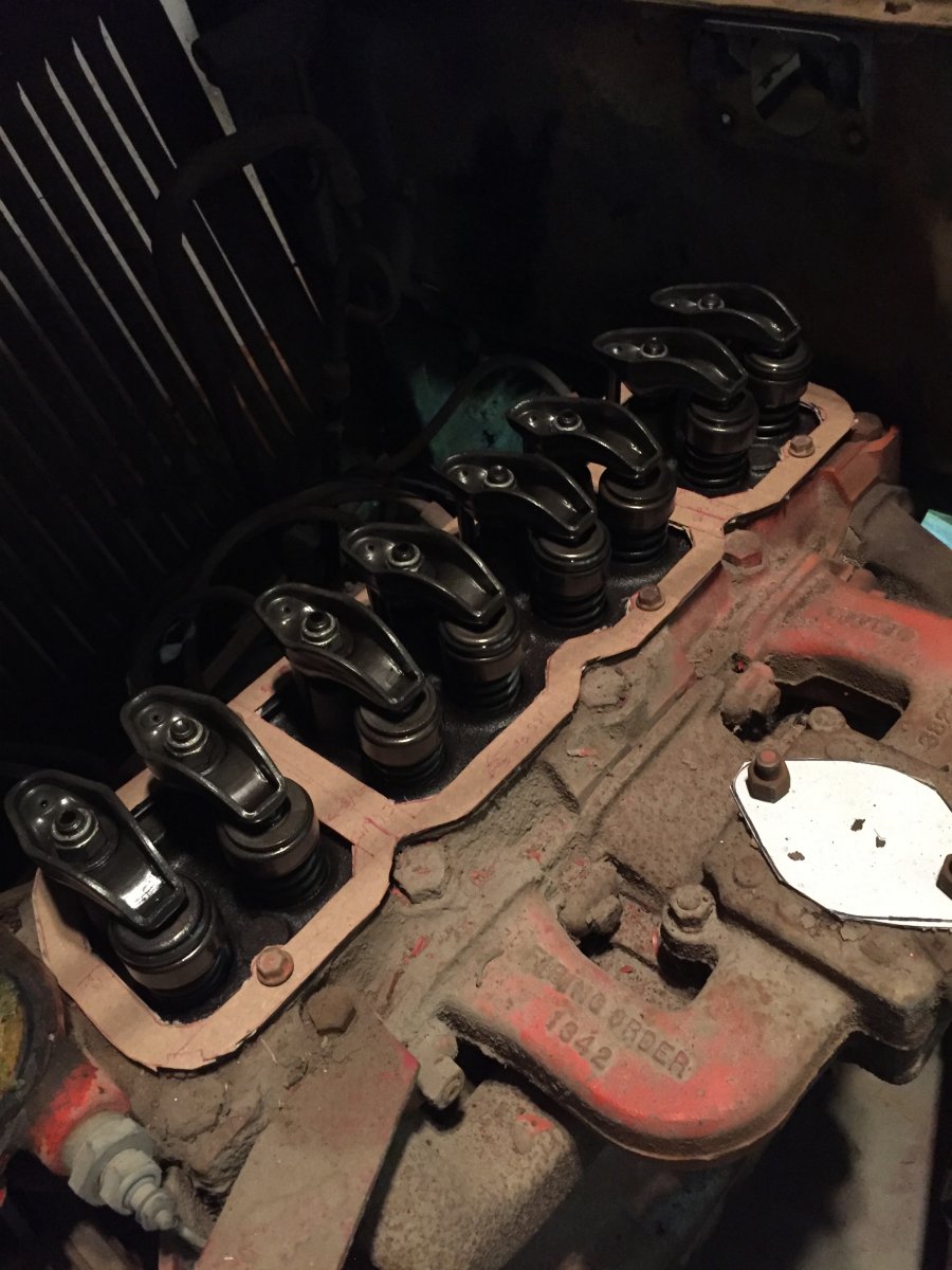

    Got some some rocker arm interference so I painted the adapter white again and will do some more mocking up and marking to see where things need moved
