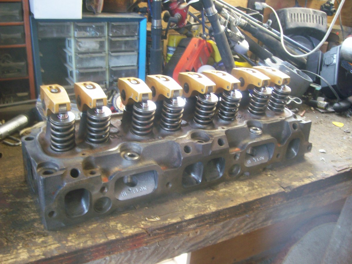

    I think Clifford still makes a tube header for these. On eBay there are sometimes both intake and exhaust steel flanges for making both manifolds for the 230-292 sixes. With slight changes and a few leftovers they'll work on the four.

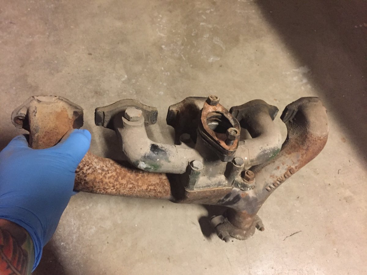

    Good lord right when I thought I was threw with this lol

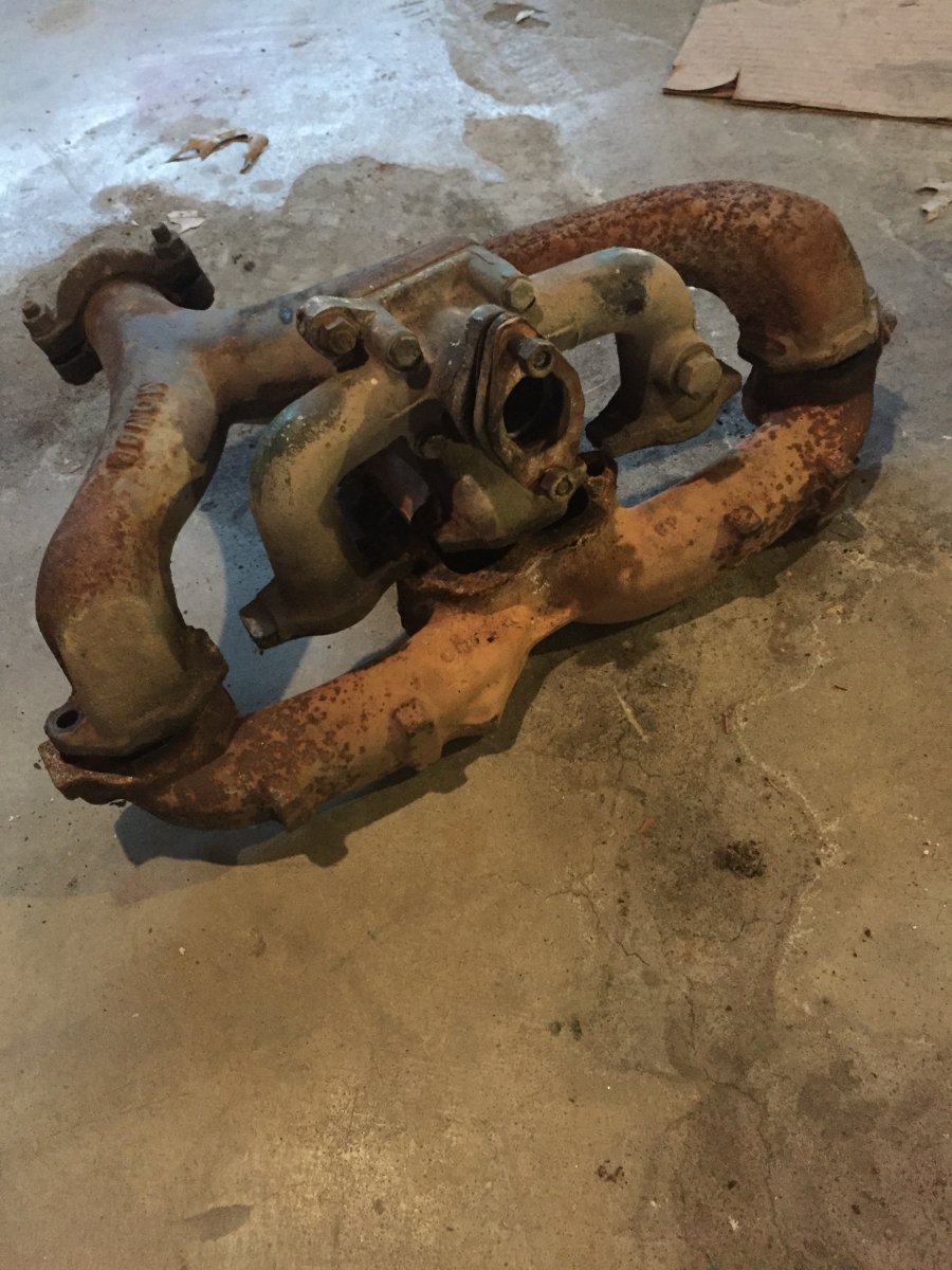

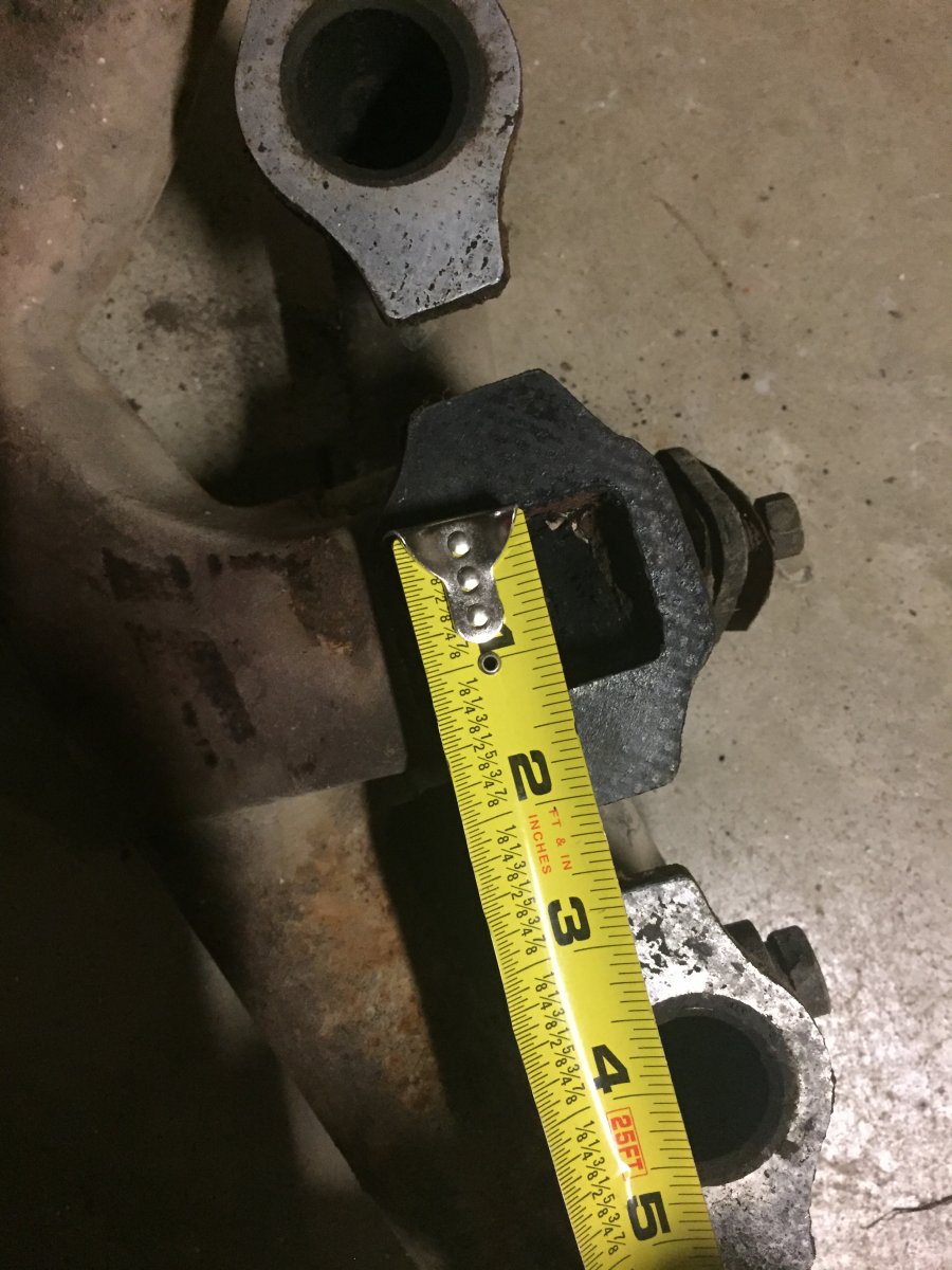

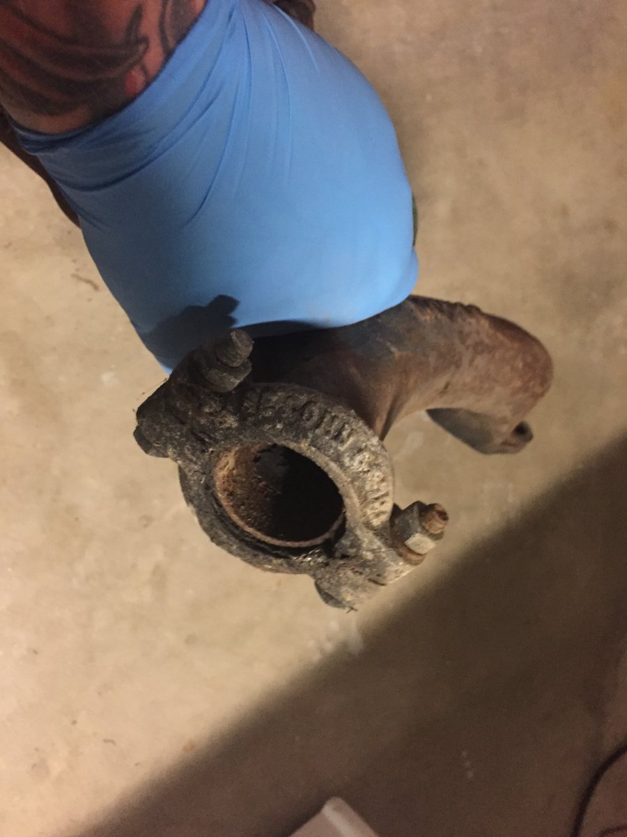

    Because like any good hot roder when any one texts and says “ya want rusty old junk?” I say hell yes bring it over!
    I’ll either use it, give it to someone who can use it, or trade it for something I can use.

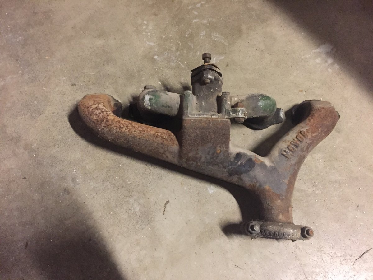

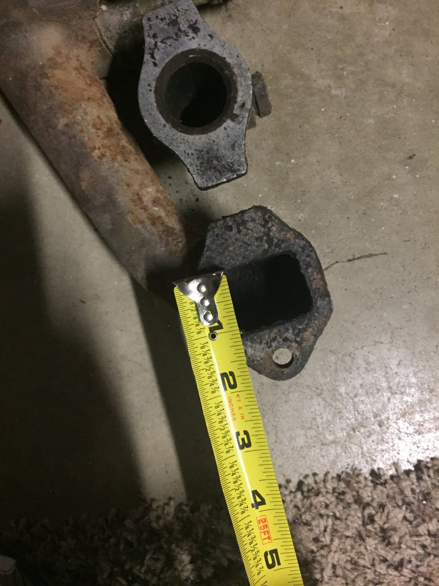

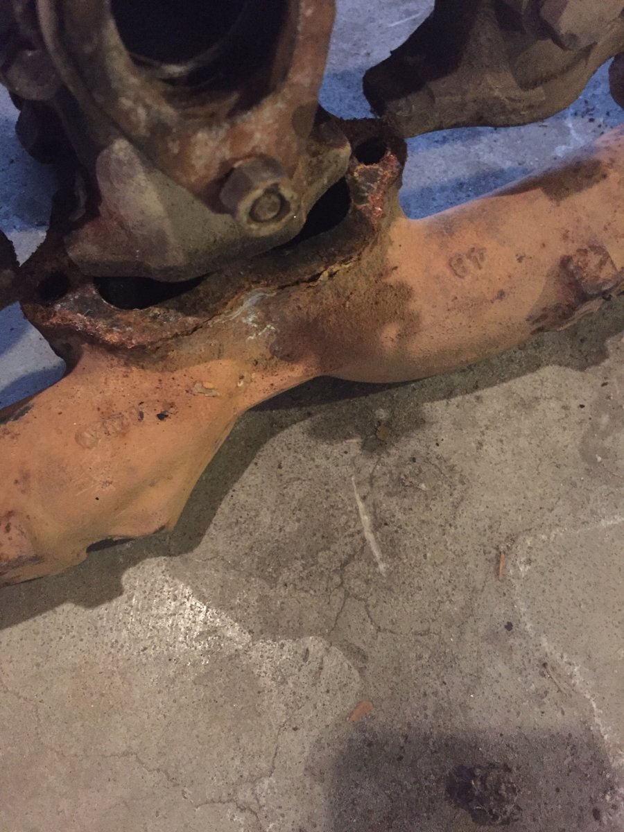

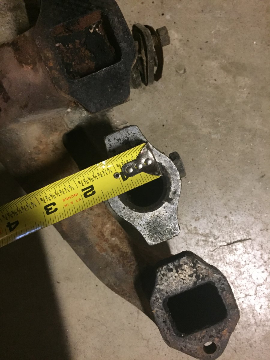

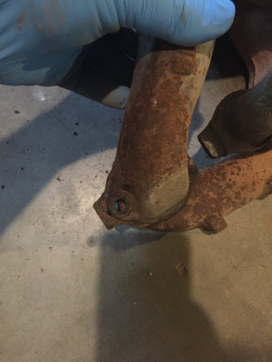

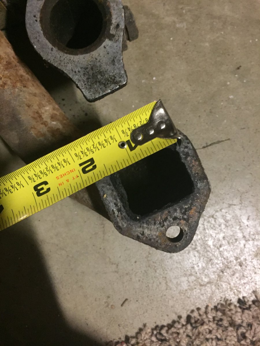

    This time a friend is gutting a Nash metro for some really cool upgrades and dropped some parts off. Some of which were the intake and exhaust.
    I love it! It’s got a weird cast iron donut on the collector end that makes me think of a v band style clamp, it’s almost a bolt on but it’s like 8/10 scale to what I need.
    If I slot the end holes a little it will actually bolt on but the ports are tiny and the center is only a single. I think the plan is to clone this in tube and to use this one as a mock up place holder.

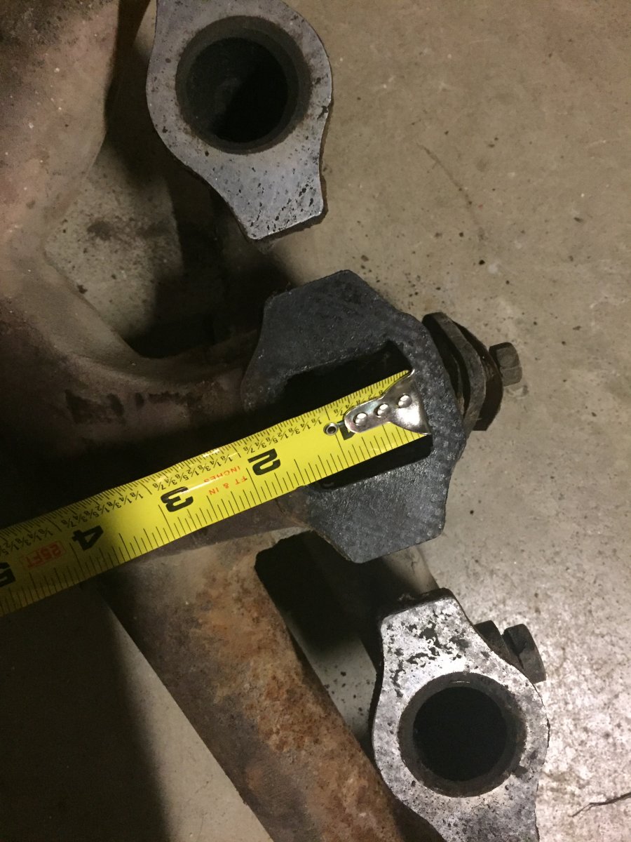

    Just because I know some of you like seeing what sorts bolts to a 153 here are more photos 618E6C36-F59F-4511-8562-31BAEAC20B1D.jpeg Cast iron donut coupling
    C600E42C-C71B-4120-A043-5D076EBCAEC1.jpeg Outer exhaust ports 702BB4BE-E1BA-40C6-9958-9B9226D18045.jpeg
    D45AF988-0FAC-40ED-89E5-F4CF3AF68DDC.jpeg Center port is bigger than ends
    4B13D7B3-6E7E-461C-9C8D-B8D2BFFB690C.jpeg Intake ports are so small my wedding ring is wider across!
    A608A080-CDAB-49FB-ACE1-4FC221BC4606.jpeg Sitting on a vette ram horn to see how close they line up. The very end holes are about 1/4” off to the inside but the actual hole is the same size
    30A4300B-D5E9-4478-B059-AB133F4CDDD6.jpeg Guess I took a photo of that too 5CAD4F0A-BD1D-4764-832D-3A6E5567DF41.jpeg kind of hard to see but the sbc intake ports way over lap that center port.
    The 153 port spacing is the same as a sbc so I used it for a quick comparison

    Got some others nash bits that I think I’ll either use or use as inspiration later on. I love looking new at older uncommon engines to see what they use. I feel like most hand fabricated things made today feel to race car/ contemporary and not “old hot rod/ race car”
    Maybe it’s because I grew up with race cars not race cars from the 50s haha. Either way excited about some new ideas.

    At the risk of looking even more neurotic i posted those photos for you because I figured you’d get it lol.
    Half way threw dinner I thought “maybe I can just cut the center ports off the 153 manifold and weld them to this nash manifold?”
    Crazy talk lol.

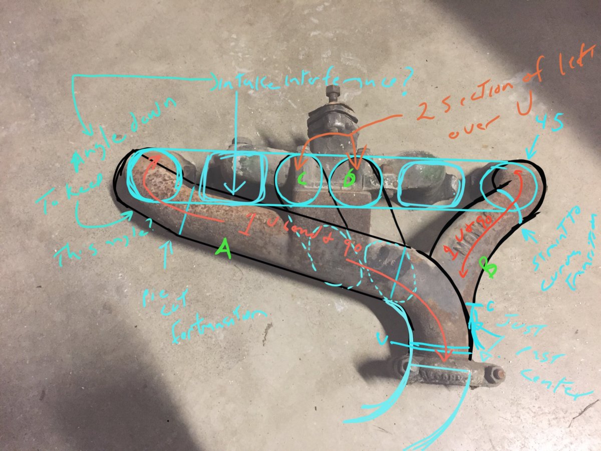

    113D8B69-B1D8-442C-A8C4-8E71F6FC5823.jpeg So I’m thinking I could make that nash exhaust in tube with a sbc flange and two of the pre made bends speedway sells that have a U on one end, a straight and a 90 on the other end.
    The 90 is the same radius as the 180 so it’s got a nice bend that’s not to abrupt.
    It’s less organic feeling because the cast iron piece has got a ton of diameter changes and compound bends that aren’t realistic for me to replicate but I think it works.
    The only other spot I think I will change is to make the collector larger than the primaries. I think I may merge the two end tubes together in a way that makes it a 1.5 of the primary diameter.
    Just seems like a bottle neck to have everything be that small size all the way out. I guess readily available flathead headers are like this though?
    Just want to make sure I’m not making it breath worse in Trying to make it look nicer.

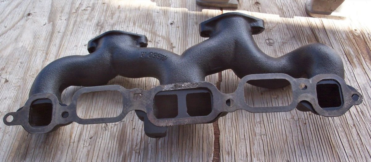

  24. Six Ball
    Joined: Oct 8, 2007
    Posts: 7,245
    Six Ball
    from Nevada
    The black widow. Just remember where you saw it first.:rolleyes: All small block headers could work. It's not quite as easy as it looks but easier than what you laid out above. 100_1620.jpg 100_1619.jpg
    Dannerr and Tim like this.
  25. Tim
    Joined: Mar 2, 2001
    Posts: 21,586
    Tim
    from KCMO
    Not all sbc headers just the ones that don’t block the path to the intake runners ;)
    Looks like if you did some creative slotting and used the stock hold down method it could go on with out to much head ache.
    Love seeing that gasket photo that helps a bunch

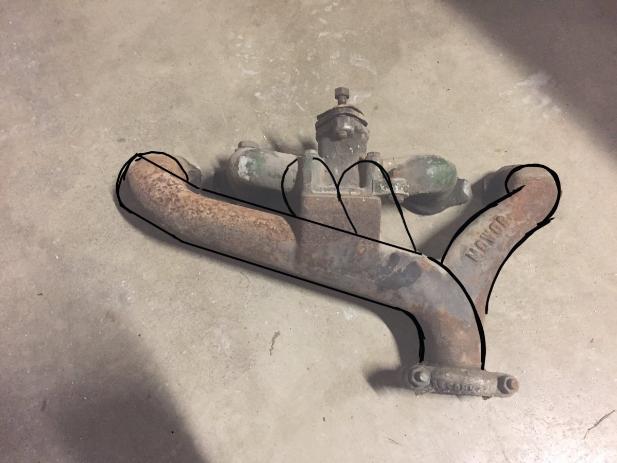

  26. It would be easy enough to build a Black widow style header, like half a try Y. I probably would not Siamese the center two ports. Good idea.
    I like the Nash pieces that @Tim posted as well. I am not a big fan of the heat riser, my school of thinking is not in that vein. But the header intake could be cloned easy enough in tubing, and with bit if 18-16 gauge the heat riser could be added. That would make the inline crowd happy. LOL
    Now the problem becomes what to do what to do. LOL

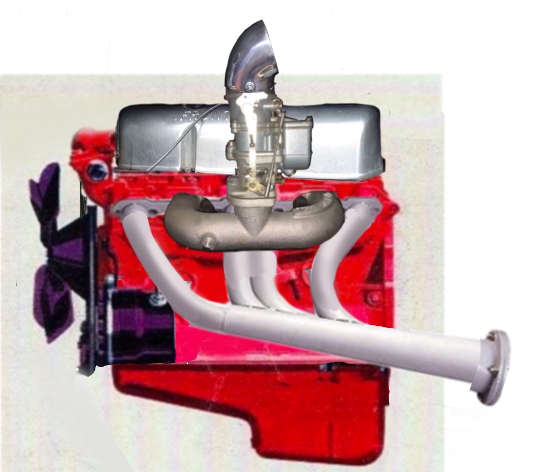

    The Nash type header would look roughly like this D316BA50-D6B6-44ED-8EAF-BB9741DC2B2A.jpeg And because @Six Ball said any sbc header I drew this lol A4539731-C4F0-4307-94D4-A4B8EAF2C50F.jpeg Front tube slanted back to clear charging system and rear tube pushed foreword to clear the firewall. Cone from sbc kit cut short
    patmanta likes this.
  29. Six Ball
    Joined: Oct 8, 2007
    Posts: 7,245
    Six Ball
    from Nevada
    100_2140.jpg I don't know why that gasket has no divider on the center exhaust ports the head does. I do have a head with siamese ports. I think it is a very early one.
    I'm trying to decide whether to try and use the stock type tie downs or use an adapter plate between both manifolds and the head. The plate would give me room to fit the ports better than without it. Or possibly just an adapter on the exhaust with stock tie downs.
    brEad likes this.
