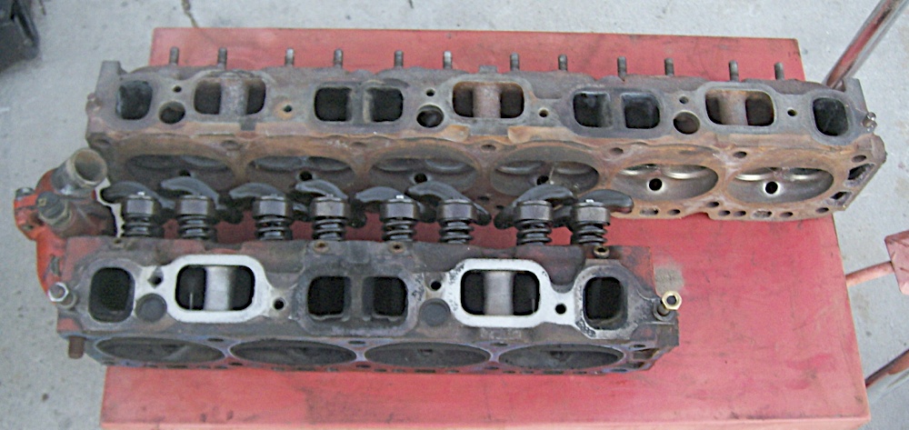

  3. Six Ball
    Joined: Oct 8, 2007
    Posts: 7,245
    Six Ball
    from Nevada
    I think if I match the 153 ports to the small block ports I'll have sealing issues. The 4 cylinder ports are taller. It might be fixed by adding some material but then the heat might warp the whole thing.

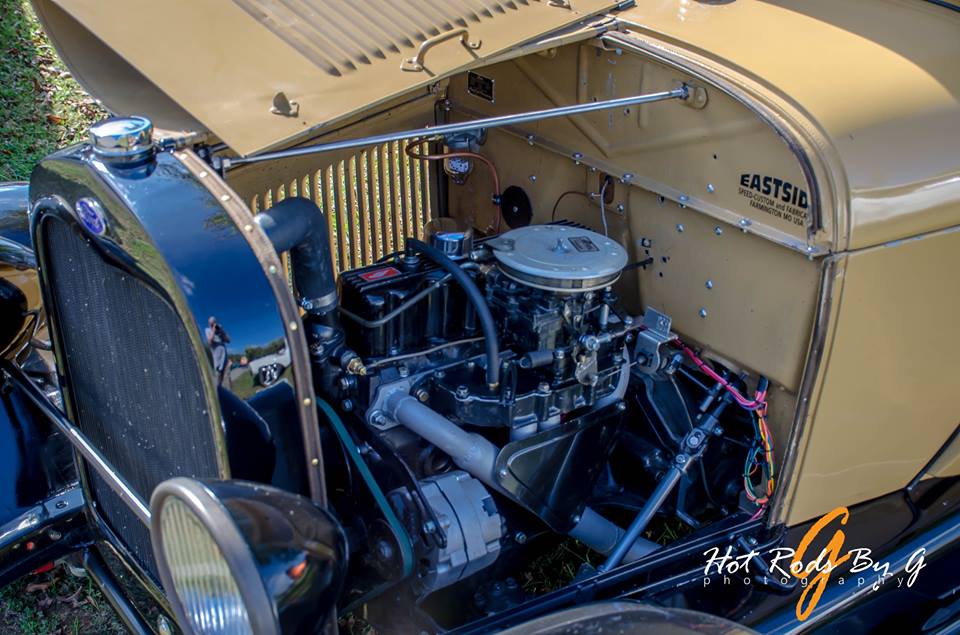

  14. 1929CDAN
    Joined: Mar 18, 2006
    Posts: 349
    1929CDAN
    2017 HotRod Hundred 015.JPG I put a merc cruiser in my car. I cut down the boat intake and had to rotate the carb so I would have room for the cables . Made my own header and it works ok. 22448414_138525210111837_7184613024384976194_n (1).jpg
    Tim likes this.

    @1929CDAN great looking car! What drivetrain is behind the mercruiser? Did you add the sheild to the header for heat purposes?
    1stGrumpy likes this.
  16. 1929CDAN
    Posts: 349
    1929CDAN
    The shield more for the look and a 700r4 trans with a 8inch rear end.
  17. Tim

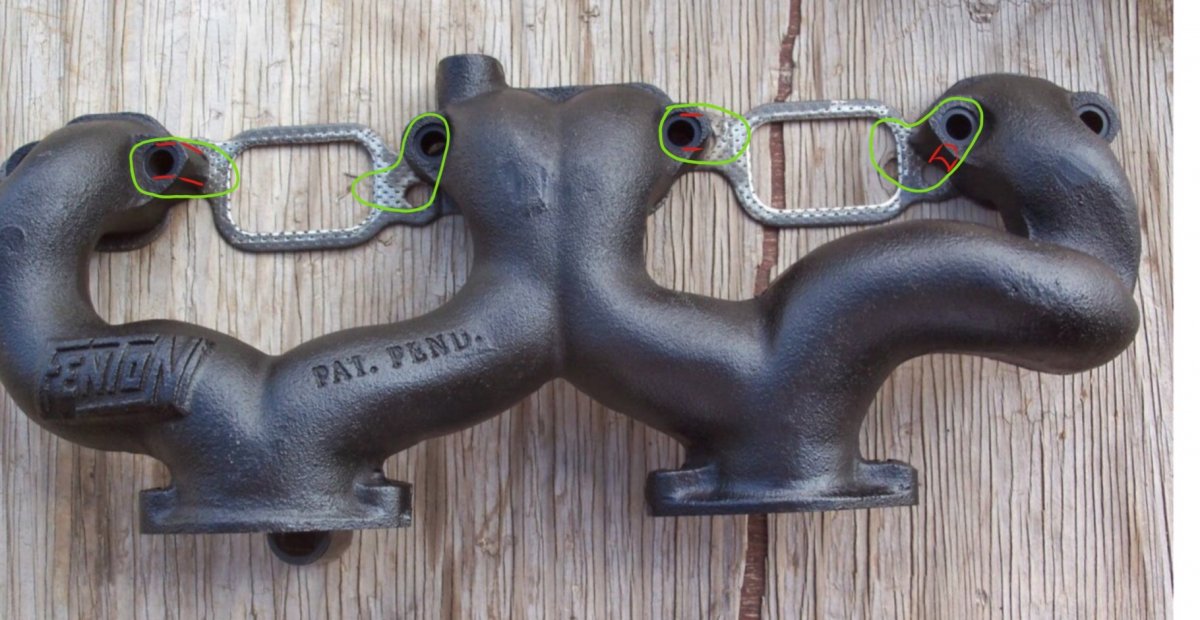

    @Six Ball ever put a tape on a flathead header? Add a center primary to the left of the existing one and they all line up very very close
  24. Six Ball
    Joined: Oct 8, 2007
    Posts: 7,245
    Six Ball
    from Nevada
    I have a set of Fentons hanging on the wall, never looked at them in that way but I was looking at some flathead parts on eBay last night and saw the similarity.
    Tim likes this.
  25. Tim
    Joined: Mar 2, 2001
    Posts: 21,587
    Tim
    from KCMO
    Had a buddy measure ports on his 21 stud last night and the center to center from outside port to outside port is almost exactly the same. The center primary lands on the center port towards the firewall I’m guessing based on a tape measure.
    You should lay the Fenton on a head for a photo and ****s n grins
