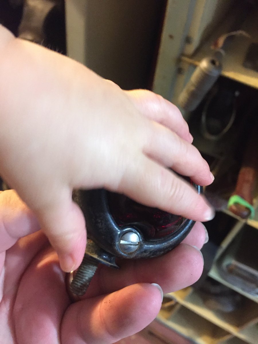

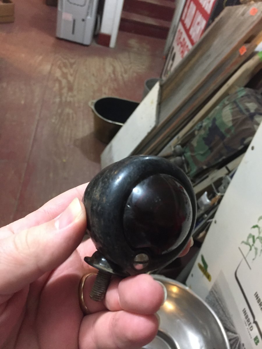

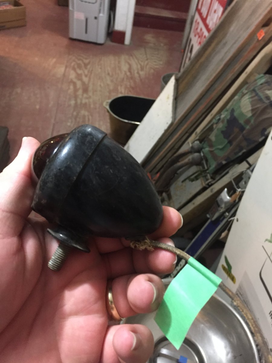

    Took my daughter hunk hunting and found this little light. Super dark red lense we think it’s a wwii era military truck marker light.
    Thinking it’s exactly what I had in mind for from blinkers other than its a red lense which probably isn’t that big of deal.

    Looks like wwii military truck marker light / black out light is correct. Haven’t found a lense match yet but looks like some were even made by ford and are marked as so.
    Not real familiar with how bright a black out light would be for a blinker so a warning light may be a better use for it. Either way I think I’ll grab it and sit it on the shelf for now

    Nice little light, you'll find a spot for it. Sometimes it's funny how much we do to fit something cool into the plan to make it look like it was always part of the plan. :confused: There is a lot os speed equipment for these engines in Brazil and Argentina. I have no idea how to access it. Both tlowe and CNC DUDE here have imported some for sixes.

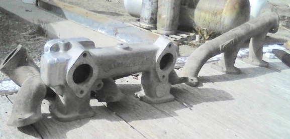

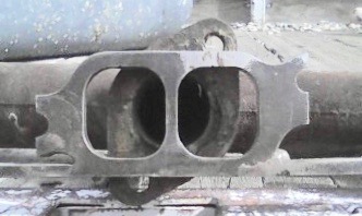

    Here are some pictures of the flathead Fenton headers and the header plate for the 153.

    Thanks for matching up the flathead stuff I can believe how close they land I’m honestly surprised the ends are that dead on!

    Yeah, they line up pretty well. The cast Fentons would take some work. The right side won't work because the main tube runs down the center of the ports. The driver side could be made to work and you might be able to one from a broken set. It does show that a set of tube headers would be a good place to start but 194-292 six tubes would be easier. **** I have some of those too. I just thought of them. I'll get pictures of them but It's supposed to be lots of snow for the next couple of days.

    Those have 4 exhaust ports right? I saw some Chevy 6 split tube headers in a speedway catalog and wondered if you couldn’t but them up and run them.

    Pretty much do what I did for the header flange. Use the front pieces is and cut and weld the #6 on the front piece. #6 ends up as #4. You have to mess a little with the stud notches and the back hole.

    Looks symmetrical just flip it over and build a carb adapter?

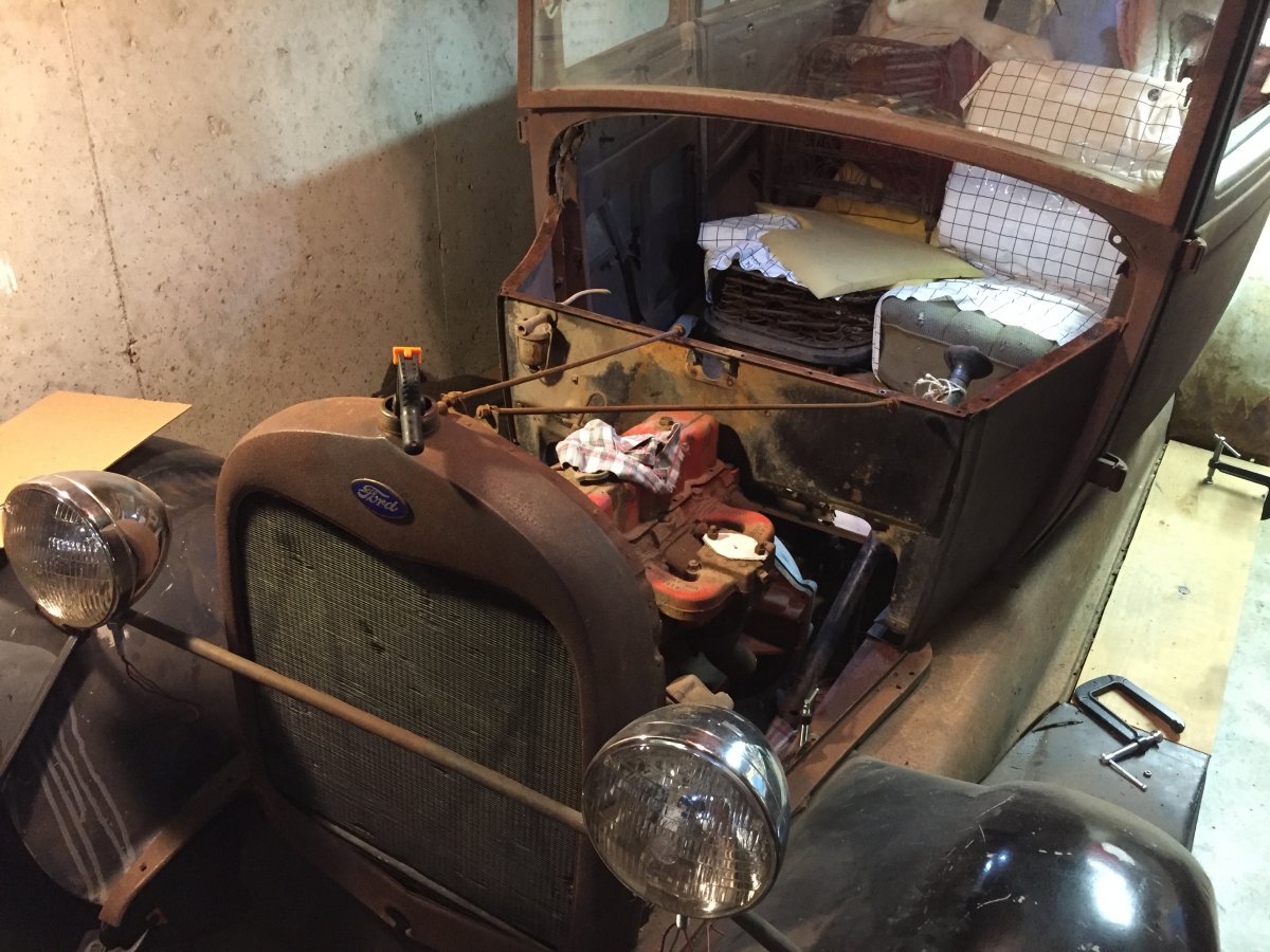

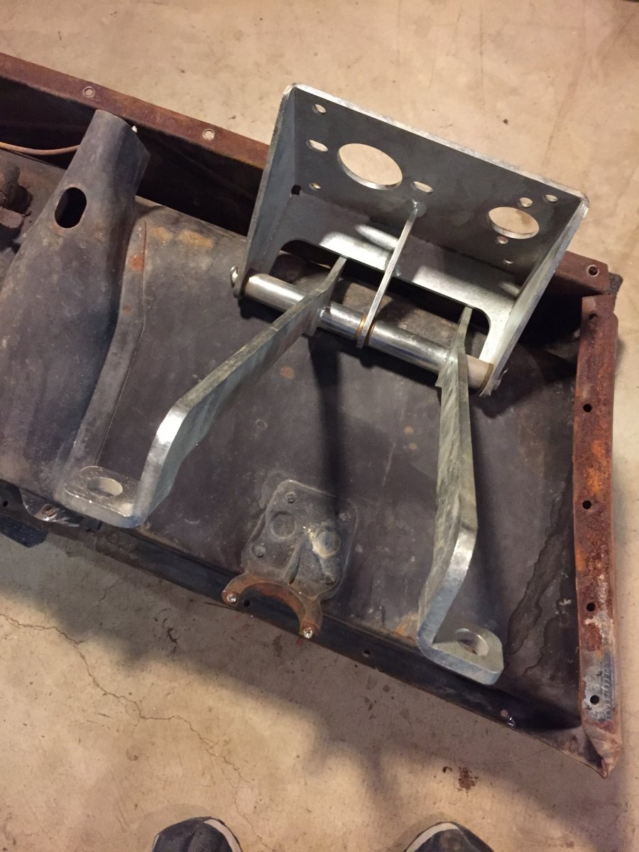

    After many small work sessions during the Little ones naps I got the cowl out!
    This is a big step in the over all mocking up of the project. I’m going to plot and mark the tank on how I want it cut and then haul it over to a friends to use his plasma cutter.
    With the tank cut out I can get the hanging pedals mounted, the master cylinders mounted and the steering mounted properly.
    I’m using a 38/9 pickup cross steer box and column . As of right now I’m thinking I will slice the tank side of the stock column mount in half and bolt the 38/9 unit to it similar to what is show in Tardels new book on hot ridding a stock model A.
    It’s all up to mocking it up to see if that will happen but that’s the idea in my head.
    Oh! And I’ll be able to cut and fill the dash and be poised for that project.
    That all will allow me to build the intake and exhaust I’ve. Been rambling about with out worrying that it’s going to be in the way of some other sub ***embly.

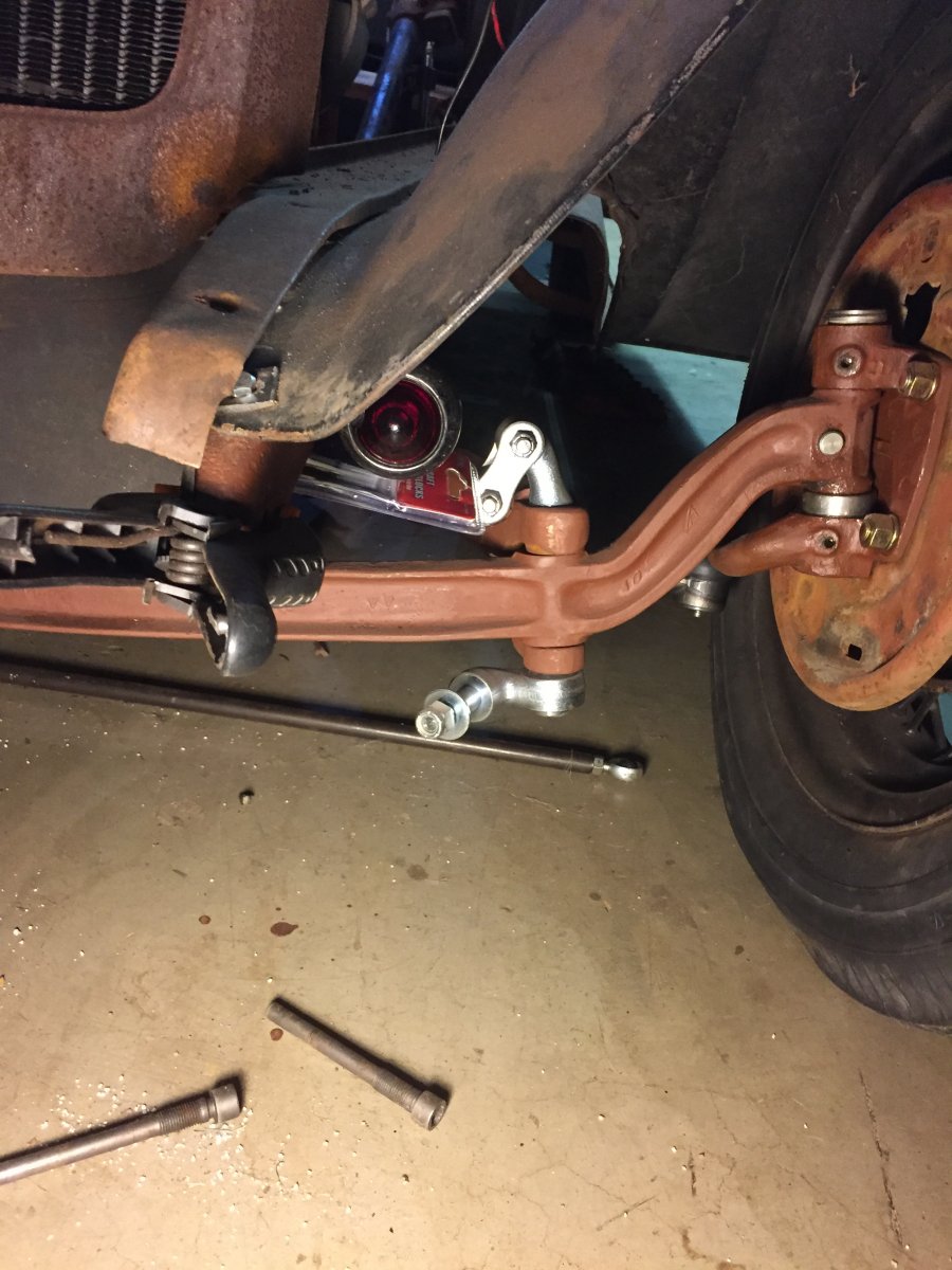

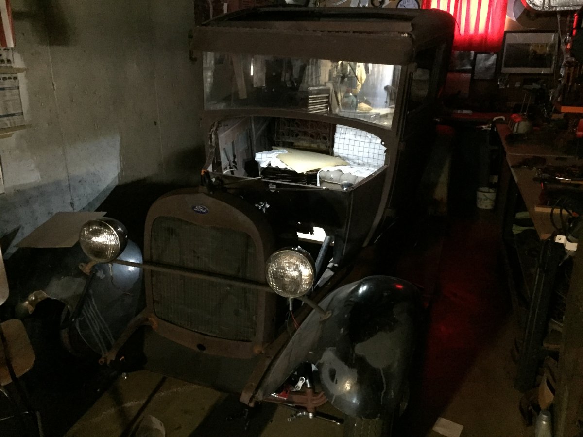

    I also took a minute and stuck the new little light I found into a pre existing hole to see if i liked the blinker idea in real life as much as I did in my head.
    Well I do! My only concern looking st the photos is where the shock will run. Should be easy enough to put something in the shocks place and see what’s what.
    It’s a guide R8-50-1 a light used, from what I can find online, from 1938-1955 on all sorts of things but the most common seems to be Harley and Indian tail/ accessory from the 40’s and early 50’s John deer tractors.
    They don’t seem like they are to hard to come across so I’m going to keep an eye out for another cheap one.
    They are stud mounted with the wire coming out a grommet just behind the mounting stud. I’m thinking I may center drill one of the fender brace bolts and run the wire threw it.
    Trying to avoid drilling more holes than I really need to while keeping it as clean as I can visually.

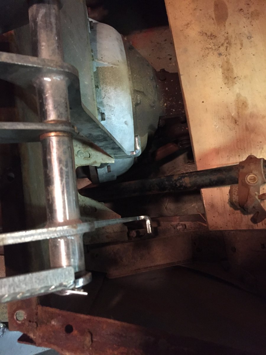

    So after looking at the photos I was concerned about the tube shock trying to take up the same space as the light in some plane.
    Used some random stuff to mock up where a shock would run and it’s all behind the light. I think I’d have to tilt it over and run a pretty fat shock for it to be any issue.
    I’m currently planing on running the shock with the upper mount welded to the fender brace like the black gendered coupe Ryan and Keith did a couple years ago.
    Seems to be working for that car and it hasn’t got a full head light bar, so I’m figuring my headlight bar should brace it all a little stiffer and be just fine.
    In the back I’m going to use 46 ford rear lower mounts and weld a stud into the rear cross member for the upper

    When my son and I built his Studebaker station wagon we put bags where the front Coils springs were. There were no bags with center hole back then so we had to mount the shocks elsewhere. We attached the top of the driver side to the steering box. That was not a good idea. :( I don't think a fender brace is wise either but if it's working for someone it may be OK. Before you design the front suspension around the little light make sure you can find another one and some not red or blue lenses.

    I can find them easy enough and I was going to run the upper shock to that location far before I found this light.
    I have another pair of fender braces/ brackets that are cast iron and look pretty similar to f-1 shocks mounts so I don’t realy doubt that they should do the job. Though actually the later style ones I have bolted to the car now do feel stronger.
    I’m every bit of 225 lbs and can bounce up and down on the bracket and it doesn’t flinch so I figure with the headlight bar tying them together I shouldn’t have any issues.
    Though I clearly appreciate your advice.
    Worse case I’ll gusset the bracket or build something totally different

    I'm not a Model A guy but I've used the F-1 brackets and if it is near that stout it'll be fine and well as already in place.

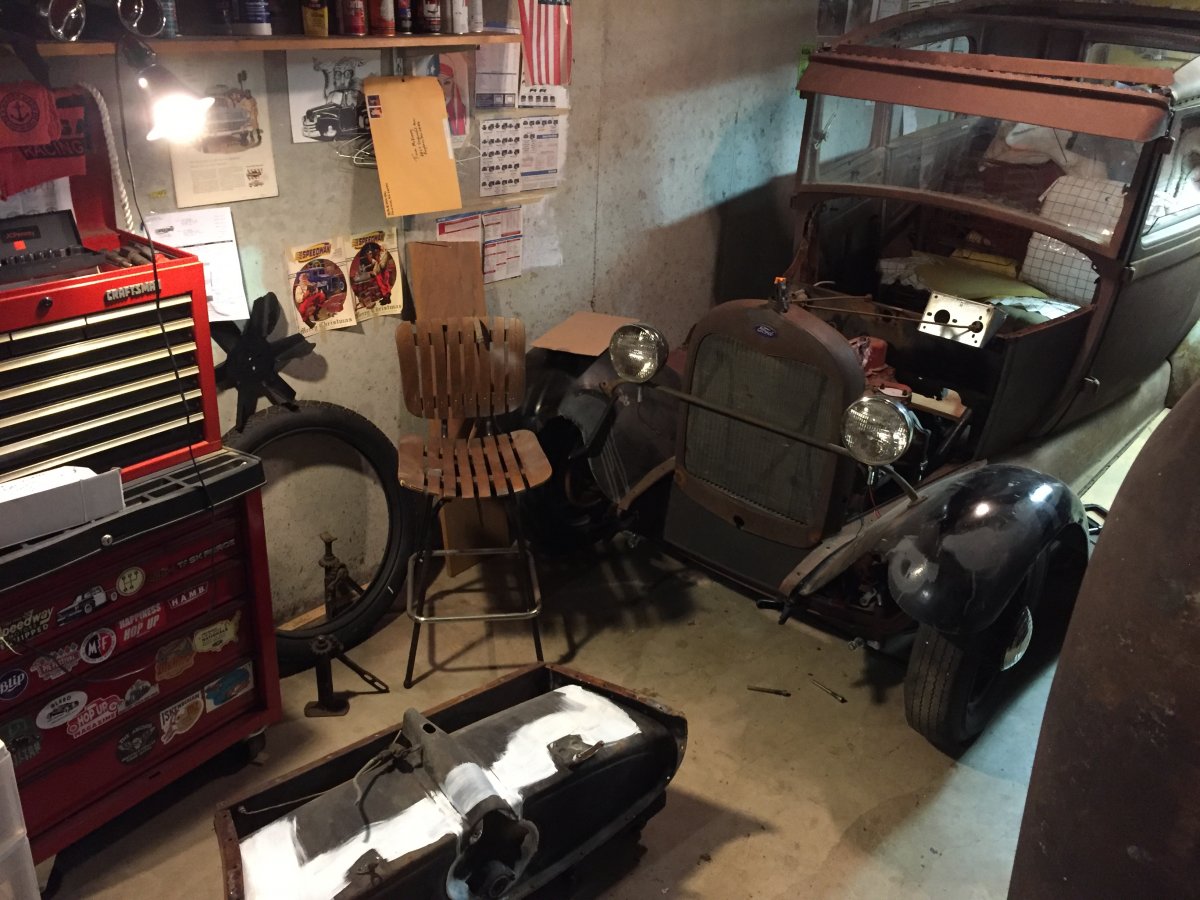

    Got the tank painted and the first draft of cut lines marked to be cut. Gonna sleep innit and walk by it anwhile before I confirm anything but I think it’s pretty close to what I’ll end up doing.
    I always clean and the. Paint everything flat white before I make cut lines just to make it easier to stay on course.
    I’m trying to keep some of the tank in place to keep it ridged, as well as keeping the stock column support. I’m considering running a brace from the firewall to the top of the column support to triangulate everything and work as part of the bracing for the hanging pedals.
    Think I may be able to drill out two of the rivits and bolt it together. Thread the brace side so I don’t have to find a way to get a nut a wrench and a fat hand in there.
    The depth along the rest of the dash line could also House switches, ****ons, 12 volt port and maybe an underdash light?
    I’ve seen ignition keys mounted out of the way in this fashion but I’d be concerned that with any sort of key chain it would pull out or wear prematurely?
    I also loosely mocked up my pedals where they will land. I’m planing on placing them as far to the outside as possible and at that placement it seems to straddle the stock column support pretty well 88AD285D-0AE0-43E3-9301-B4A81A1AA700.jpeg And sitting it more or less in the same place on the still in tact lower fire wall it looks good as well.
    I think the brake pedal make be a little close to the column so I’ll use some strong magnets to hold the bracket in place later on to mock it up and make sure the pedal pads and my big feet clear everything.
