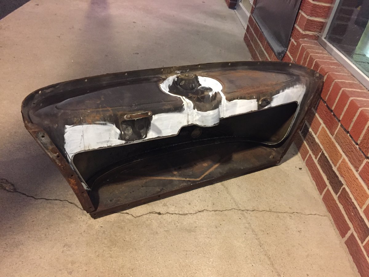

    Wow, never underestimate how bad old varnished gas can smell. Lord have mercy lol.
    C6721008-2E98-441E-A416-2EC1A258B9C1.jpeg Gonna let it air out outside for a while until I figure out how to clean it.

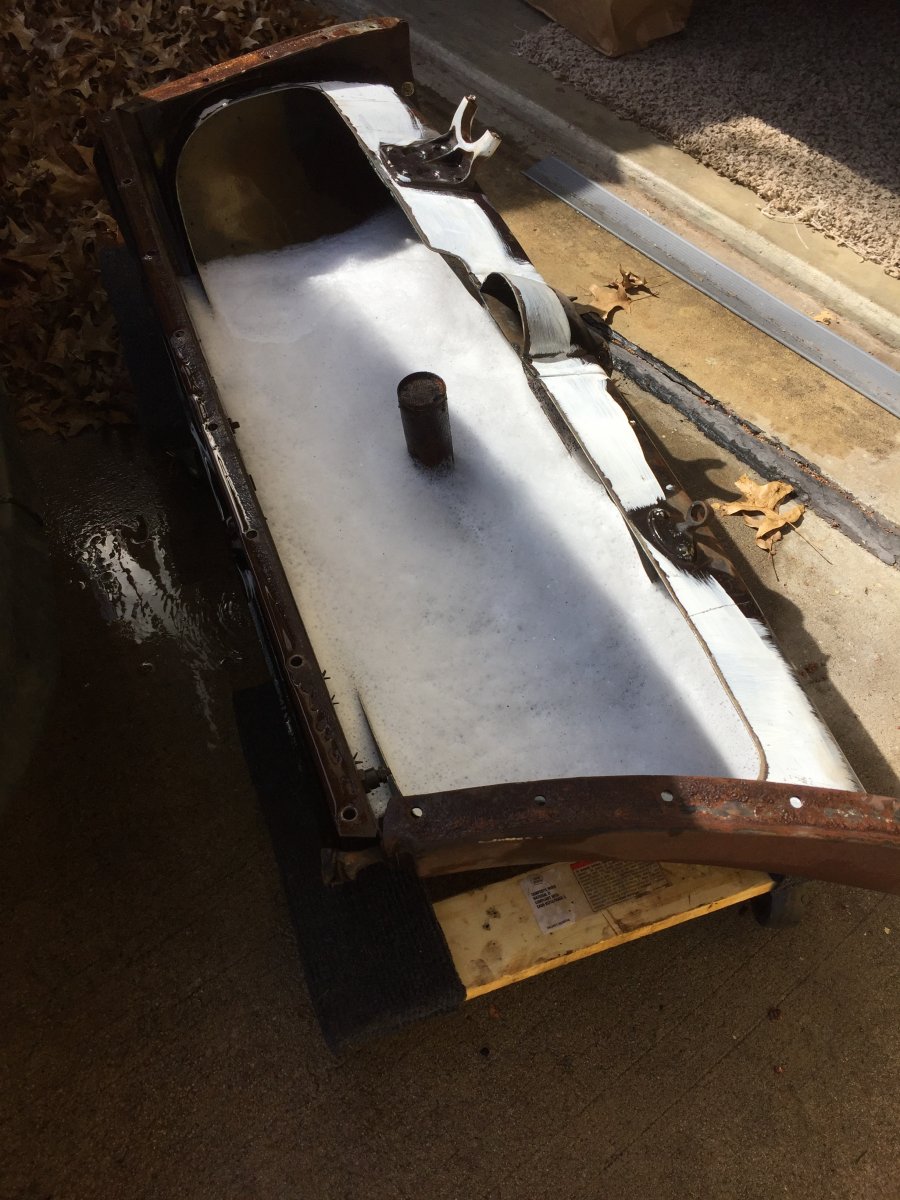

    Some dawn dish soap and a garden hose got a surprising amount of the sludge out. I’m letting it soak a while and we’ll see how much of the stink is gone. 92E49BBC-8B42-4C97-8665-5EBBF05AF949.jpeg
    Thinking I’ll take it to the car wash this weekend and use the high heat, high pressure hose and blast it some more.
    Doesn’t have to to clean enough to paint just clean enough to bring in doors and play with

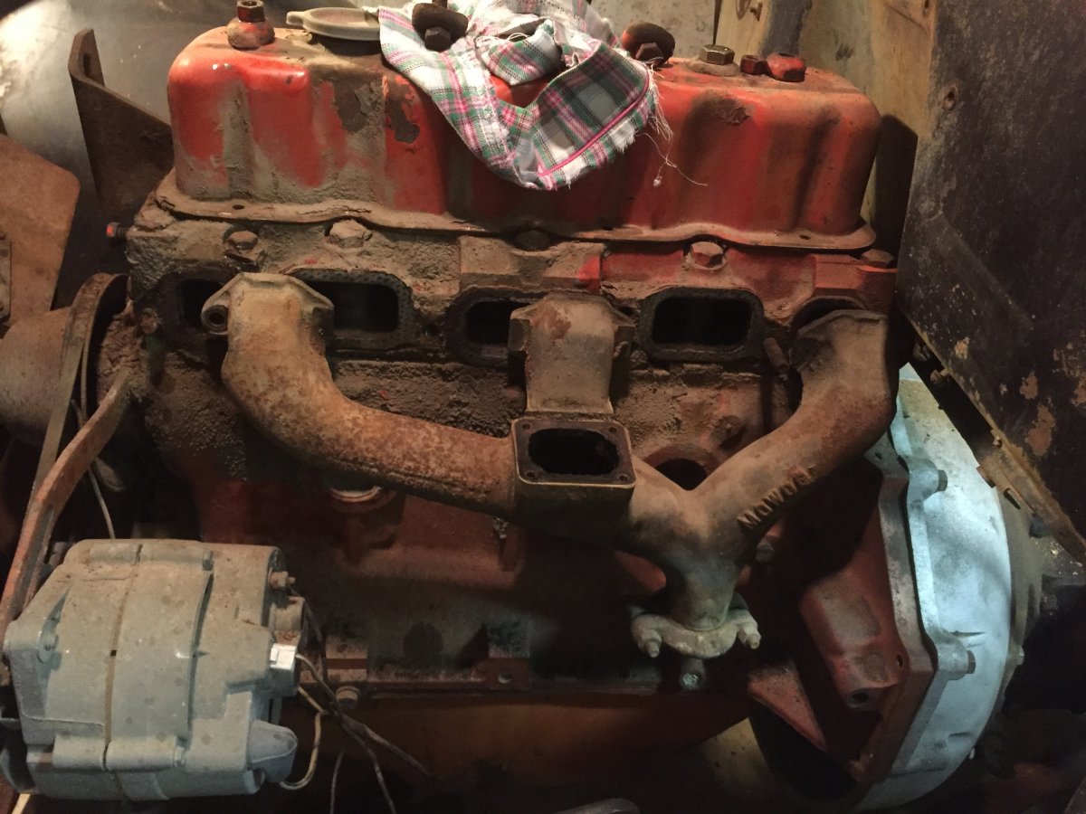

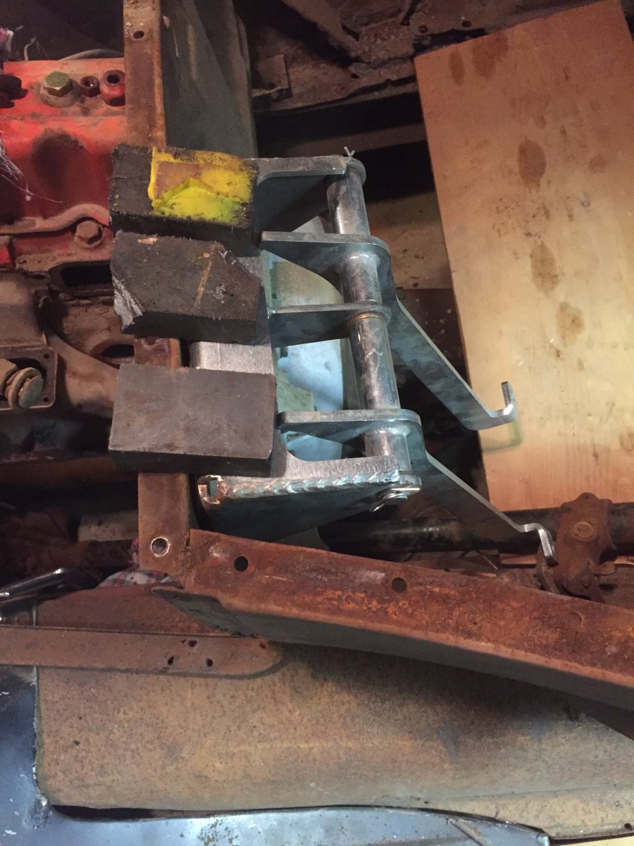

    A trip to the car wash for some steaming hot high pressure blasting and soap for the tank clean enough to bring back inside 5BAC6BA0-674E-4018-925D-83BC9B771269.jpeg Pretty clean! C0E3A714-C869-4C90-9A9E-9052F8E8ECFC.jpeg pulled the intake off the Nash manifold set and pulled the stock manifolds off the Chevy for a little look see. The end ports space out closer than this but this is the position that lets me hang it on the motor for a photo. I think I’m going to like the tube version. E2CE1BB8-009E-4BBF-A03C-6831172F47E5.jpeg @Austin kays brought me some mega strong magnets to help mock things up and I stuck them on the pedals to see if they’d hold to the fire wall.
    Sorta.
    Pedals aren’t very magnetic apparently because it barely holds though this magnet could smash you finger if you got it between the magnet and an anvil B311D4D7-E4B2-4776-ACBC-9CED325CCEE1.jpeg

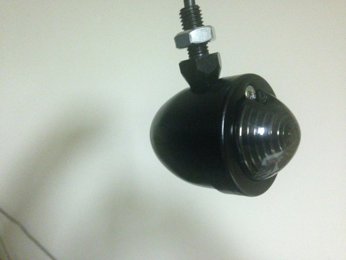

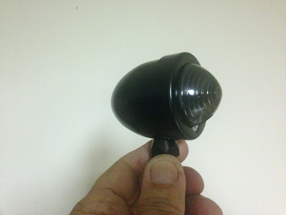

    Tim...I found these little lights online. I think they're for some kinda Jap bike but I forget which brand. 34signal.jpg 34signal2.jpg
    Tim likes this.

    @Rocky yeah I thought of those when I saw this one on the shelf. Was thinking about using them if I couldn’t find another to match the one I found.
    @Corn Fed this is a speedway knock off of the ansen. The spacing is enough to allow two 40-8 ford masters to fit. The center hole on one side needs inlarged and you need to add a provision for one bolt hole that lines up off the “box” I’ve got a couple ideas of how I’ll do that.

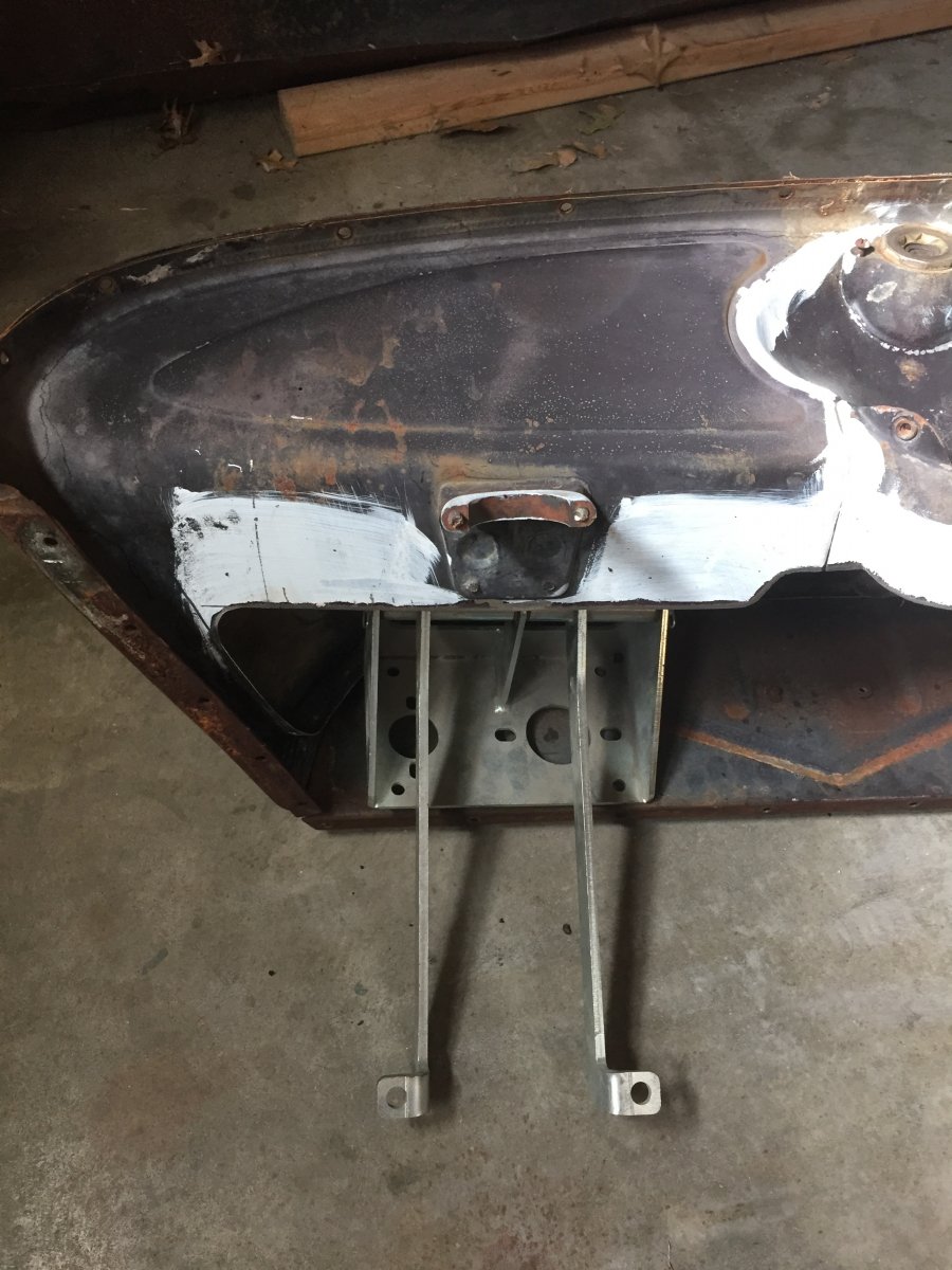

    Today’s “mental math” trying to land on a way to brace everything with out it getting in the way of everything else
    Pedals land about here, still need to make sure that clutch master clears the hood as @Tman pointed out to me.
    Right now the only thing I’m set on is welding a 1/4 plate square to the inside of the firewall with all the holes I need drilled and tapped.
    That way the pedals just bolt right on and the masters bolt right on from the other side.
    I was thinking I’d run a 1x1 brace from the bottom of that plate to the steering column support and then a 1x1 brace from the top to the dash rail.
    That brings me to two thoughts.
    1: if I brace it that heavy I need to have my switch positions and gauge positions figured out and mocked up so I don’t run into interference later. If something doesn’t fit, or doesn’t have a provision to work easily the only one who’s at fault is me.
    2: @Tex***peed mentions a similar plating the firewall minus the added 1x1 braces and I got to thinking that my dash would already offer mote support for the steering column than a 32 dash and people hang them from those all the time? If plating the firewall would be enough to keep the flex out I wouldn’t have to work 10 steps ahead and have the gauges figured out to add the bracing.
    I tend to shoot for overkill because I don’t want to have to go back and make it stronger later but sometimes over kill is waaaaay overkill and not needed.
    Thoughts on bracing the pedals on the firewall?

    What to do you? Plated firewall enough or add braces to dash/dashrail?
  25. Mine had braces built off the cowl hoop. I would brace it, they are gong to be getting some pressure when the brakes or clutch is applied.
    Tim likes this.

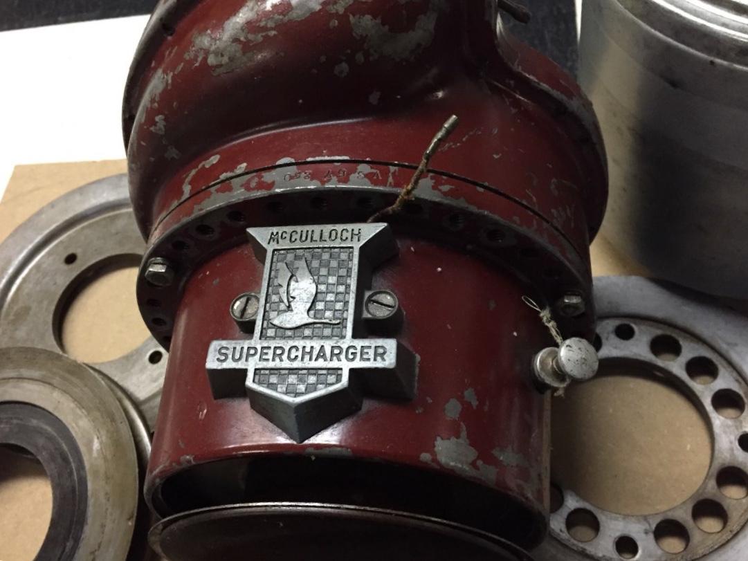

    I have a couple of McCullochs and I thought about using one on my roadster but they are pretty big compared to the engine.
    Tim likes this.

    True, figure mines got a late 60’s jumbo sized gm alternator on it now where I’d place it. If I squint and pretend it’s a super charger it looks like it’ll work to me lol 2D38B387-989A-41F1-B74C-984B90936833.jpeg

    @Six Ball for ****s and grinds throw a tape on one of them I’m curious how much bigger it is than this alternator
