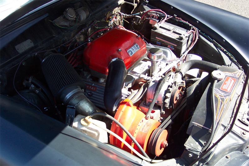

    My son has one on his Studebaker. He worked for a guy here that rebuilds them so his has some custom stuff in it. It makes the car fun fo a few seconds and then scary. :D
    patmanta and Tim like this.
  2. Tim
    Posts: 21,587
    I bet! Looking at the size of that alternator compared to the supercharger I’d have to say it’s not much bigger than my jumbo alternator.
    Looks like he’s using a carb box to pressurize it all instead of building the carb to blow threw?

    We used the Stude Lark setup and had a tough time getting it all under the hood of his '54 wagon. It is 4" shorter from the firewall to radiator than the coupes and a much lower hood than the Hawks. A supercharger build for a 250+" engine would do anything you'd want on or fours. I'll be running the smallest 12v generator I can fit on mine on the lower left side. That leaves quite a bit of room on the upper right with only the distributer to deal with. The carb box makes it easy. We only had to change the float and go full mechanical on the secondaries.

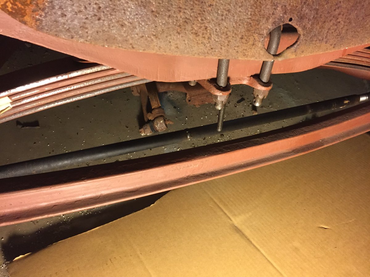

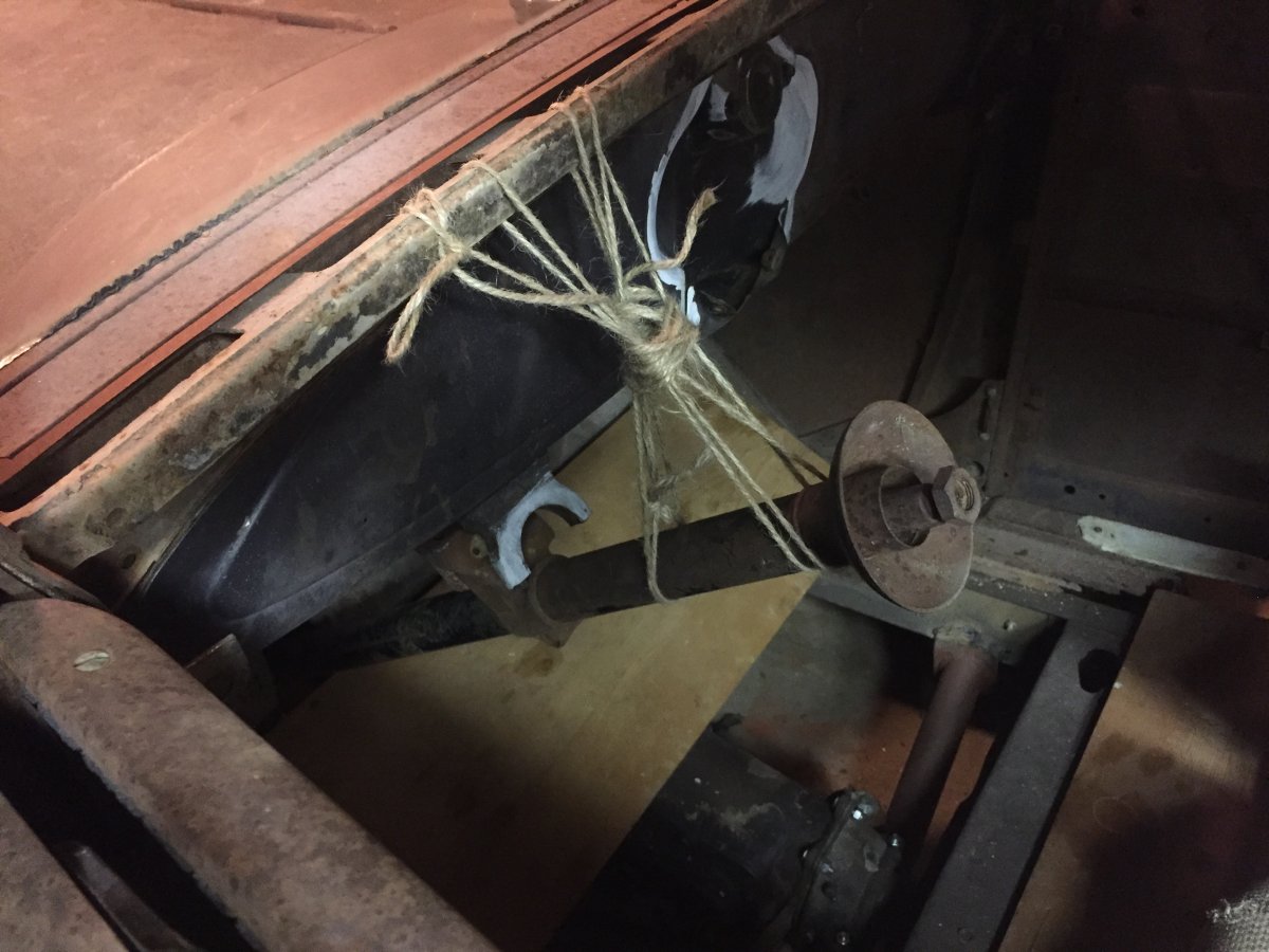

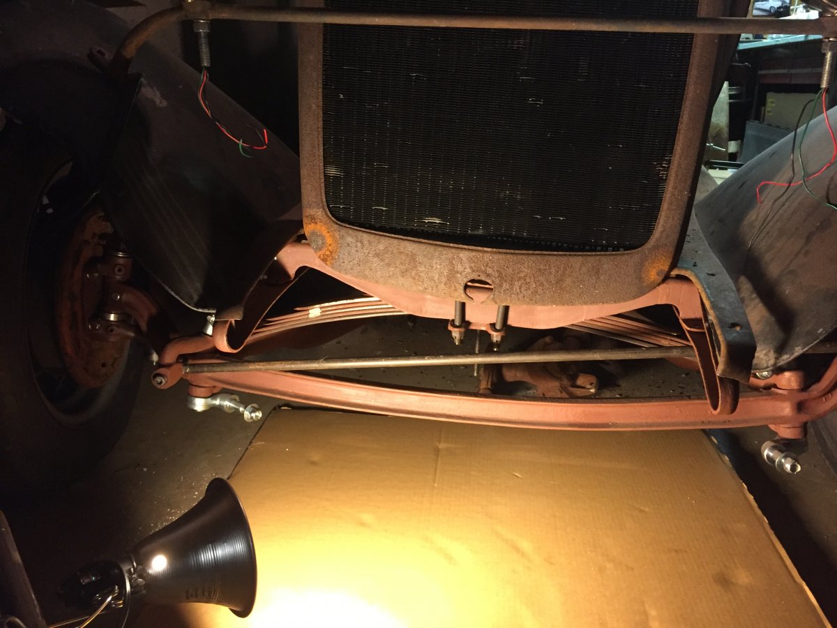

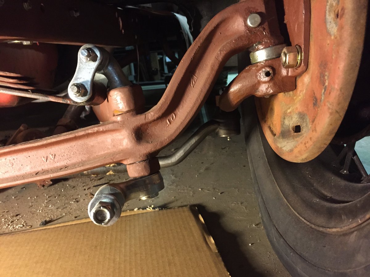

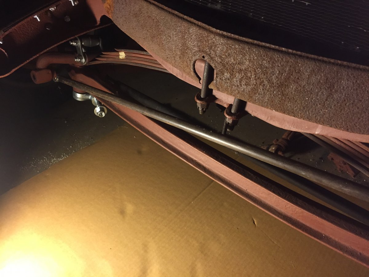

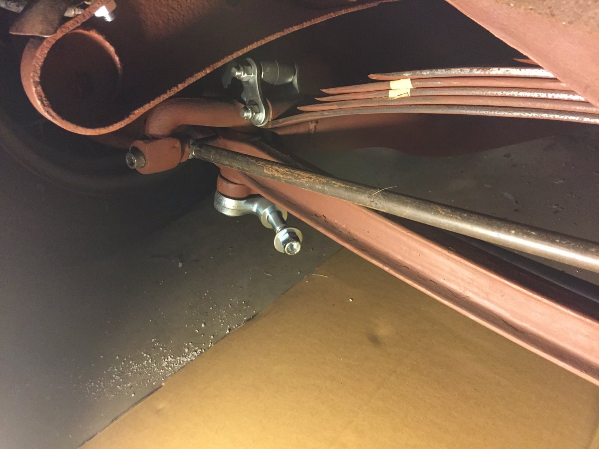

    Well @porkn****** chopped a big section out of a tie rod and burnt it back together for me today so I finally got to attach these dropped rod ends together :) 6CFEE10A-2833-48C7-9529-E89FE8321E8C.jpeg pretty happy with how they mimic the drop in the axle, the tie rod ended up at 35 inches. CFCB1961-3E23-4E48-A001-ABE89E823F78.jpeg Did a quick mock up of how I’m planing on running the pan hard bar with some heim joints and tube. Looking like I should be able to sneak it behind the splash apron. 3D7E2A0C-F012-4BFB-85A8-86AF91A0F293.jpeg 9CA76DDE-4BC5-4BE9-9328-D7E0CF15DC1C.jpeg DE8362FA-95E7-404D-ADA9-191E2A8F4D15.jpeg Super excited about being able to turn the wheels together after pushing it around with the wheels acting like the shopping cart with then bad caster at best.
    Hopefully in a couple weeks I’ll have the box/ column mounted and be able to actually steer it :)

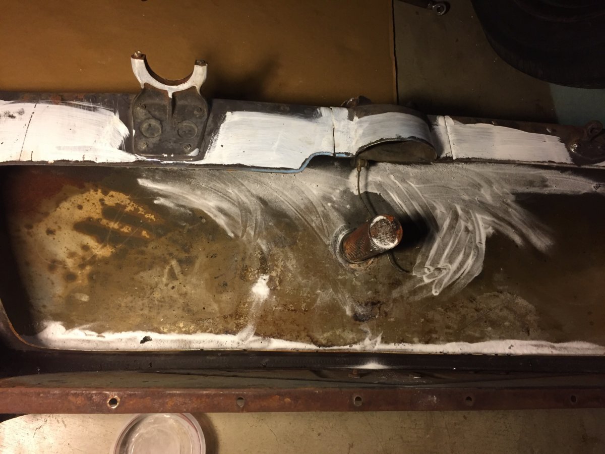

    A861F516-480F-405B-B194-D0AD8B0D15E3.jpeg In tank news it still stinks, not a whole lot though. I smeared some baking soda around to try and soak up some of the stink. Should work well enough to move forward with mocking up.
    I think a lot of the stink is the fill tube under the cap and oddly enough the back of the dent that the instruments set i is just caked in stank.
    Both of those will get cut out in the future so I’m not to concerned about getting them clean right now.

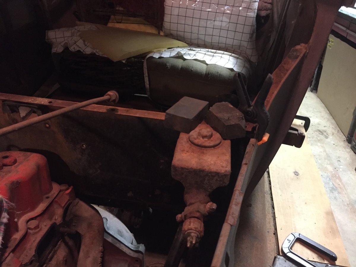

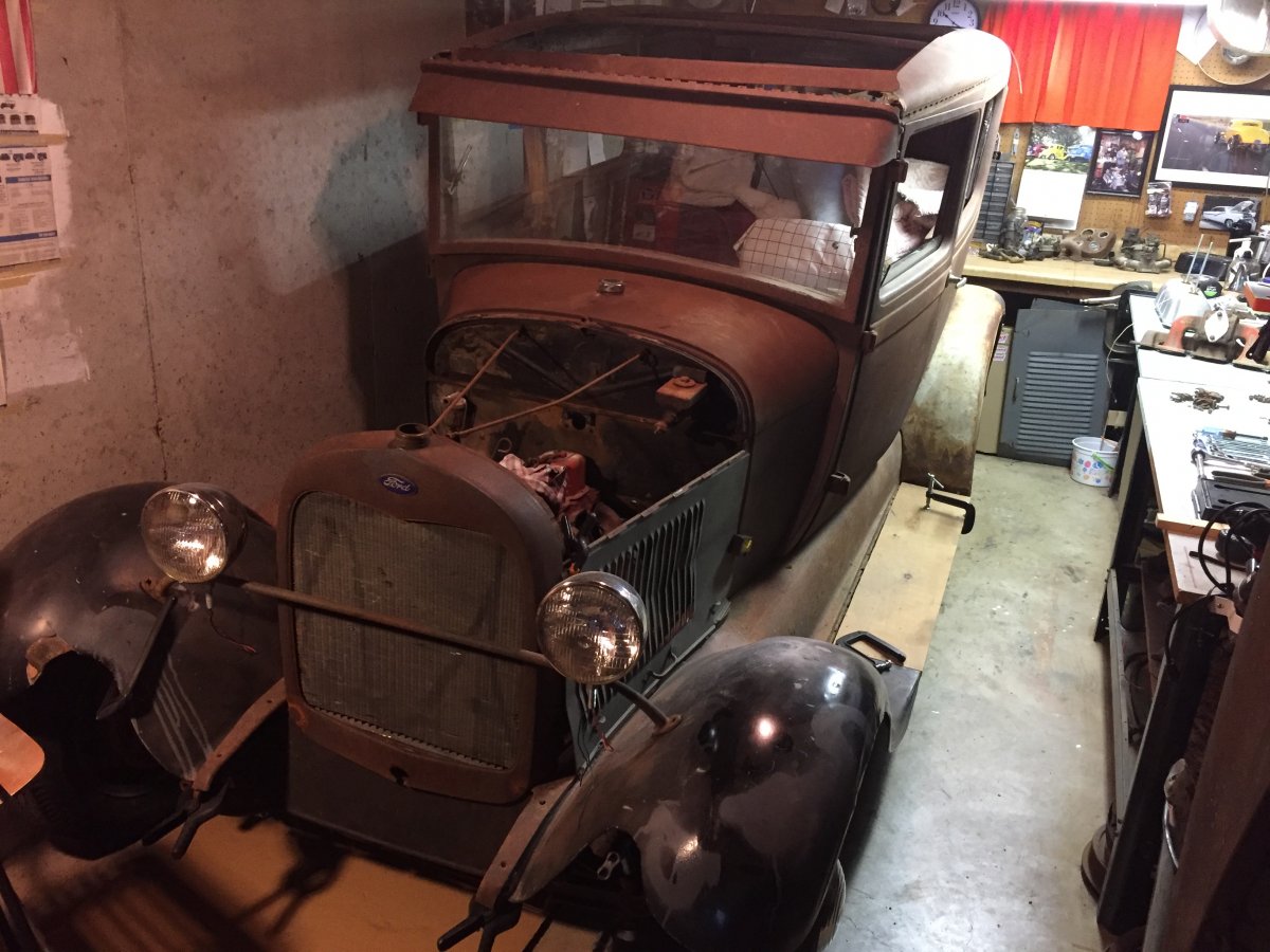

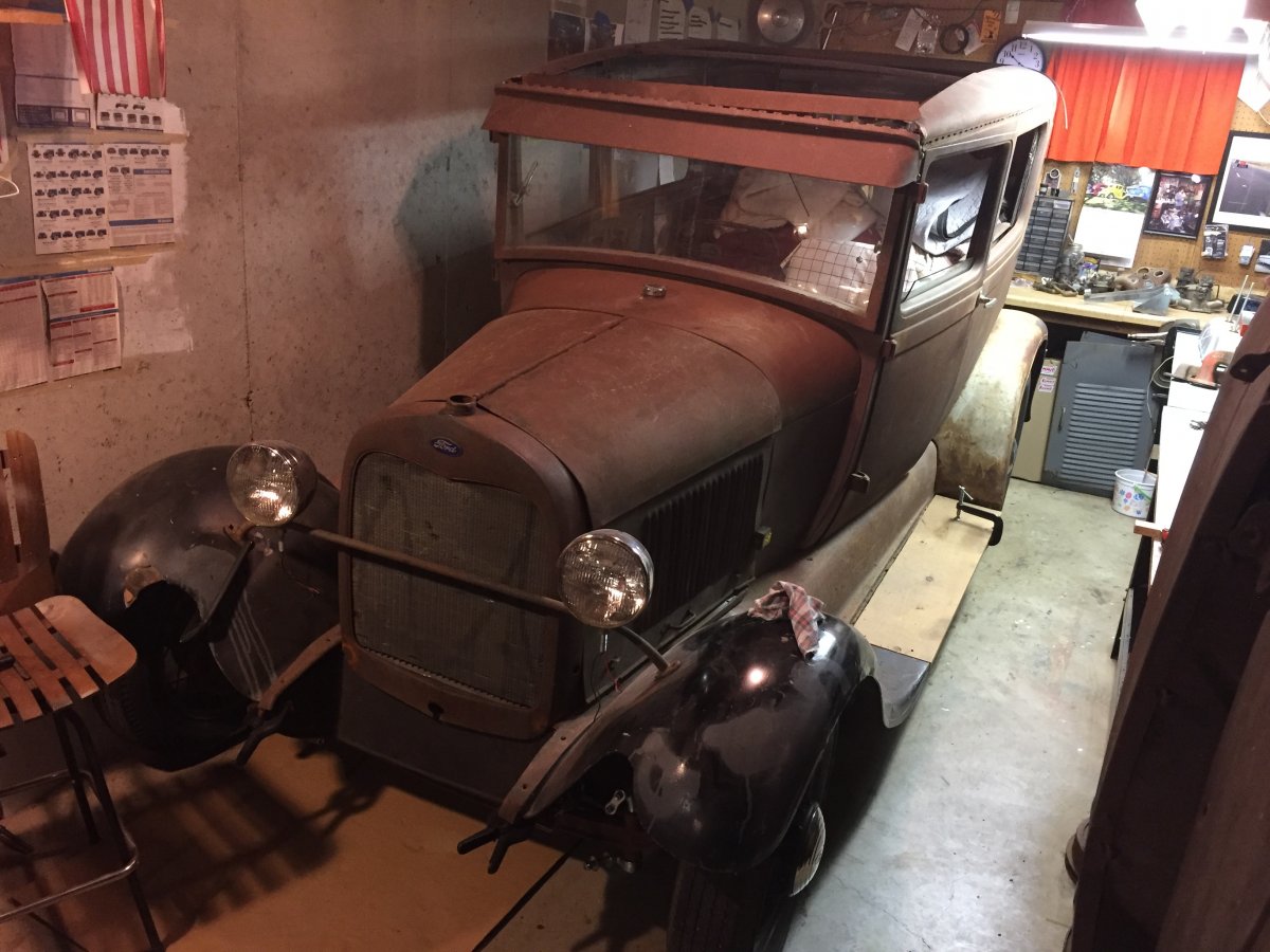

    FC5D7D38-F319-4FDE-8259-D8C8F8504A57.jpeg Used some big magnets to hold a master to the firewall. They will actually mount to the upper firewall but I’ve been curious about hood clearance lately and I was standing there so... A01358FE-2B89-4E04-A4FD-BAEBDCEF15C7.jpeg i clamped this hood side on that resembles bacon on and shoved the master over as far as I felt comfortable. I need to account for the downward slope of the hood top but I’m thinking the location I have in mind should clear just fine 61D190FA-03C1-4721-99BC-67E761DC0856.jpeg Man lots of room, @Austin kays and I shook our heads at what a mess it must be to shove a hemi in one of these.
    Won’t know till I’m further along but seems like I should clear my proposed carb location and be able to remove everything easily like I had invisioned

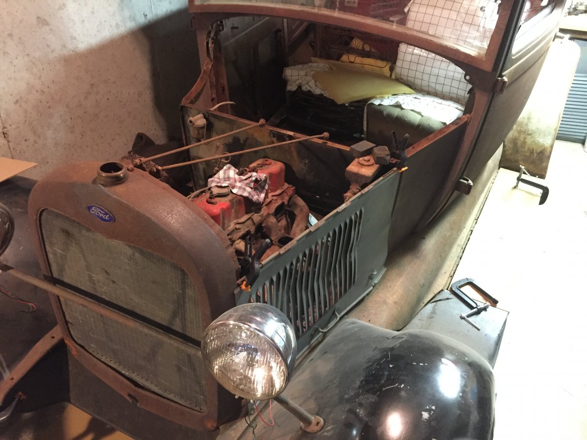

    Got the steering mocked up and some other little things. Threw the hood back on and remembered how poorly it fits lol
    B9CD477A-0A84-4156-BB51-113BBFB8DE75.jpeg Plan is to chop the stock column supported in half, drill and tap it and bolt the one on the column to it. May end up sliding the support up the steering column a little bit first DB979FD2-CC43-44FA-B1DB-D1BB210D1CFB.jpeg
    Fancy mock up tools right? Lol whatever works.
    Need to get the column lock unlocked so I can check pitman arm to oil pan clearance before I go any further on that end of things.

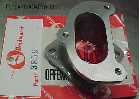

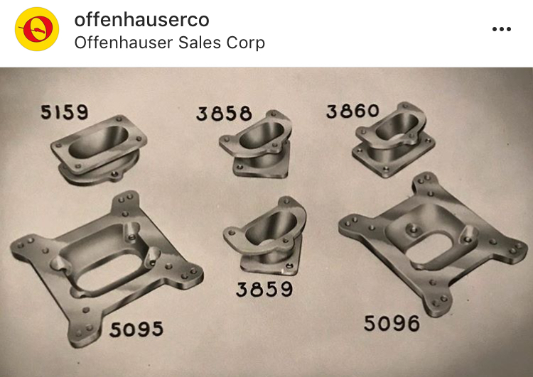

    7E3E2FFF-0FF0-4DA4-BD3E-952F229A67F2.jpeg D6E61FFB-5735-4397-914C-F299C0D56F92.jpeg @porkn****** and I were talking about how I’m going to clean up the stock intake and use an offy adapter to run a big 97 and I realized that I do t think I’ve posted a photo of one of them.
    I’m not supper stoked on it raising the carb up that high but I figure I’ll get the dimensions and make a mock up out of wood to see what it looks like.
    I kinda like the idea of the carb sitting lower though it does seem like there make some advantage to the riser.
    Anyhow pictures

    Great Progress! When I first built the 270 GMC for my pickup I only had the stock intake. I put one of those adapters on it with a GM two jet and it ran great.
    Tim likes this.
  29. Tim
    Posts: 21,587
    @Six Ball bout how tall do you figure it was? The adapter
  30. Can you just make your own flat adapter?
    Tim likes this.
