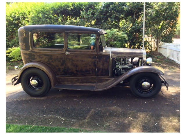

    Right? I might hang the main on my wall just for the optical illusion haha.
    I think it will kinda look like a 1948 ish hotrod with a later rake and additude. If it doesn't feel aggressive when you look at it parked it's just an old car in my head. That make sense?

    I believe you will have issues with the f100 brakes and the wire wheels. Other than that. Looks great. I love the plan.

    @Hitchhiker I've got it covered.
    My wife, ******, any one within ear shot and anyone that owns any relatable items had to listen to me drone on and obsess over it for about 6 weeks. Lol.
    I'll cover what I end up with when I get there... But thanks for the intended heads up :)

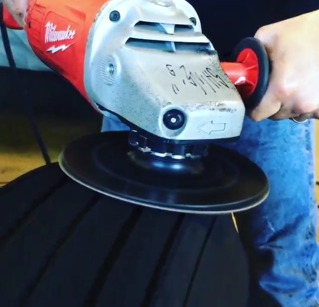

    I recently saw someone with the car on jack stands- fender less car- and with the tire rolling just skimmed the tire road surface with an angle Grinder with some sort of scotch bright pad looking disc on it trying to get it round.
    Figure it's good info to have knowing that these tires aren't always round and shipping stuff back and forth typically
    Is less than fun.

    Well turns out he was doing it for some cosmetic reason~ show car~ but I have seen people shave tires to round them.
    Took a screen shot of the video anyways.....
    The tire moved/spun from the tool rotation I think.
    Seems like it'd make a nice mess this way, normally I see more in the way of ribbons shaved off when rounding them out.
    Wonder if a semi/ tractor trailer tire place would do that sort of thing? Seems like something you'd find there
