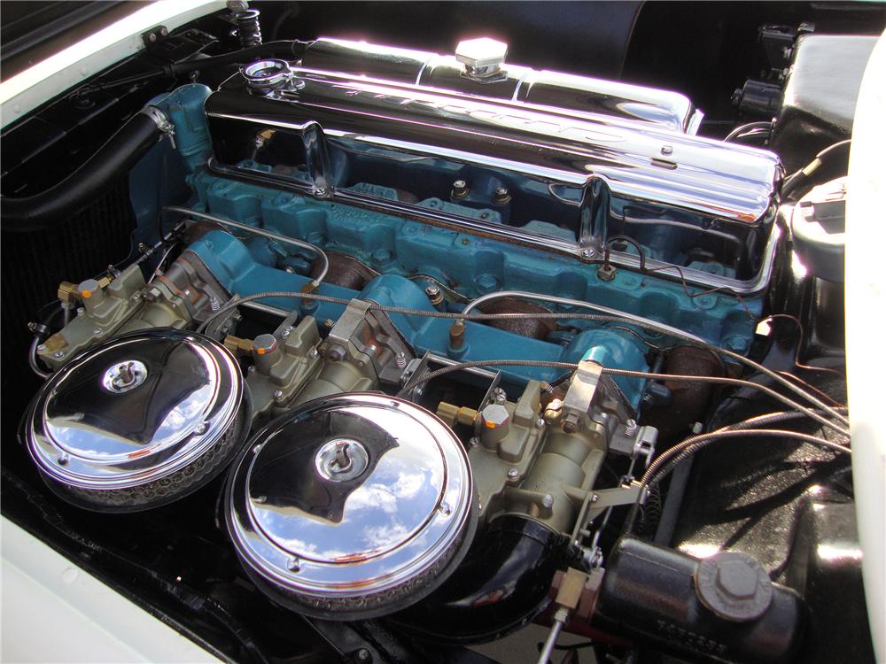

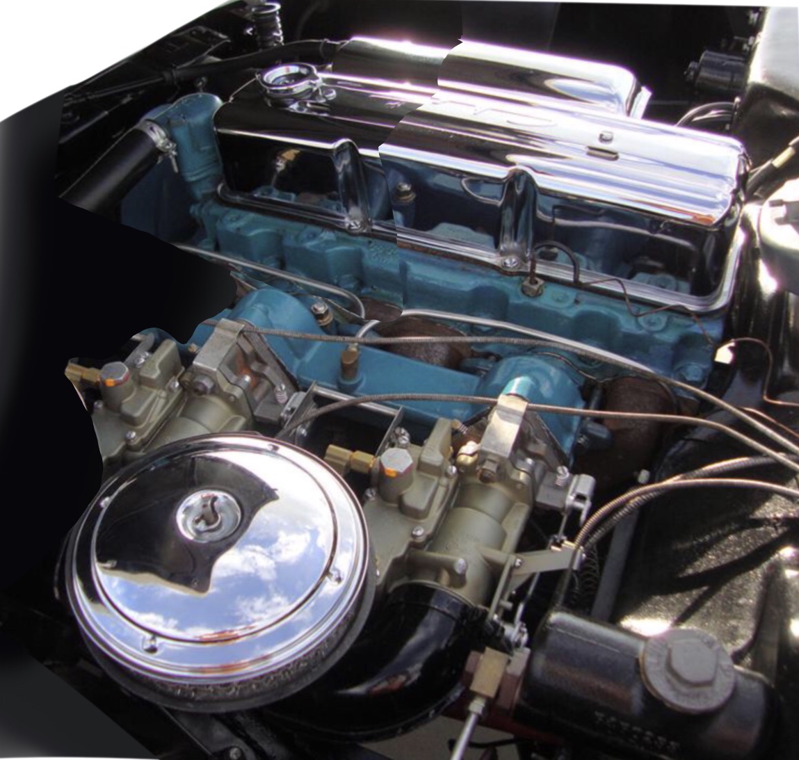

    a friend suggested two carter yh side drafts which would land me pretty dead on to my ideal cfm and they had a neat air cleaner set up or two I could copy from the triple carb set up on vette’s but I’m not sure I like that visual.

    In the 60s I had a '40 Chevy pickup with a 261 and a Corvette intake with 3 YHs. The front of the hood on the left side would not quite latch. That old truck would only do about 80 mph bot it would do it between streetlights. I think vintage side drafts would be cool. Zenith mad a carb that could be refigured to be side or down draft. They are very hard to find.
    Tim likes this.

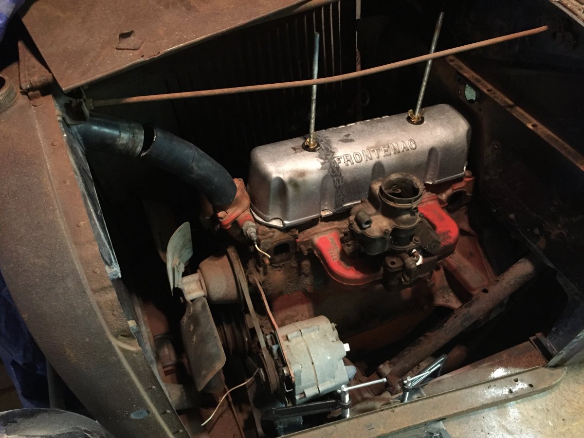

    39A8FE99-7515-4C1D-BEB1-B6878B051588.jpeg Hmmmm, yeah I can see that causing hood interference
    brEad and kidcampbell71 like this.
  10. But think how cool they will be poking through the side of the hood! ;)
    barrnone50, brEad and JOYFLEA like this.

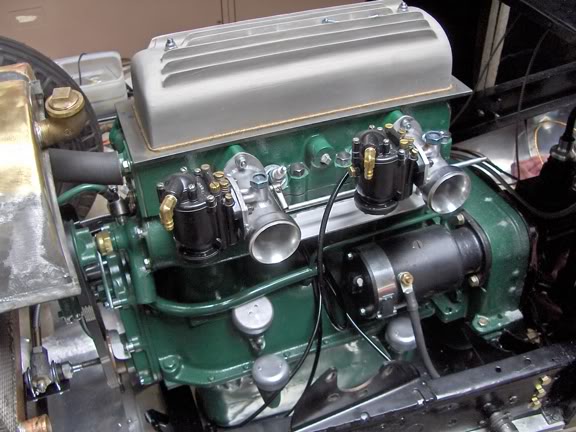

    Here are some sid drafts on the Spurgin/Giovanine roadster running the early Chevy four and a 3X1 setup with the Zenith side drafts mentioned above. Note on the four the carbs bolt directly to the head. upload_2017-6-4_20-58-45.jpeg 4899453743_7558ff6a5c_z.jpg 423401_4240216736131_1085283099_n-1.jpg
    chop job and Tim like this.

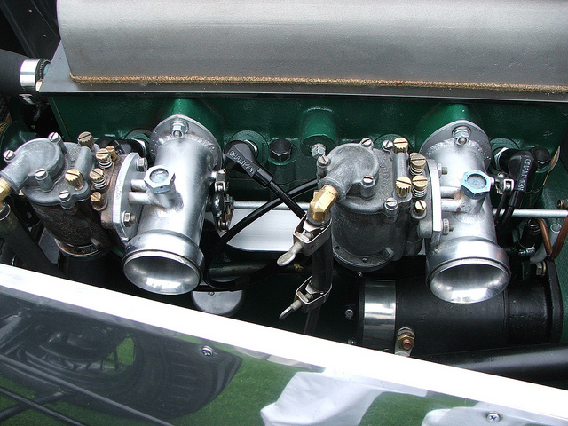

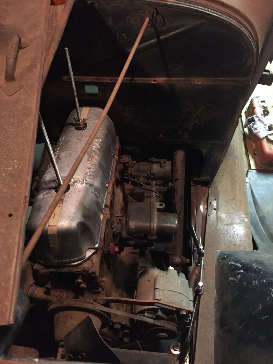

    Played a little bit this morning before heading to work...
    Bolted some random 40’s carters to the head to get an idea of actual space available.
    Think I’d ditch the vette style filter and do a small open/ sandwich style filter on each or maybe one long oval that fits both of I can find an easy to source filter.
    I’d have to keep the intake manifold really short. Thinking real short with some sort of balance tube may work. 9E2420F1-680C-47C6-B24C-9CC2044F18AB.jpeg Hung this little sbc header on while I was at it.
    Havnt got far enough to see if it actualy clears the stock single intake or it id would let me bolt the side drafts in real close but I’m jist having fun bolting stuff to it for the moment.
    The side drafts would certainly de clutter the space visually. Could run the balance tube between the carbs under the center exhaust primary’s to tuck it all in.
    Hmmm.
    Just throwing stuff at the wall and seeing what sticks

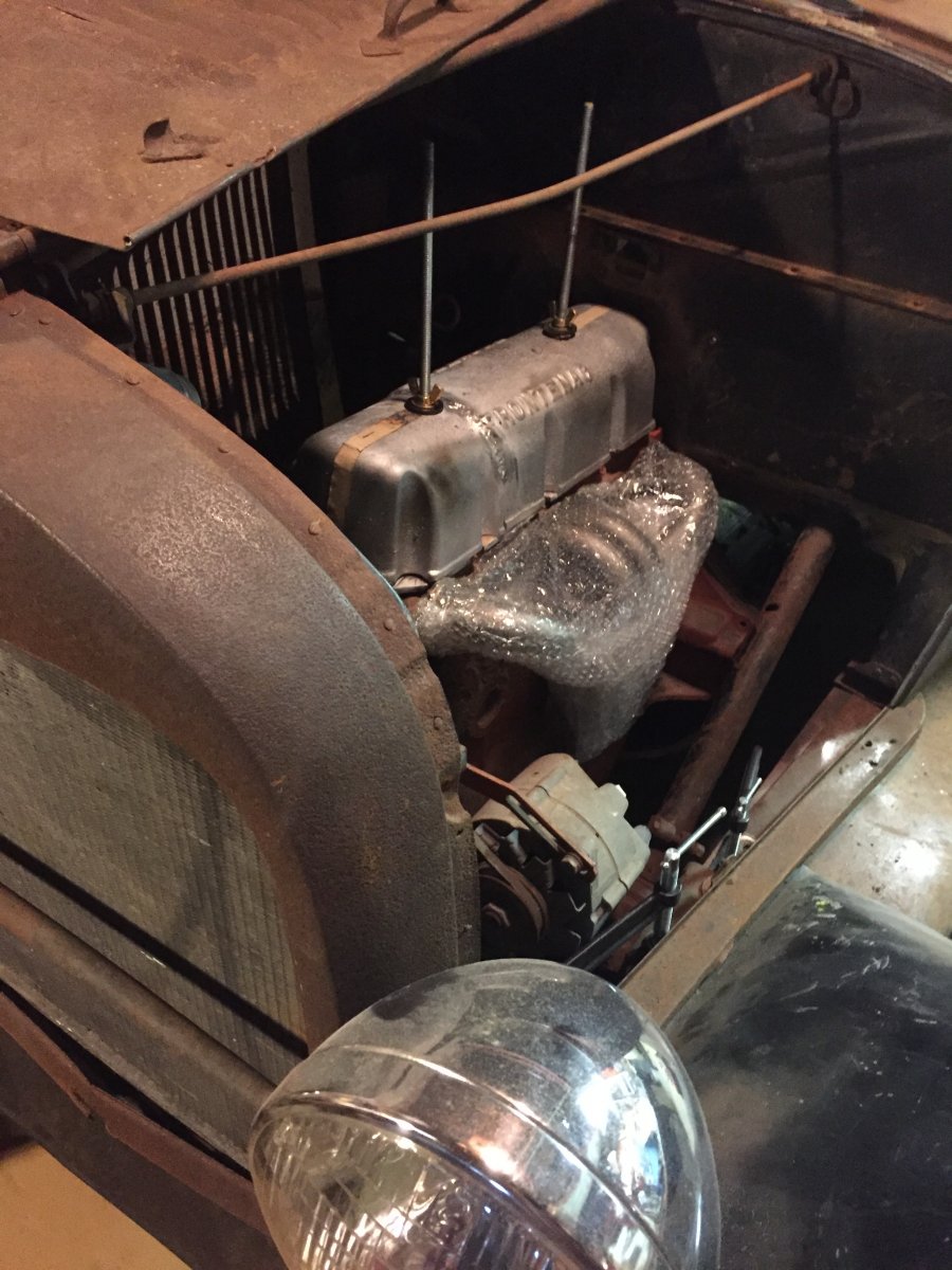

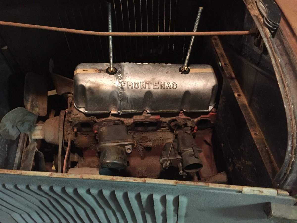

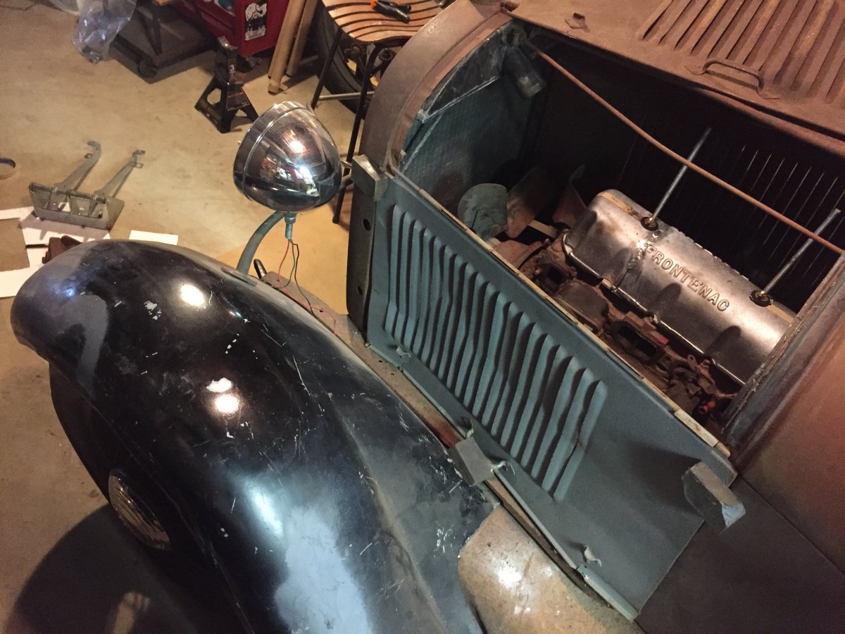

    440AA2D5-7AE5-4B1D-A889-7001338F4133.jpeg Looks pretty much like the rest of the photos but the valve cover is in one piece, bolted to the adapter, and the adapter finally to the head.
    Needs plenty of finishing. Trimming, filling, sanding and painting but it’s finally on.
    I bolted the thermostat housing on and mocked up a quick upper radiator hose. The housing is going to need a little bit of grinding to fully clear but just barely. A flap disc will probably be enough.
    brEad, OFT, 1stGrumpy and 1 other person like this.
