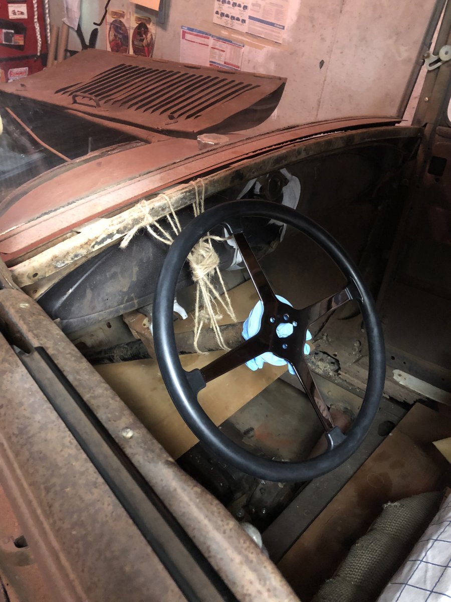

    Still not working on the A but this morning my little girl was good to me for father’s day and I got this rad bell style wheel for the car and matching Mcphail hotrod shirts :)
    The painting will get framed for my space at work :D

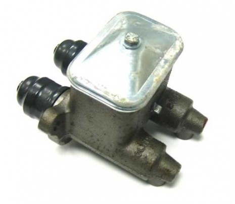

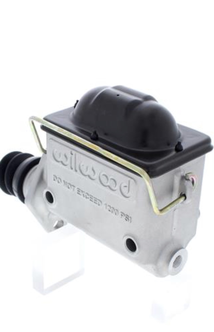

    Now, I’m normaly the first guy to wrech at a modern master cylinder mounted on a firewall let alone on a car trying to fit an earlier period.
    But these 40’s ford masters just aren’t growing on me. Just bulky and... well I’m just not feeling it.
    If it were one, maybe. If it were a v8 where visual focus was shifted over maybe. But in this case where the intake and the masters will be so close to each other I just had to go hunting.
    These willwood masters are sold as a brake or clutch master. They are slightly shorter than a 40’s ford, and I actually really kinda dig the lid shape and over all the shape is a little more pleasing.
    I’m thinking I’ll run a pair of them with the logo and lettering smoothed off and then painted in a hammer tone paint. I’m thinking black but a dark charcoal could work too. C8D14829-B684-4580-BD2B-B1495D5BD149.jpeg Latest obsession is back to mounting the ansen style pedals and and bracing it all with the steering column.

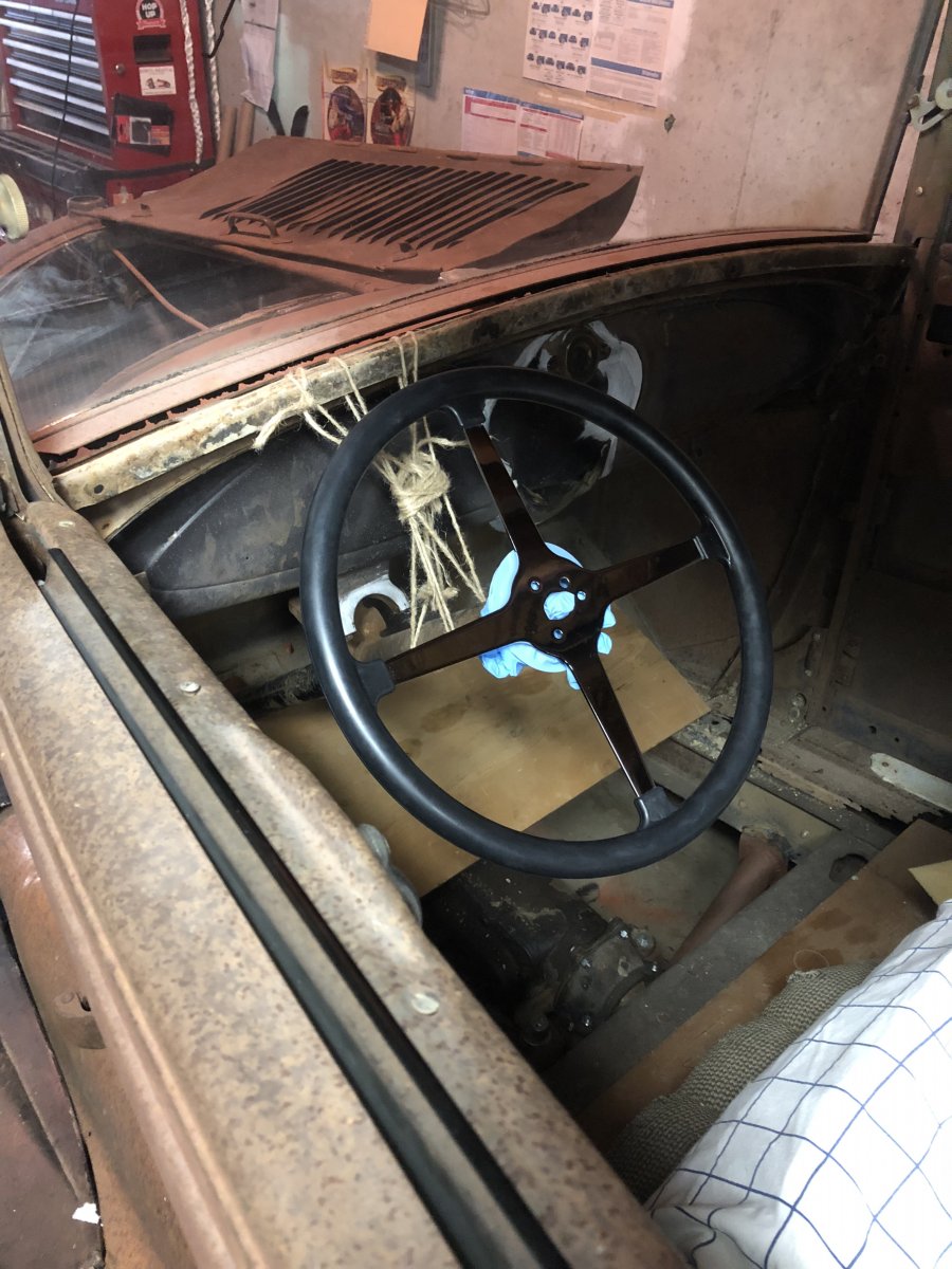

    E02480AB-EC1D-45A7-B9B9-424F7433704E.jpeg 37DC598B-0BDD-488B-B96C-CE12F5BE5828.jpeg
    And because no one likes a post with no photos lol.
    I’d been thinking about wrapping my nice new wheel on Saran Wrap and trying it on for size on my rusty column. This afternoon it hit me that I could just put a glove over the bell with a finger over the shaft.
    It’s probably going to move up a bit, I’m going to saw off the stock A column support and use the truck unit mounted a little further back. About where it is in the photo actually
    Dash rail is off in this photo but I think my fat hands should clear everything just fine.
    Though seeing this mocked up does make me wonder about covering the gap I’ll have behind the wheel letting you see into the bell.

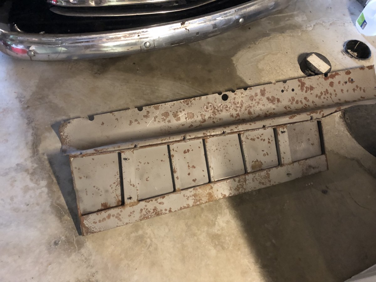

    Daughter and I went out gathering hot rod parts and eating tacos :) here is a little bit of what we drug home 95238BF6-8646-48C9-BDA4-1AB26A15A8B7.jpeg B80C684D-43EA-4C7E-80A9-3034CCF96B0B.jpeg A0DFBCC7-EF92-4857-BD1A-6B756358A5EA.jpeg
    Some brokville splash aprons, home made mega stout running boards, some apron gas tanks and a magnesium halibrand quick change center to replace the stock banjo in my A rear :)
    Got a few more bits but didn’t grab a photo yet.
    Excited for when I can get back on this one :) getting closer on the 46 though. Got the tires mounted and balanced on the new wheels just need to wash the car and mount them up to see if my “vision” was a good idea or not lol

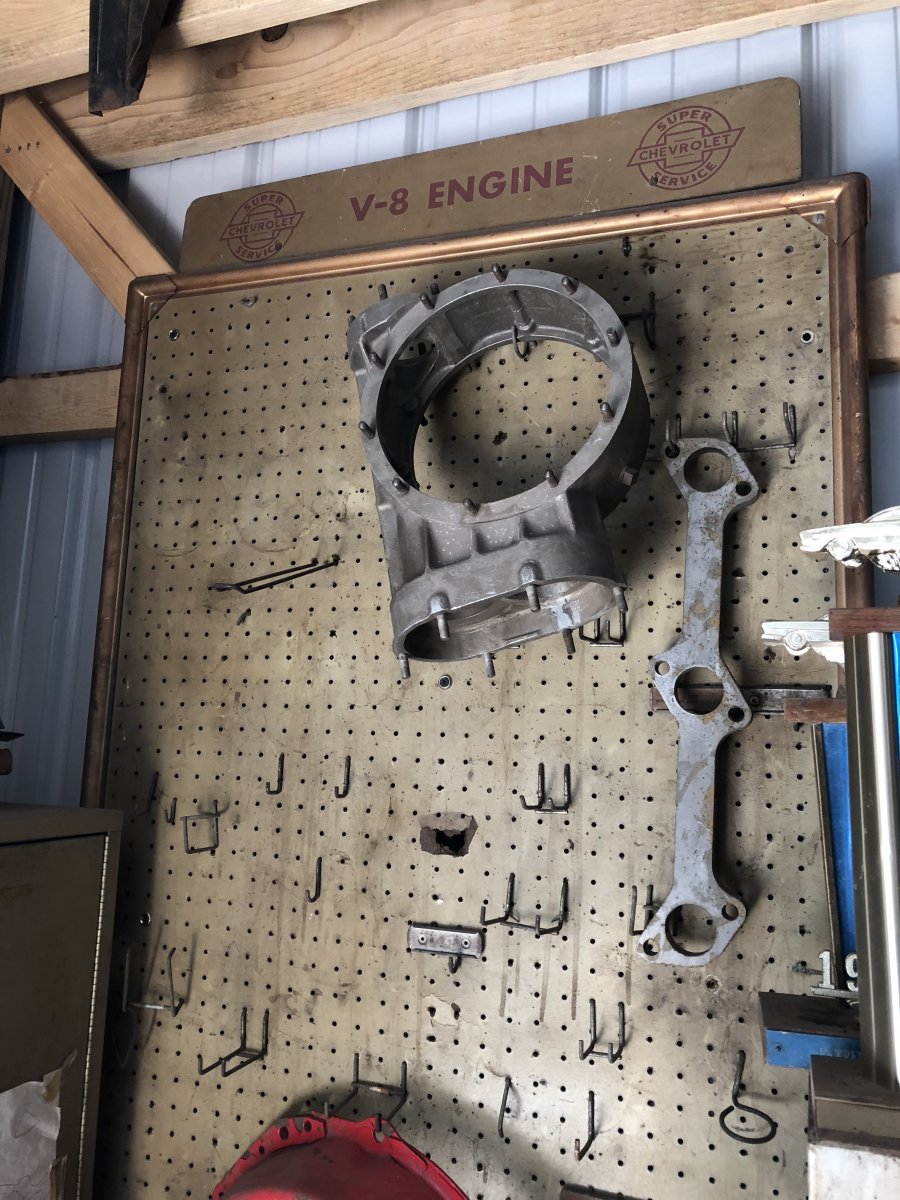

  21. I actually got a pretty trick looking wildwood (as in simple and not lettered) on my shelf in the garage. Never had fluid in it if you want to give it a look this evening.
    Hey why does a banger guy got a V-8 tin can? Where was that when I needed one?

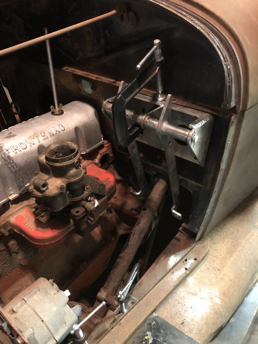

    A23EF57E-0270-4833-A757-071A76A79C47.jpeg Not really a “real” update but my brains been thinking about different brake options and even though this car is not what I’m working on at the moment I had to go measure some stuff.
    Figured out that for my pedals to bottom out close to stock ford. More or less where the toe board meets the lower firewall. I needed to drop the masters.
    Mocked it up on the lower side of the seam instead of the top and it seems just about perfect from where I’m sitting.
    This means-
    1: better pedal placement
    2: way way easier for my brain to wrap around bracing up the firewall
    3: visually looks way better it hanging so high
    4: only have to worry about clearing the single angled hood side instead of the compound shaped hood top
    5: might make throttle linkage a little more creative but gives me TONS of roof for whatever air cleaner I want to use now.
    Still planing on the willwood masters I posted above.
