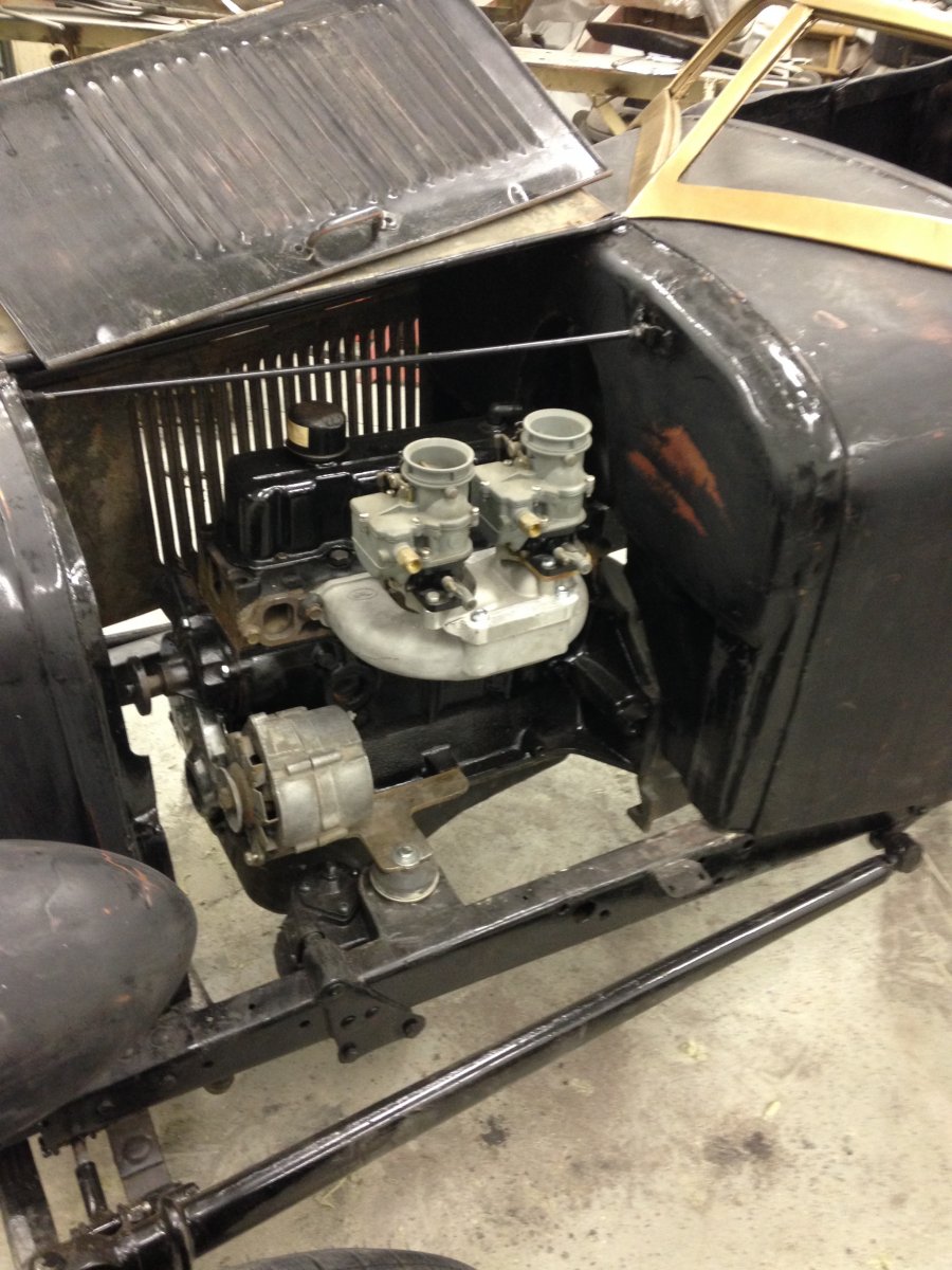

    AE1AD692-94C3-486A-9063-0E4B9D04CABD.jpeg I have no idea how I didn’t think of this but it looks like @justabeater37 is running the Clifford 4 barrel intake with a common adapter to run two 97’s on his 153. Looks pretty good!
  4. Six Ball
    Joined: Oct 8, 2007
    Posts: 7,054
    Six Ball
    from Nevada
    It's too simple we were thinking too hard. :D I'd like to see the other side of this one. Lifted from another thread here.
    fiftyv8, Stogy, Tim and 1 other person like this.

  6. justabeater37
    Joined: Jan 1, 2009
    Posts: 1,845
    justabeater37
    I also have a 3 deuce intake from a 250 I am going to cut down like six ball did. I am worried about sheer and maintaining the mixture with all of the turns the Clifford and adapter have. Possible a turtle in the Clifford may help. Hope to get it going this year after my 63 is done and the Chari-T is gone.

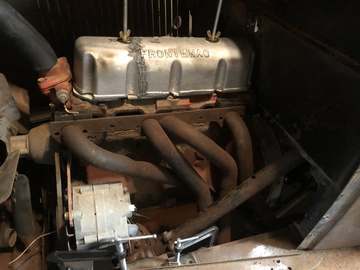

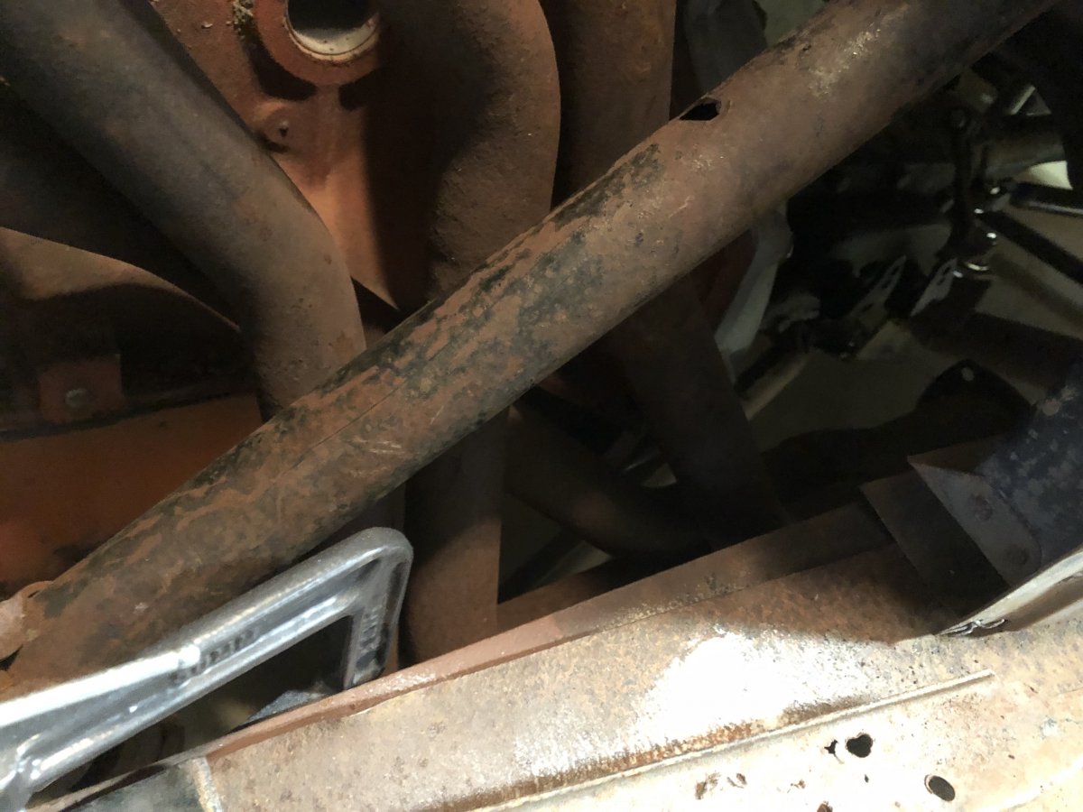

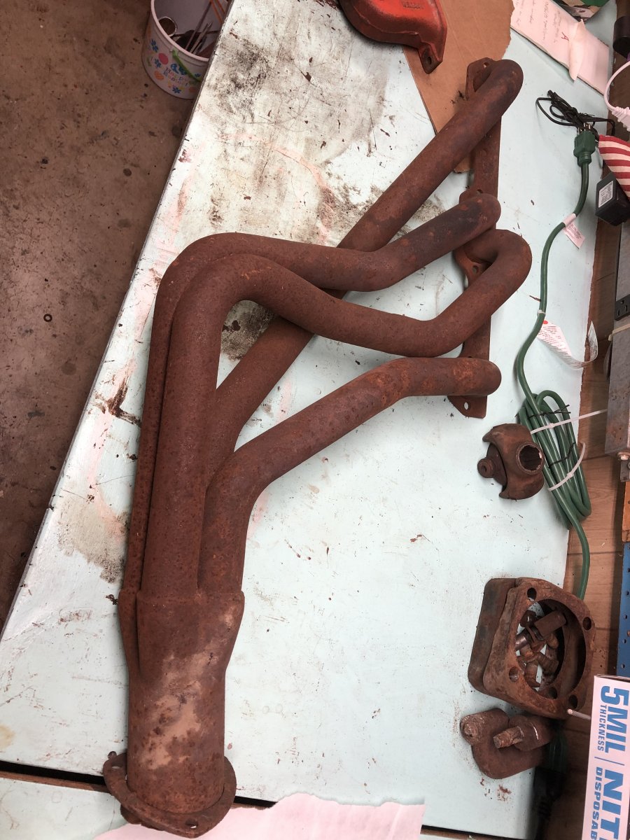

    9A91E6E3-F8C7-4481-808E-6314C59D2445.jpeg Well @Austin kays had these leaning against the wall in his garage when we were wrestling the crossmember swap and so of course I had to try them. DCFD777D-9D67-4988-834C-1062C2B71EB3.jpeg C4E77549-74EE-49CC-BB3C-E6CB257AEED3.jpeg 854CCF32-CDF5-404F-92D0-5AD53AB3F22B.jpeg
    Surprisingly the clearnpretty much everything! Didn’t have to move anything and they snaked right down in there. I have them spaced off the head about an inch and the only thing in the way would be the two center primary’s coming out to far and hitting the intake.
    I think they came of a 4x4 c10 I’ll have to see if I can find them in a catalog. They don’t look quite as “old times” as I’d like but I’ve been struggling with the idea of spending s good chunk of cash making the head flow and the. Sticking a restrictive header/manifold on it. So I might give this some more consideration.

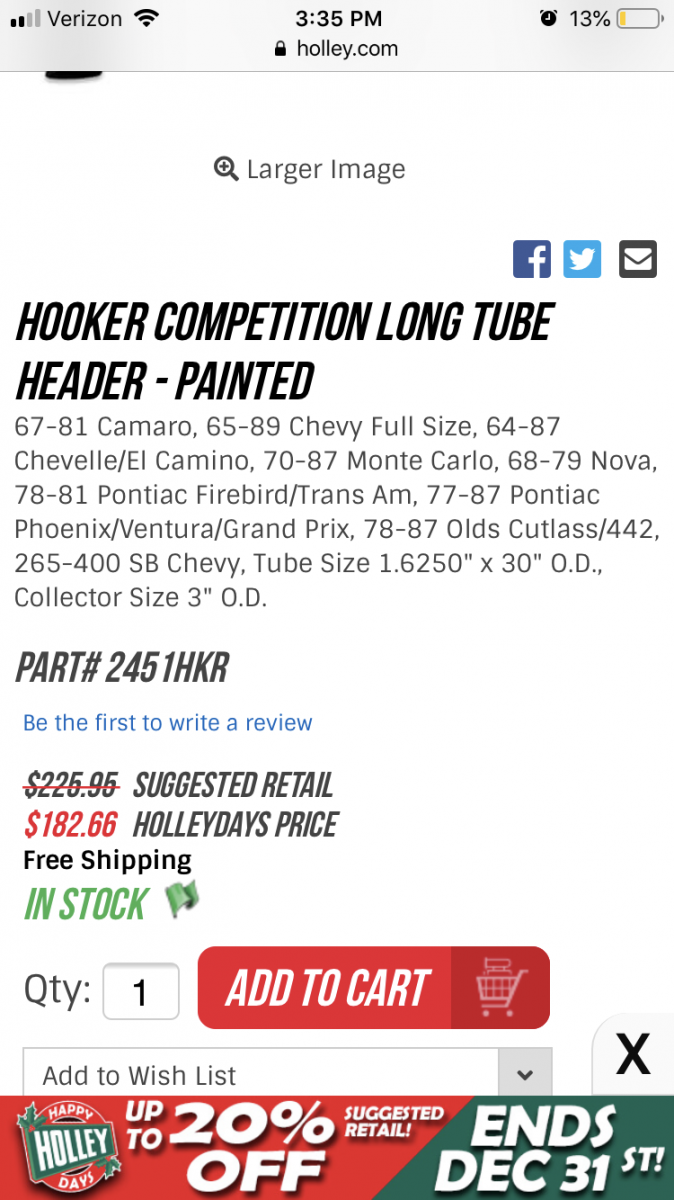

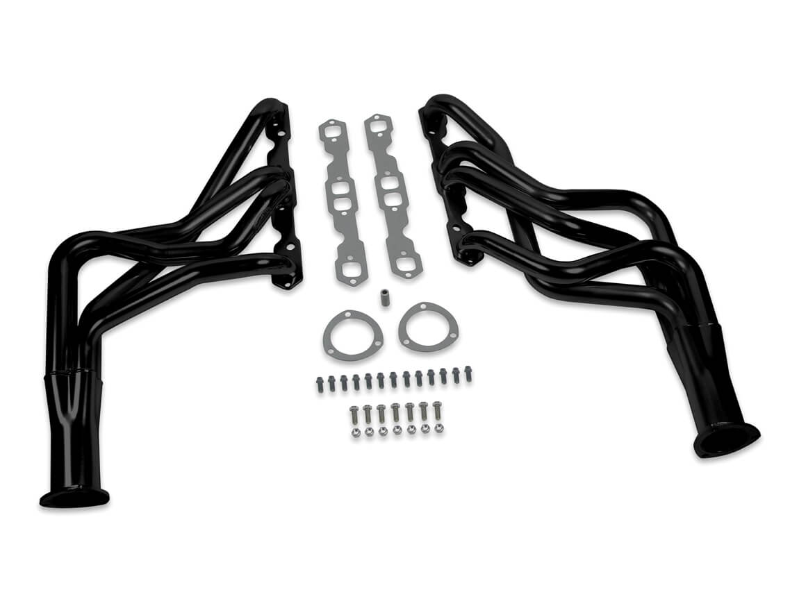

    Mostly because I’ll forget if I do t post it here but I’m pretty sure these are what those headers are. ****** is the only one I’m finding with that funny bend off the center primary FDA1FA0F-0581-430F-A37B-79C7688D2638.png 513E9F76-4119-4F23-A35C-8BF9A14CCF49.jpeg
    brEad likes this.
  14. justabeater37
    Joined: Jan 1, 2009
    Posts: 1,845
    justabeater37
    Look about right. I have a couple sets of them around. I should see if it clears the manifold.

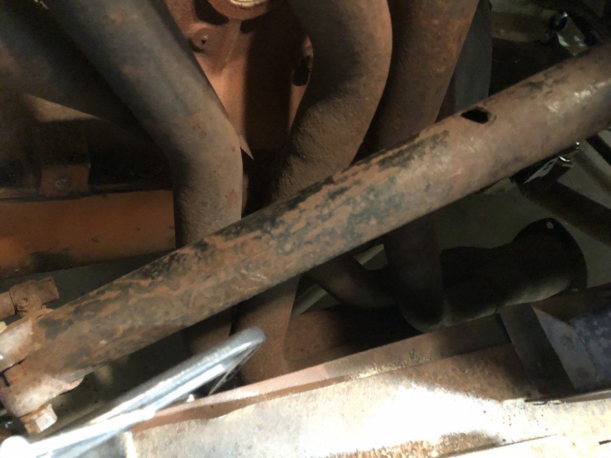

    It hits the heat riser on my stock manifold. Thinking I could build a tube manifold that has a little rise in it simular to a lot of the ones you see for ford bangers

    Yeah, those are the headers I cuss on my '68 flatbed. They make spark plug changes a pain and starter replacement an all day deal. They like to melt plug wires too. One would be much different on a four.

    Yeah I bet.
    It makes me curious if this build a set would fit the same space now that I know that they can clear so easy and clear the steering by lots and lots of room.
    I wouldn’t have to add to the primaries where they meet the flange because they come long, I’d just cut to size. They also look nice and curvy.
    Could use bends from the other half to build an intake lol.
    Just say dreaming for the moment but it does give some possibility.
    Curious if anyone cuts new flanges for this motors? Be nice to get intake and exhaust on one single piece.
    brEad likes this.

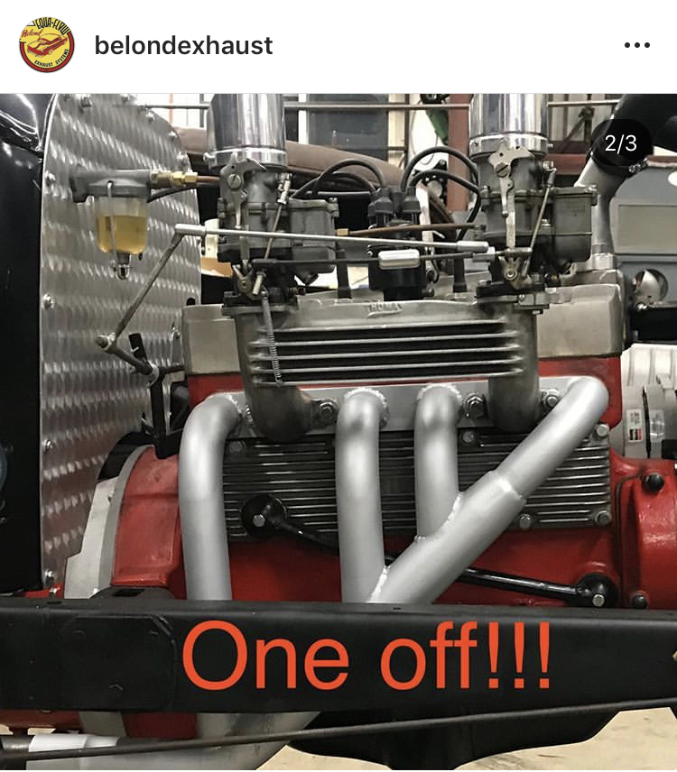

    A newly made, old style, belond header that shows an option for the collector not being the same size as the primary’s. Not real in love with the visible step in the tube but I guess it would flow better than it all being the same size and it looks “era correct”
    Can’t believe that the intake and exhaust has been the thing I’ve been the most hung up on with this car lol A7CD2A5B-1504-47BD-9567-41EBA2BE9182.jpeg 896DB0C9-6B81-4E59-B03C-6C6DE9182436.jpeg

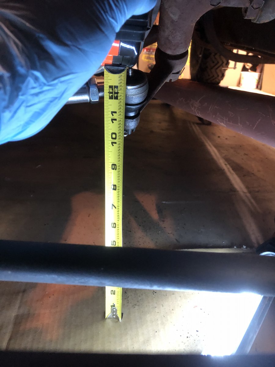

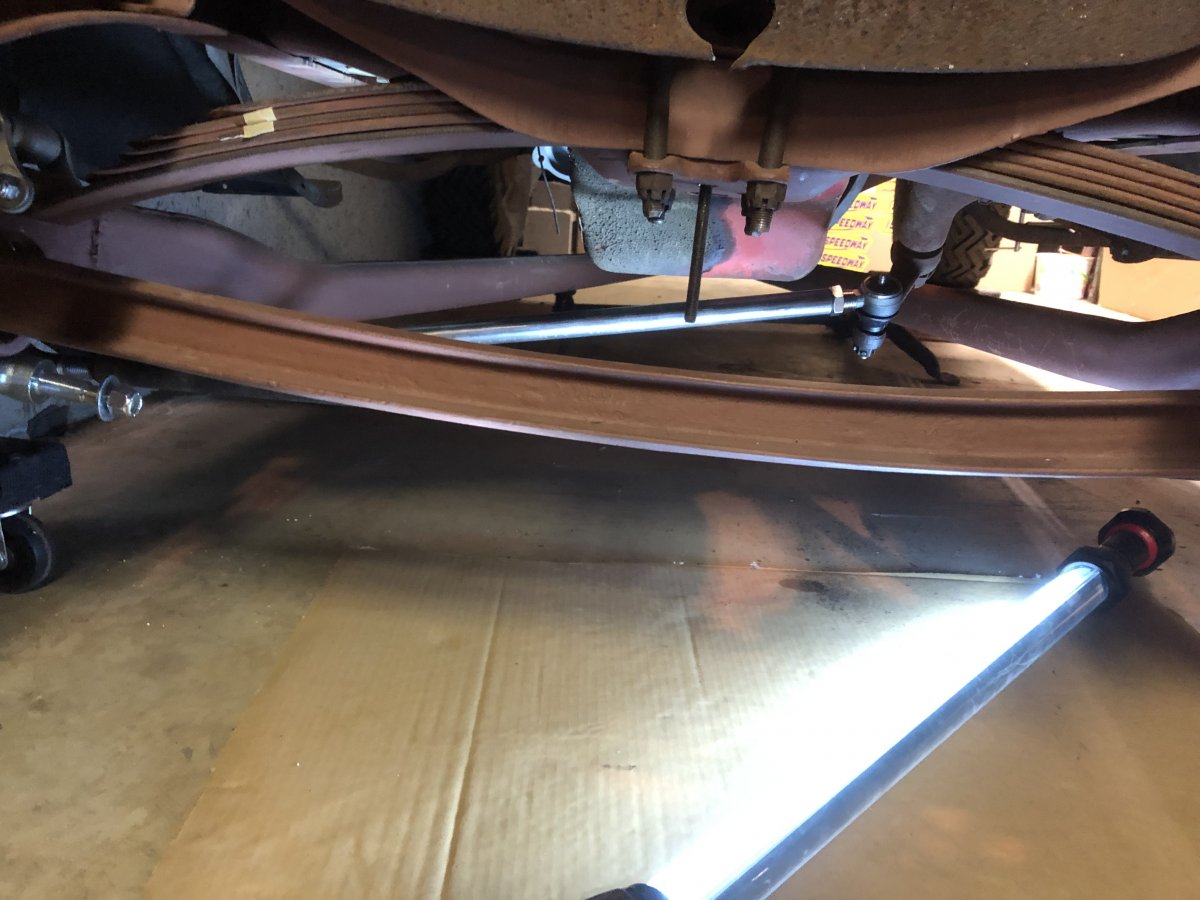

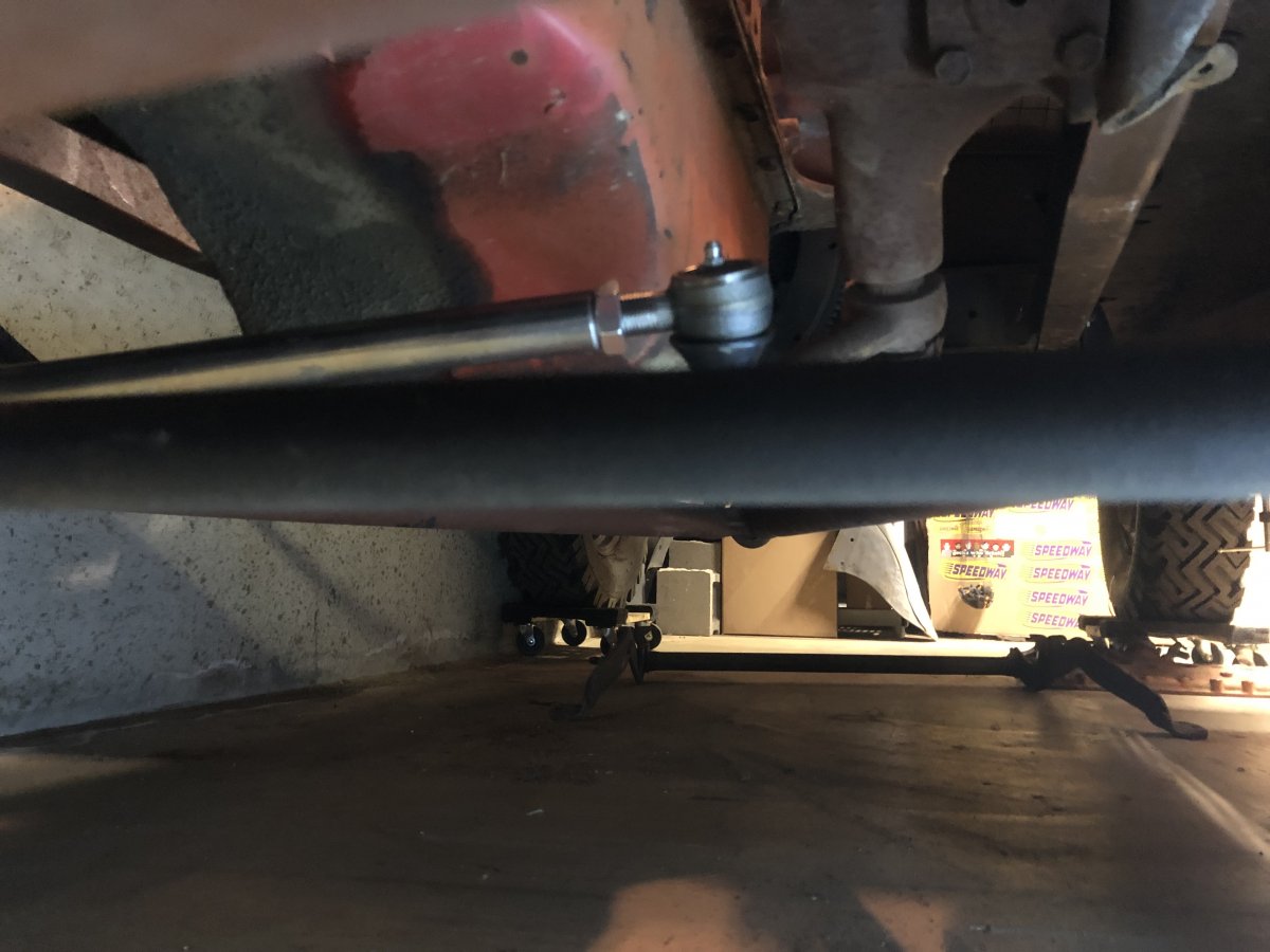

    6B9A8C72-D085-41CF-894C-2B39DA2432D8.jpeg Thought I’d blow your minds and post something that isn’t about a damn header.

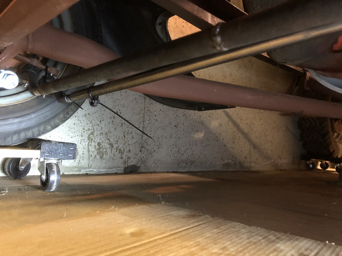

    I got a drag link and rod ends for Christmas! I used another of the dropped ends on one side and a standard tie rod end on the box side of things 0287E5B8-827C-483B-9B11-EFB891DBE569.jpeg as you can see here the drag link runs up hill to the pitman arm a little. It looks exaggerated with the angle and lighting BCA0C769-494F-48E6-82E2-FD553C963619.jpeg tie rod lands about 9.5 to the top from the ground ~ car is sitting on dollies right now it’s not actually that high
    F801360C-DC6C-46C9-B393-EE847279516E.jpeg The drag link is closer to 11.5 A59AF1FE-6AF3-4163-BAC8-39CBFFFC2379.jpeg My plan to get them pretty close to level is to taper the pitman arm from the bottom and flip the rod end around.
    I already need to taper the bottom of the p***enger side steering arm to hand the rod off it so it’s just one more hole to do. Then it’s on to cementing the box mount as it’s only hanging by a few bolts and a clamp. Then drilling the set pin out of the column lock so I can see if I get to driveway steer this thing before the box gets rebuilt or not.

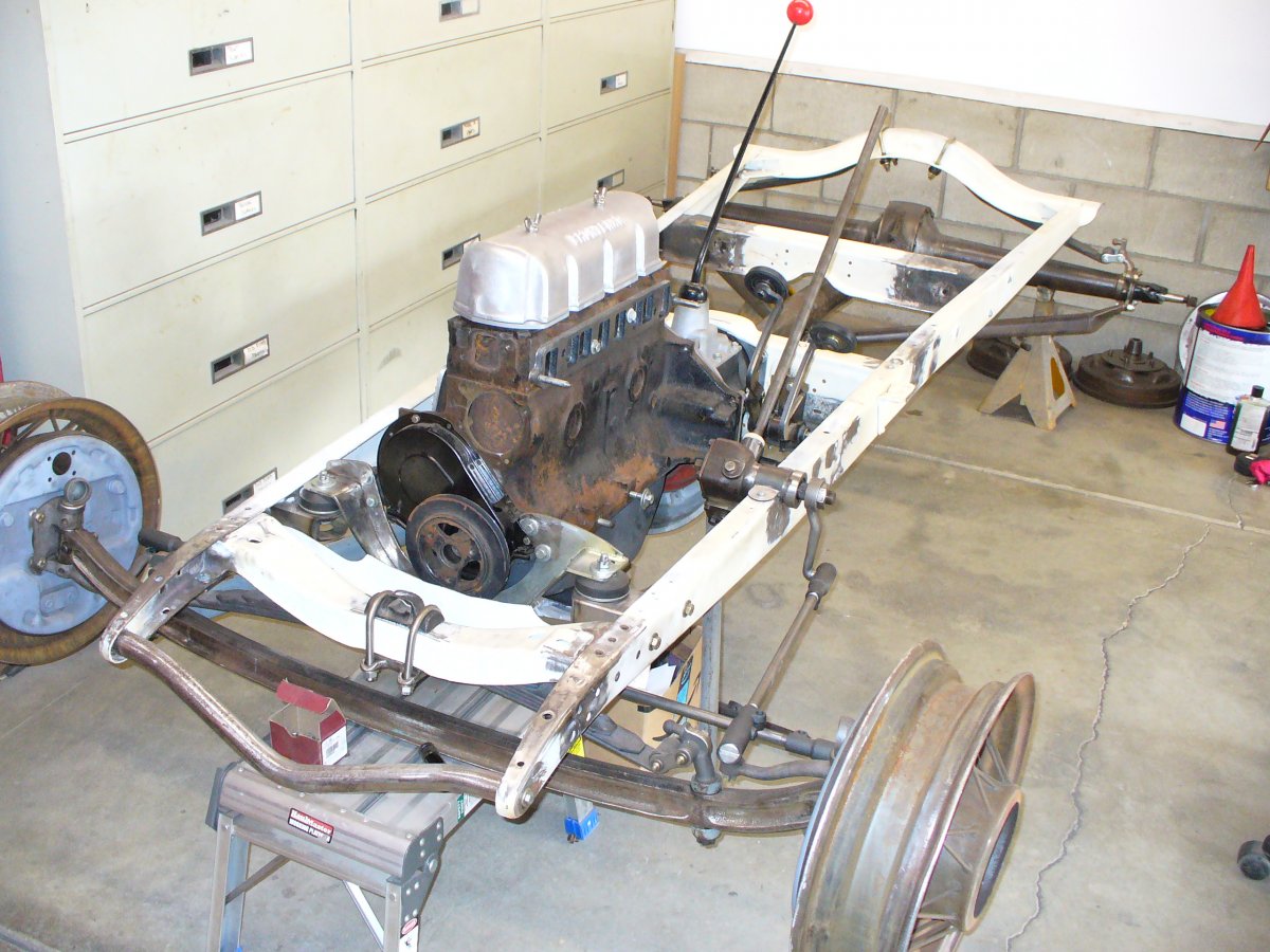

    Looks like @sdroadster is building a merc/Chevy A as well! Looks like he’s got the same cover I’m using mocked up and had mentioned running a dual carb intake for a banger like in some of the photos we’ve shared previously.

    Curious to see how others make it work. I ended up cutting mine in half because it wouldn’t clear the fire wall/ thermostat housing if I didn’t.
    I feel like it looks better with out the over hang so I suppose I’m happy with my choice to cut it instead of the firewall but it sure did open a can of worms that I still haven’t totally
