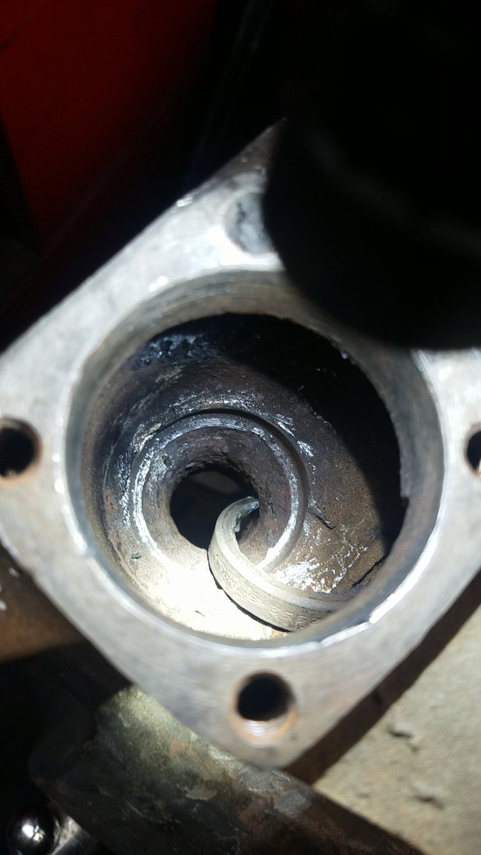

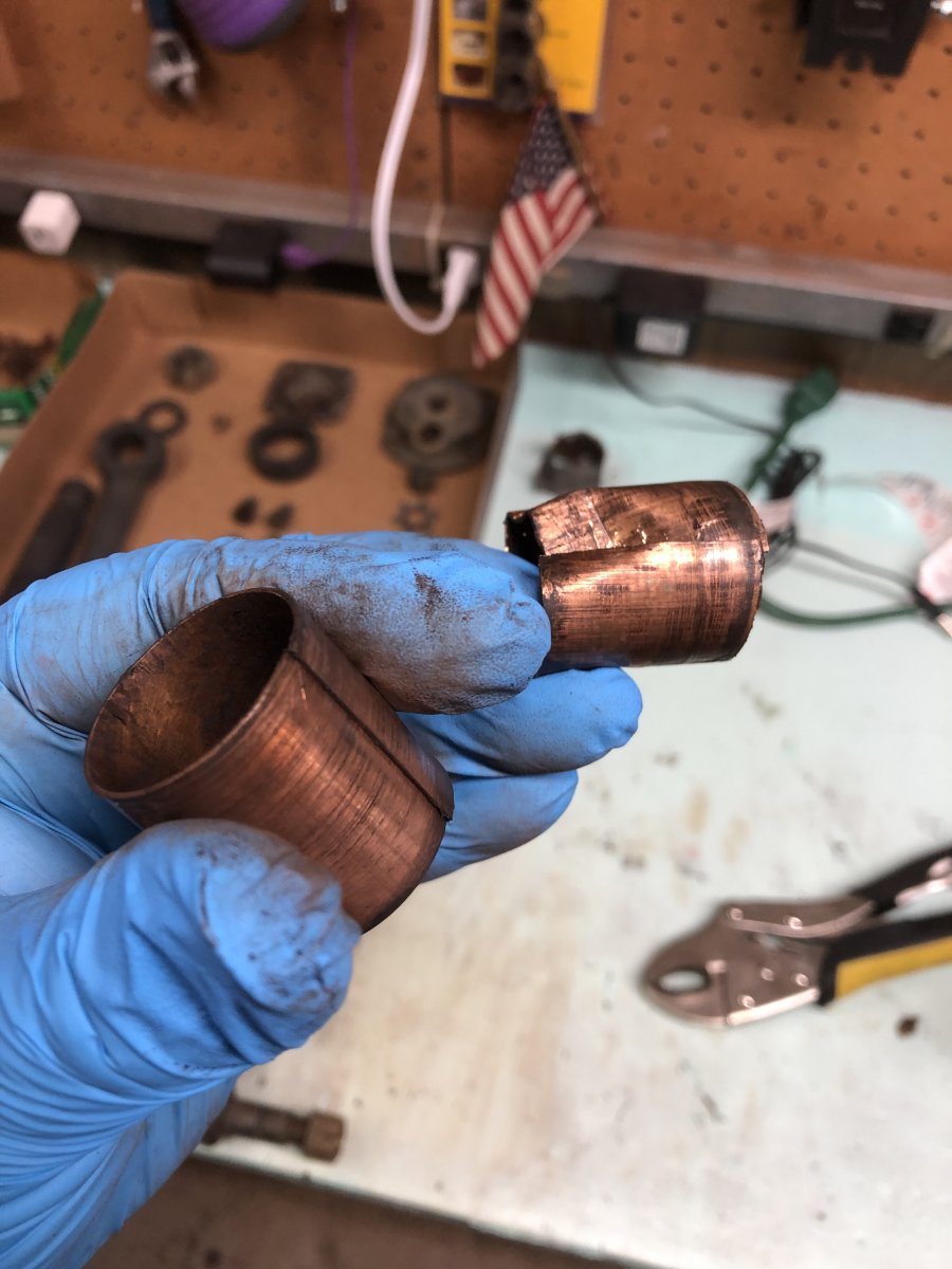

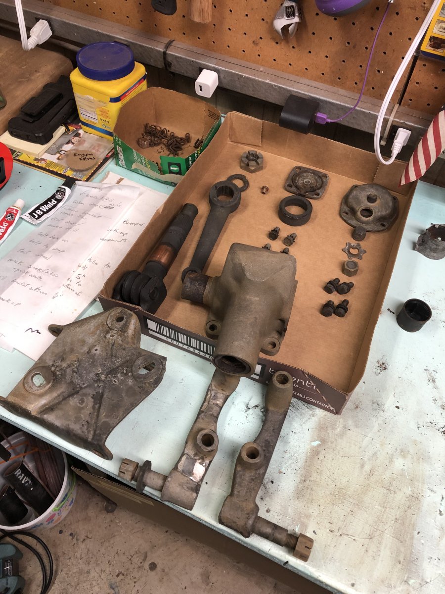

    Chipping away at getting the box empty. I got the remaining sector shaft bushing out after curling it into itself a bit, and the one that came out on the sector was easy to spring and then slide off.
    The sector seal is about half way there. I think I’m going to use a dremel and cut a notch out so I can spin it lose. The upper bearing and cup for the worm gear is solidly rusted in place with nearly nothing left to push at so I’ll have to get creative with that one but I’m not overly concerned EA920F1F-A8BC-4CAA-8675-E9DB947D51BD.jpeg i did find that in my stash of cardboard that a gift wrapping tube is the exact same size as a 39 column mast so it’ll be perfect for mocking up the new one. I noticed when I sat the new steering wheel on the column on top of the adapter previously that it sat a little further away from the bell than I’d like so this will let me fine tune the gap.
    I guess I don’t really need the bell at the end but it makes it feel like it’s old parts and not new stuff... even though it’s mostly new. D034247F-5002-44FA-AB3F-F6584C70E772.jpeg everything laid out so I can keep track. Still need to smooth those shock mounts out a little more and after @Aaron D posted his shackles where rubbing I might leave them with out paint until I can mock that bit up. The box to frame mount also still has one more crack welded up. 1FAC6952-567C-477F-8ACF-FDDD503FA16D.jpeg 78-3553 finally a number I can read! I’m ***uming that’s the number that’s on the box as well 325419B9-022B-4448-992D-9B02E246B67E.jpeg 18-f on the worm gear. And yes that’s the lower bearing stuck on the end on the left. This thing is toast. I’m considering having a local black smith make me a knife out of this stuff. AC5D12CA-98FA-4BAA-8F45-A4E4888A8605.jpeg cardboard tube sitting on the shaft next to the mast A84AFF15-A040-4ECE-9498-E092A16FE59D.jpeg the old sector bushings
    That’s about all I’ve got for photos at the moment. Trying to get myself to crawl under the 46 and address some things but this is so much more fun.

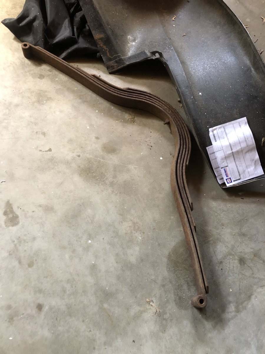

    Oh! And @drdave came threw and has a t spring on its way to me for the back! I’m thinking I’ll clean it all up and do like he did, use the three longest leafs- including the main- and then a couple A leafs on top. Should get the back down nice :)
    Thinking I’ll run a posies super low in the front but this steering box rebuilds taking all that cash. I think if I get time to do the rear spring swap that I’ll just pull all but the main leaf off the front and add a wood spacer to get it all the way down so it at least look right sitting in the garage til I’ve got the money for the new spring. Or who knows maybe I’ll cash by the time that happens :)

    I used the main and the next 4 leaves (5 total) of T spring....those were the only T leaves I had. Then I used the top 4 A leaves, tightening up the radius to match the radius of the T spring better and kick a little reverse curve at the tips of the 4th leaf (from the top) so it didn't dig into the T where it curves back flat. As a side note, I think I'm going to add the 5th (from the top ) A leaf cuz the back is just a smidge lower than I'd like it. Your mileage may vary as you have a tudor with what I ***ume is less weight than my 4dr. ;)
    ....and hey....any leaves out of the T spring you don't end up using, I'd be happy to take those off your hands. Haha (even though I know it will be a while before you can settle on the right combo that works for ya.)

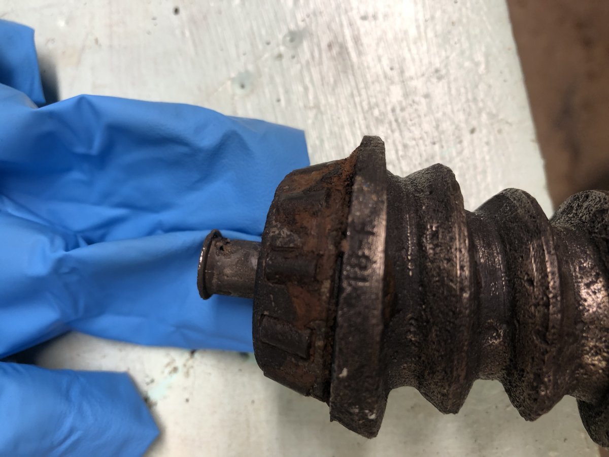

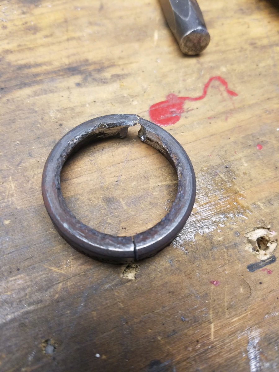

    Oh and I grabbed my favorite drift... an old kingpin, and got the last seal and the upper bearing out. Just need to get the upper cup/race out. Inching closer :)

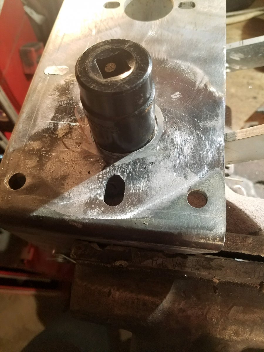

    Thinking I’m going to mig a bar across the face of the upper bearing race so I have something to land a drift to and knock it out. Got it soaking in kroil at the moment.
    In other news my buddy got this done for me! 0249EC1F-DD0C-4EC4-8AD4-6B2B88FDE251.jpeg I had been trying to figure out how to make the big hole in the pedal set up the same small size as the other. Spent a lot of time looking at washers, spacers, bearing races, **** even 1/4 wall pipe. Finally I took it over and said go for it.
    Ended up torch cutting a 1/4 plate filler for the entire hole, cut over size and whittled it down so there was a nice bevel to really get it good and solid from both sides F9CFCE80-706C-4C93-9A4B-AFBA079F21AA.jpeg then drew the circle where it needed to be and cut the hole with a torch. A lot of time with a burr bit in a dremel and it’s perfect! He found this socket in his tool box that measured exactly correct with his calipers so he just kept sneaking up on it and test fitting it with the socket.
    Some real @zibo style work. Pretty sure he’s got more than one light bulb in his shop but in the same spirit ;)
    Anyhow, need to drill two vertical holes to mount the master and a few holes in the sides of the bracket to mount it to the braces we havnt made yet and it’ll be ready to put back together and paint black :)

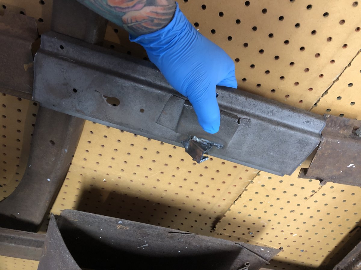

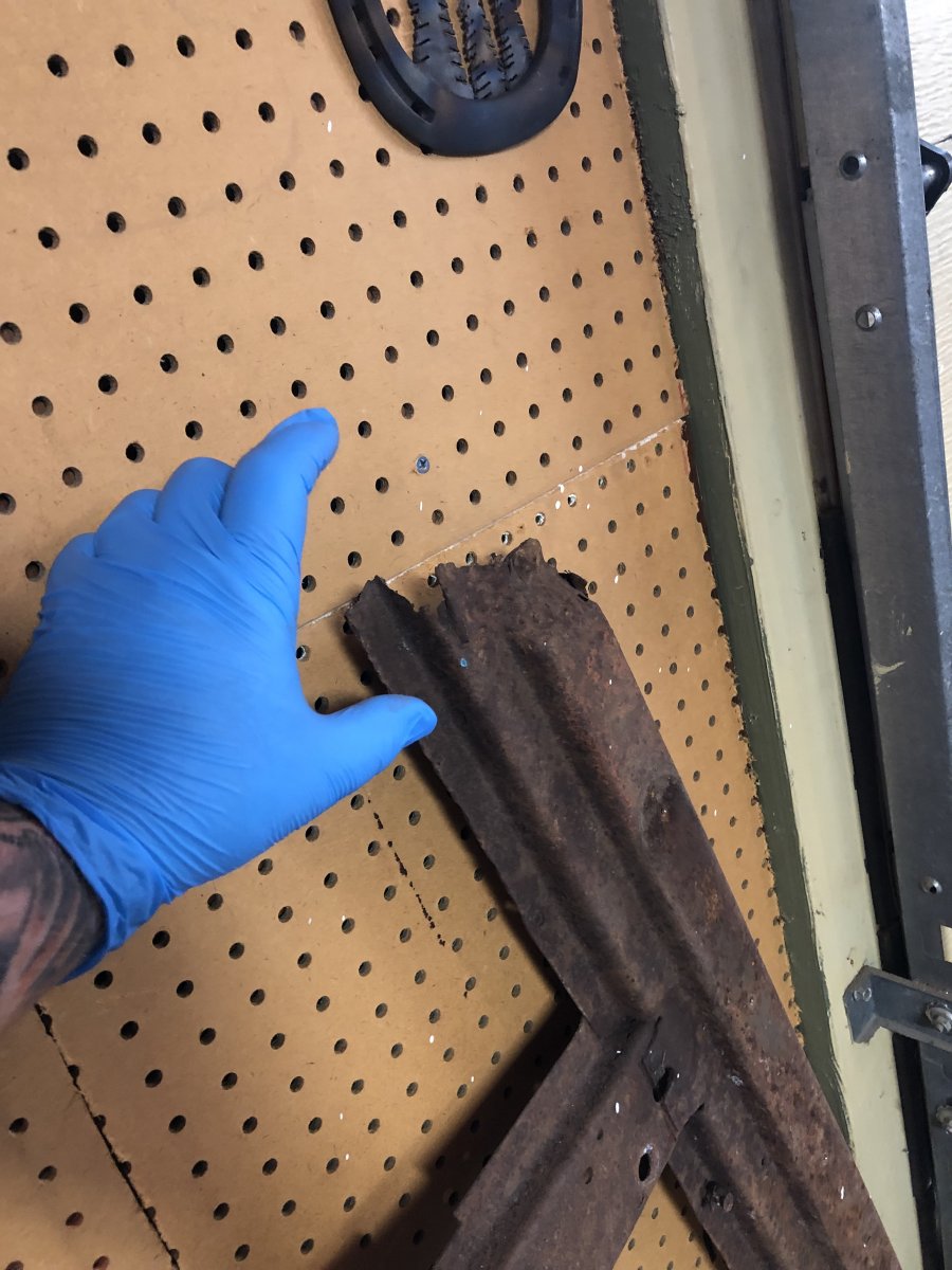

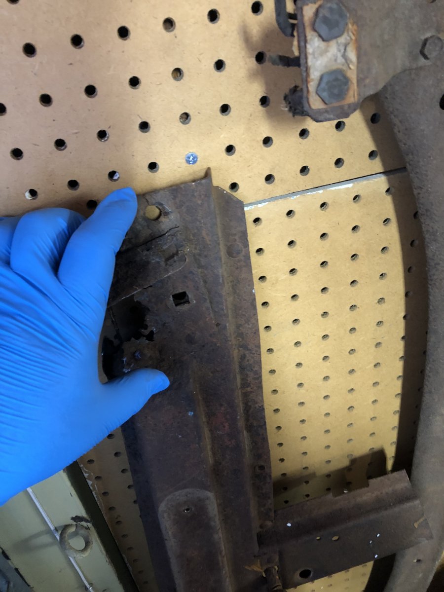

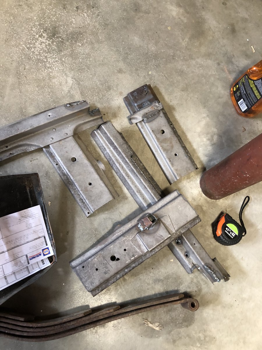

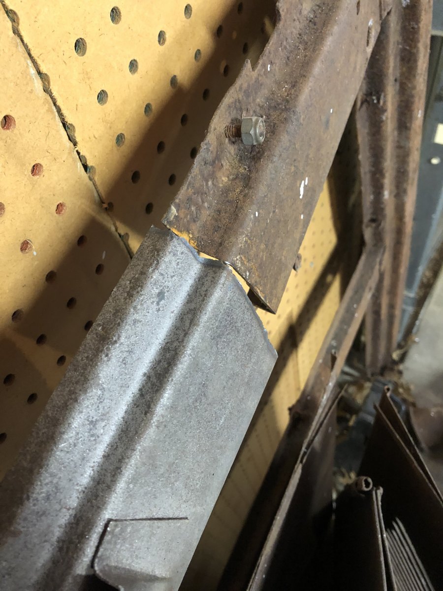

    Well some more scrounging and I’ve got some model T parts for the car this weekend. I think this brings me to 10 different years of fords I've used so far and I’d guess around 30 actual cars. But of a patchwork hotrod I guess :) 500E805A-FDAD-4429-883B-99C6C80FE654.jpeg Ben D dropped off this T rear spring for me from DrDave and I’ll add a single A spring on top to start with and see where it lands me via @Ron Brown sedan post and Daves as well.
    The. @BigJoeArt dropped me some T sub rail s****s B982E13B-BD8E-42B3-AAB5-0ECFFCB411F1.jpeg this is most of it
    4530A3EA-761A-43DA-A2F9-8ABF141A173F.jpeg F6B09E10-F52D-4A30-8DC9-E31C08DC7B57.jpeg Measures almost exactly the same, just has another fold at the bottom on the T stuff EFD16639-9447-4493-9F6F-788A0BFB6EA5.jpeg should fill that gap nice! 171BAA80-8181-480A-A359-BCB188963FCF.jpeg and I think if I can lop this section off the drivers side front and juggle it around to fit here 67D4F6B4-4BFE-4572-8C90-50B8D922B5C7.jpeg i should have all I need to have full subrails in the car!
    It’s going to take a bit of head scratching and zig zag cuts to patch in the best metal from the 4 different cars but I’m feeling good about it

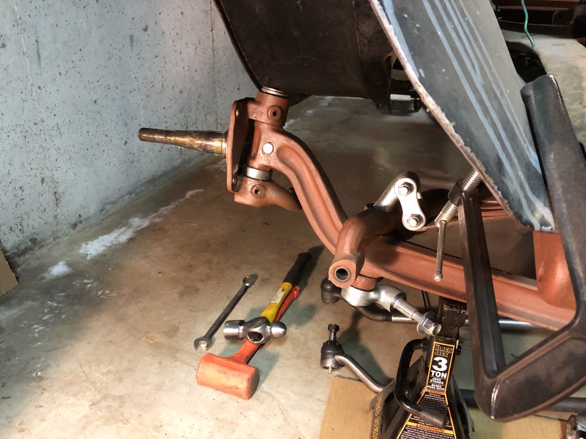

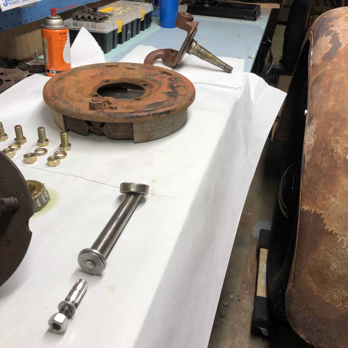

    Just chipping away at it here and there. Even if it is 7 minutes a day. B8BAA40C-BA28-4003-9317-CB0A10F2DDC3.jpeg AFEDDDB4-BC28-43FF-97BF-FF66FA2FA754.jpeg
    Time to hit the hay. Should have the pitman arm and steering arm re tapered to fit the rod end on the other side by the end of the weekend, as well as the upper bearing race/cup out of the steering box.
    Inching closer to having steering :)

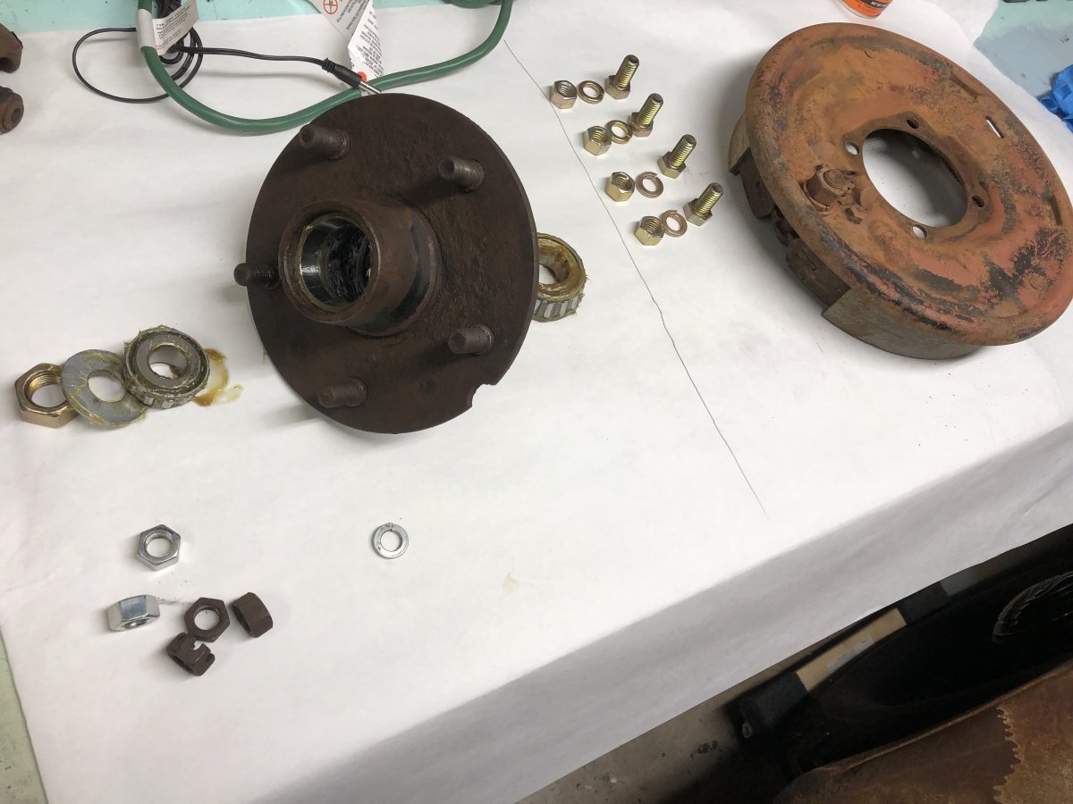

    Today’s 7 minutes. Off to the machine shop :)
    7F33B257-1871-42FC-B55E-020B64FC5FDA.jpeg 07F2EEDA-87FA-47E8-A68F-C45D79AF210E.jpeg
    All laid out so I remember how it goes back together. 8C0B3930-96E3-4205-83A3-C9494F8FCA9C.jpeg 740AB314-74EE-4A16-AD76-AC6AEF46C23C.jpeg

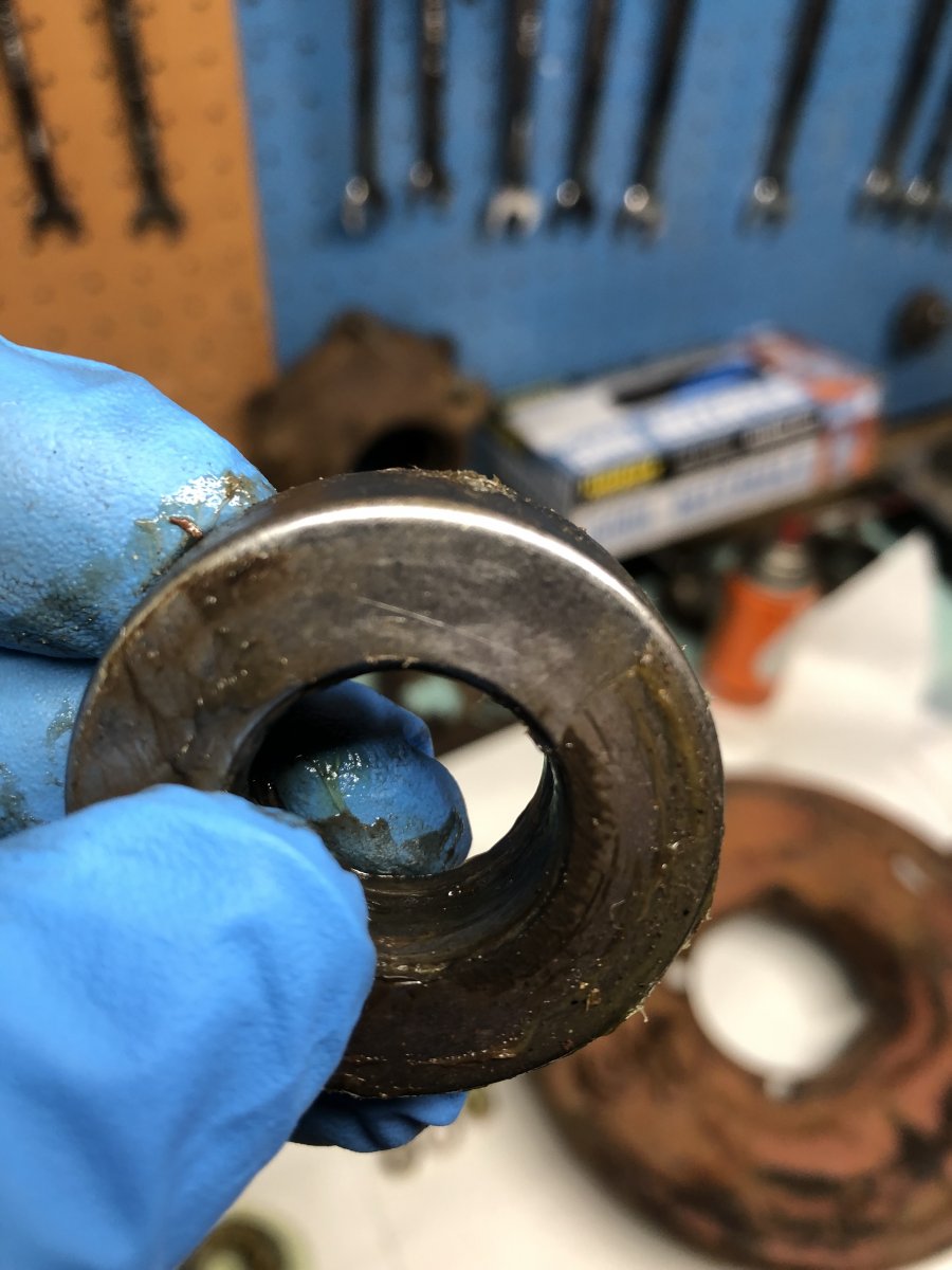

    Well, I couldn’t get that upper cup/ bearing race put on my own. Everyone makes it look like it slides right in with the rest of the stuff so I figured it was just rusted in place like the rest of the stuff.
    There wasn’t a ledge of pop it with a drift or anything so I brought it to my buddy Ryan who has been more than a little helpful as of late and said go for it.
    My idea was to maybe tack a bar across the face of the cup and then land the drift on that
    That’s not what he did but he got it out! 4F22371C-7D2D-494F-A050-391A75A4E786.jpeg first half out, you can still read the part number and everything. D08739B5-E413-4529-B463-5340861BE448.jpeg Out and on the bench 8AEBA1CD-9B49-4594-A9E1-C7E12C34856A.jpeg cleaned up!
    Thinking I’ll give it another good wire brush scrub down and then it’s ready for new guts :)

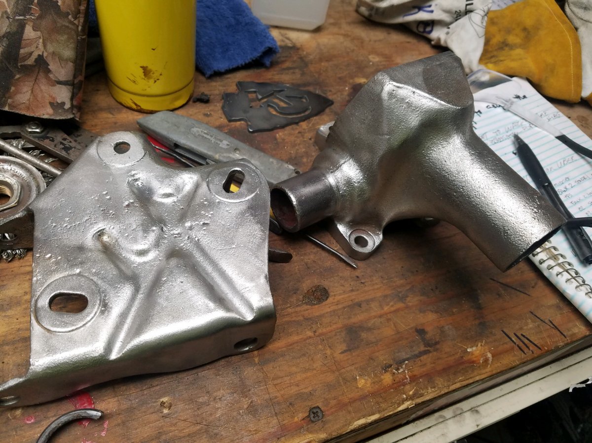

    Alright steering box bracket all cleaned up, box empty and all cleaned up! Gonna throw some primer and paint on them while it’s warm out in the next few days.
    Still need to weld on some spacers to the bracket but I need to have it all mocked up and on the frame before I can check them. The bottom flange just hangs below the frame a little, not enough to justify sectioning the entire bracket but it will take a little spacer. Want to weld them in place because if it ever had to come off the car while ***embled it would be a pain in the *** to wedge the spacer in and then try to get the bolt threw it all.

    Chipping away at it. I’m posting a lot of little detail stuff because I felt like I looked all over for some of that information and couldn’t find it online.
    Stuff like that upper bearing race that we fought to get out is press fit and a good way to get it out is welding a washer to it and hitting that with a drift to pop it out.
    Hopefully I’ll have some bigger bites to share in the nearish future
