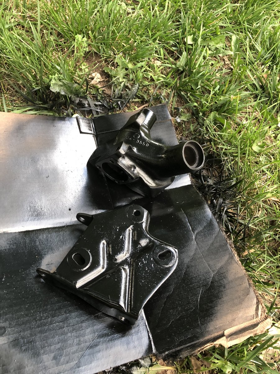

    1124B843-96D9-45D2-902C-FBA0DAB4CD54.jpeg Only the finest of rattle can for this guy. Lol.
    Actually this self leveling enamel from ace is pretty awesome and wet sands/buffs fantastic.
    Box needs a tiny bit more cleaning inside and sanding the paint off the gasket surfaces. Box bracket is all welded up and ready to mock up and drill into the frame.
    Jumping threw some hoops with the p***enger side spindle but should have it tapered and back on the car soon.

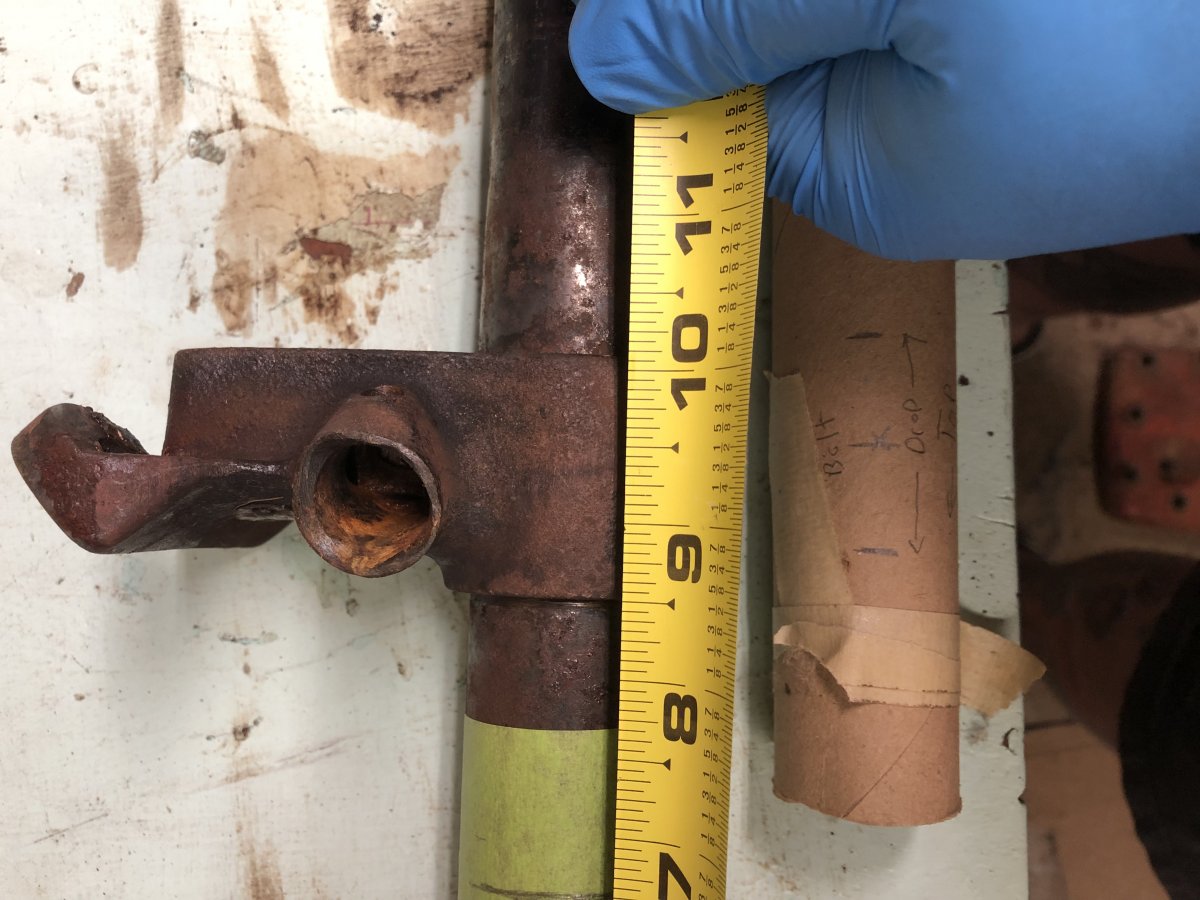

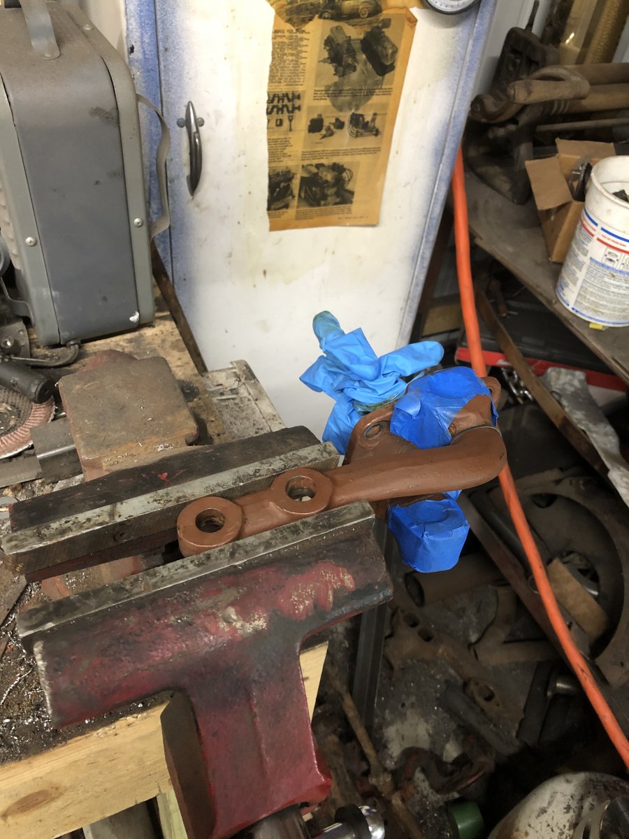

    I had a guy machine the taper on the opposite end of the hole in my pitman arm to flip the tie rod end over. Went well so I gave him the spindle to do the steering arm so both tie rod ends go in from the bottom.
    Surface to say he managed to do everything but what I asked him to do.
    Twice.
    So I made a drive to a buddies shop 0A5A2A39-6F4E-4A4D-918D-892C6CB288F1.jpeg stuck it in a vice 7A062B0D-4CA1-4136-94D3-F942341FAB44.jpeg 6014467A-BCDB-40FE-AAE1-4CF6A3A05E2B.jpeg brap brap we have taper :)
    Managed to get the spindle and backing plate bolted back on during a nap. Hoping to have the hub and wheel back on tonight after dinner. C42B38C4-6C6C-479E-8637-16810C3B9028.jpeg also took a look at the posies super low spring for a model A in person and decided that’s the way I’m going to go with the T spring in back. We’ll weld a little box shaped notch in similar to the slot in this photo. B523696A-A1AA-4EC8-96AD-49298702B570.jpeg and well, this is totally in related but to cool to stand next to and not take a photo.

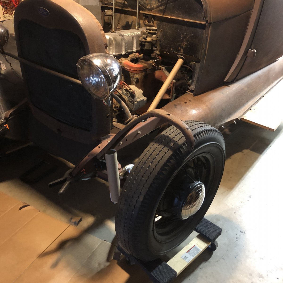

    Got it back on all four tonight. Well, all four on dollies but close enough. These are the small ones from harbor freight. Something like $7 on sale and rated for 1000 lbs each. I’ve moved some heavy stuff with them but they really do work great for this little car.
    Only problem I’ve had Is if the wheels aren’t turned the way you want to go on the back end it can be stubborn. But that could be exaggerated by the tight space I’m working in.
    Thought this would make me feel like I got something done but I’m kinda feeling like “all that’s left is everything” at the moment

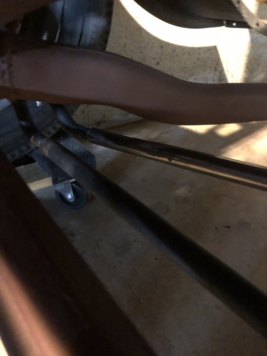

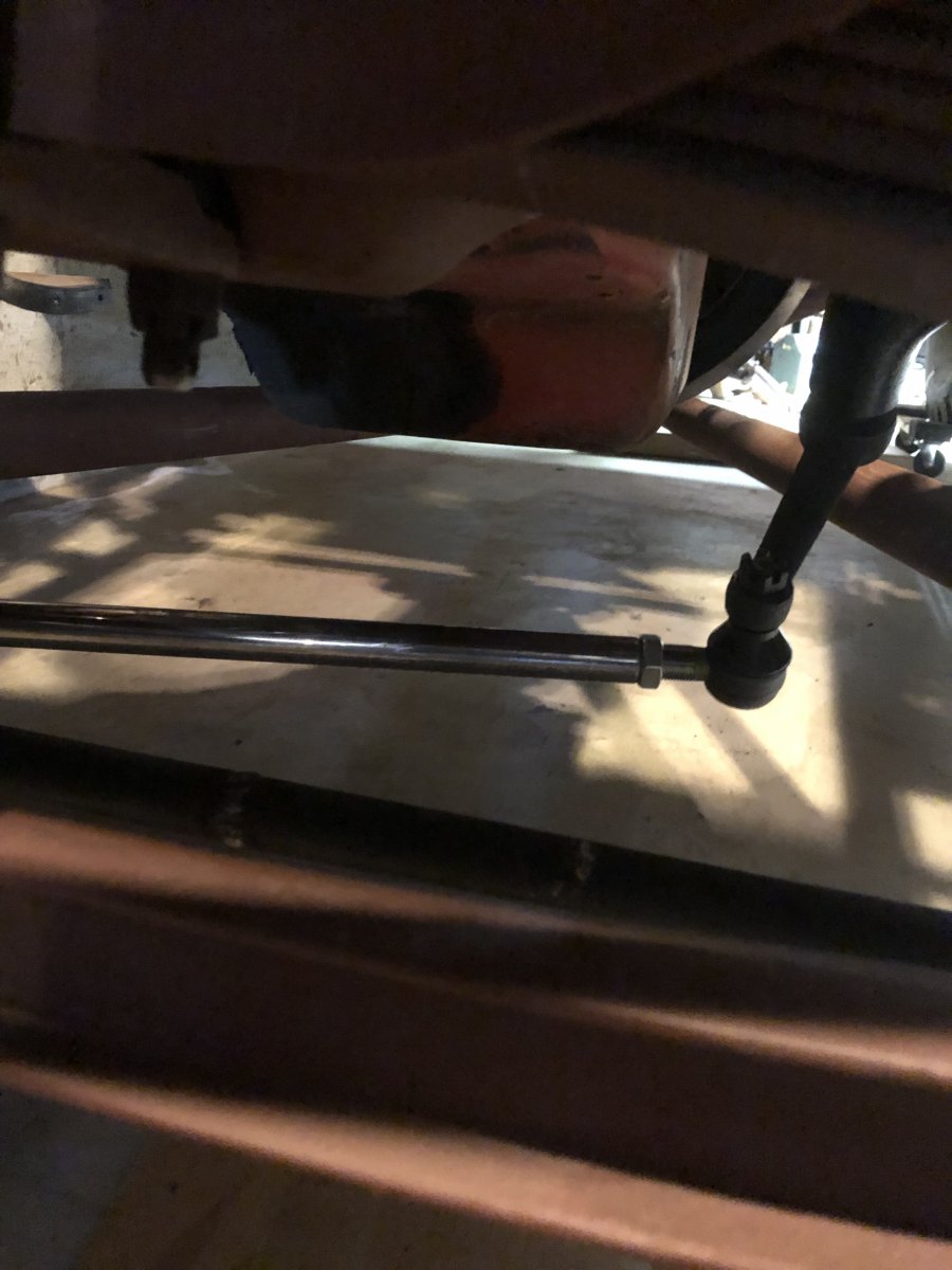

    C50C2738-744E-44D6-B3B9-7CBD63A8A9B3.jpeg Alright mock up with tie rod, drag link, pitman arm was a success. I’m going to compare a few geometry distances to my 46 which uses more or less the same box but there’s not much I can move at this point. Times to drill some holes, build a column mast and stuff it full of new guts :)
    Blurry but this is how I’m keeping everything from dinging around during this stage. Cheap spring clamp snacking the tie rod and drag link together 6291C3BF-88B1-4E86-A71C-9D9974632253.jpeg just slid the sector in, slid the pitman arm on and zip tied it in place because I mushroomed the hell out of the end of the sector before I said screw it and found a press to use.
    224BE949-630B-4323-BFC8-1717A0F2008B.jpeg Bolted it to the bracket on the bench, I can slide this up pretty easy from underneath the car. Don’t know if it’ll be so easy with a column. Guess we’ll find out.
    FEF09749-6007-47ED-BC4D-E6F44787CD5F.jpeg Just a mental note that these pairs of holes are in line with each other.

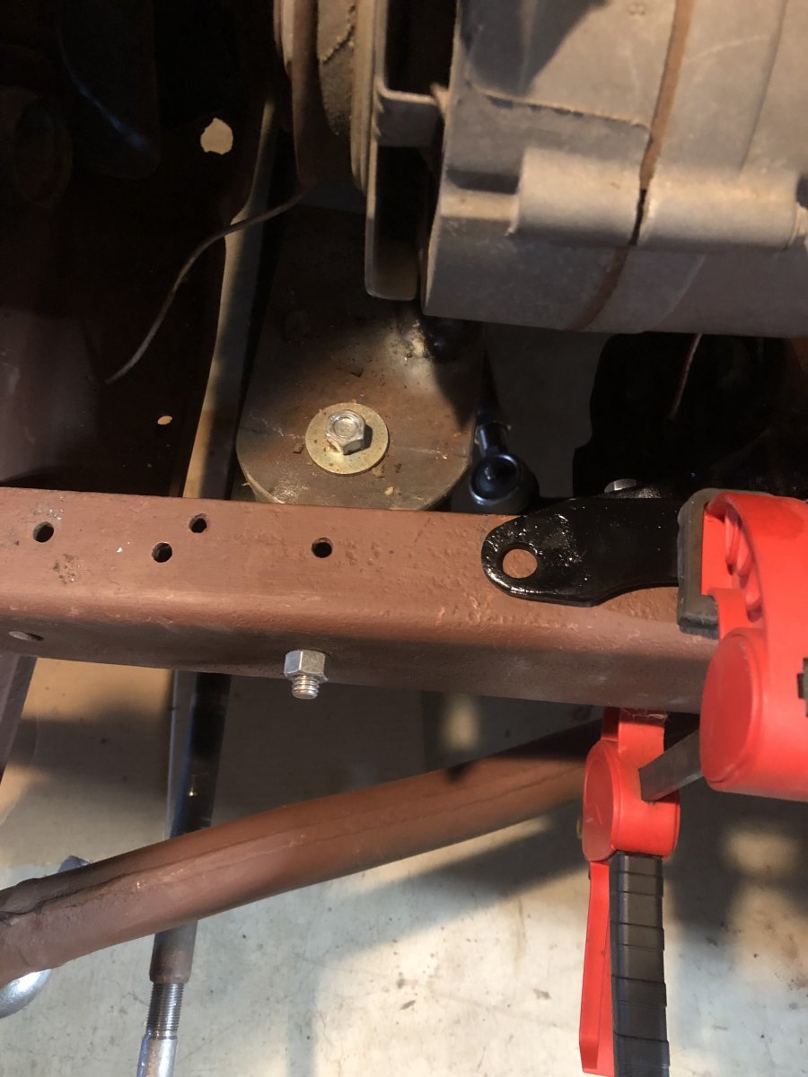

  11. Tim
    Joined: Mar 2, 2001
    Posts: 21,585
    Tim
    from KCMO
    Alright half way done with the holes. I mocked up the steering column and box again to make sure everything was where I wanted it and then drilled pilot holes threw the bracket F41DE133-CCA8-43B0-8896-B99228F84914.jpeg Then I pulled it off and hit it with the step bit and cleaned the bevel up with a normal drill bit 5CDE1CA7-1261-4B24-9BF9-20F6D919B750.jpeg the hole towards the front of the car is round while the one closer to the firewall is slotted to give some adjustment.
    Mock up showed I’ll want the back of the bracket about 1/16 to 1/8 out so I kept the front hole where it was and drilled the slotted hole right in the center of the adjustment.
    This should let the back move out a hair to center the column and give the front room to pivot.
    The holes in the bracket are larger than the holes I drilled so it gives some wiggle room there as well. I drilled the holes roughly the same size as all the rivet holes. I figured I didn’t want to go over bored and have it feel like I Swiss cheesed the frame, and if it’s good enough to hold literally everything else together it should hold the box just fine.
    A042BD50-8CBA-4D05-A822-39065BF18097.jpeg Need to crawl under and drill the two bottom holes and then find/make some spacers for them.
    Some thick washers and I should be done in that end of things.
    Next step is fix the busted threads in the cap for the box, clean up the sector and remove the circulating gear. Get them all painted.
    Then I’ll move onto building a new column mast. Still need to remove the column drop and clean it up. I’m going to clearance it for some new switches before I install it as well. I don’t want to take this apart more times than I have to.
    I’ll use the stock stuff to mock up the length of the column but I’ll leave it a little long so I can sneak up on final length. I noticed when I had the adapter and new steering wheel on it previously that the gap between the bell and the back of the wheel was wider than I’d like. So I’ll use this as a chance to tighten that up.
    Anyhow once the column is sorted out I’ll buy all the new guts and put it together full of grease and bolt it on!
    I know it’s going to need a pan hard with this cross steering set up but it’s not even on my list of things to get done right now. Figure it’ll be ok for pushing around the driveway. But it is on my radar
    Daily ramble: done.
    Stogy, Thor1, osage orange and 4 others like this.

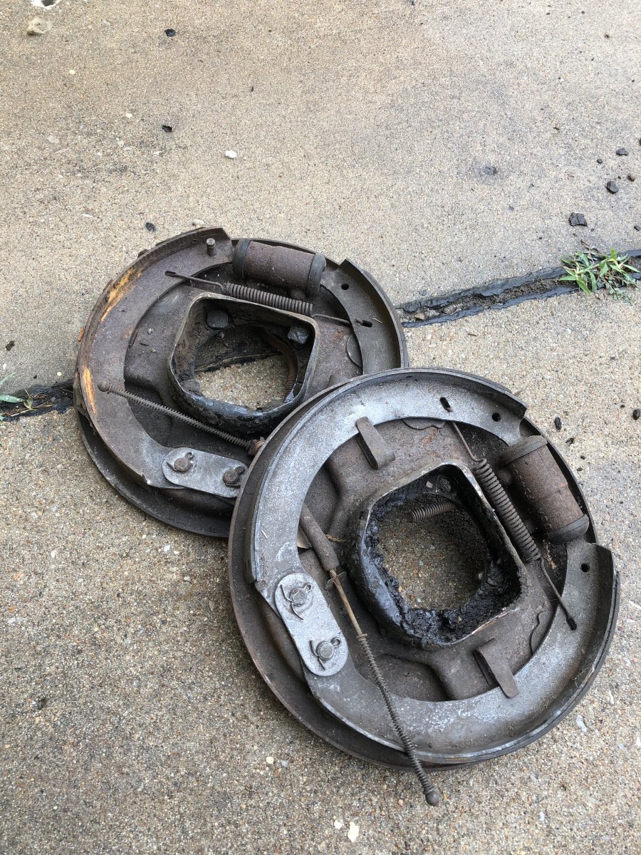

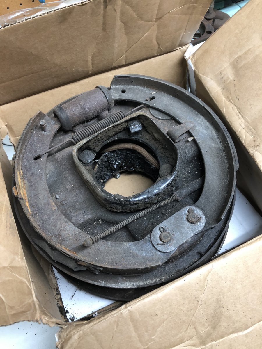

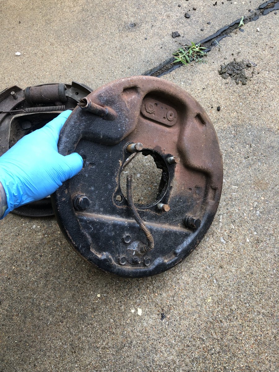

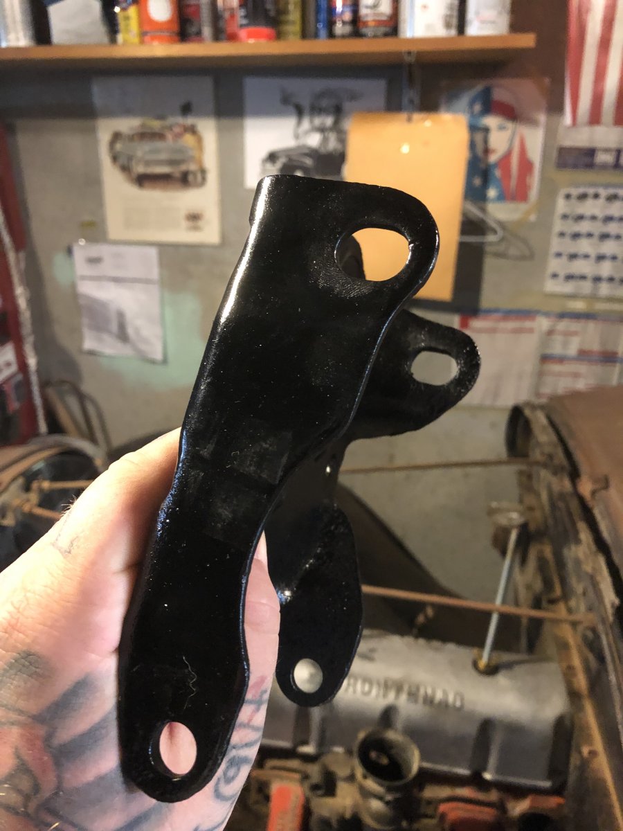

    @Dan Hay came threw today and delivered the brakes I bought off him a few months ago 60B430F1-FB6A-4F80-B6FF-BD1EC989680F.jpeg they came off this banjo that apparently came out of an old 32 hotrod in the Dallas fortworth area. He snagged the center section with the good gears for his 40 ford varmit build and shelved the brakes 958C0315-917D-4176-9D4A-3BFF7CDF7868.jpeg when he dropped them off he said he thought they were 46-8 though I had thought they were 40. Thankfully he’s right and they are the better brakes! I’m stoked 02DA607C-8ED6-485B-967C-26B89DA4B6B3.jpeg step one: clean off all the spider eggs and smash the spiders you can catch. E1B290A5-A167-4358-8F77-46951C01F085.jpeg Step two see what we have! Seem pretty clean and complete. I think it’s missing one spring clip, which I think I have and the parking brake levers/linkage are gone. So I’ll need to find some of those.
    Pretty dang happy with these! My thought is to have the E brake set up before I plumb the car so I can stop it in the driveway.
    Stogy, Dan Hay, guthriesmith and 6 others like this.

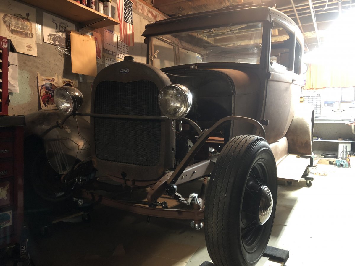

    A quick photo drop. What it should look like with the new springs. Seems like I should be able to run it with or with out fenders and have it look good.
    69E511DF-10D2-40E8-AC27-E76048A8A99E.jpeg 63FB020E-14D1-499A-BECB-AEC4AB4DE19B.jpeg

    Nice stance! I like '28-'29s best with fenders. Anyone can run no fenders. :rolleyes: They just wrap around the tires so nice. You really fought this thing until you got it right.
    Tim and OFT like this.

    Thanks, it’s just a phot rendering at this point but with the new springs that’s were it should land.
    If it doesn’t I’ll keep messing with it till it does. I’m actually concerned my t spring might sit it lower than this so I’ll have to see what happens. I basically want the top of the back tire to have the crown on the tire inside the fender but the side wall below it. I find that makes the arch of the fender opening and the radius of the back tires echo each other and look perfect.
    I think with the back wheels shoved up into the fender both the fender and the wheel/tire lose appeal for various reasons.

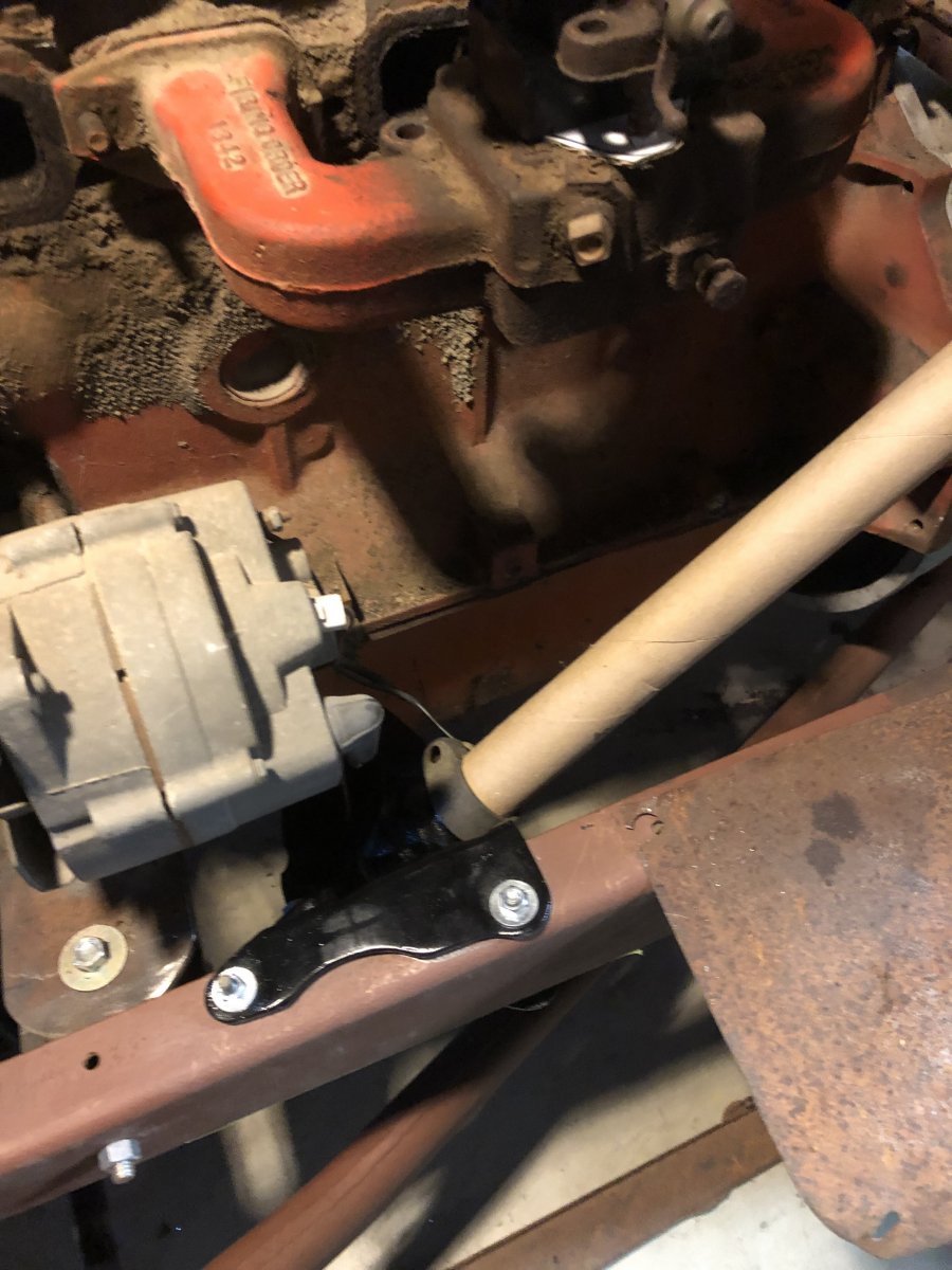

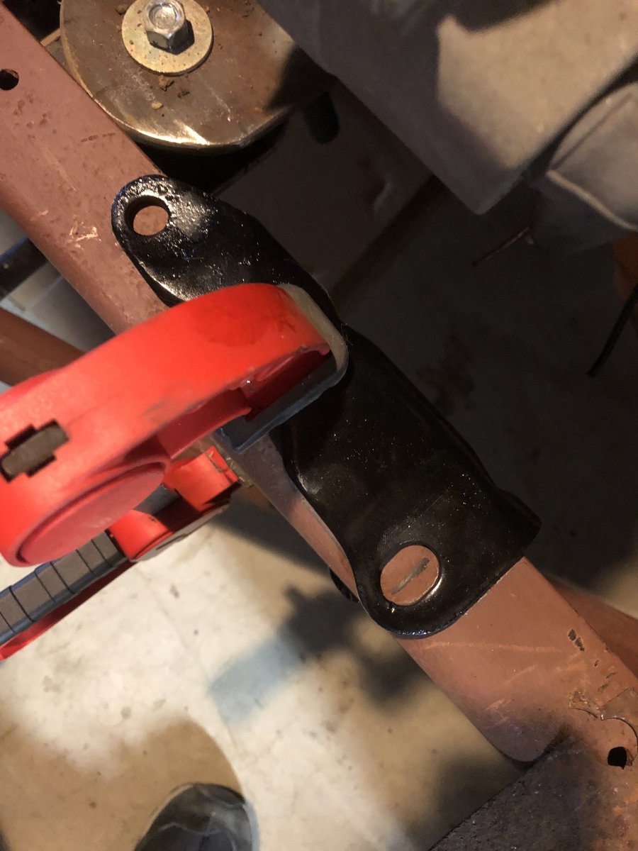

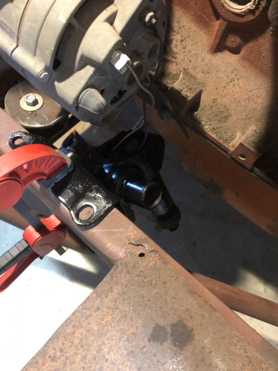

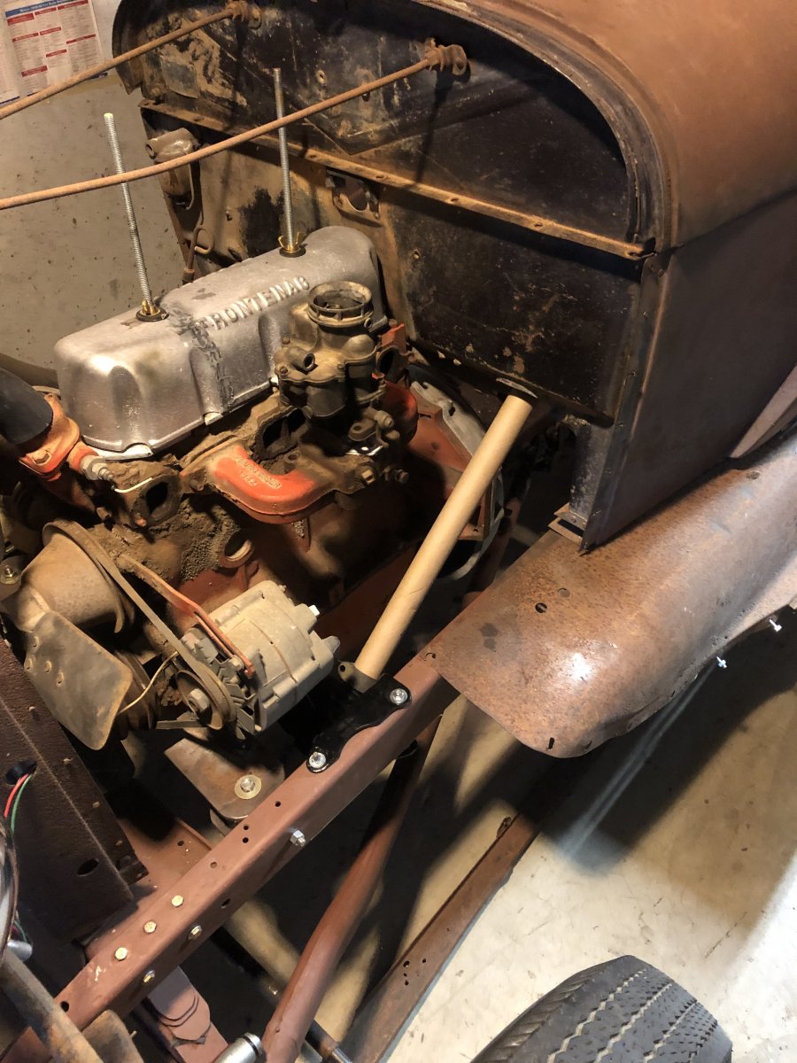

    Got the box bolted to the bracket and the bracket bolted to the frame today 6A1A83A8-A4D6-45BD-97D2-5304ECF056C9.jpeg I adjusted the frame bracket and got the colum to center in the opening 03BFB2A8-4138-4035-9FF1-EB3239AA31BA.jpeg I adjusted the tilt of the box and got it as snug to the dash as I can BB3F1B1D-8D94-45CD-B8D1-8EE1C4A3D09E.jpeg and because I always mock stuff up a thousand times I stuck the hood shelf on. It’s gonna need some t*******. The hood support comes down in the same area as the further back bracket bolt 19E43606-6556-4569-8935-200092EC52B4.jpeg In back and forth on cutting the actual fender. It makes more since to have it go under and have the bracket bolt over it. But that makes getting the fender off a pain in the *** because the box needs un bolted.
    Maybe ill slot the holes so the fender still goes under the bracket but a slight losing of two bolts let’s it slip out? Dunno guess we’ll find out. Just something to chew on for now
    brEad, Stogy, kidcampbell71 and 5 others like this.

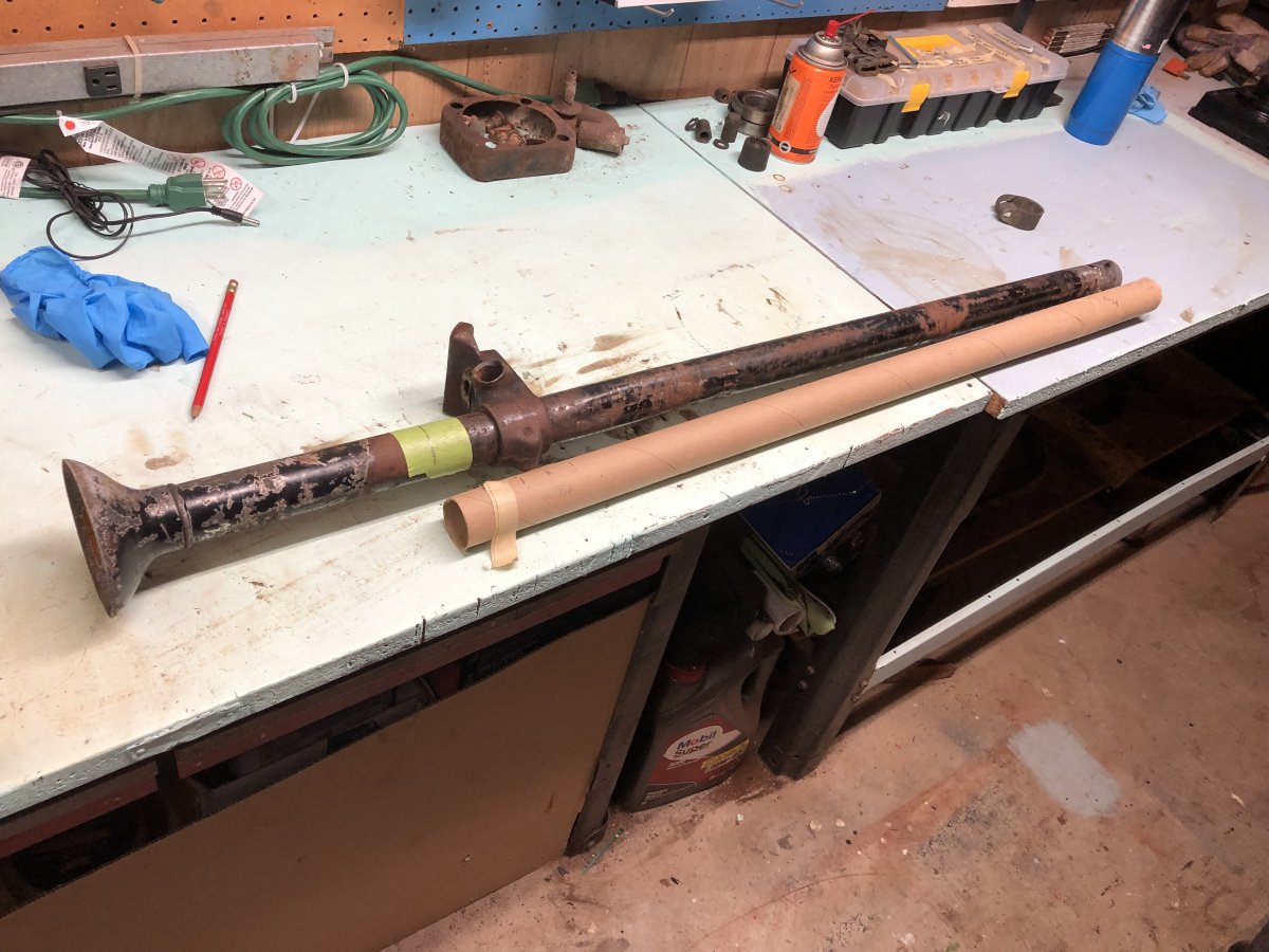

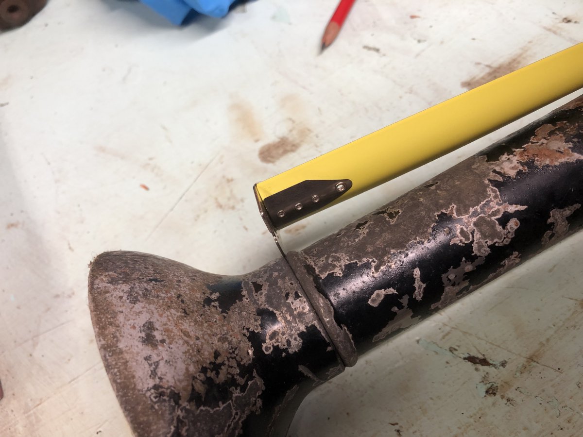

    Don’t have much time so these photos may have loaded in a funny order I’ll jist try to caption them as I go 95AF95C4-12C3-49E1-8613-F564387AFED4.jpeg here you can see the hood brace that comes off the hood shelf that will hit the bracket. I think it’s basically there to sturdy the brace to the frame. 03F95DBB-4C58-47A9-B0C4-805104C6A64B.jpeg kind of a funny angle but I swung the hood side out to see where it encounters that bolt a little better
    I’m thinking I’ll cut it and then I’m going to create a wood piece to fill the entire inside of the hood shelf. I think stock it just has blocks under the hood side latches. In my head it being filled with wood makes it more ridge and should create a lot less rattles. Should make the snipped hood support negligible D0142DB0-F472-4E67-8278-A6FE9C74F3E0.jpeg next i pieced my rusty column mast back together and lined up my mock up tube to measure A6E05CAB-E358-45E3-881E-44DE8820C6EA.jpeg made reference marks to note where the column should land B4948E7A-F07D-4149-B9DF-0A9B2AC08ACD.jpeg added about a 1/2 inch to the bottom. I noticed when I had it mocked up with the wheel that the bell was further from the back of the wheel than I’d like. This will let me sneak up on it and get rid of that gap 78E4EFFF-C34D-4F32-9FAD-B8A3E5F37248.jpeg this picture shows both that I’m sharing this stuff so I remember later, and that I’m **** enough to take a photo of which tape measure I used to measure this so I measure the new stuff going together with the same tape. Reduces any weird tape measure end inconsistencies BE43A41B-875D-4A0A-9B09-0E01AB53294B.jpeg this is kinda out of order but shows that the top of the drop is 8.5 inches down from the seam I’m measuring from 0381330C-B442-405E-BA71-8A93302DBCFC.jpeg my note to self about that measurement after I cut it in half 4F0BD8B2-621B-47E2-A832-619E8854673F.jpeg the other side of the measurement. Who knows how long it’ll be so I want to know for sure what I measure and not throw previous mock ups that led to all this out the window CEFEF449-A306-4D81-AEA6-771A6D879727.jpeg cut off tube lined up with the cardboard mock up half 7ED8A721-76C2-45ED-9288-AEFE0C532EC4.jpeg im back and forth between welding the new tube at this bead or further down 785F611F-9F1F-44CC-A0F3-A23AD684E6C5.jpeg the leak that rotted the mast out is further down so the metal up here seems consistently thick 940F4D02-A1E6-414A-9535-2CB8FD6BDD01.jpeg noticed after the acid that under that black paint is some plating of some sort? 66D68F7F-5718-4B47-9C59-EE6C78D4D4E9.jpeg together minus the column support. I based position of the box and column on a lot of things but one of the biggest was where the wheel landed, that it didn’t look weird, block me from getting in the car, and didn’t smash my fingers on the door or dash lol 4BB87F96-4701-41A8-BA9E-3FAD4DF2D01A.jpeg lopped off end I’m working with now. Found some good battle scars on it. The truck this all came out of had to have been beat to **** on a daily basis
    Anyhow. Now I need to get the column drop off the old column remnant. Chipping away at it.
    Sorry this was all probably a better note to self than stuff you’d care to see lol
    brEad, Stogy, Thor1 and 4 others like this.

    @drdave can you take a photo of that when you pull it out to add the leaf? I’d like to see how much shaping you had to do to get the A leafs to fit. Thinking I’ll likely have to do the same.

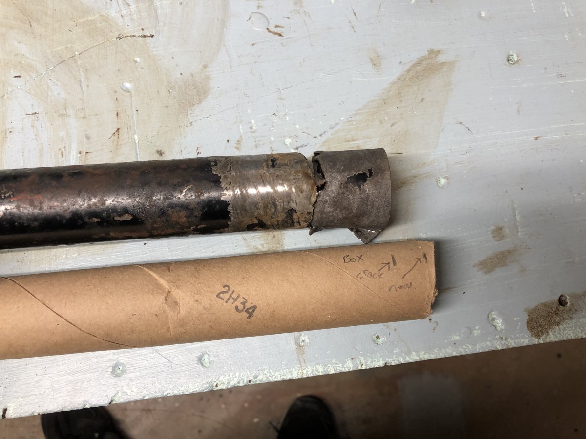

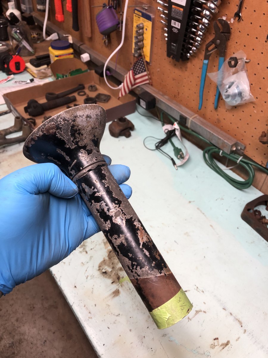

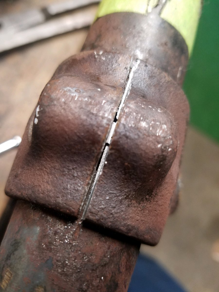

    Anyhow I handed off a few little projects to my buddy Ryan and tonight he got that column drop off the tube.
    E59FFBD6-1956-4E48-8DE8-C0DCA86AABEE.jpeg Hack saw blade threw the clamping bolt 58D83623-8F18-4A4A-ADA5-35661374268E.jpeg he said it sprung a bit getting it off the tube so the gap looks like he took a big chunk out of it in this photo but he didn’t. He also got clever with a weird shaped drift and punched the lock cylinder out. Rusty and beat to **** like most of this steering has been 887F270A-6A19-415A-9404-75BD7CDA20D5.jpeg on that note this is the bushing that normally lives towards the top of the column. It’s further down and smashed to bits and then rusted back solid. Wow.
    That’s it for the moment. Needs some time with my drill press to get a few more bolts out of it then I’ll clearance the spaces for the switches and clean it up

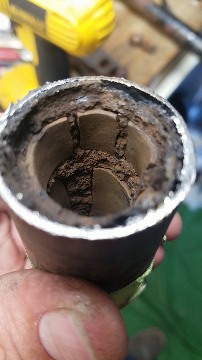

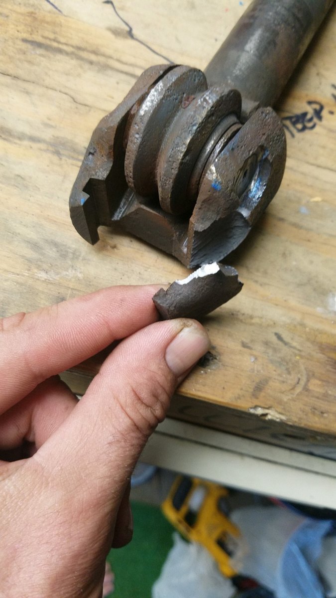

    Well guess I’m hunting a new sector lol
    Ground the premed over surface off the pin that holds the roller in place and when we tried to press it out pop! 4856C8F7-417D-4FEC-B979-853D4677F8A3.jpeg I’m not exaggerating when I saw this box was very beat on, and very froze up.
    Oh well. To be expected I guess
