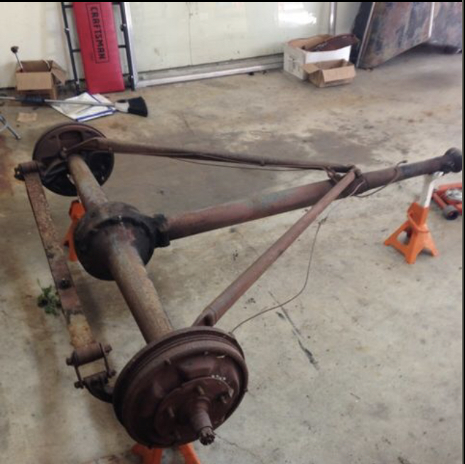

    Glad I could help! And, super impressed you dug up a pic of that rear end they came off of!

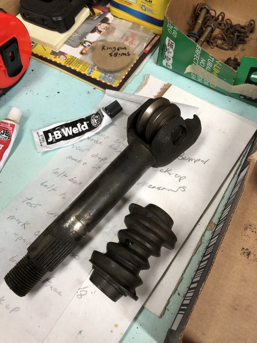

    I believe that shaft is the same one used 37-48 and in the F1 box. P/N 7RC-3575
    I looked around and can't easily find any for sale with a straight price on them. One place wanted over $300 (I think it's at least new or NOS though). I would suggest buying up a few more of the side steer boxes though. They're usually A LOT cheaper than that or F1 boxes. When I decided to run one on my car, I ended up with 3 of them and made one I thought would work well out of the bits of two of them.
    http://www.vanpeltsales.com/FH_web/ch***is-partsprices-pg3.htm

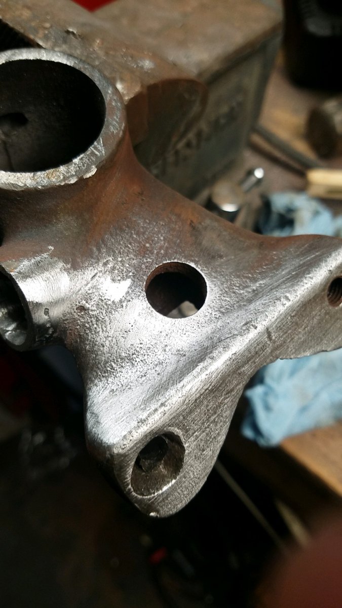

    53B5554A-7FCB-4EE0-BE67-08279BDDC142.jpeg Muuuch better :)
    - jb weld is unrelated lol just siting there

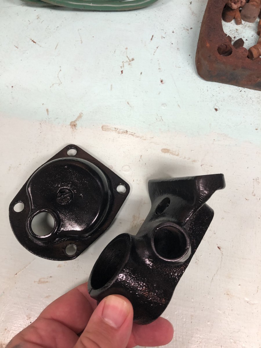

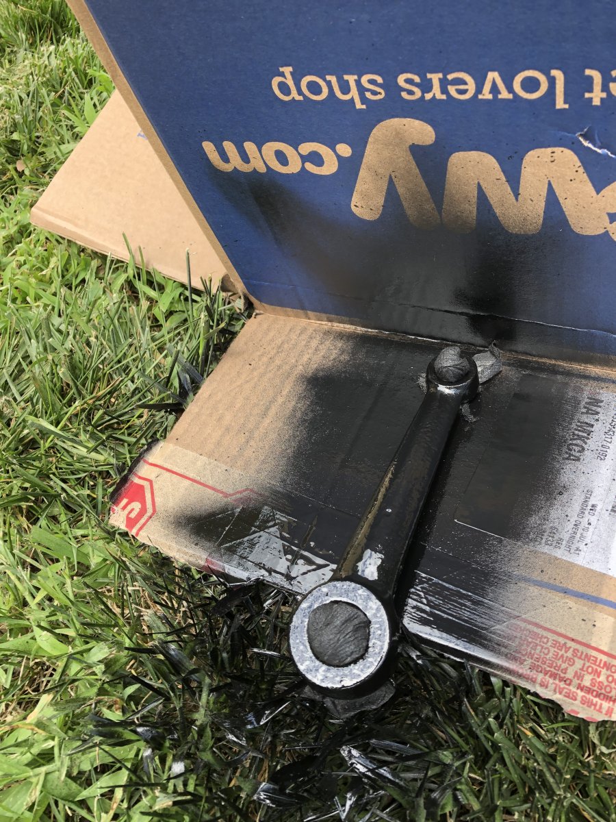

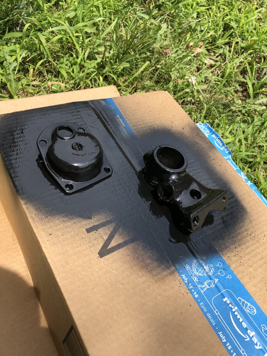

    Painting a few steering box parts, still tweaking repairs to the lid. I think I’ll try and post all those photos together.
    Supposed to be in the 110 deg range this week so I figured it would bake be paint nice and quick.
    Got the column drop all apart, drilled out the frozen mounting stud, the remaining length of the “sacrificial “ bolt that holds the clamping bit together, and drilled the set screw hole for the key cylinder to a uniform sized, I’ll thread it later this week.
    I’m wanting to mount a push ****on switch in that spot for the light dimmer switch and hold it in place with a set screw because I won’t be able to get a jam nut in there and glueing a switch in sounds like a terrible idea.
    The commonly found dimmer switches are beefy foot switches and to big for this space. Any idea if the load is so big on that switch that I’d need to run a relay to take the load of whatever push ****on I find it fit the space? I’m thinking yes?

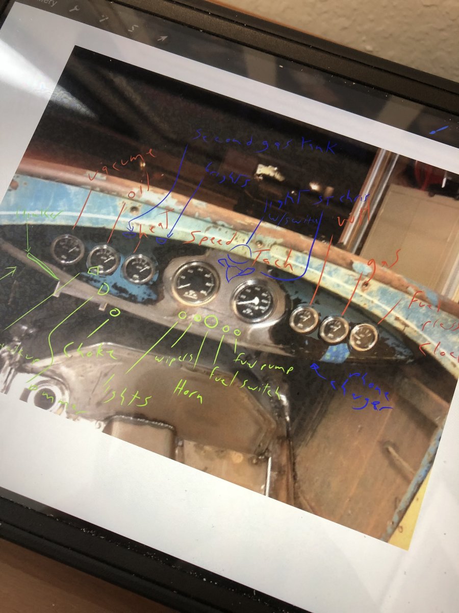

    Anyhow on a related note I saw this photo on Facebook A6873C31-0ED3-4103-8C3B-A3CEB68CE857.jpeg I had actually been messing around with a photo of a dash to get ideas for how I wanted to line mine up. This one has 3 on one side compared to my idea of 2 on each side so I mocked it up to see what that may look like 80AF8827-1FF3-4016-988D-0D6DAA579074.jpeg for the moment I’m thinking 3 on each end looks cooler than any arrangement of 2 I’ve come up with so far.
    Maybe add a vacuum gauge and a ****og clock that matches the gauges?

    Pretty high tech over here lol 1762685A-100D-4D26-8A8C-36EAB933729B.jpeg C24E9A3B-A12F-4F12-B4EF-6C9C8E497D20.jpeg have been pretty impressed with this hardware store brand enamel though. I used it to touch up the fender on the front of my 46 and after a couple hundred miles it’s still perfect.
    Gotta put a couple coats on the cast stuff to get it to be shined but on flat surfaces it levels out remarkably fast. Buffs good as well. Don’t know if it’ll bother buffing and polishing this stuff but who knows.

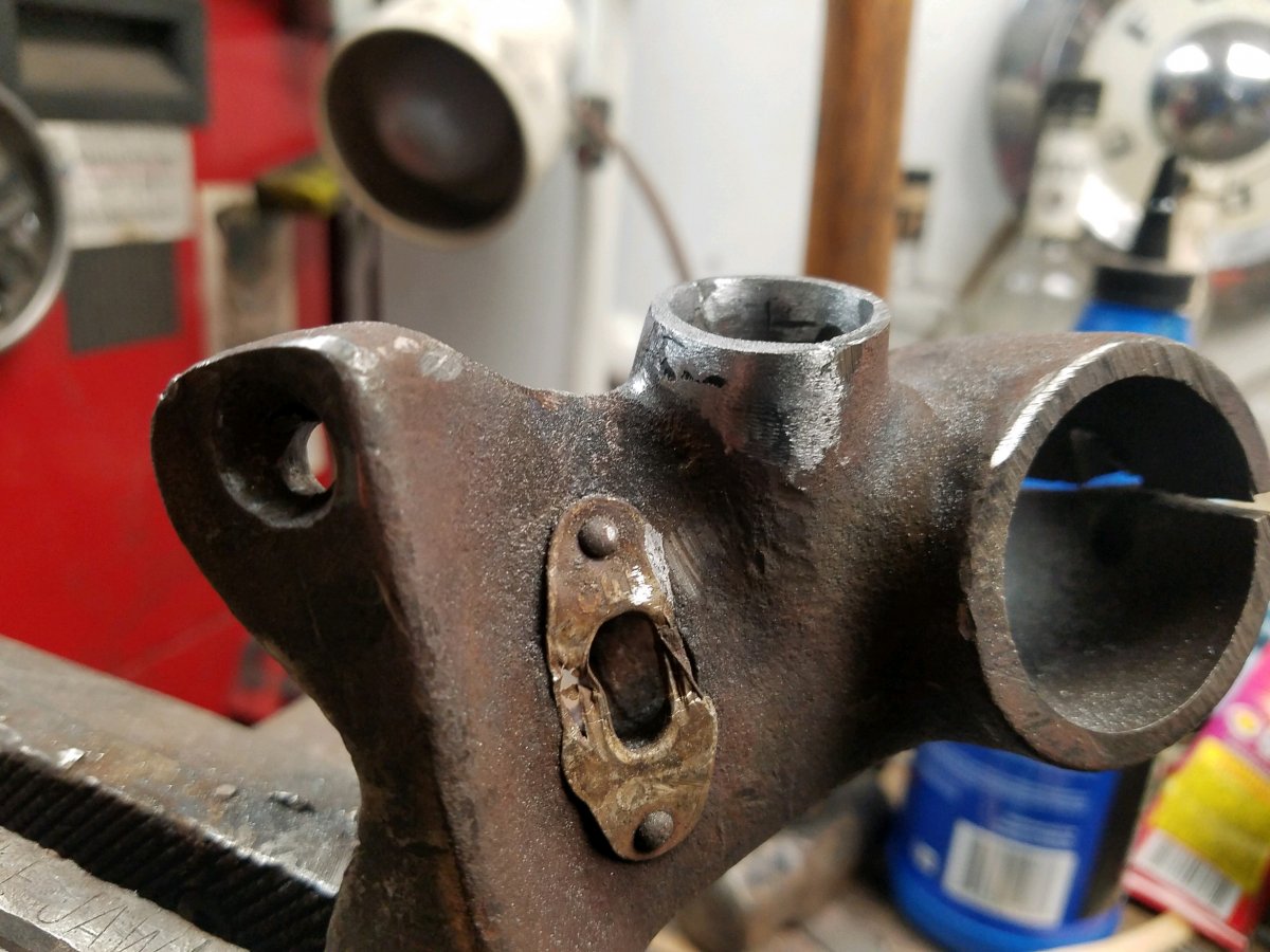

    C52A2DC9-24AB-43FA-B574-57626DE46BAC.jpeg Alright so cleaning this up. I want to put a push ****on for the head light dimmer switch where the key used to live. By the time it came apart it was pretty un even. 39AE599F-507F-4BFA-BB0E-A7C352EAF3AB.jpeg thankfully it seems to be forged so it go tigged back up flat and ground smooth 46632940-701A-46AA-89E0-90F24A61D000.jpeg got the switch plate off where a different toggle will live. I’ve got some ideas on how to keep that switch in place as well. Not sure how the original tag was “riveted” on when you can’t get to the back side? F759B0F9-9F3D-4EE4-AA3A-11E36C24301D.jpeg cleaned up a tiny bit we are playing with a new abrasive disc that 3m makes that kinda acts like a less violent wire wheel and no shrapnel. They make ones for a grinder as well but I had this one on the bench so we tried it.
    So far not bad!

    Wonder if those "rivets" were press fit into a blind hole and were more like nails than rivets?

    Yeah I don’t know, I think I’ve seen people do little tiny rivets on the tag itself and then jb weld or glue the tab to the car. I’ll probably do something like that.
    Probably won’t be a stock tag so it’ll help me put it where I want.

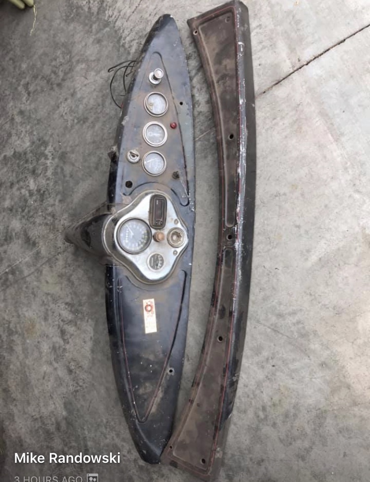

    Just some random “inspiration” photos to chew on. 07953A6B-93C8-43BA-9033-FAA8C0B15DC6.png stole this photo from a post about bumpers but I kinda like where his plate and lights are. I think his tail lights are lower on the fender than stock and are centered instead of sitting in a little. I’ve been considering changing my original mount idea and welding tabs off the back “spreader bar” to locate it about where this is.
    I guess you could also mount it with the spare tire holder holes and get it to about the same spot but I feel like some tabs would be cleaner, easier to adjust and have it land it the same space. Kinda curious what’s actually being used in this photo. F0E4A880-9117-481A-B08F-459047D5CE4F.jpeg this rad roadster dash I saved for a couple reasons. I’m using the same steering wheel and so it illustrates the change that makes to the dash compared to not having a wheel on it like my previous renderings. It also shows that the gauges aren’t all lined up off the center of the gauges. The small gauges are centered about 1/4 down the face of the larger gauges.
    I’m being picky and **** about it, but it’s teally the only part of the car you sit and stair at when it’s on the road. The same dash with the same gauges but different spacings all read/ feel differently. D2D01BA1-BFED-4646-87FF-20F5EE1E956F.jpeg still planing on 1928 dutchess blue with black fenders, wheels, grill and visor. Came to mind because I keep trying to spot a late model with a close color to make it easier to find paint eventually.

    The switch tag had hammer in twisted ****on heads. They just press in to a hole. I made my column drop lock the column like stock. Super easy and added protection!

    The more you know! Thanks David. My lock damn near had to be melted out of the drop or I’d consider keeping it.
