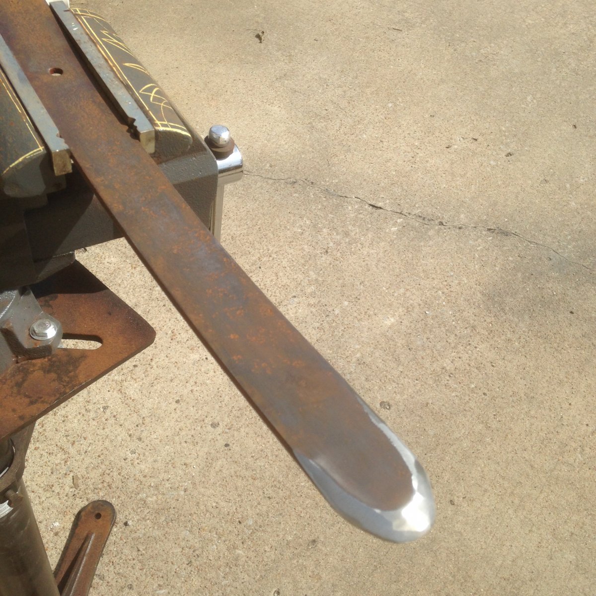

    image.jpeg Figured I'd start this post with another inspiration photo. Not to many sitting on an agressive take with no chop and this ones even green!

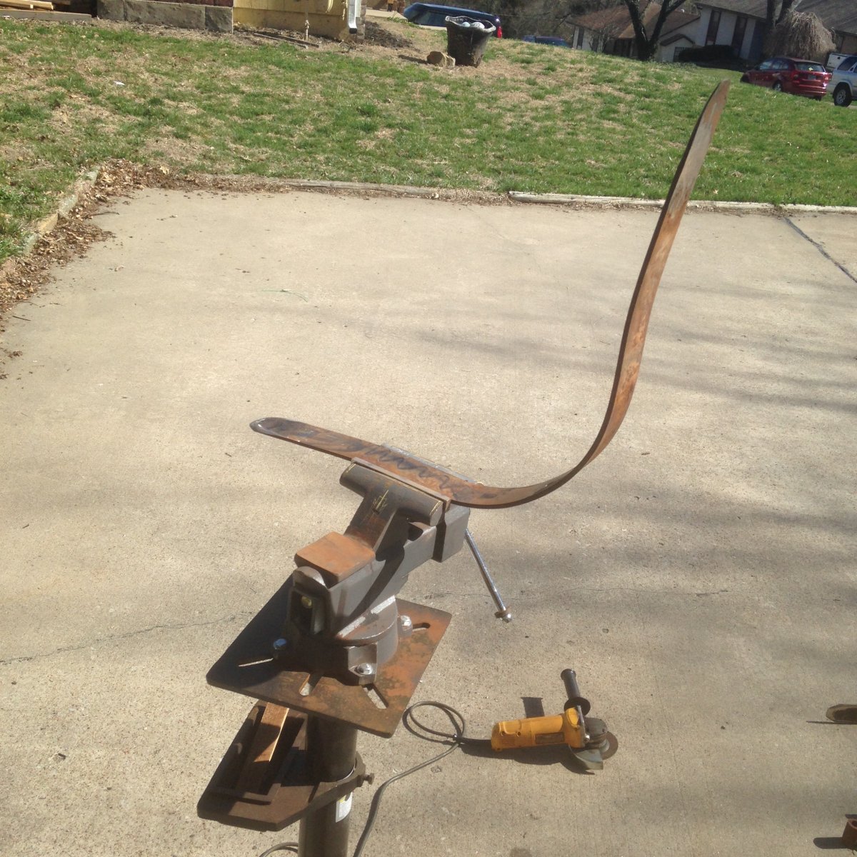

    Anyhow I got my leafs all sorted and ready to reverse today.
    image.jpeg I made a m***ive mess inside when I started yesterday so today I took advantage of the nice weather and the fact that most of my neighbors would be at work.
    I staryed cleaning up the gouges first. I used a flap when on my grinder and some other weird abrasive discs I had around but they didn't really cut the mustard so to speak. However as I grazed the end of each leaf I found some subtle indentions that I may have other wise missed so there's that.
    image.jpeg I ended up starting today by hitting the indentions with a grinding wheel with the spring in the vice. That worked much faster and then I fine tuned and got te last little bit of it out with the flap disc as it's quite a bit slower at pulling material.
    That done I moved rounding the ends of each leaf. I first took the grinding wheel and nocked off all four corners off the end of each spring. As long as some of those grooves I worked out were I figured the less things to grab the leaf under neath the better.
    The side ones I basically flattened out and the two on the tip were ground to give the end of the leaf a slightly round curve. I wouldn't say a half a circle round, more like a philbert tip on a paint brush... Or I guess like a finger nail.
    Anyhow I think rounded the bottom surface of the leaf getting rid of that leading edge all together. Some of them got all the way to a nearly a knife edge and others maybe a 1/16 thickness temained at the tip. I tried to make the slope as smooth as possible so I made the transition up to a half inch long.
    My thought is the smoother the better, and since working the grooves out of the leaves still gives you a bit of a wobbly surface is try to make up for it by really paying attention to the surface that would be sliding on it.
    The grinding wheel can be a little in forgiving it you catch a funny angle so I got them pretty close and then went back with the flap disc and got them all the way there.
    As of now the plan will be to drive the remnants of the old bushings out of the spring eyes, sand blast both packs, reverse the main leafs, trim the second leafs and then make the call on paint and ***emble with Teflon slips.
