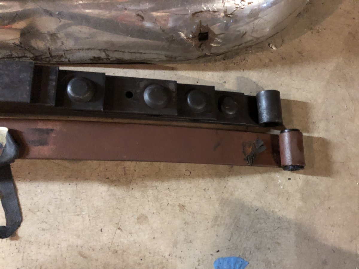

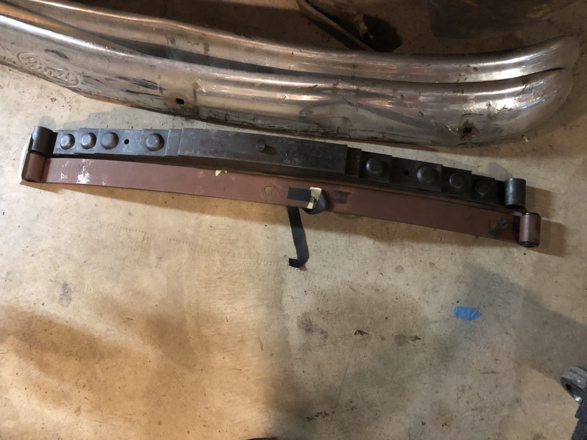

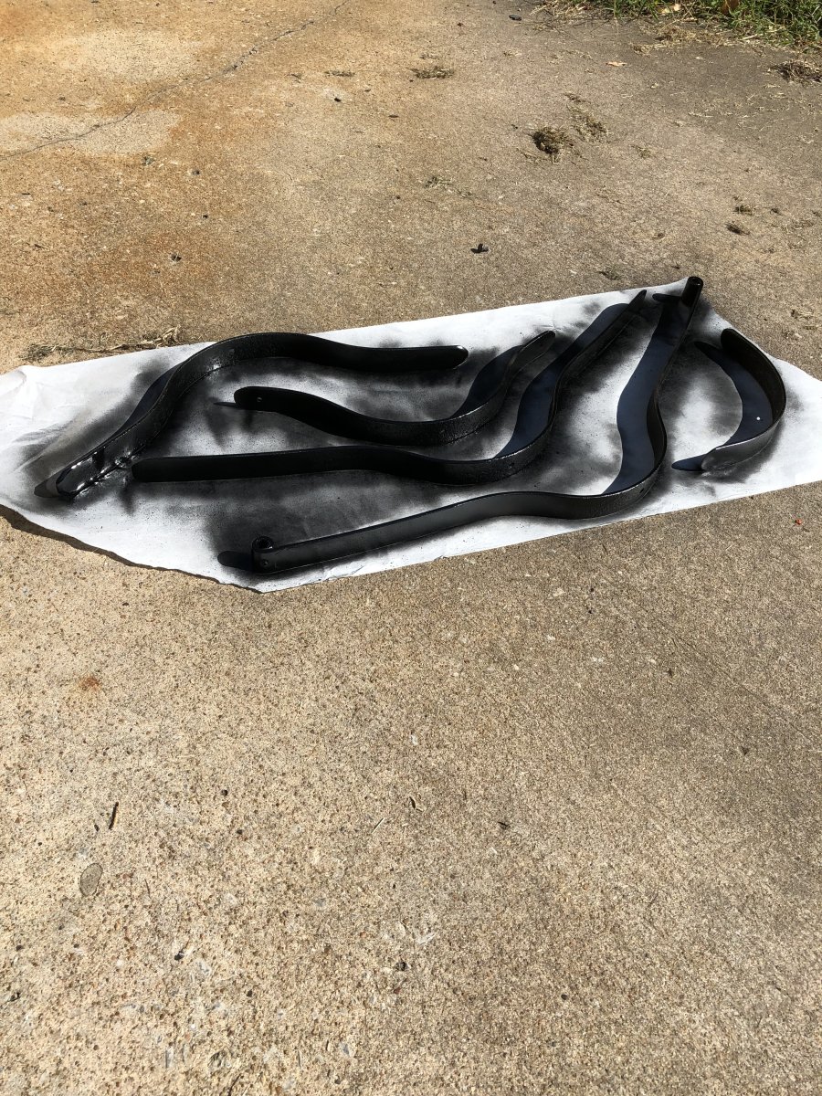

    Got the rear spring cleaned up and the tips rounded and picked up my super low posies front spring this morning.
    Need another cost of paint on the rear leafs and it’s ready to tear into this weekend!
    Just gotta find jack stands tall enough to reach :p 4D78F20E-8C13-4BAF-A6AC-A71C7C28DF28.jpeg 39F694FB-B3A3-4814-B315-838F469C455B.jpeg D7773E3D-5973-41F4-817F-ABD37D972CD0.jpeg Yay Hoo cup waiting to hitch a ride with @Rocky this morning to the drags :)

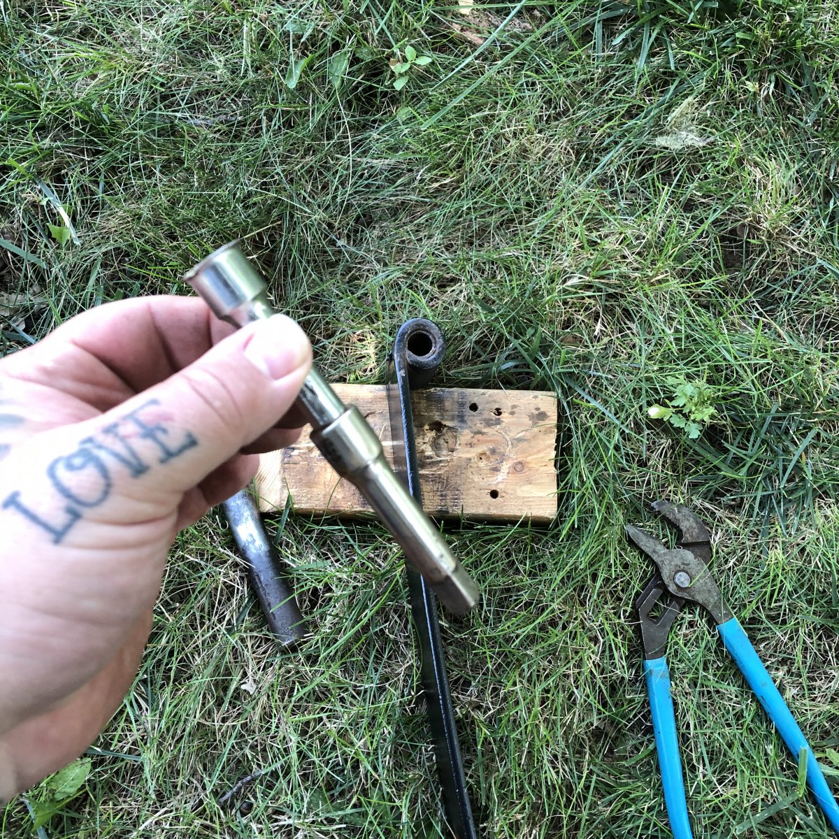

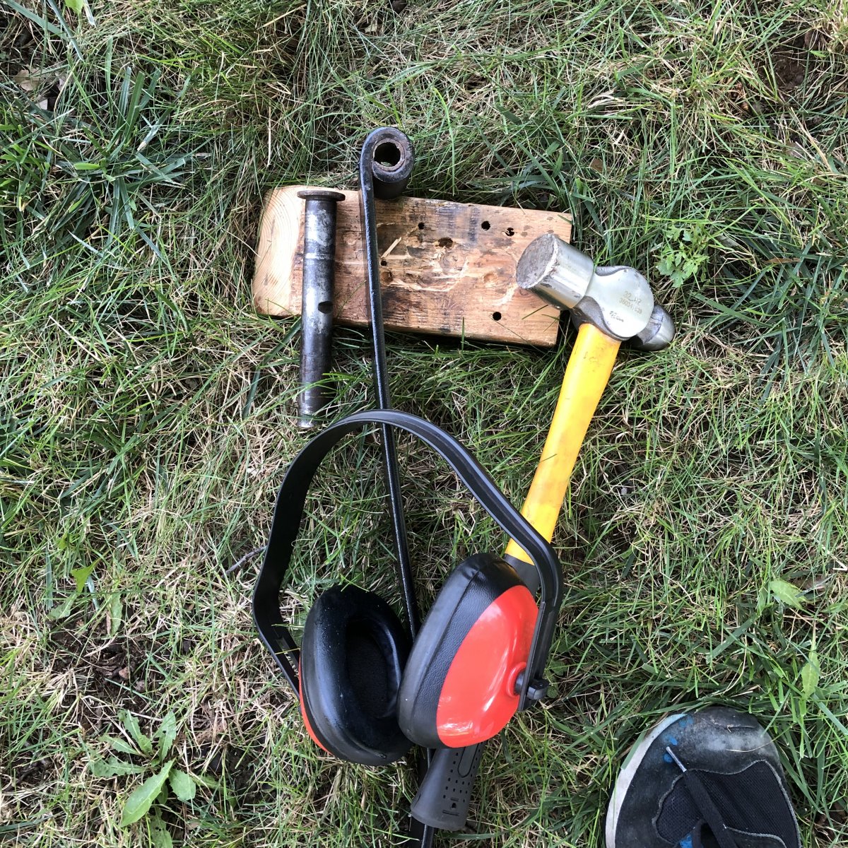

    “Progress” FCE4E142-9584-4D1A-8A30-21B2342B4CD8.jpeg a zillion hours into cleaning up the rear T leafs we zinged something off. Come to find that the stock T bushings have a hole in them that lines up with a hole in the spring eye and the shown above Oiler presses in. A little spring loaded lid flaps open to oil the bushing!
    Kinda neat, looks like older ones have a screw in cap. I’ll probably order some the next time I get stuff. Wont use them for oiling but I think they are to neat to not keep. 1366FEEA-130D-44D5-8114-7D8C81B39871.jpeg New posies pack laying next to the main leaf of the pack I had in 3FB1531C-3962-4AA8-8A3E-FDDA2B8FCF3D.jpeg noticed the posies pack don’t come with spring clamps. Guess I’ll buy a set when I get some for the rear.
    Got the old spring taken apart and out pretty easy other than trying to figure out how to get tall enough jack stands to hold it up. I ended up using some osha approved 2x4’s. Not sure what I’ll do in back. Guess I’ll scroll back a dozen pages and see what I did last time 97E1C61A-86C5-4A9B-8FCC-CC667E138210.jpeg mocked it up for ****s and grins. Also forgot to grab bushings for the front and back springs. I called and Pete and Jakes will have them on the counter for pickup. D6D59AEB-A4DF-494B-8AC2-693A816F6F62.jpeg On that note the bushings in the T spring needed vacated. I was all set with my favorite king pin/ drift when I realized I have something for this ED0201AA-C746-480F-B9B0-74B8666088CD.jpeg mushroomed together the center lump pushes the bushing out A2BA6D84-C738-4FAD-8B87-9BFEEA552FA4.jpeg slide it in, hold it with some channel locks and 5 or so swings with a big hammer and they are out!
    Stogy, brEad, Inked Monkey and 5 others like this.

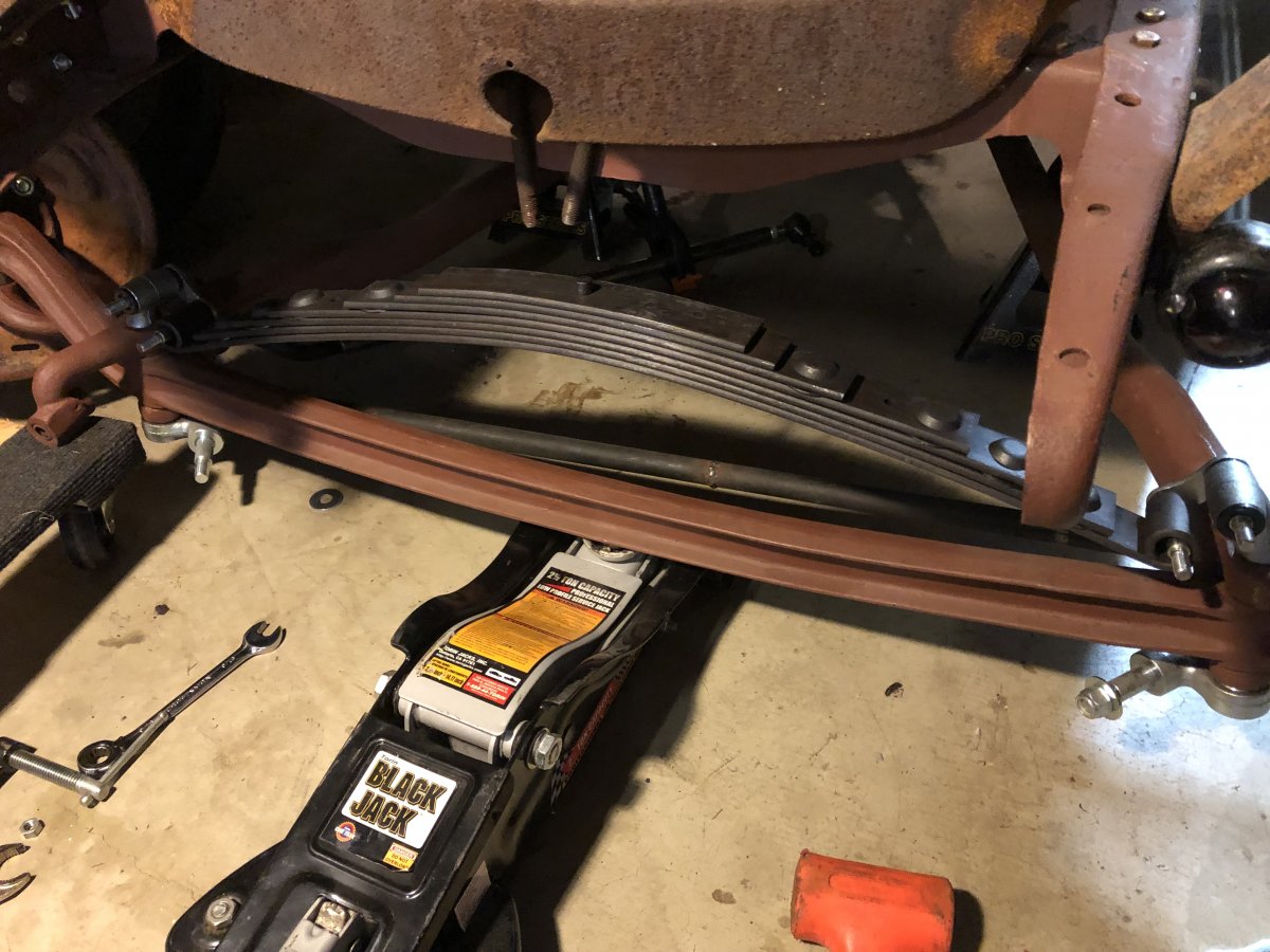

    Well this morning we ran down to Pete and Jakes for some spring eye bushings.
    Got the front spring loaded- much much nicer product than the speedway ones I used on the other spring- and got it bolted back to the car.
    I think I need the smallest of spacers to get the clamp to draw tight as it’s bottoming in the cross member but I think the spring is all the way into the pocket. Hard to tell if it’s got the tie bolt in the hole but it seems pretty even side to side and it made. A big racket when it landed so for my purposes I think it’s close enough. Not like this isn’t going to come back apart more times than I want to before it hits the road lol.
    Aaaaaanyhow. Quite a bit lower! Very happy with the super low posie spring so far. I’m debating wether the frame needs a notch to clear the spring travel or not.
    These don’t move all that much, but i think I’ll go ahead and do it anyways. If the spring settles as much as the one on my 46 did I’ll be happy I did it while the car looks like this and not all together.
    That being said this is roughly where it landed. 7 even from the chin/splash pan.
    Things to keep in mind for those playing along at home. 500/525:16 wheels. The car has a heavy nose down rake and is currently on dollies so it may come up a tad when I drop the rear down.
    Also! I’m using 46 wishbones so the car is automatically ... let’s say 3/4 of an inch give o take taller than the same set up with A bones because the yoke is thicker.
    If it really needs to come down another inch and the spring doesn’t do that eventually. You could stick it in a mill and chop it down and put the 60 -I think - degree taper back in for the perch pin and have down that much.
    Gonna get after the rear tonight/ this week. Photos don’t seem worth while st the moment but I’m sure I’ll take 700 when it does come time

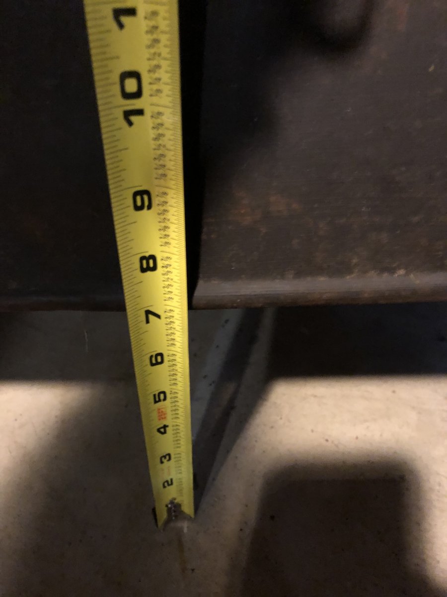

    Out of curiosity @flatout51 @drdave how much space do you guys have between the top of the spring pack and the bottom of the frame rail at the inside edge of the frame rail? I think I’m about and inch and a half at the moment.
    I can’t see that part of the spring moving that much if the ends are only going to see 1.5 even in heavy use? Just debating the notch while I wait for hardware for the back spring.

  20. drdave
    Joined: Jan 3, 2006
    Posts: 5,367
    drdave
    That’s a great stance right there. You get close to that and you are golden.
    Not sure how much clearance I have spring to frame. I’m out of town this weekend, but I will measure when I get back and let you know. Drove it for the first time the other day after adding a leaf back to my rear spring. No banging in the back that I could tell, but I do bottom out somewhere in the front very occasionally. Of course, I hit bottom in the Merc and the Chevy ALL the time, so the occasional hit in the A seems like a million miles of clearance to me. Haha

  22. flatout51
    Joined: Jul 26, 2006
    Posts: 1,326
    flatout51
    I haven't even looked at it since getting back from the hamb drags... haha! I'll try and get you a picture and measurement this week.

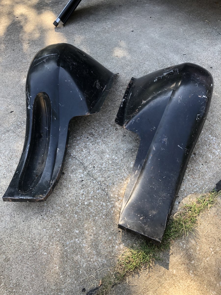

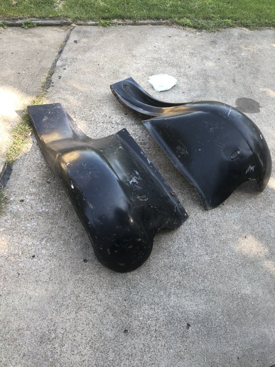

    Scored some waaaaaaay better fenders at greaserama and packed them into the back of the Subaru along with 5 people lol. C4F7B3CF-0ECE-4D19-A540-AB2316C5750F.jpeg 47012E0F-032D-45B0-B524-AAB8531E9263.jpeg “Naw they’ll fit”
    It’s even harder now to get a photo of the stance in the garage but I’ll get the U bolts on, the steering put together and roll it out with the new fenders on for the outside photos as soon as feasible. Couple weeks?

    brEad
    Those fenders look pretty mint. Nice score.
    Tim likes this.

    Yeah they’ve got a ding here and there but overall pretty nice, I’m super excited about them

    Those fenders look great!!!
