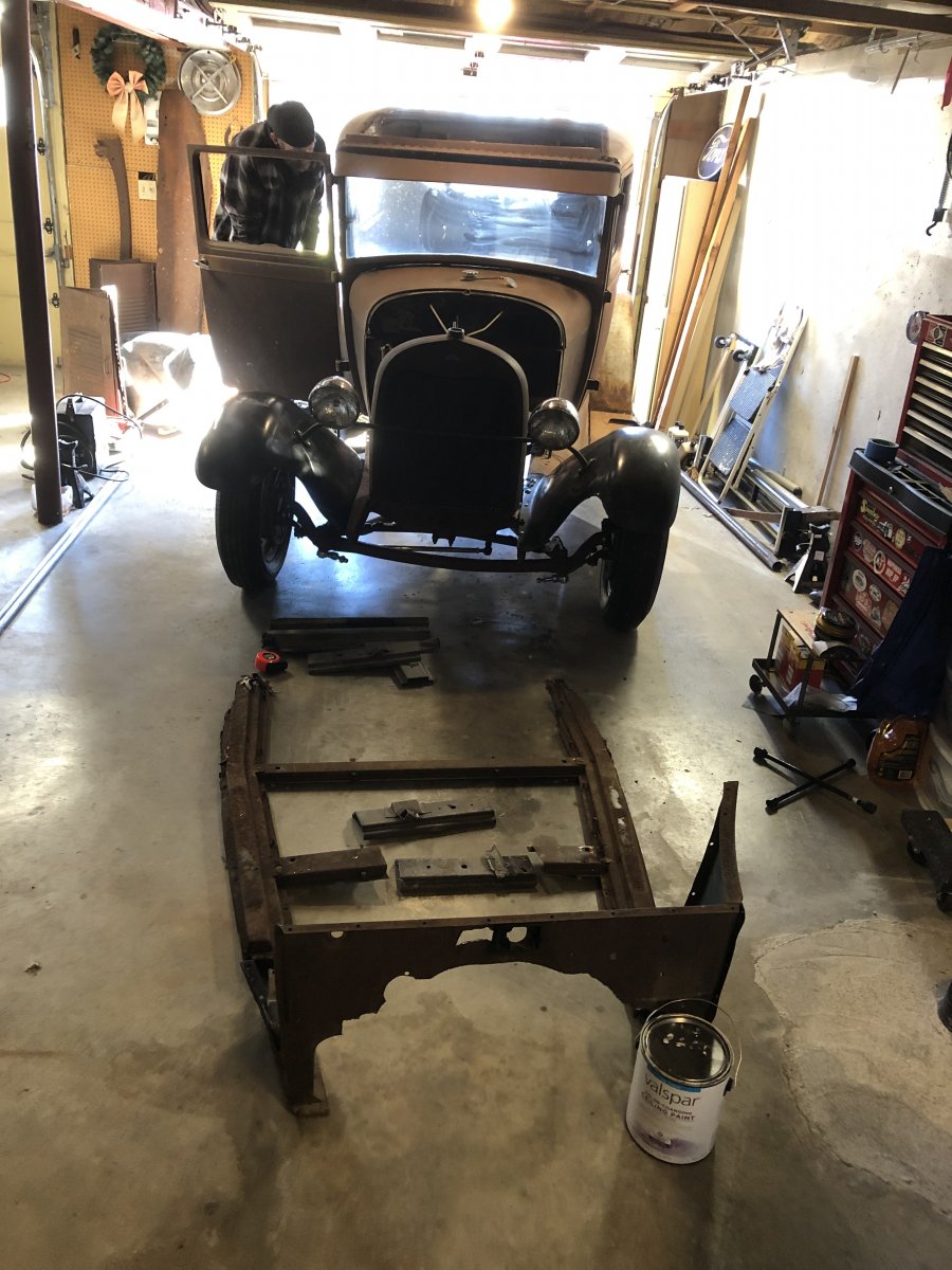

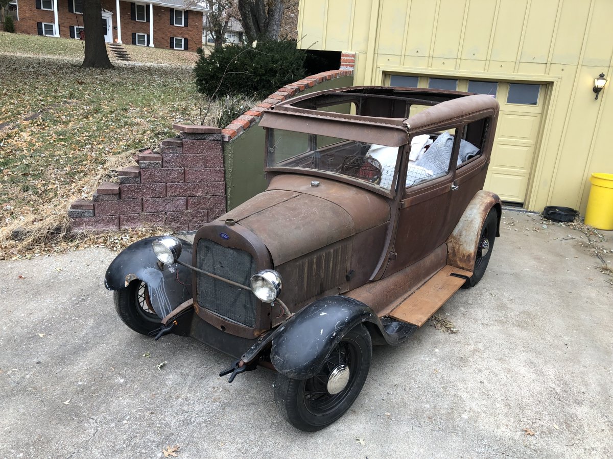

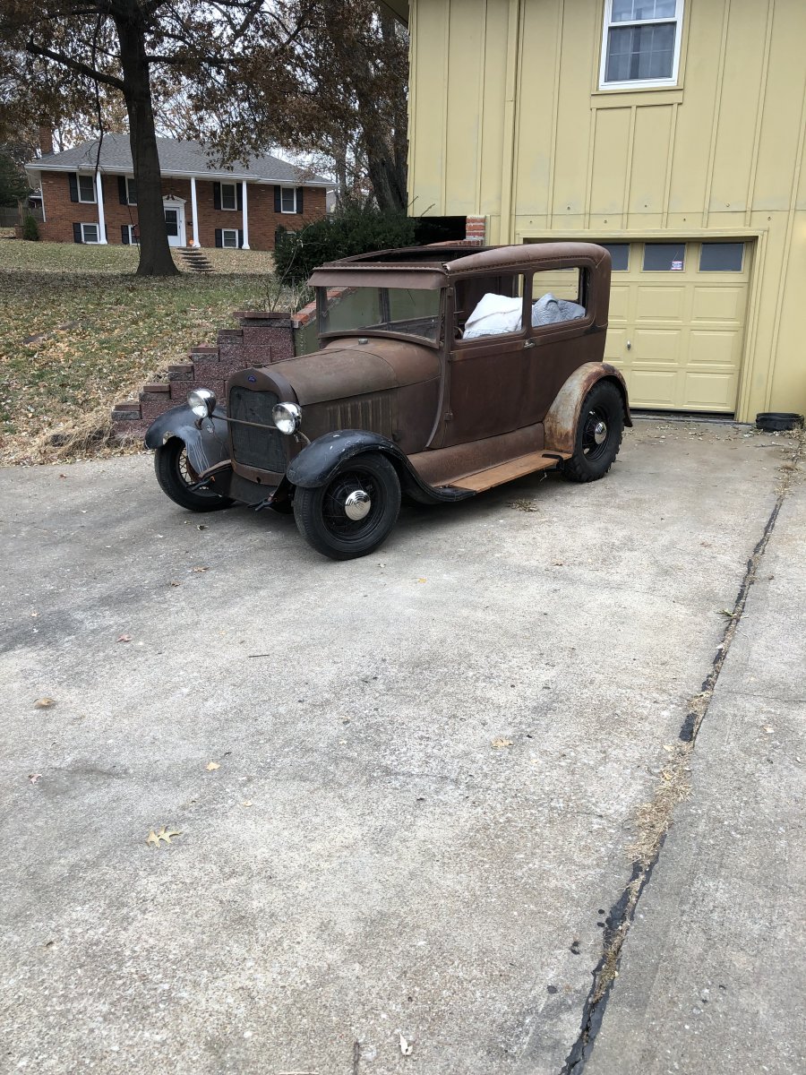

    Alright so my buddy Frank came by and helped me muscle this thing around out into the driveway and turn it around to put it back in with plenty of photos in between today.
    I have a video that shows the look much better than the photos but I can’t remember my you tube info lol. So here’s a bunch of photos EDD2D43A-4920-4F3D-BC49-B08B382CC9F2.jpeg 2.5 years since it’s been outside... 1850219B-02D8-4FF9-BA8C-87D64FAC4802.jpeg 6A973C67-2AB9-49A9-A832-624D785CBD6B.jpeg sloppy hood really kills the vibe on an early A but I had to see anyways 39ACD444-1403-4F7D-BFB9-B96D83D28B03.jpeg 5197473C-4F67-4064-AAEE-42C55C794B09.jpeg rear 3/4 is surprisingly my favorite angle at the moment 49E0AFE4-88B5-4CF7-92D0-E4DFD3A7D0F3.jpeg 25252FDC-8E8E-46A4-83FA-8EF2921CEEA8.jpeg head lights are pointed down a little which gives a funny effect as well. The car is raked forward enough that the stock set up won’t let me adjust them up. @drdave four door points down as well. I’ll either slot more adjustment into the buckets or I’ll heat and bend/twist the head light bar a little.
    That’s all for tonight!

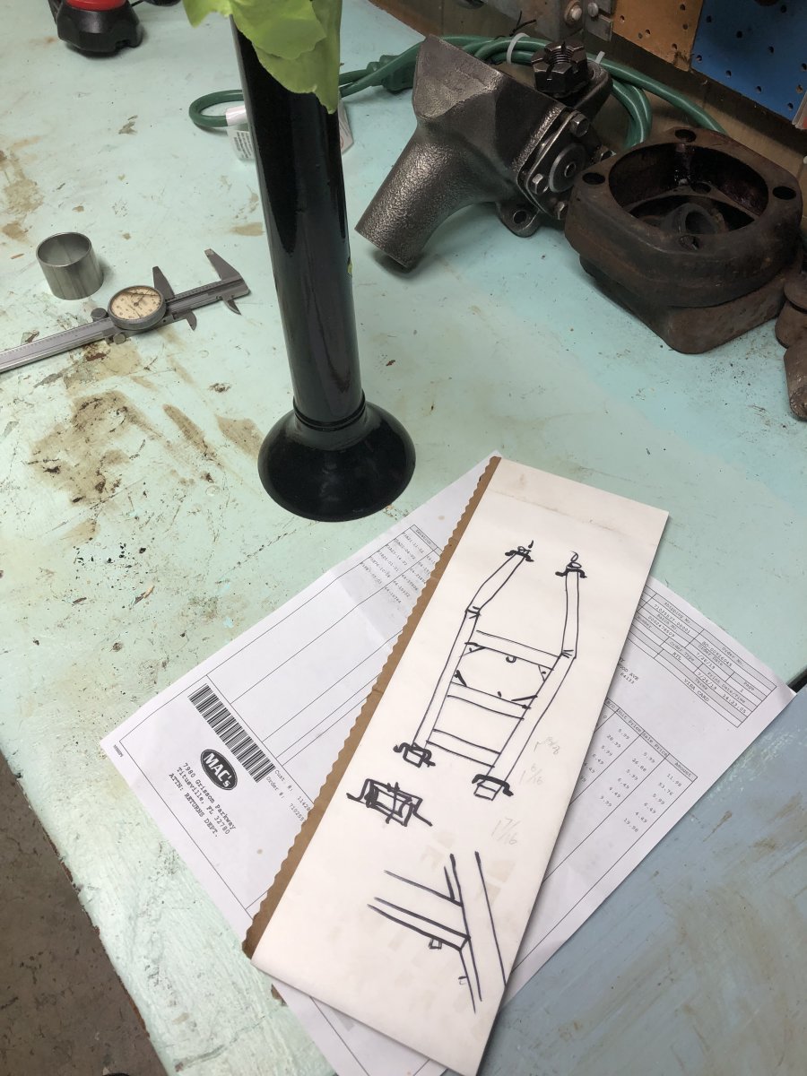

    That's looking fantastic Tim!! I like the idea of an old bowl or the like to fill the space between the column and the wheel. Surely something will turn up to be the perfect fit that no one will notice unless they know what they are looking at....those are my favorite details.
    I'm laughing @Six Ball about the community service. I think that would be something that would certainly be of help today, kids doing service for little stuff....helps them appreciate stuff in the world takes effort and maybe be more careful to not add to the mess yourself knowing someone somewhere has to clean it up if its not you. So far as the beer.....I'll leave that to your best judgment. LOL
    loudbang, Tim and Stogy like this.
  9. Tim
    Joined: Mar 2, 2001
    Posts: 21,576
    Tim
    from KCMO

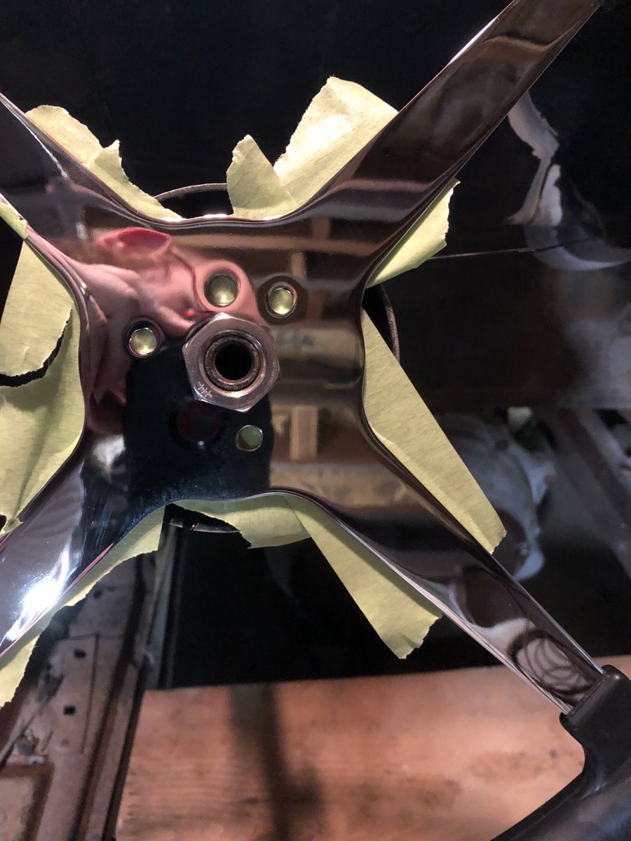

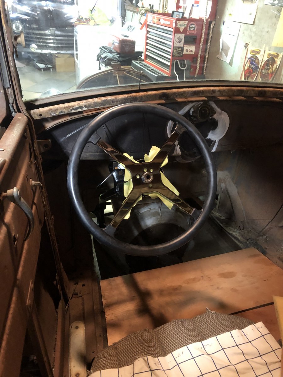

    The only gap I have now after making a new column and t******* the inside is seeing between the 4 spokes of the steering wheel ito the “bowl” end.
    I think I’m going to cut a circle of copper and acid etch a knit design into it. I’ll place it between the adapter and the steering wheel.
    That way if I need to get into the column I can, and it’ll cover the space.
    Why copper and knit?
    Well, the wife likes copper and isn’t super into engine turning. A mutual friend of ours is a jewelry designer that has been doing copper pieces with the knit design in them. I contacted her and she showed me a few tricks so I can do it myself.
    I also have some other plans for some fun etching tricks on the car :)

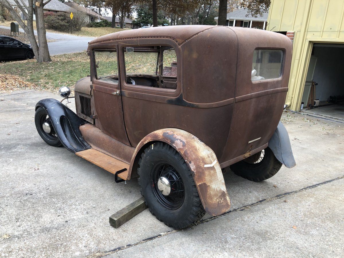

    7830F607-CABB-4714-8A85-35FDE832D586.jpeg And now it looks like this lol

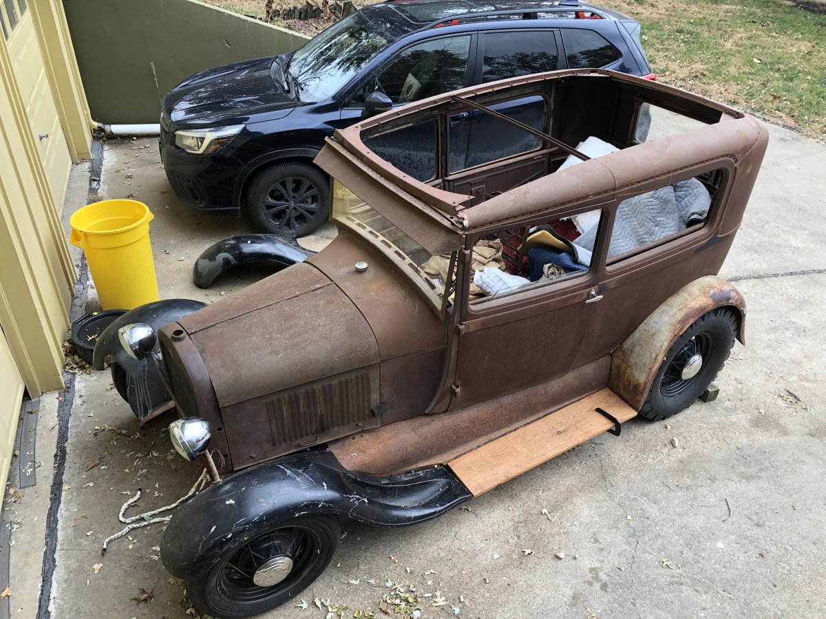

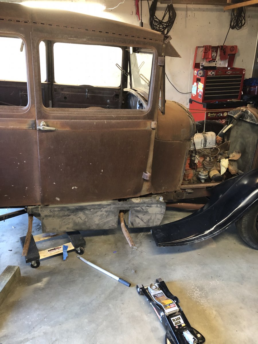

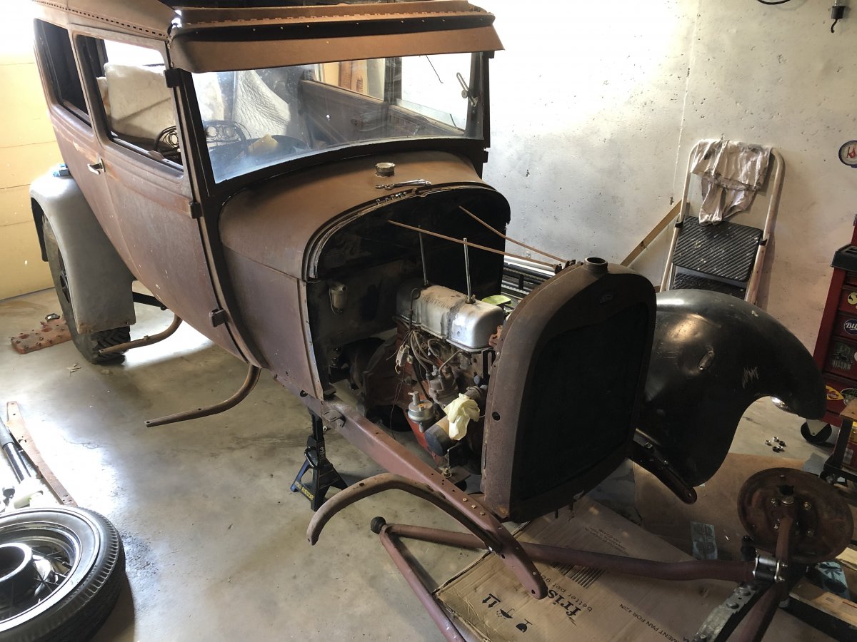

    Back together-ish. 87143259-6C98-4435-A05E-72C99D0F692B.jpeg Originally put it up to get the suspension dropped enough to drill the bottom holes for the steering box bracket.
    But once I got it dropped it was still in the way so I took it all the way out.
    Then figured it was a good time to swap the p***enger side fender out for the better one while I was at it.
    Think I got it on jack stands, front wheels off, suspension out, hood off, hood shelves off,fender and headlight bar off, new fender on and headlight bar back on in about an hour. And that was with ********ting with the plumber working on my house at the time.
    I can really see why so many stripped the fenders for racing. With nutserts holding the back fenders ala @Blue One it would take maybe a half hour if you were alone and working fast to strip it down.
    Having fun :) hopefully more progress reports this week.

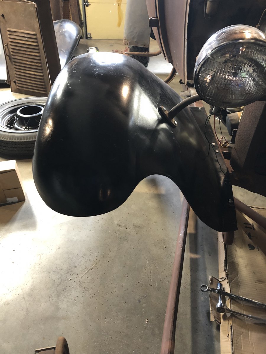

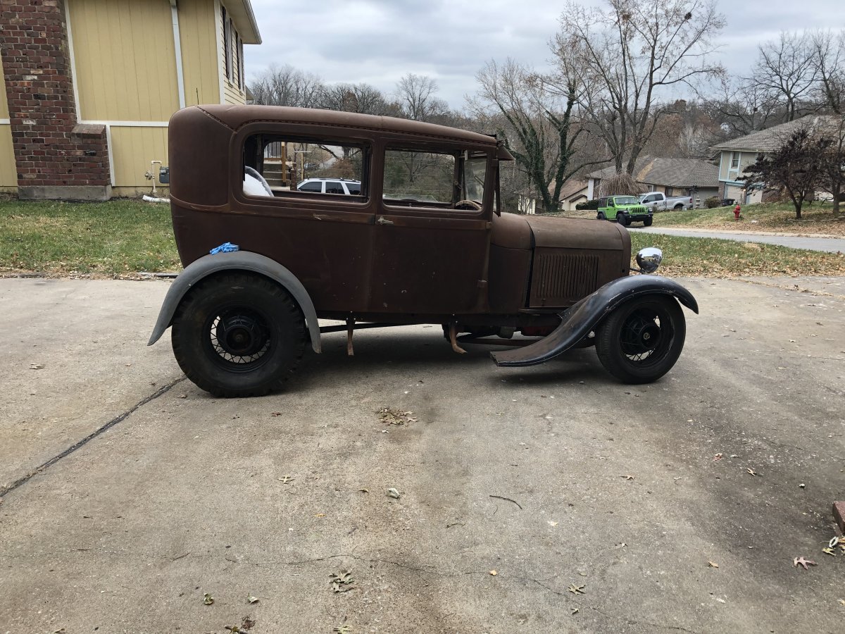

    B86E0773-09BE-4987-8115-6D03A36776DC.jpeg Walking out the door to work this morning it struck me that the front looked sooooo much better with the new fenders on. - new to me, not like actually new-

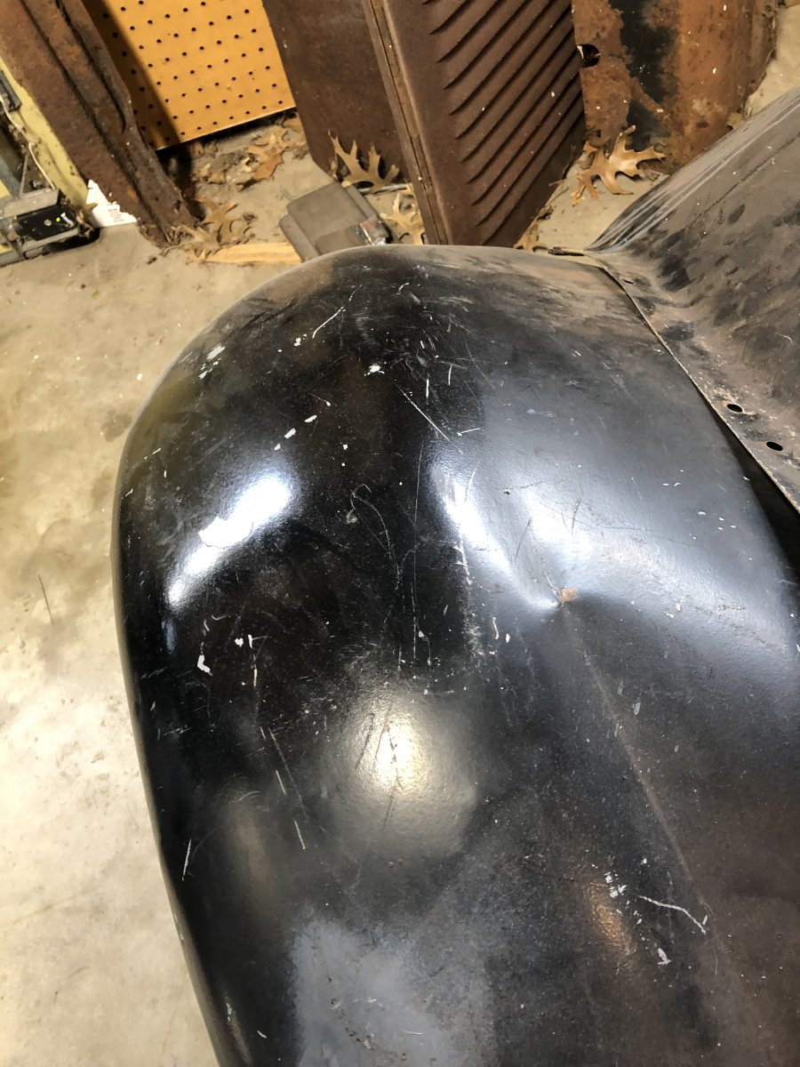

    C3346F82-FED0-415C-9FCB-D3CEEBA6B8DD.jpeg Then I saw it. Look at that body line on what is basically the inner side of the tire. Not quite a crease but a subtle bulge of body line. Scroll up and you can see it really clean in both fenders 3364C153-EB52-462F-9B4E-F41874572307.jpeg old p***enger fender ZERO body line 6B3136B2-310B-431C-8132-7776ABE04D13.jpeg drivers side barely has any. The both have a little of the shape from the running board side but once it reaches any part that covers the tire it’s gone.
    Man I knew they’d been worked over, patched and s***ched together but I guess even my initial estimate of “a bunch” of bondo may have been been flattering. I’ll have to look under neath and see if it’s been pounded flat or if it’s just filled on the top side.
    Never even noticed that until I had the better ones on the car lol. Learned something new today :)

  21. drdave
    Joined: Jan 3, 2006
    Posts: 5,366
    drdave
    Nah, I'm sure that's just a coat or two of high build on those....a little blocking and I'm certain the body line will pop right back into place. ;)
    loudbang and Tim like this.

    Lol. I got my first glimpse when the front edge that was chipped fell off and there wasn’t metal under it

  23. Aaron D.
    Joined: Oct 27, 2015
    Posts: 1,038
    Aaron D.
    I think that line is correct. It goes from the front of the fender to the rear of the fender and matches up with the running boards.

  25. Tim
    Joined: Mar 2, 2001
    Posts: 21,576
    Tim
    from KCMO
    Yup it is, my old fenders were beat to **** at some point and “fixed “
    The crummy fenders are still usable, the stock ones just look much better is all. Just thought it was funny that I’d never noticed the missing shapes.
    There’s a good amount of filler on the top of the fender and a good amount of 1/4 plate on the bottom side who knows what it might be hiding lol

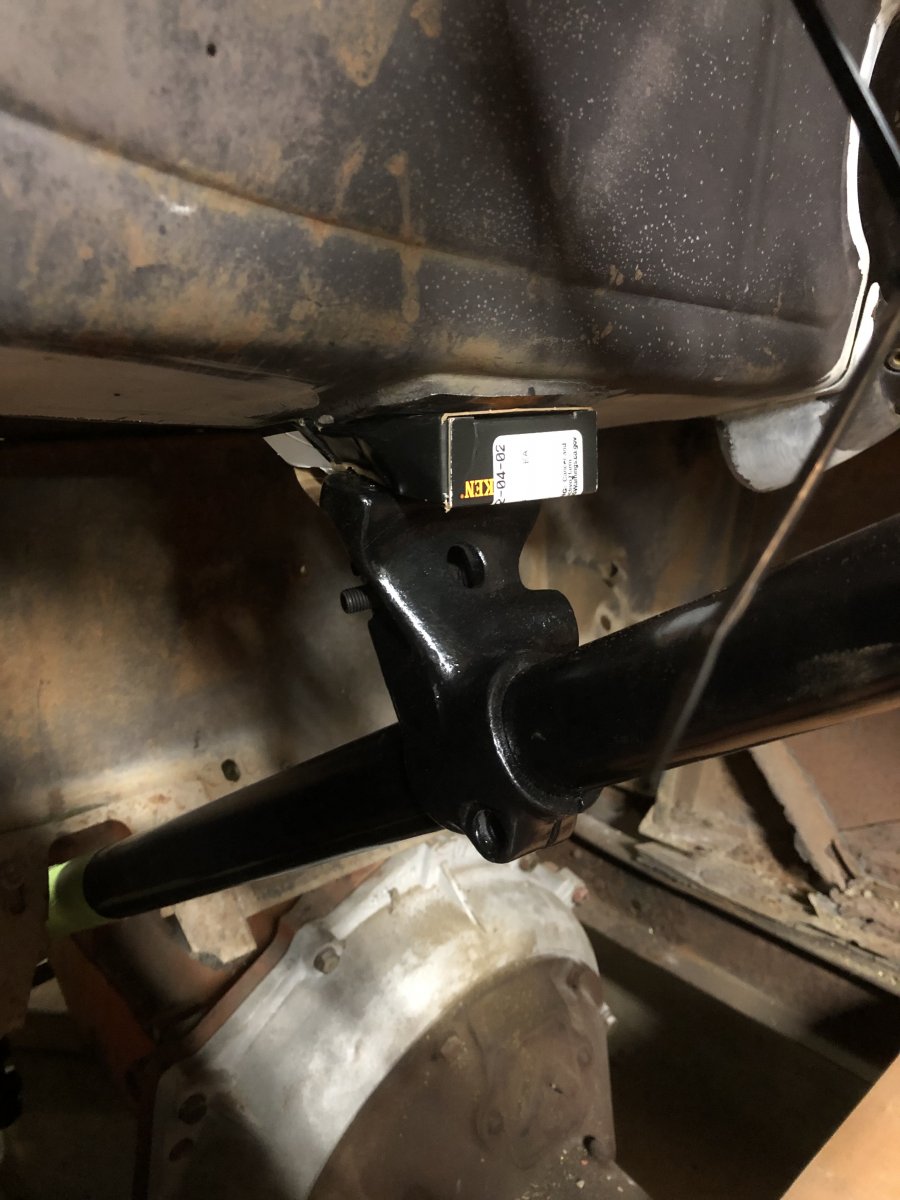

    Well, it wasn’t the progress I had planned but progress is progress right? 490112C0-AAB9-4CC9-9D86-D97E253E1976.jpeg we had planned on thrashing all day bracing the body and patching in all subframe 58384417-0D6D-41FB-9DFB-D82CF24DF425.jpeg thats two model a’s and a few T s****s for good effect. Well that didn’t happen. Family plans won over hot rod plans and we just made a game plan for next weekend. Much easier to do in person together so at least it’s something 4B8150DD-680B-4609-A8E1-65B5642CCFD1.jpeg jumping ahead just because that’s the way the photos loaded and I’m tired, I mounted the p***enger side fuel tank to make sure it actually cleared and fit and after learning some new swear words I had it in and held up the spare tire frame side of the mount roughly where it goes to make sure it would still clear everything. Looks good 5D9C55ED-C81D-47BE-93C5-059D0A328D98.jpeg tank in place. Kinda wondering how these fill because I’m having a hard time picturing a gas spout actually going all the way into a filler neck that short 0A6C346D-ED27-4038-BA74-3B7E0B5EF2C1.jpeg back to subrails. After looking at the head ache of patching 4 different cars worth of patches together we are basically going to make the center 1/3 or 2/3 of the subrails out of square tubing tying into the stock tie board stuff and the stock area under the seat. Thinking some 2x1 and 1x1.5 and we can build it outside of the car. Put it in threw the roof and sit it in
    it’ll be some back and forth and some hokey pokey but I think we’ve got a good plan and it’ll be stronger than the stock stuff was most likely. 2E9CB317-88A8-46DE-A7EB-EDC57D922F76.jpeg this is just to make me chuckle. Frame rail, splash apron, fender, hood shelf. And none of them are curved the same lol that’s what you get when you build a car from a dozen cars B8F715BA-BA19-4394-B144-C27B26A9599A.jpeg still pretty cool to see it out in the open though :)

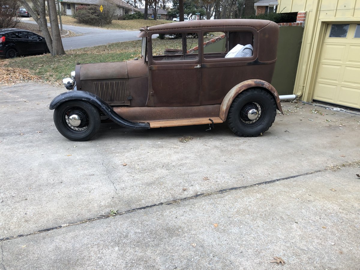

    I’m really stoked on it. Never thought that the rear 3/4 shot would be so good!
