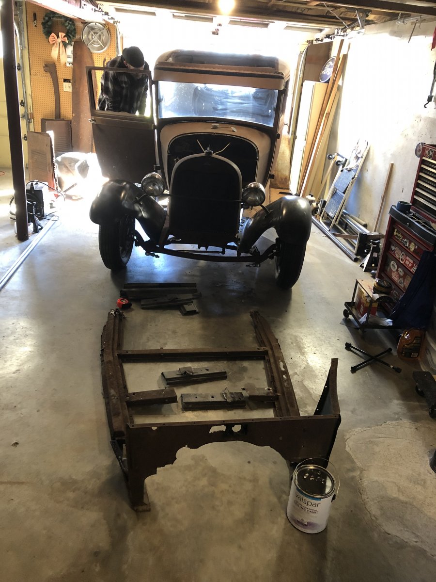

    Pretty much going to keep taking photos of this thing until I shove it back into the corner

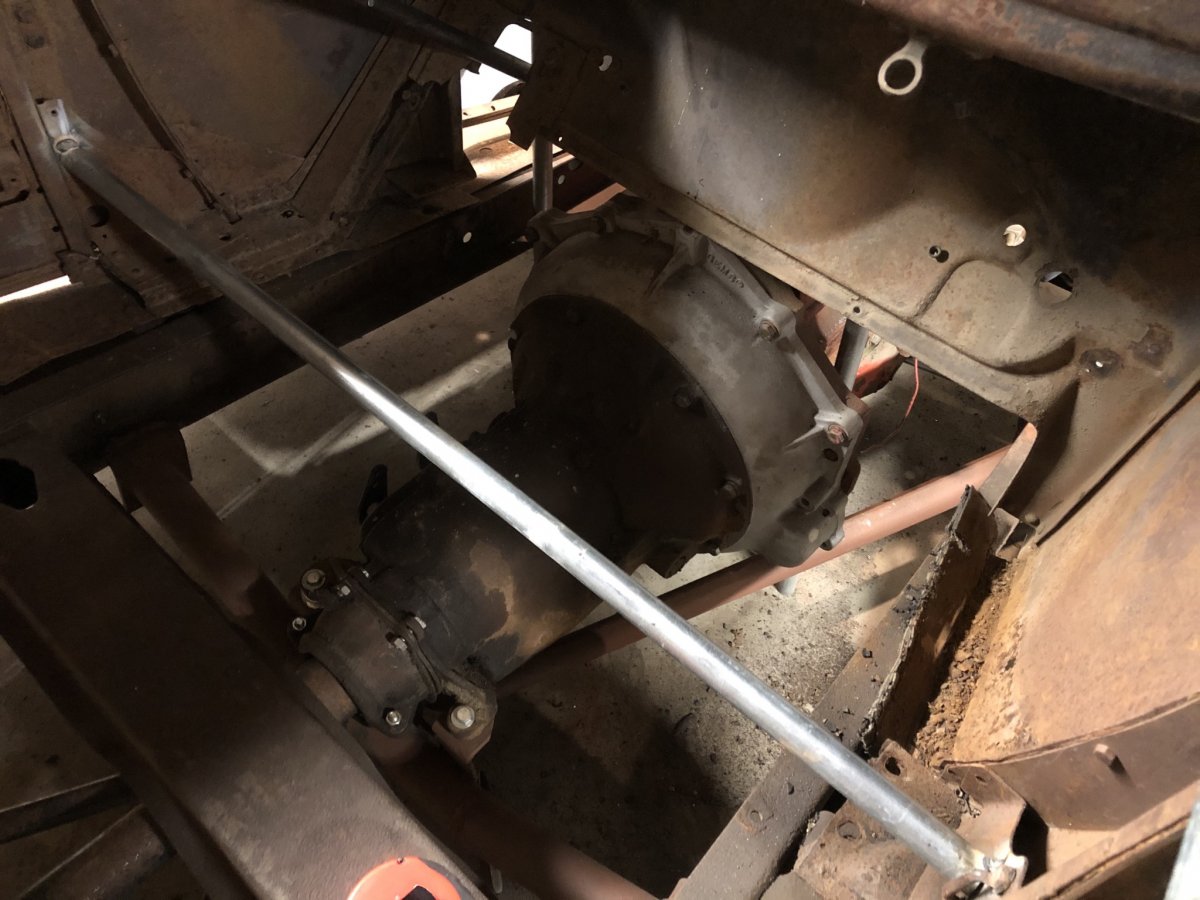

  6. Tim
    Joined: Mar 2, 2001
    Posts: 21,581
    Tim
    from KCMO

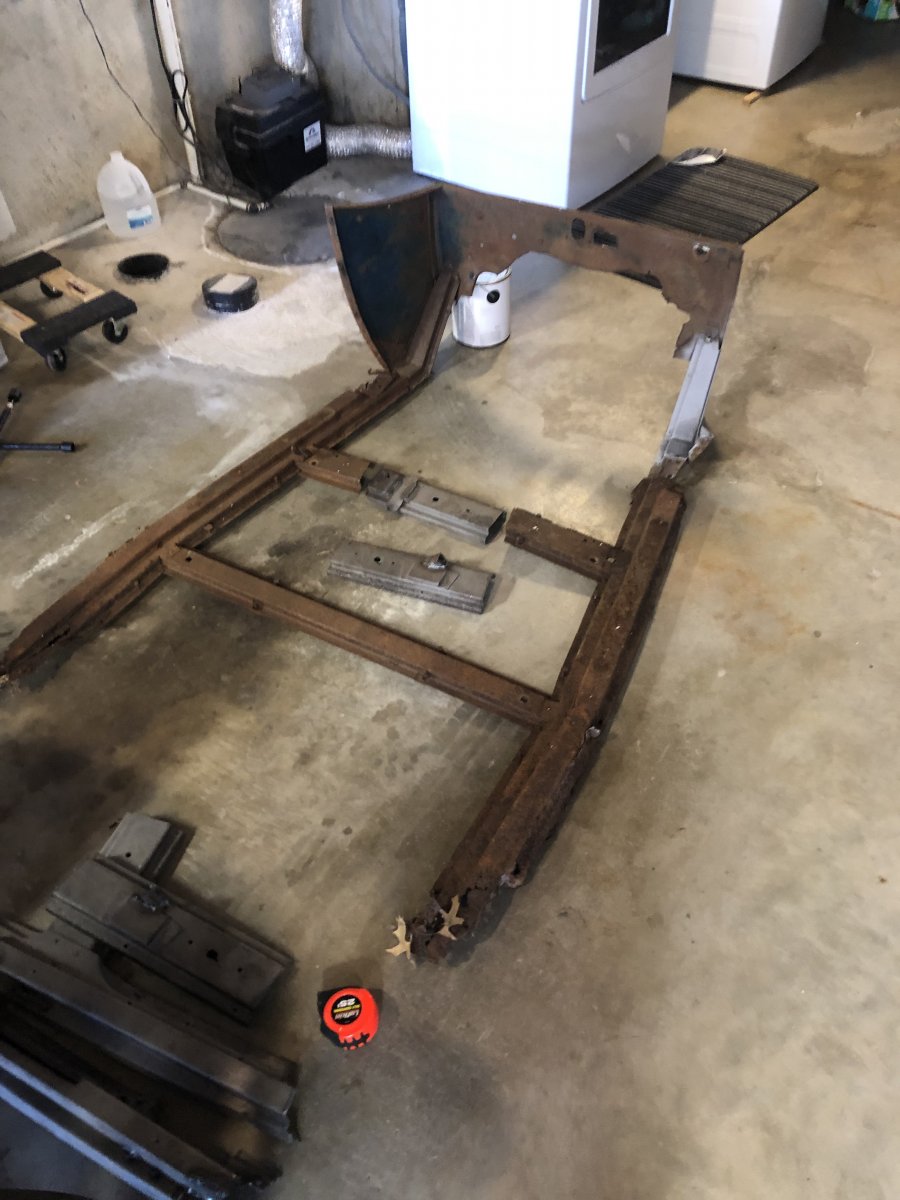

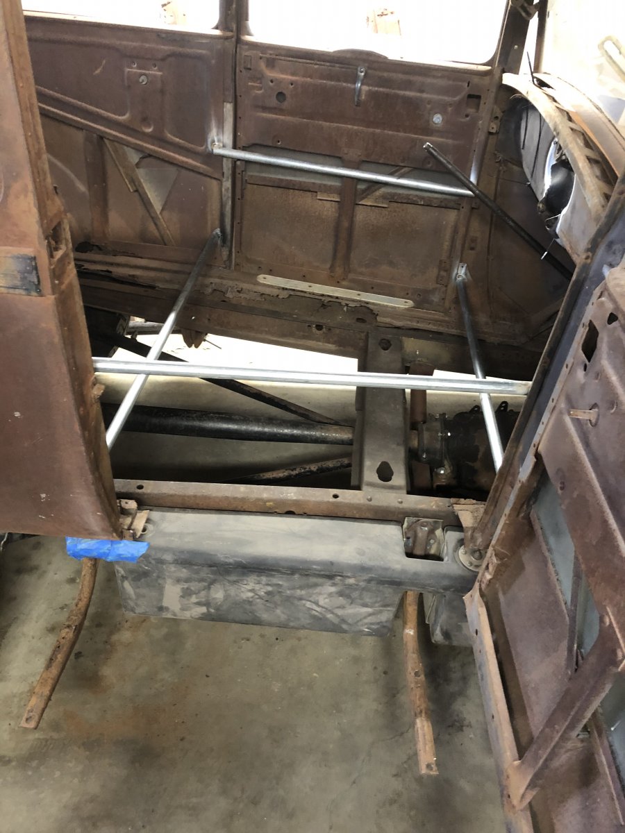

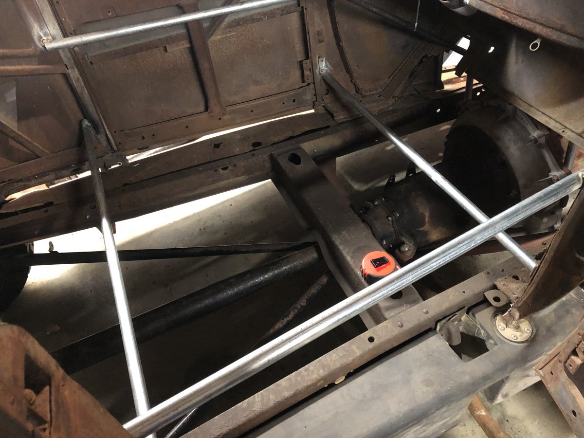

    Ended up throwing some bracing in tonight and getting everything straighter than it was 5CD1B5B7-1C92-4F72-AC37-939210570F8C.jpeg 65BD7AB4-98D4-4028-87D0-C846978046A6.jpeg you can see here how rotten the sill plate area of the door is. I’m going to go buy square tubing tomorrow morning and pick away at gutting this old stuff out and replacing the toe board areas so Sunday we can just get to work making the new parts.

    This literally has no subrails at all, I spent over a year collecting off cast parts to try and patch a set together and when all said and done it was welding rusty metal to rusty metal.
    It would have been more time and effort for a weaker result.
    I can’t afford new subrails, so box it will be. I’m basically mirroring the stock set up. I’m not going crazy with it like I see some people doing. More or less replacing top hat with box.
    If I sell it and the next guy wants it different we’ll thats that guy’s problem.
    @flatout51 yeah I think they just take an elbow and a cap on the apron. Right now I’m thinking I’ll use two stock gas caps so it doesn’t stick out to much but I am leery of how slow you’d have to fill them because your not going to be able to put a lot of the gas nozzle into it. Thought about seeing if maybe the motorcycle aftermarket has a telescoping neck or something?
    I have to fill the 46 pretty slow/ shallow so I guess it’s probably not that big of deal but I figure with the filler so close to the ground that I’d like to make it as easy as possible.

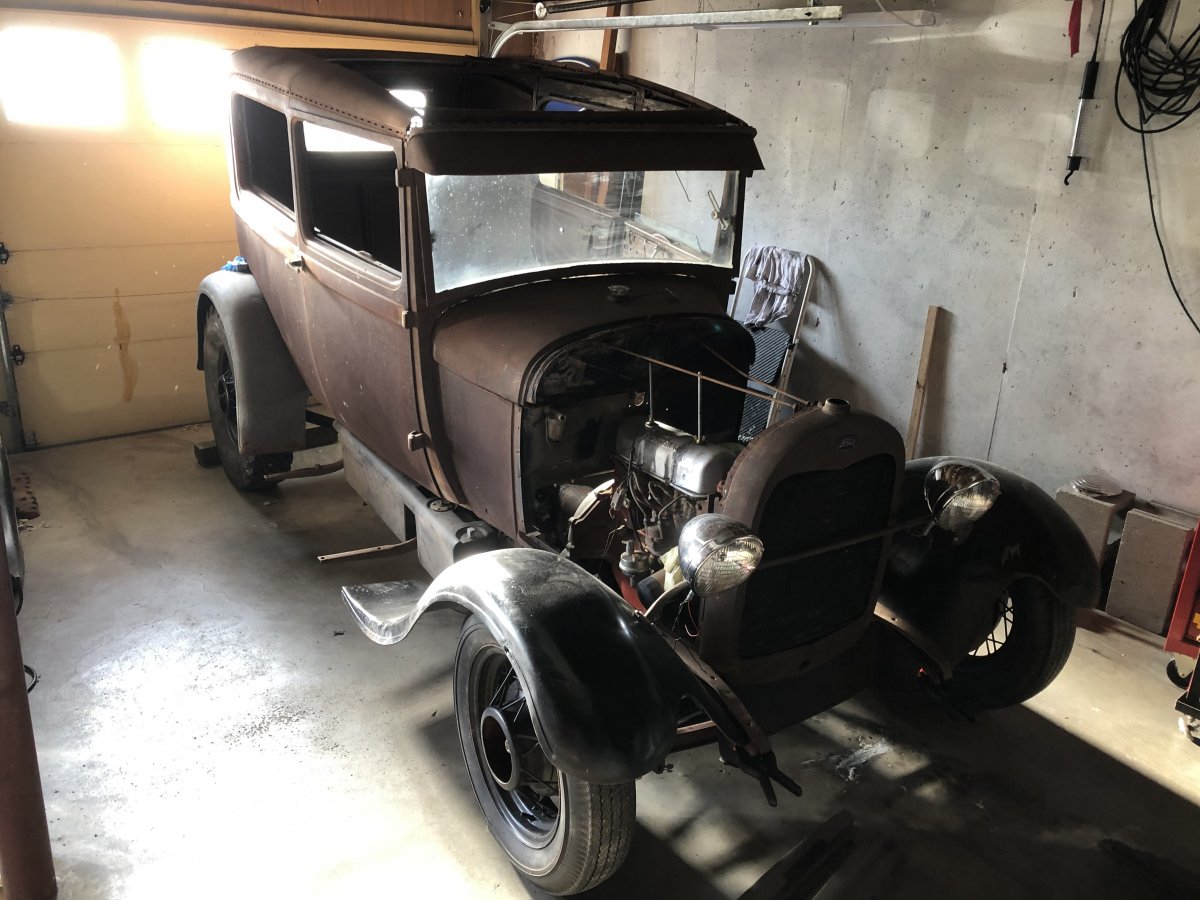

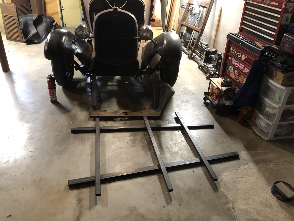

    To late now lol. 75AD73C5-7D80-4DE5-B67C-F9E021CAF9D4.jpeg 93BB2164-098F-4BB3-8E12-4B5C556B879B.jpeg Pulled the rotten p***enger sill plate area out and nothing moved. Feeling good!

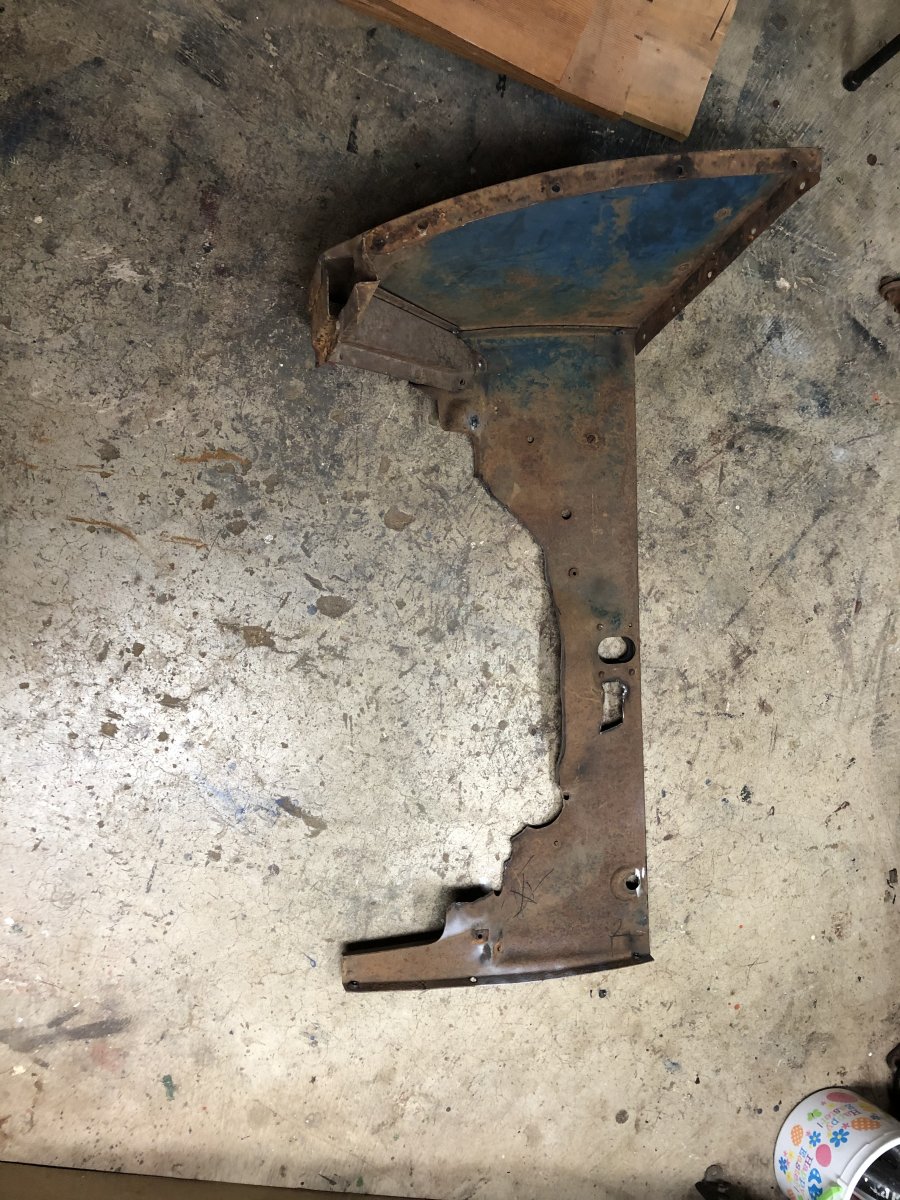

  20. Tim
    Joined: Mar 2, 2001
    Posts: 21,581
    Tim
    from KCMO

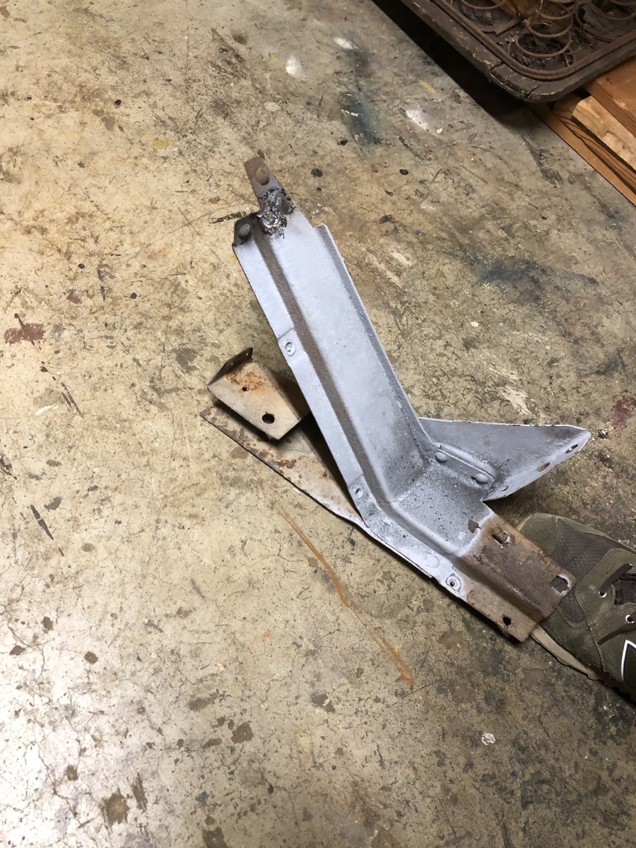

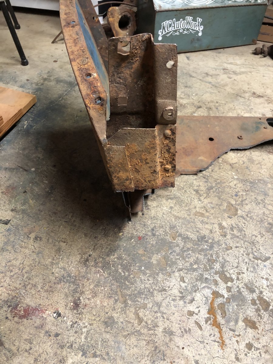

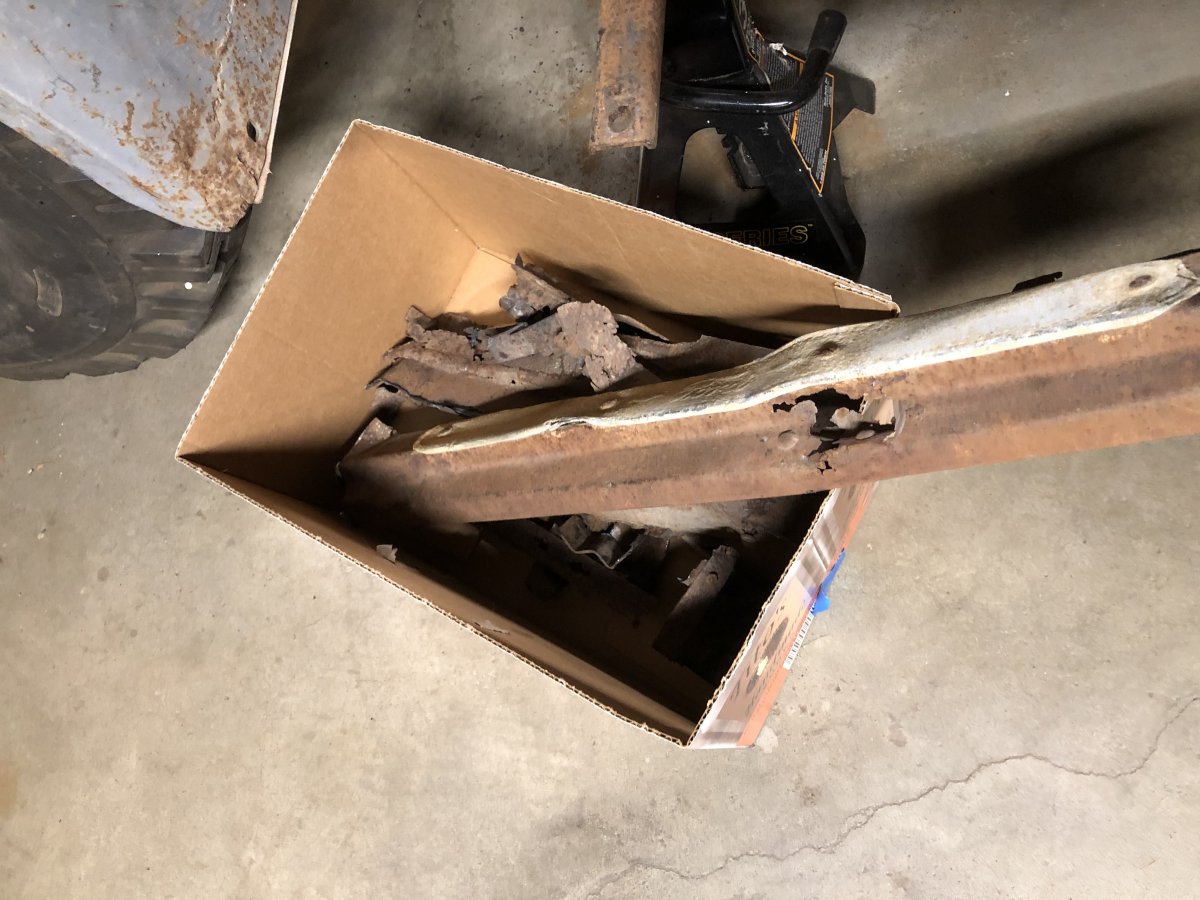

    Not to a point really worth rambling about but we got a few more hours in. The more we cut away and prepare for the new pieces the more the plan takes shape and we have a little clearer idea of what we want to do. E8B33F77-1557-4FBB-92D8-6EAACD2CD0DA.jpeg
    Firewall braced to the floor so we could pull the p***enger side cowl foot out. The extra/donor chunk of cowl/ firewall I have was priceless during this process. There are so many rivets bits and folds that hold it together that you can’t see when it’s on the car. We would have been swearing at it for hours with out it. And honestly if the old one wasn’t trash and sacrificial I do t really know how you’d get it apart with out a LOT of time involved
    New foot waiting to get cleaned up and painted. I’m also going to inlarge the 4 holes that rivet to the firewall. I’m for the moment replacing them with bolts and they are tiny holes. I’ll knock them up a size so I can use a 7/16
    Save for some paper thin door sills that’s the entire s**** pile

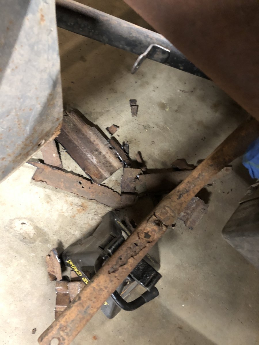

    234DF528-27F7-4185-8617-0789E7448961.jpeg 6B4A3569-9717-4320-A59B-6F3BEFEB13D9.jpeg
    Clearly this cardboard box of tet**** was not worth saving
    going to fit the new cowl foot, clean up, paint parts with rustolium rusty primer before they go together and prepare to start fitting new metal Sunday.
    After we figure out exactly what we are going to do I’ll give a more in-depth post about the how’s a s whys and the “to comes”

    The “parts” cowl bits. This helped a ton so I figured even a crummy photo of how the other side is still on could help sone one. Cowl side folds under and there are a few rivers holding it to the subrail C40D23D5-0E7E-4A8F-844C-FF0EF3D98519.jpeg 2238EF3C-3AD4-4E7C-8ED4-98D920974141.jpeg
    cant see them all in the photo but that’s where you’d need to look

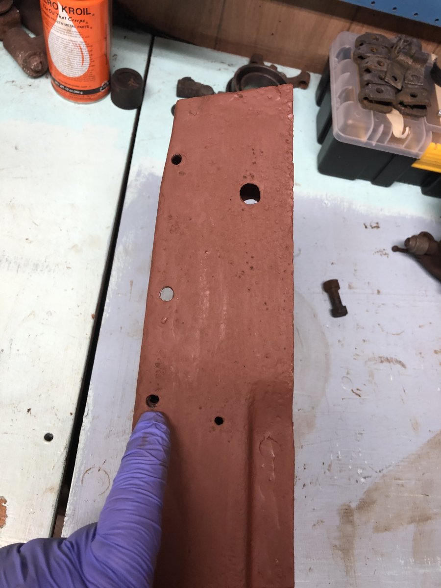

    23610EED-61D5-439A-8D2A-E5BCD032E18B.jpeg While cleaning up and painting the sections you won’t be able to see with rustolium rust primer I found 4, what looks to be spot welds threw the bottom fold of the cowl side- which is longer than just the tab on my spare parts one
    when I looked at the new foot it had 4 holes where I’m ***uming a rivet or spot weld must have gone threw the skin into the foot. Maybe @BigJoeArt remembers what was going on when he took the side panel off? I’ll ask him 1876DD6A-93E3-41B2-AC3B-7C73B8FC5922.jpeg either way, figured I’d post a photo of my hand pointing at the holes so when I take the body off the frame to address stuff I can’t reach currently I will have a nice “note to self” about the existing :)

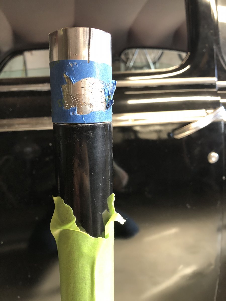

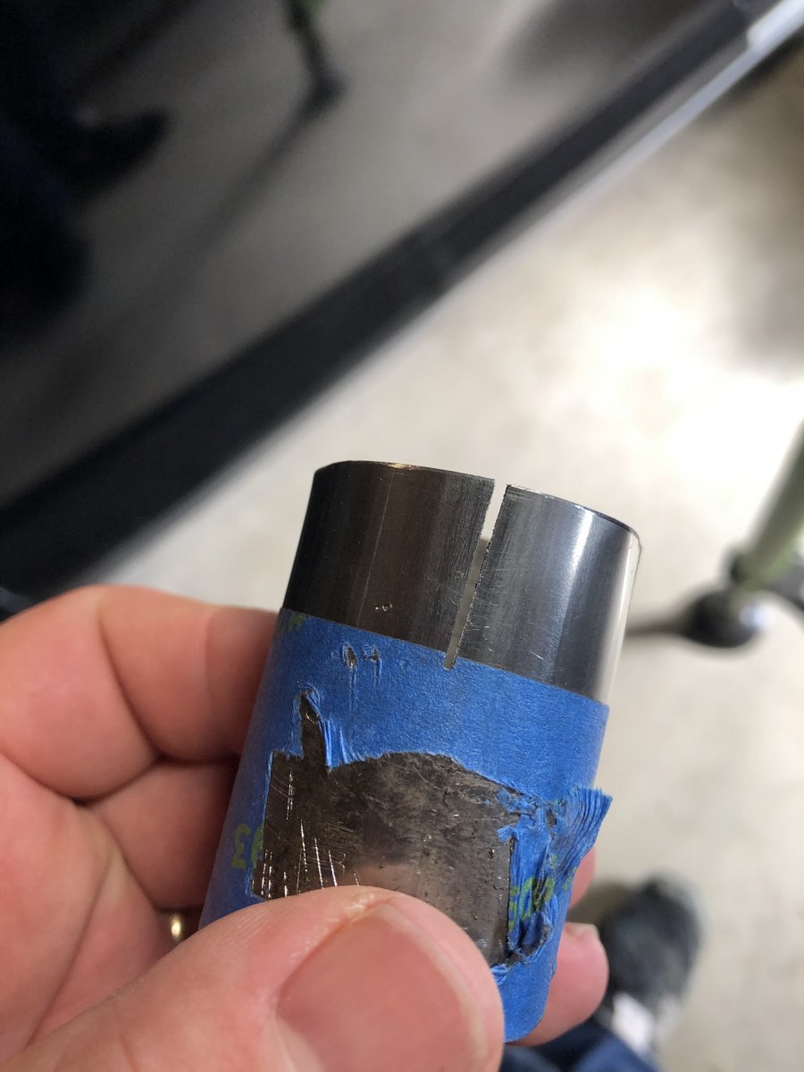

  27. Tim
    Joined: Mar 2, 2001
    Posts: 21,581
    Tim
    from KCMO

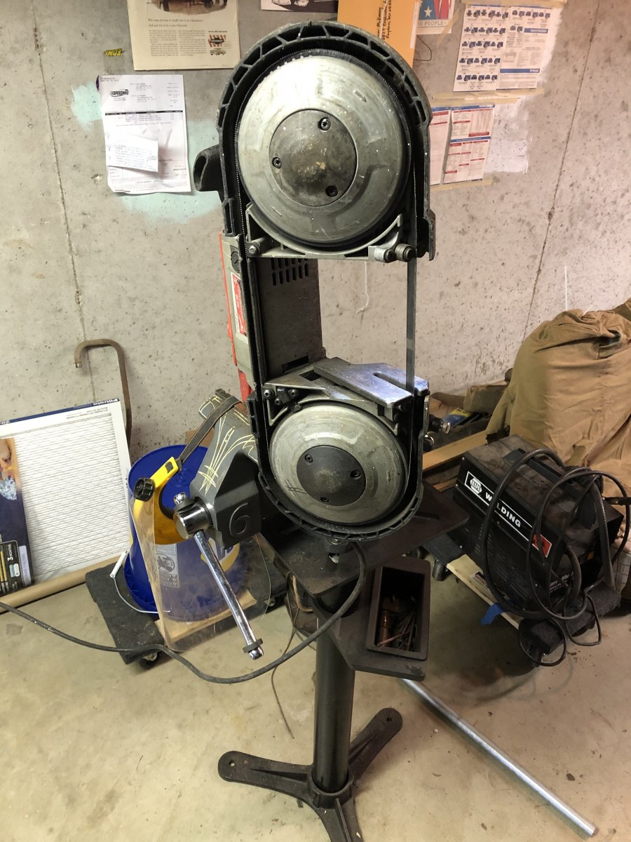

    691FCAA3-1E2C-4E1B-AE3A-AA8A93E9443F.jpeg 31D20B8C-32C8-4BFB-9050-F5F60BCECB77.jpeg 17E1DBB7-33C8-46D1-B5C6-DBCB0FBE0F5D.jpeg 92FBC15B-D0C1-407B-B6D3-7D5284533498.jpeg Well after a trip to a friends lath and some filing the small tube for the end of the column still wouldn’t quite fit.
    after some conversation we decided I should just slit it and see it it fit.
    so I chucked the porta band in a vice and to a slice out of both sides at the same time.
    It went on but not far enough to easy enough.
    so I stuck two wrenches in there and spread it some. Slide it over the steering column and tapped it over the box with a hammer.
    Some channel locks got it back off and now it fits just perfect by hand.
    gotta trim both ends and weld it up, re spray the bottom black and I can finally stick the column, adapter and wheel on for real!

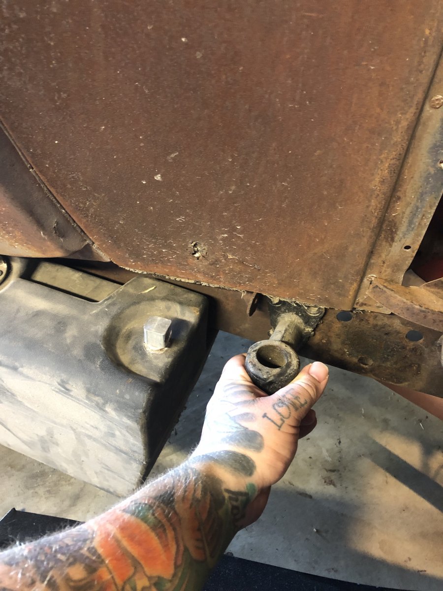

  29. Tim
    Joined: Mar 2, 2001
    Posts: 21,581
    Tim
    from KCMO
    Haha my buddy neko came and striped a bunch of my shop and the I beat on it for a couple years. Looks perfect now lol.
    Power tools in general are nothing to be takin lightly. Less than an inch away probably is about about accurate.

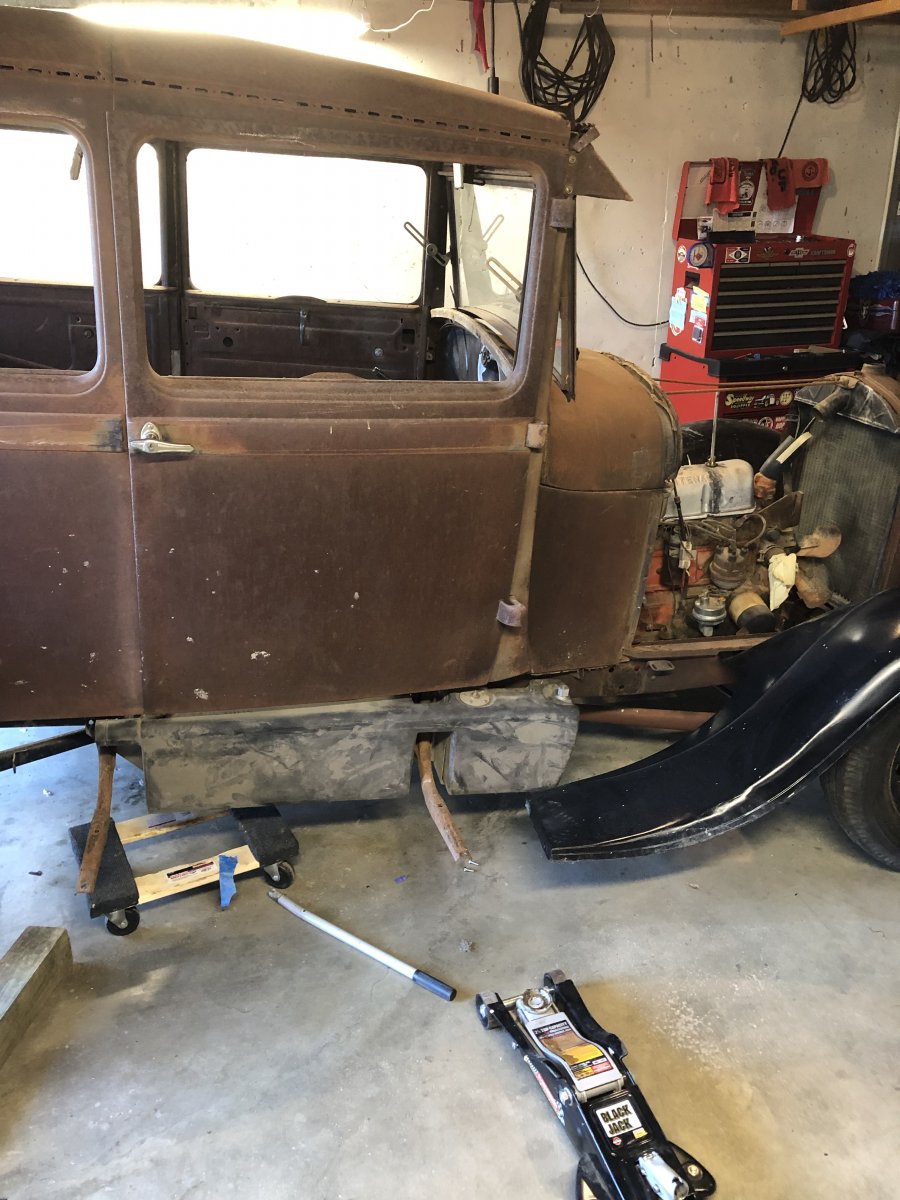

    this morning I got the last bolt in the cowl foot. I used a jack to lift the body up off the frame and rapped on it with a hammer trying to get it aligned. I really needed a spud wrench to push them around but what I eventually got to work is the bolt fit threw both holes very slanted.
    I stuck a nut on it and started cranking it right and it pulled it all into alignment. Didn’t seem to mess up any threads and it did t fight me at all. A little mechanical leverage does wonders.
    popped over to the drivers side and pulled off the wooden running board and crusty apron so we have room to weld Sunday.
    the old front fenders and the crusty aprons will go to @Inked Monkey because we are trying to convince him a T on A rails would be even cooler with A fenders. Haha
    Buddy is going to weld up the column tonight not sure if I’ll get to fit it before Sunday.
    update as they happen :)
