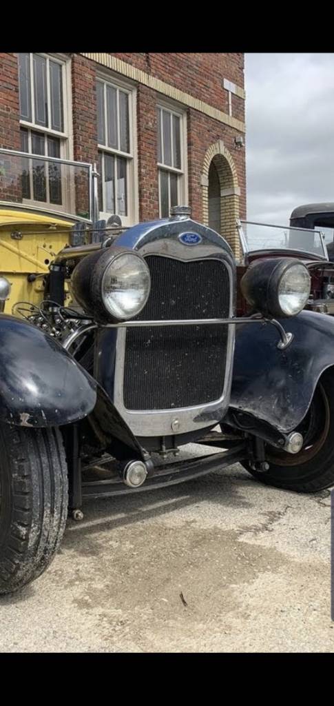

    Here ya go maybe this will help? Zoomed in roadster shots. Screenshot_20191213-180459_Photos.jpeg Screenshot_20191213-180552_Photos.jpeg

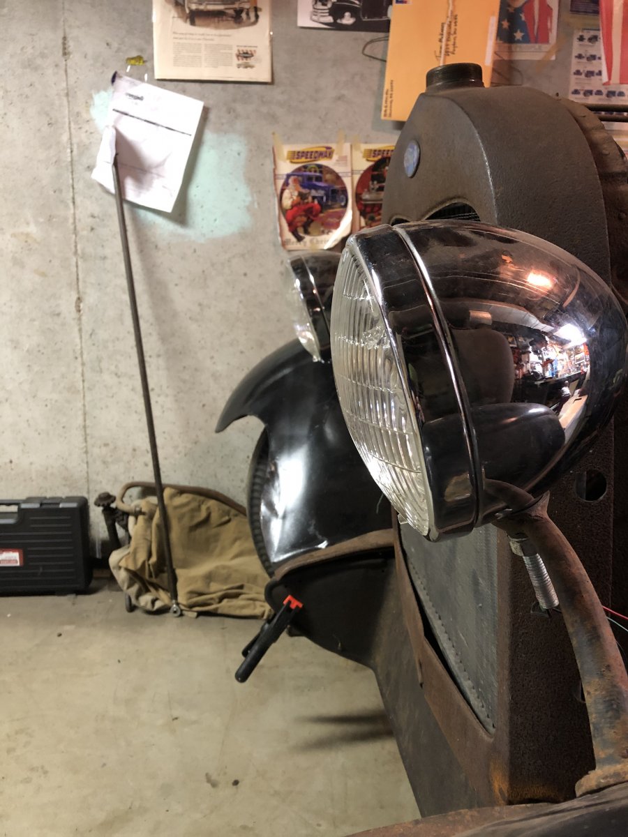

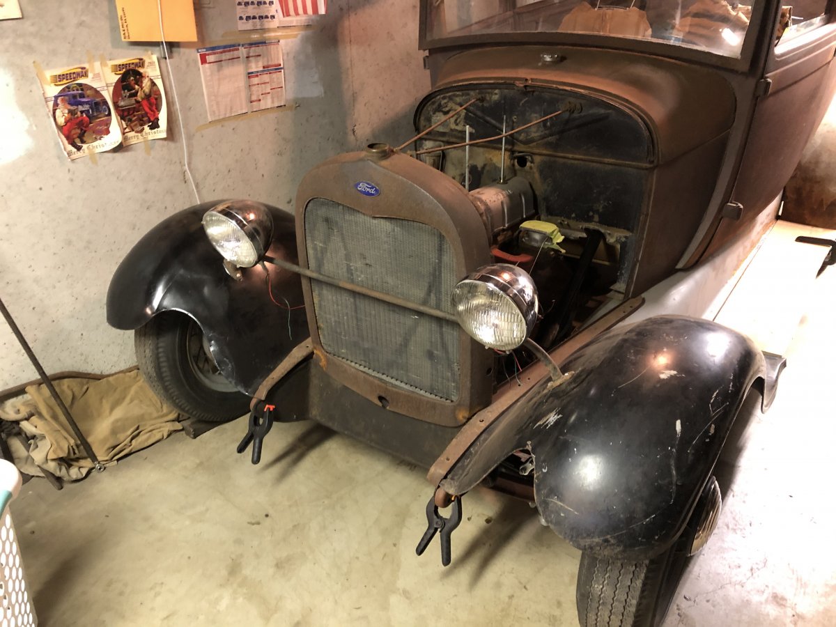

    Just bolt the bar down tight, take your torch and heat it on both sides of the headlight mount seat, stick a bar in the hole, and twist as needed; repeat on the other side.

    that’s exactly my plan. Just wanted to try it on backwards to see if it was any closer since I already had it apart

    Can't you heat it bend the mount up? Is that a cast piece? Isn't that what was used to make the original mounts for fenderles rods? I think we cut off each side bolted them to the frame horns heated them and bent the **** out of them till they pointed where we wanted. Maybe some bars were cast and some were forged.

  5. Tim
    Joined: Mar 2, 2001
    Posts: 20,781
    Tim
    from KCMO
    “The light bar is on backwards to see if by some chance it would line up better and require less bending, my plan is to bolt it to the car, heat the ends and put a bar threw the mounting cups and twist it into the correct placement”

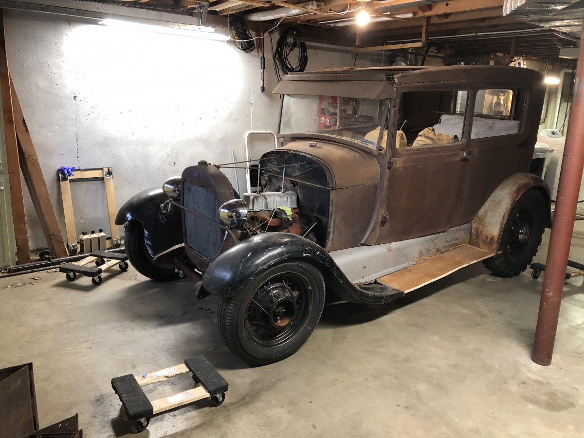

  10. Tim
    Joined: Mar 2, 2001
    Posts: 20,781
    Tim
    from KCMO
    Well, it’s ready to go back in the corner tonight after work.
    snows on its way and mama needs her parking spot back. To be honest I’m ready to have my stuff back where it belongs and to finish up polishing on the 46 so it’s good timing
    when I get back to it the next item in the list is building the fire wall/ cowl/ brake master bracing. That will require fine tuning the steering box bracket but after it’s done I can bolt the brake and clutch pedals to the firewall and move into making the dash flush and popping it full of holes for the gauges.
    my little mini me is all about wrenching on mamas hot rod and working on projects together so I’m hoping in the coming crazy year that we can get some garage time in together.
    anyhow some photos.

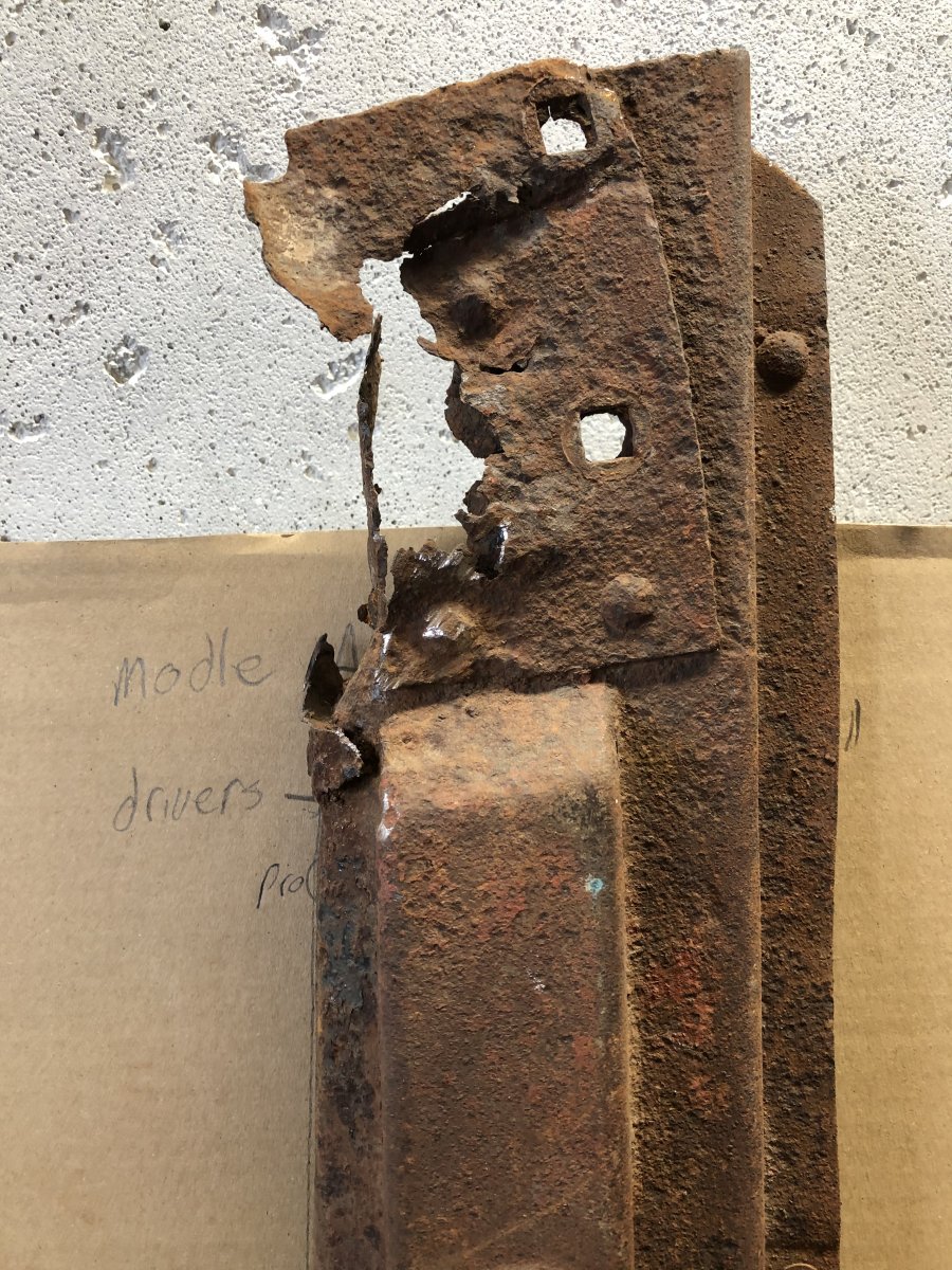

    I traced The profile of the stock door sills and made note of lose measurements and positioning. 30F21AED-D79D-4CD4-BFEE-940F9F44AACE.jpeg E910AF4F-62A5-41EB-88AF-6C0C1B4E4FD0.jpeg 73AFF991-CFDD-43FC-AD81-6373F514EBFC.jpeg 3999A26F-F573-4703-AE7C-600504158D87.jpeg 630EAD33-4B3B-4D2C-8AC0-2EB2AB0C02EB.jpeg

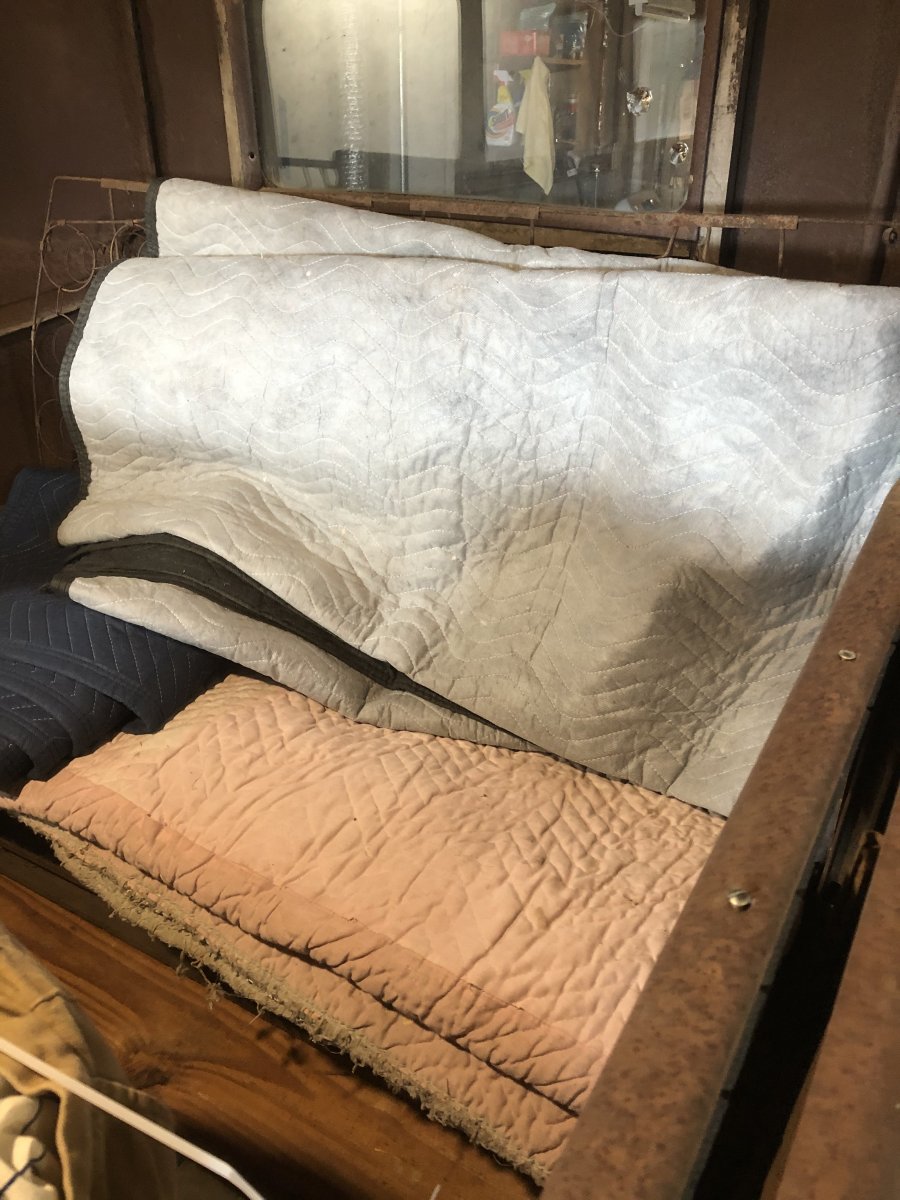

    Phone glitched so the photos came out jumbled. You get the jist.
    added some moving blankets to the back seat springs, and yes I spelt model wrong on the cardboard lol

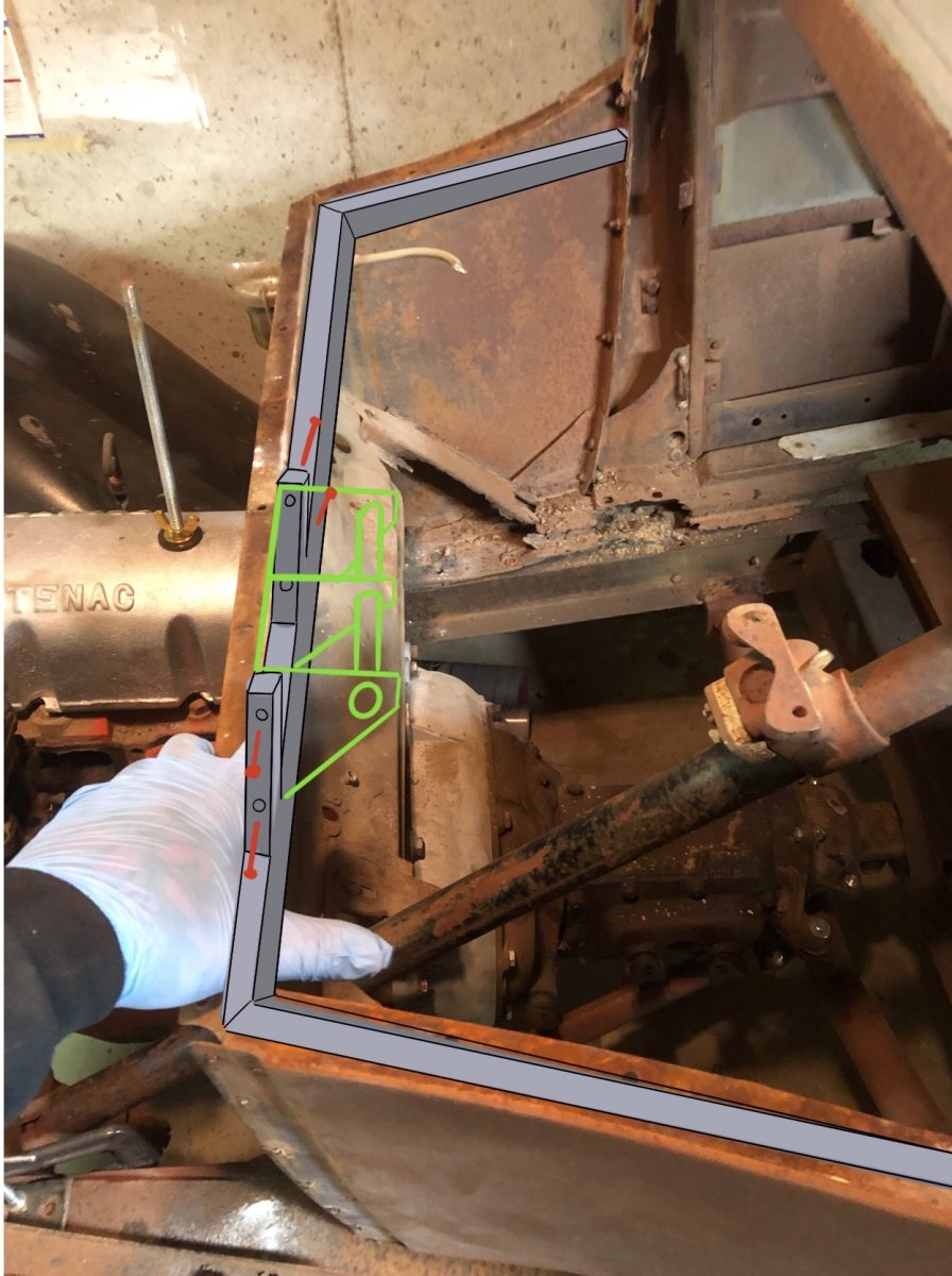

    This is what I have in mind right now. Second photo shows the pedal ***embly that is shown in green in the first photo.
    trying to decide how to attach it to the cowl sides and fire wall because it’s so thin I don’t want to warp the **** out of it welding it
    maube some vertical legs in the corners that weld onto the cowl feet?

  27. RICH B
    Joined: Feb 7, 2007
    Posts: 6,127
    RICH B
    Have you clamped the pedal ***embly in place to determine it will be that high? My kid had a channeled roadster where the pedals were up in the tank part of the firewall; but seems to me they might be lower on a regular body.
    If they end up high like your drawing, just skip weld the cross tube to the firewall; but drop the tubes to door posts below it to allow access to bolts that hold sides of the ex-tank to the side panels. You can't weld to the front of the door posts due to the cowl sides bolting in; use a flat plate from the rear side of the door post to tie to that tube. Don't block in any of the bolts that hold the hinge blocks to the outside of the door post. Can't see why you would need any tubes going downward. The ribs where the master cylinder bolts on are fun; but a little heat along with some hammer and dolly work will shrink them out.
    Stogy, loudbang and Tim like this.
  28. Tim
    Joined: Mar 2, 2001
    Posts: 20,781
    Tim
    from KCMO
    @RICH B fantastic advice.
    and no I’m not sure if they will land on the upper or lower firewall. I’ve mocked up it a dozen times but until now havnt had enough floor to really sit in the car and try them out.
    @Austin kays got me some “blood blister” strong magnets that I can hold the ***embly to the fire wall with to test it out.
    I was also considering sticking a tennis ball when the push rods will go to get the pedals up to where they would actually be.

    Watched an @IronTrap video of them pulling a 30/1 firewall and had a conversation with @-Brent- and have got some ideas brewing. Thanks to very one whos weighed in with an idea or thought :)
    But back to headlights I turned the bar around and measured for you all A5120598-4DD6-4342-8F22-7ACD204F6813.jpeg F9E6BC07-5AF4-418E-8FDA-38F677C1BF99.jpeg BFA20369-5B7E-4810-928B-AF2574C5D529.jpeg 7D888982-CE75-4F17-B921-780E922BCB1C.jpeg the back side of the retainer ring where it’s a nice flat source measures 17 deg off level.
    could be wrong but seems like these king bees are pointing to far down.
    oh, and I checked both, they are at the exact same angle. Just looks like ones better than the other in the photo. They’re the same
  30. Never2old
    Joined: Oct 14, 2010
    Posts: 743
    Never2old
    from so cal
    Tim,
    Notice that the mounting bolts are located near the bottom of the light bucket.
    This would work fine on a 4WD light bar.
    The stock lights have the bolts further up the back of the buckets so they work with the cups in the stock bar.
    loudbang, osage orange and Stogy like this.
