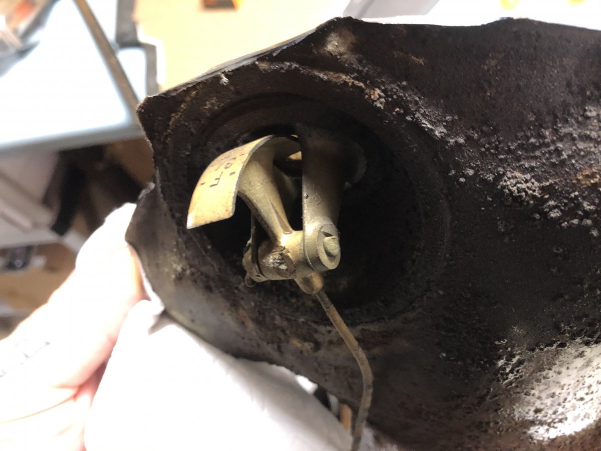

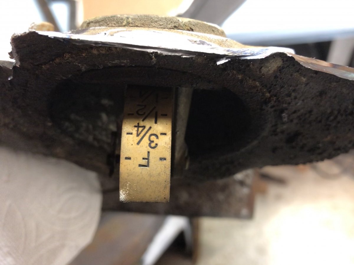

    That makes enough since. After some creative wording I got a search that popped up quite a few threads about running aftermarket king bee and other style headlights on a stock headlight bar.
    the solution in pretty much every case was to open the slot up to be longer so you can adjust it all the way.
    as these are actually @porkn****** head lights I’ve been using for mock up I’ll just leave whatever I end up doing til I have my actual lights in hand. Though I do plan on running basically this same light

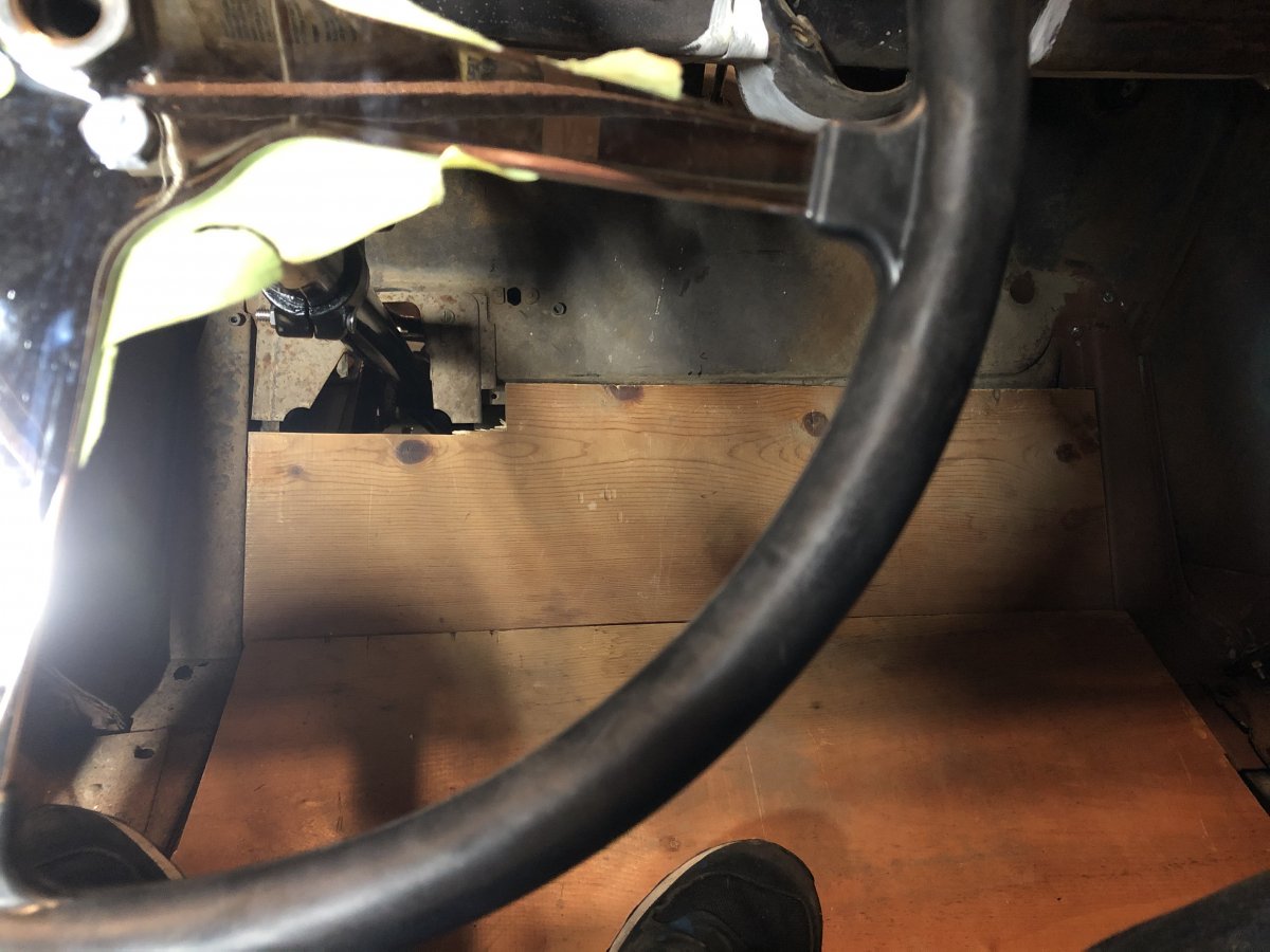

    Let’s see if these load in order. It’s been more difficult than normal posting/ navigating them on my phone lately 0A389B49-A684-4EDF-944B-C530EE4AB332.jpeg used two zip ties each side and got the pedals to stay “up” 269F5388-48D8-4465-A5DD-F73CFD9FA151.jpeg 6D6DF2C5-4918-4155-82E3-10B1E2FFEEB3.jpeg A4DBF204-B533-4A34-9861-21D87429AA1E.jpeg
    A little out of order it would seem. Oh well. Cut some wood up to get the toe board mocked up and after sitting in the car with the seat where it felt comfortable with the steering wheel I put my feet where they felt about right and then set about mocking the pedals up with magnets
    this positioning is with the bottom of the “pedal box” level with bottom of the upper firewall. So my bracing if done like I’ve drawn will all be on the cowl/ lower half of things. 9656E928-3E85-4174-97D2-759D137516FB.jpeg D18F32BF-C962-4D74-A2C3-C9EB284F59C0.jpeg 42A67F45-F260-4DE8-92FC-30E7286CC4A5.jpeg
    Even though the seat will be scooted forward for her to drive it the relation of heel to pedal is still the same because the floor doesn’t move.
    because I have bigger feet I’m used to/ enjoy the pedal being lower in relation to the top of my foot. The gas pedal I like closer to my toes but for clutch/ brake I think I like this.
    I put one of her shoes next to mine and looking at where the pedal pad will in theory land on them it looks like the toe of her shoe should be close to level with the top of the pedal pad. Seems like a good compromise to suit two drivers.
    Plan A is a round rubber pedal pad. If it looks
    Like it would work better with a more rectangle shaped pedal pad I’m thinking more along the lines of some plate steel bent at an arch like stock T/A pedals or sorta like Wilwood pedals for race cars

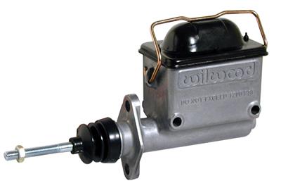

    masters, originally I was going to run two 46 ford masters. This set up has enough room side to side to do that. You just need to shrink one hole and drill two new little ones.
    however mocking it up the length of that master came into where the carb/ filter wants to live. So I began hunting around for the smallest master I could find with correct size bores that would look ok.
    I found these wilwood units that are available in a few different bore sizes, I think afco makes a similar one as well.
    I think I will remove the logo from the bodies and either paint them or take a needle scaler to them to hide where I removed the logo. FAF32310-41D1-479D-AEEB-68F60E4C5F06.jpeg

    I’ve seen about an equal amount of people heating and bending the bar and opening the slots in the buckets. I think if all the different lights were about the same amount of did lean towards bending one headlight bar compared to altering 6 buckets.
    ive seen a few people make shims from round tubing. Basically cutting the tube in half length wise and then pie shaping it. You end up with an orange slice/ wedge shape if that helps you picture it.
    don’t think I’d bother with that. I’d ***ume it would be visible and in the amount of time it would take you could just bend the bar.
    Stogy, loudbang and -Brent- like this.

    Have you checked the math to see if that short stroke Wilwood master has enough volume for your brakes and some reserve to accommodate shoe wear?
    Stogy, loudbang and Thor1 like this.

    Not yet but I’ll look it up and compare to a stock one when I get the chance. Good idea.
    I’ve seen them run on several cars running 46-8 and f-1 brakes so I’m ***uming for the moment that they should work

    Ok so looks like if you are looking at volume in terms of bore/stroke they are a negligible amount different than a stock 46 master compared what lose info I’m finding. If anyone happens to have a solid measurement for stroke on a 46 master let me know.
    but for now looks like the wilwood is a teeny bit smaller bore with a teeny bit longer stroke. I think it probably balances out just fine. I saw Rex rods put the same masters on a 32 with the new Lincoln brakes not that long ago. Seems a comparable set up?

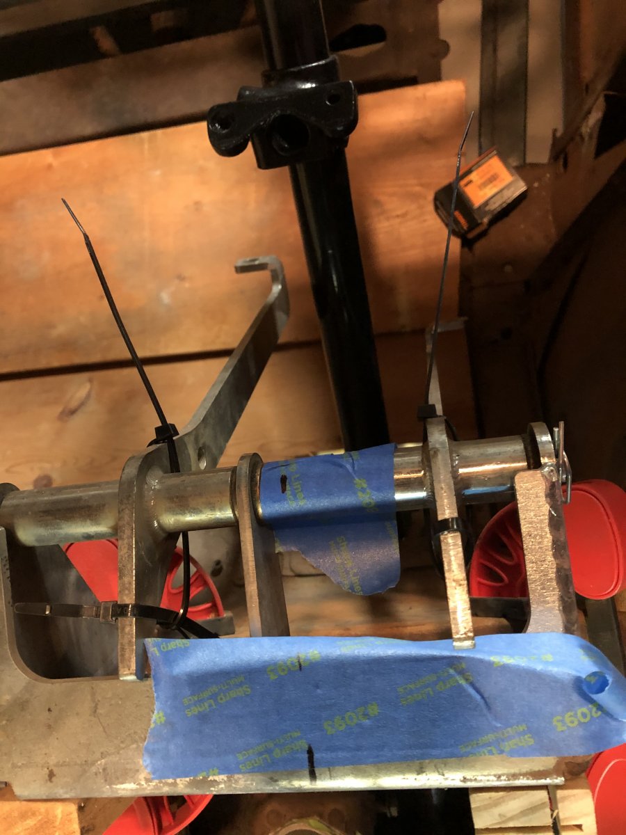

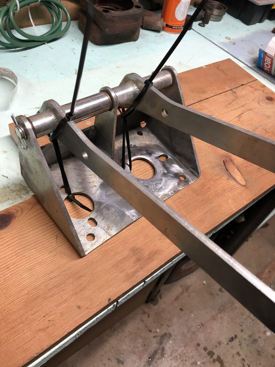

    No confirmation on stock ford stroke but I know the push rod moved about 3/4 inch from off to “all the way down” in my friends 47 ford. The website lists the stroke of the wilwood unit at around 1.4 inches. Sounds like plenty?

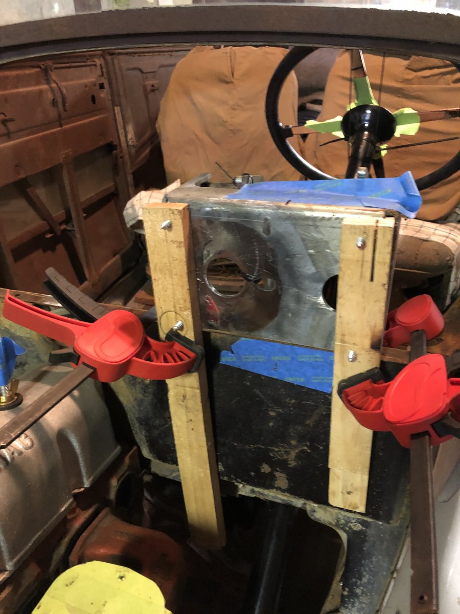

    9EDC2D10-CA75-4EA1-BDC0-18C6652C7285.jpeg 8685D06B-21C8-4CA0-9375-0A7334114463.jpeg E76F6E32-00EE-4036-A9FB-1A6C6E24B8F9.jpeg

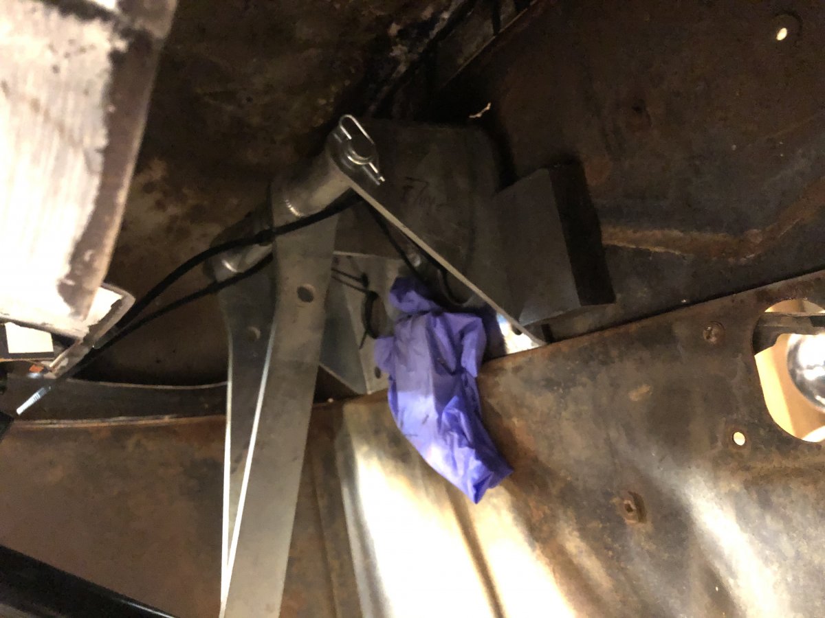

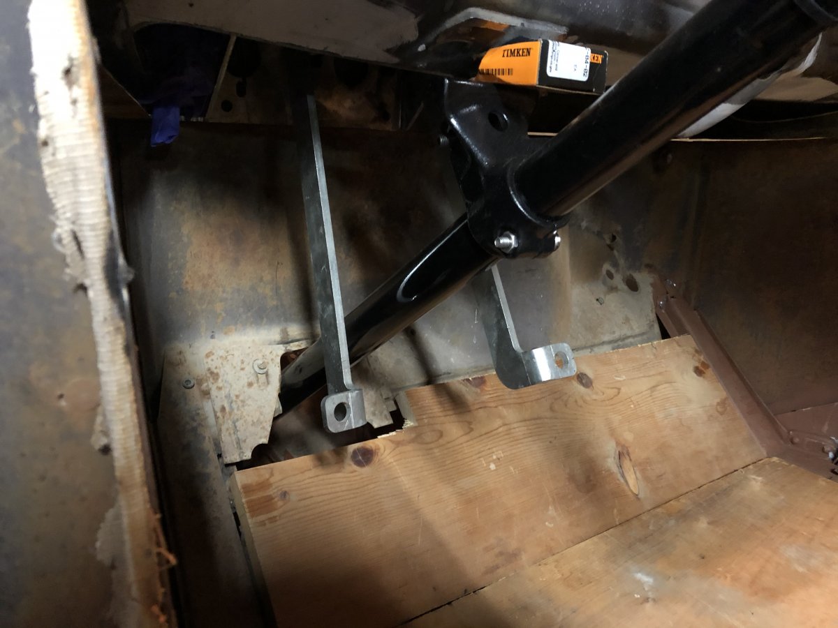

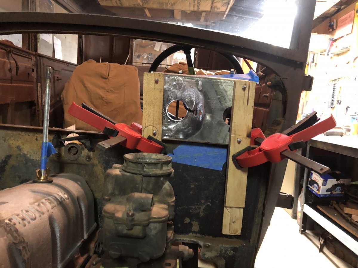

    either way, I moved forward this morning with mocking the pedals up. After figuring that they would mount above the firewall seam I started thinking of ways to hold them in place with the cowl off to measure/ adjust.
    My first step was marking the center of the column and transferring that line to the lower firewall. Used a level to get it as accurate as I’m gonna get it with the car together.
    then I grabbed some 1.5x3/4 wood and drilled two holes in each and used some lag screws to attach them to the pedal bracket using the holes in the corners.
    sat it on the flange and was able to clamp the wood to the firewall super easy. The pedals are about a half inch further back than they will be because of it sitting on the flange not on the plane of the firewall but I’m more or less trying to figure out side to side at this point.
    to that point I marked the middle between both pedals on the pivot shaft, roughly 2 1/8 inches and then measuring marked that line to the bracket. The pedals are off set in the “box” so the center of the box that bolts to the firewall is not the center between the pedals.
    I lined that up with the line on the firewall roughly and then started to measure and see if the column fell between the pedals dead center or not.
    with it centered it looked like the clutch would be a little close to the cowl side with my fat feet so I nudged it over a 1/4 or so. Gonna give it a test sitting in the car to see if I need it over some or if centered is the way to go.
    I’m keeping in mine the further to the right my clutch, the further to the right my throttle will have to be. I’ve got an extra 46 linkage I plan on manipulating into the correct form for the car so I’m thinking I’ll mock that up as well before I make anything permanent. Trying not to take to many backwards steps going down the road

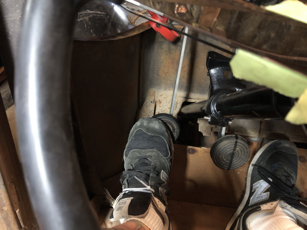

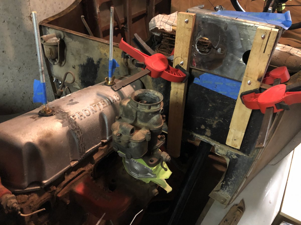

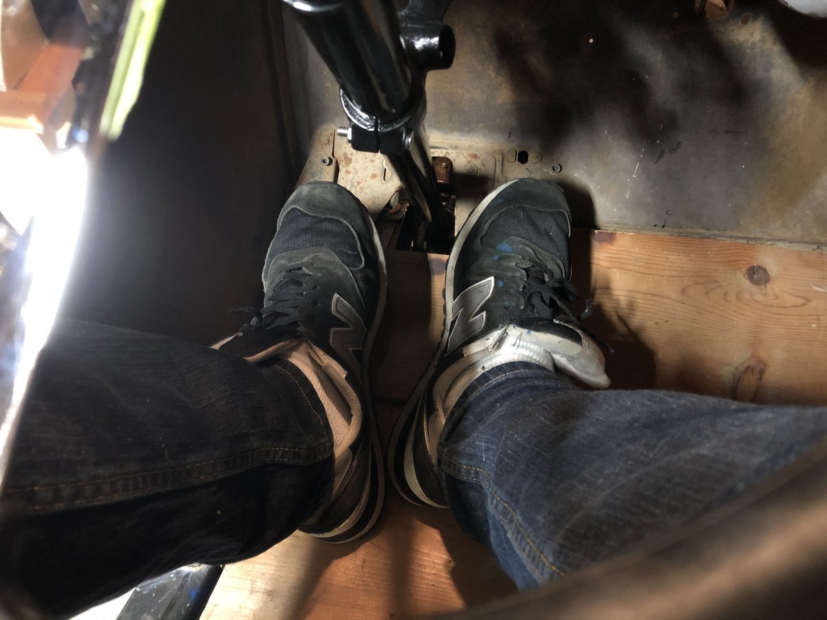

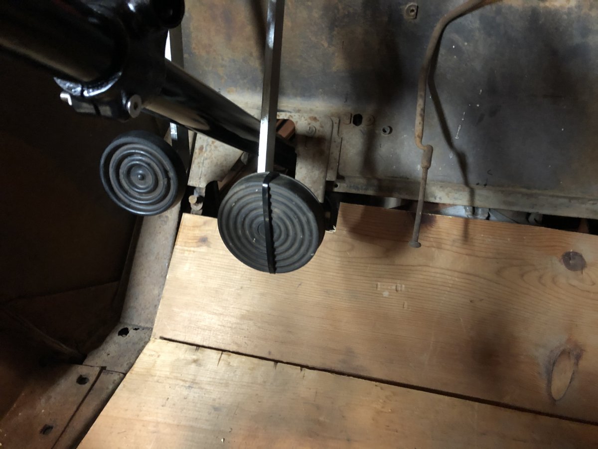

    Sat in the car and tried things out 58F8DD7F-517A-4859-95B7-C289BE9D5C63.jpeg used a 46 throttle for mock up pedal position. It’s a shame this isn’t a cross flow head it lands exactly in the right spot... on the other side of the engine lol 2C024593-7EA5-4E6E-95C4-3232BB8F77A2.jpeg hard to see but the throttle is right in the middle of my foot in that photo FCDF570C-73A3-4DD9-BC26-F01A58325887.jpeg rough lay out. The brake pedal pad is just a cover so I zip tied it onto the arm 045D8C43-1327-4D14-BC0A-67A02484D442.jpeg and this all feels good to me. My next step will be to use cardboard to mock up a kick panel because right now I could move the pedals over to the left a smidge but I think I’m in danger of h I guess my foot inside the panel at that point.
    My plan right now is to have my foot clear the placement and then put a blister/ pocket like moal makes into the panel should it seem like I’m going to run the upholstery off he panel with my foot regardless of all this bench racing

  17. justabeater37
    Joined: Jan 1, 2009
    Posts: 1,855
    justabeater37
    Intake is still on the same side on a crossflow.
    loudbang, OFT and Stogy like this.
  18. Six Ball
    Joined: Oct 8, 2007
    Posts: 7,245
    Six Ball
    from Nevada
    You could run a throttle shaft through your valve cover to get to the other side. With some of those Ford spring and ball linkage ends It would come off in a jiffy. :confused: Really you may be able with some clever work to reverse the direction and get it on the right (left) side.

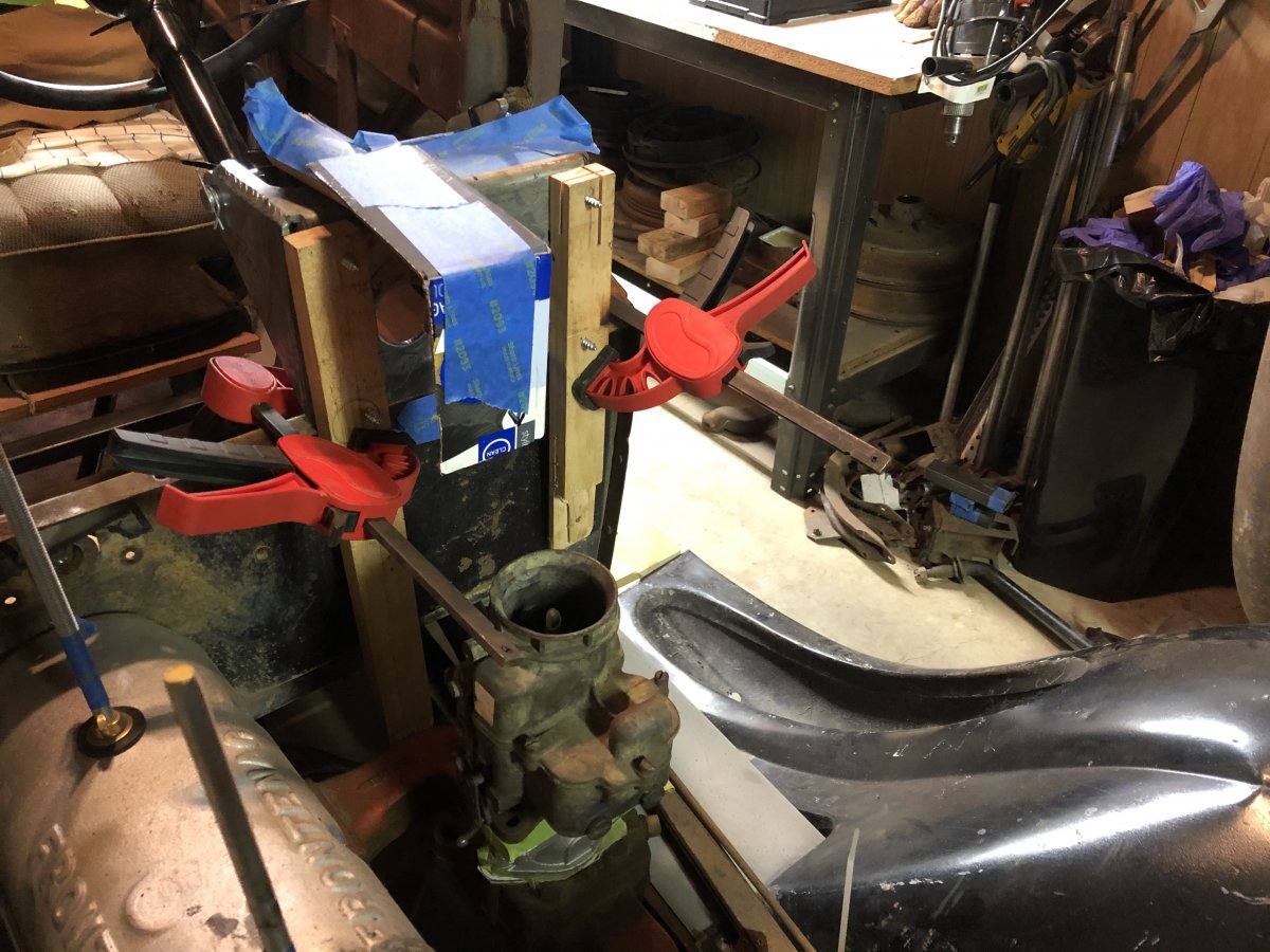

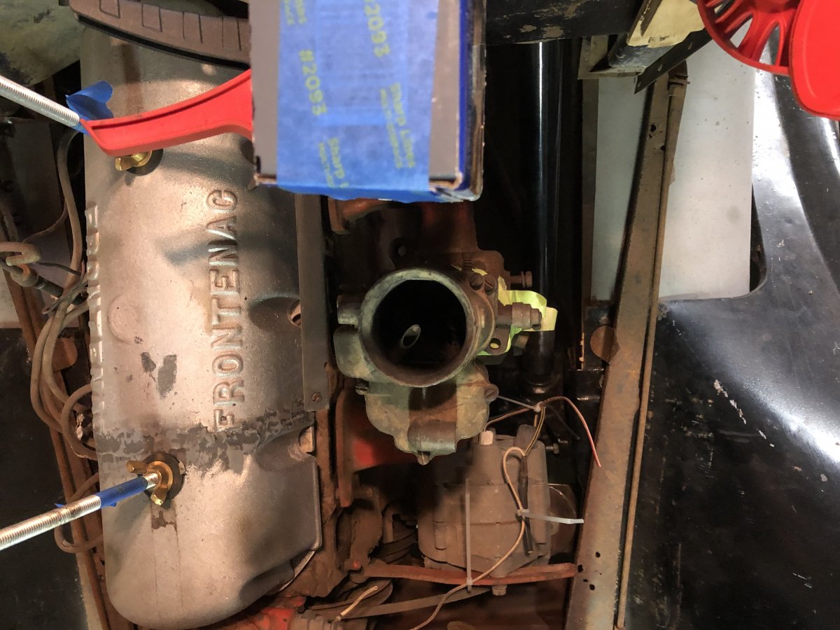

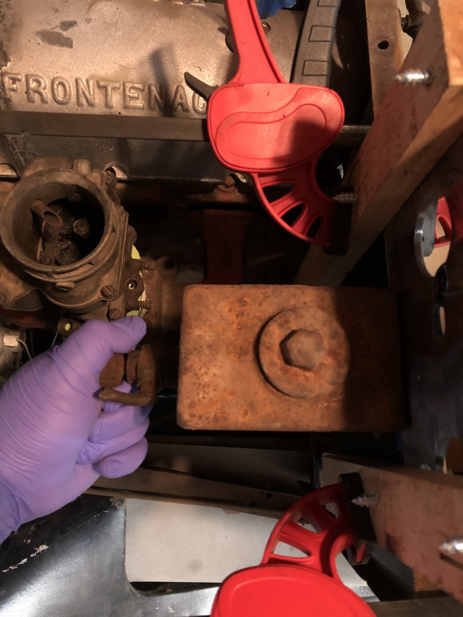

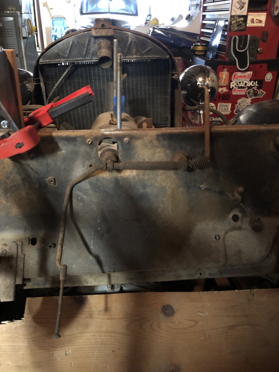

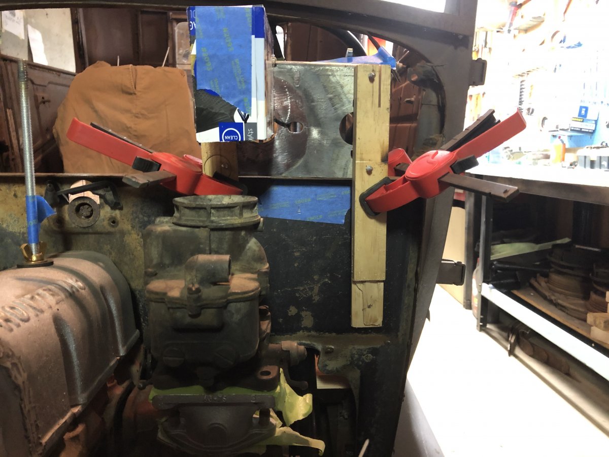

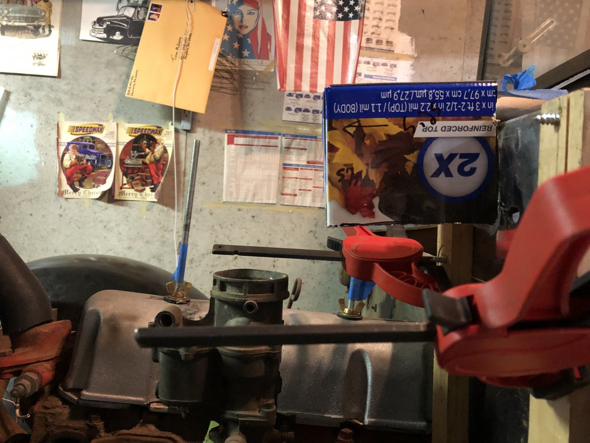

    Also some quick mock up photos to show why I started hunting for the shorter master cylinders over just using the ford stuff F6FE735C-D083-4BA6-BC7B-48BE7C66192B.jpeg the line where my hand is ^ where the fitting attach is 1: basicaly even with the carb body rearward edge. And 2: where the end of its length would actually be if it were mounted in the firewall correctly. In this photo it’s on the face of the pedal box B415C3E3-8F21-498E-89CC-74ECAD8B8D46.jpeg here you can see side to side how the master and any air cleaner would come into conflict fairly quick 71C5CA18-54E5-4FF8-8780-897D41D29196.jpeg just another photo to get the lay of the land so to speak. in correct position the bottom of the master is about 2 inches vertically from the top of the carb. I think you could maybe run a little helmet air cleaner but it’s to close for comfort and figured it would look really cluttered. So I decided to go with the shorter wilwood. I’ll get a measurement to compare lengths here later.
    Will probably make a cardboard box that is the same size as the master and tape it to the firewall for another look
  20. Tim
    Joined: Mar 2, 2001
    Posts: 21,581
    Tim
    from KCMO
    Well ****
    on my 46 it got cut and flipped around to line up with the linkage on the sbc linkage. Im sure this won’t cause me to many head aches. I’ve got some ideas

    Made my cardboard will wood master based on installed length, over all height and width measurements that were easy to find.
    the height is a guess because the pushrod enters the ***embly pretty low. C5135A0E-F8FD-4324-B697-CE73EFB59F54.jpeg A8493159-BCC3-47D8-AFAE-AA5308EA7A7B.jpeg 1B6964A5-4AB8-40EC-A1B6-FF8D946F61DB.jpeg CFE47108-7D80-417A-B925-FF3CA50AFD51.jpeg
    compared to the 46 ford master this unit with the fitting installed should be nearly 1.5-2 inches shorter than the ford with no fittings
    I’m thinking because the masters are spread apart a little wide that I’m going to use a banjo fitting on the master cylinders and have the hard lines dive back and meet each other in between the two before running down the firewall together.
    oh, and once I get the pedal box 1000% set before I make it permanent I’ll mock up the hood to make sure the clutch master won’t hit it. I mocked it up previously with a ford and it cleared but I’ve tried so many differently locations that I have no idea how it relates to the current location.
    Easy enough to try and find out

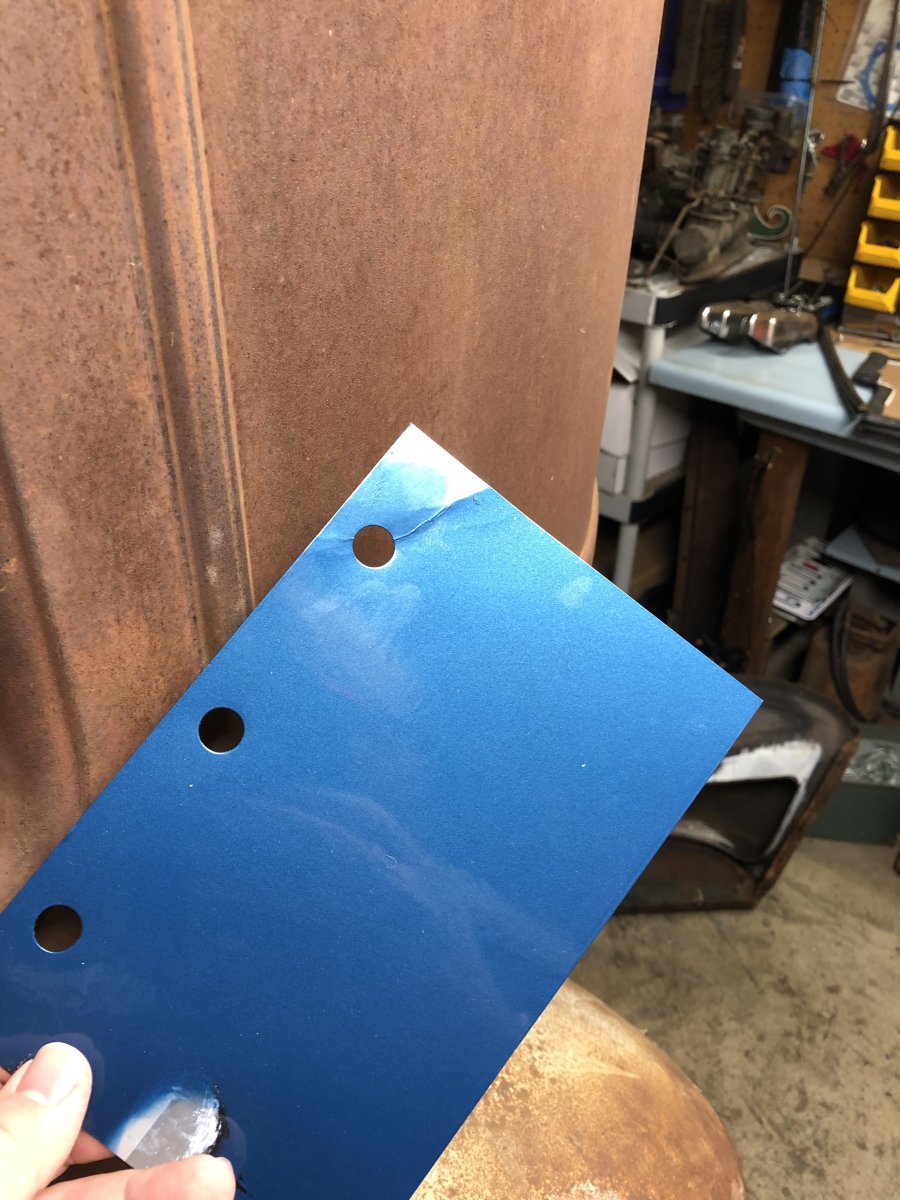

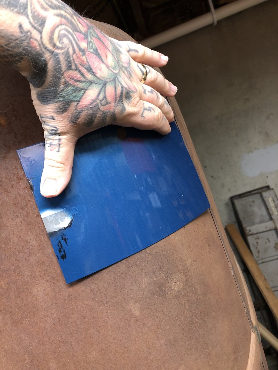

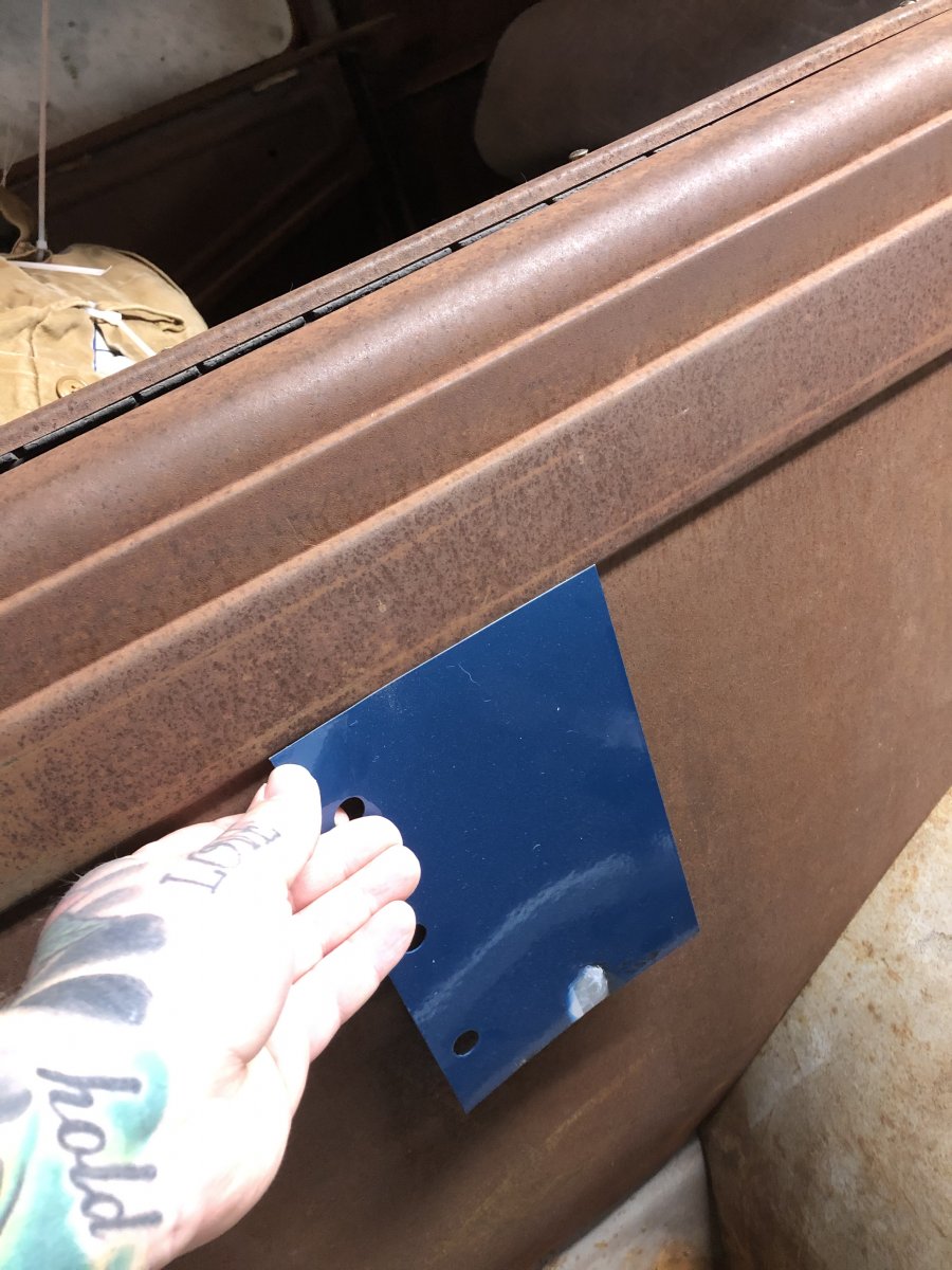

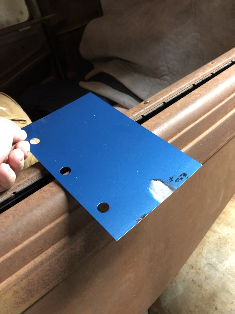

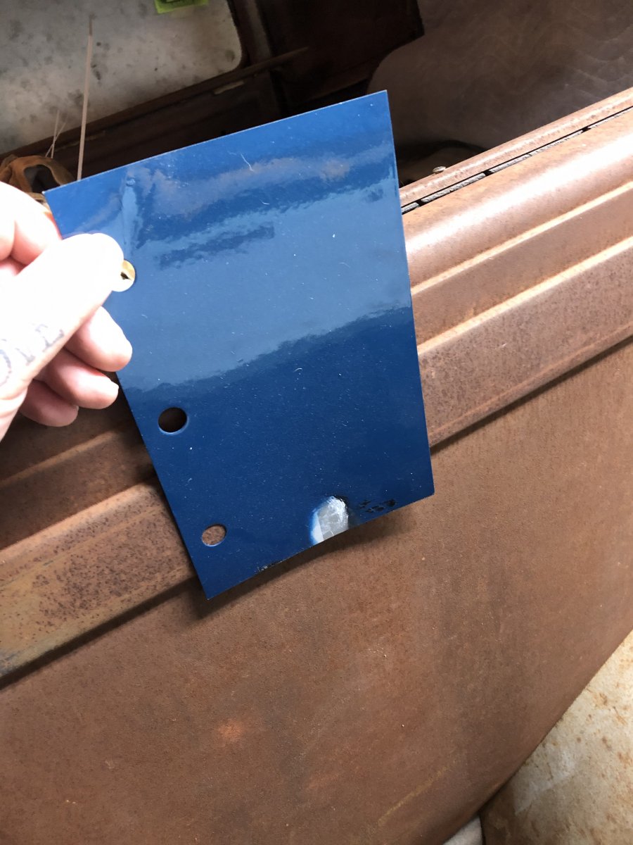

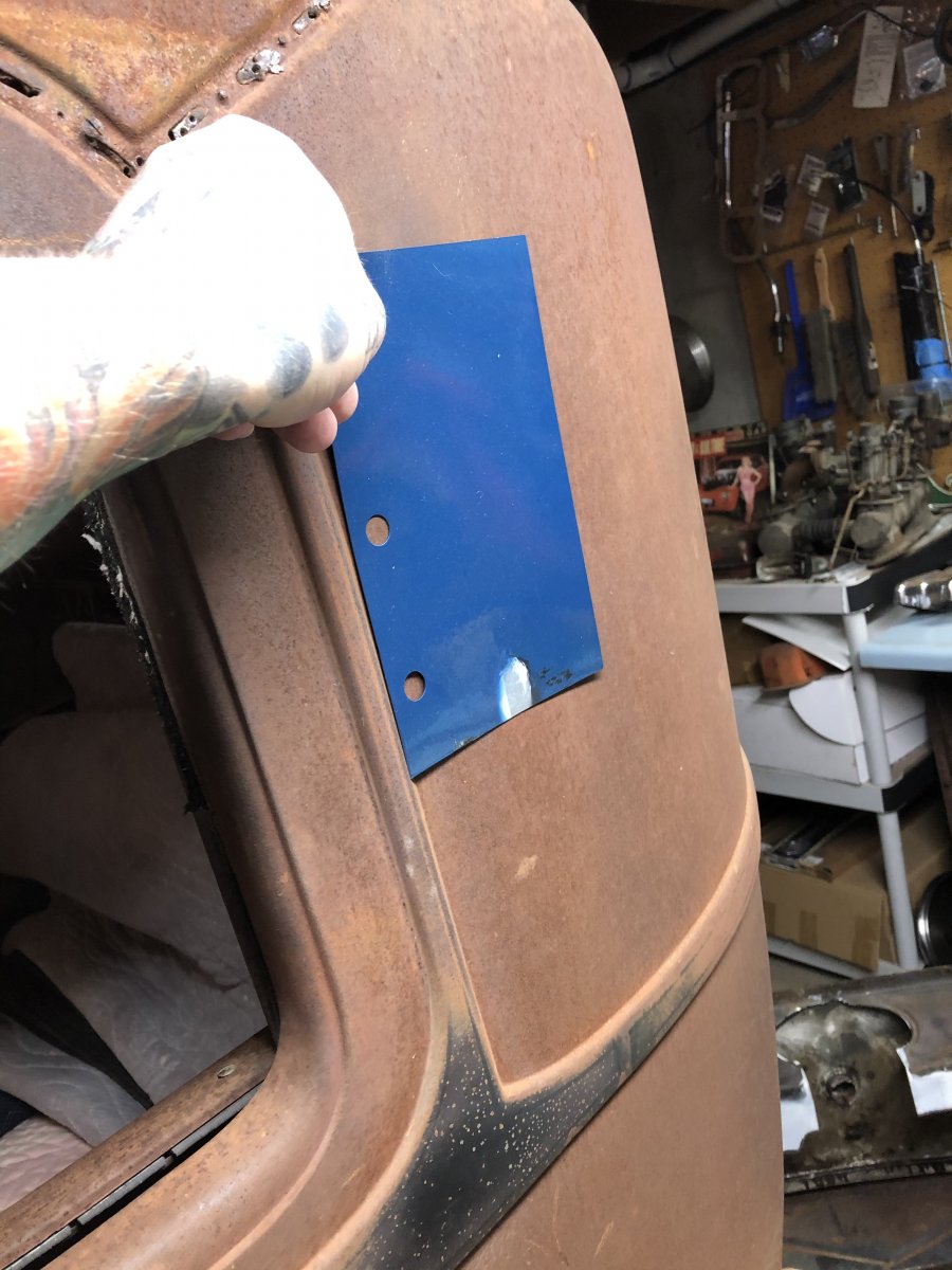

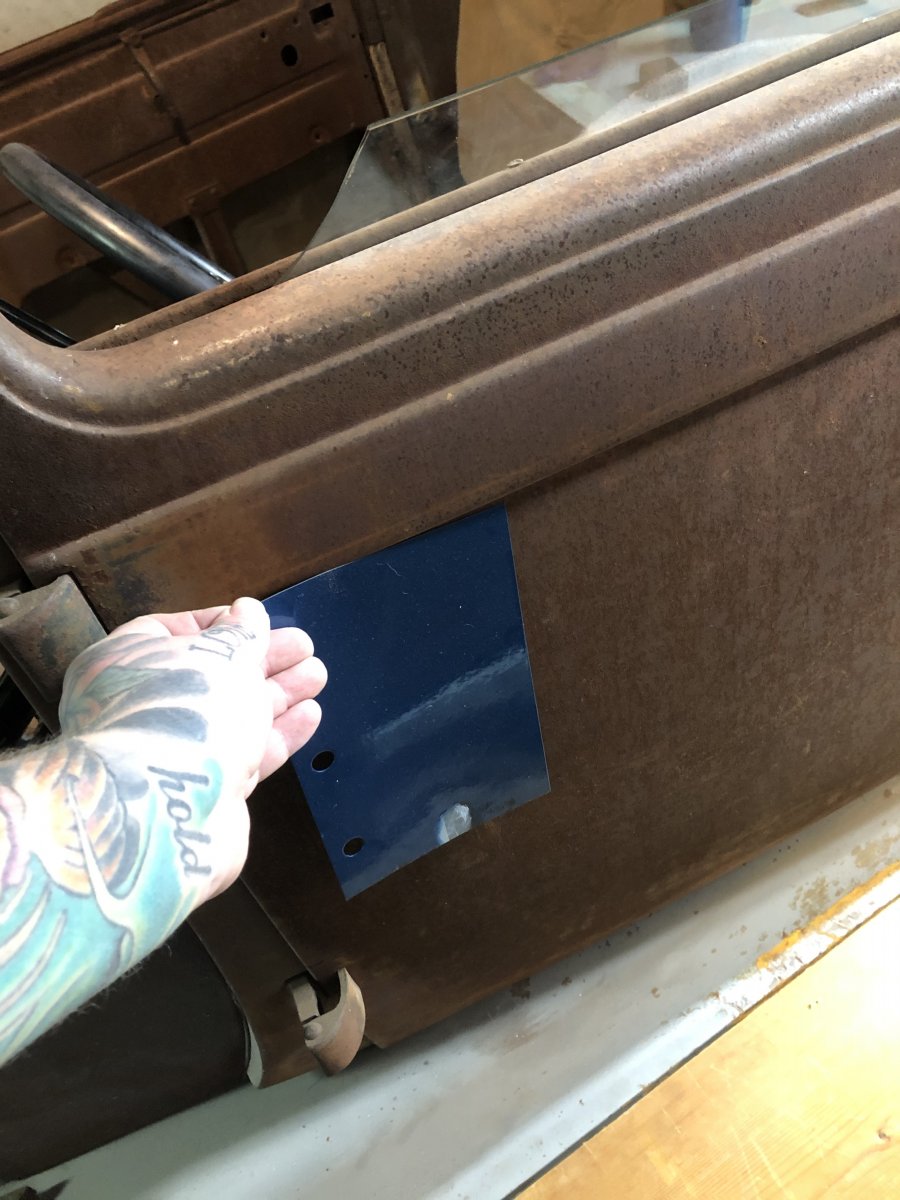

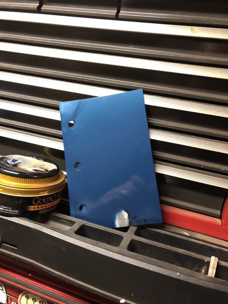

    Walking around the car under led lights holding the paint sprayout up to the car.
    you can’t really see any color change with this lighting but you can see the light/dark tones a little.
    in natural light it looks more green/aqua marine when laid flat and more Washington blue when it’s vertical.
    I think I dig it. D55C3AC1-0AC0-4507-91EB-0750EB407F3C.jpeg 8016DC13-9554-4702-8DF0-DC3C3CC79D5B.jpeg EB093B73-6579-4A1E-BD9B-76A5BC67DF33.jpeg F1A3E212-4AC0-4D47-B768-46FAF8262D42.jpeg 7E86F300-6B2E-432D-AFB2-18AE4338A2C4.jpeg F7AA5561-55F3-44DE-BCD7-96A67BA85904.jpeg BD083F90-530A-4B7E-ACE1-994FD65A0663.jpeg D0D2BD79-A669-44B3-AB7D-758744556626.jpeg 864F35DD-4C41-4B33-881B-FBA3492B9164.jpeg
