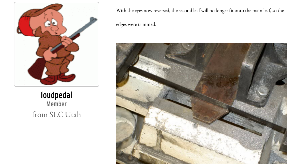

    image.png Well I found this the other day so I think tomorrow I'll use it as a guide and nip off an inch off the ends of the second leaves and get them rounded.
    He posted a photo of the front pack together and seems it gives plenty of space for the reversed eyes. Guess we'll find out!

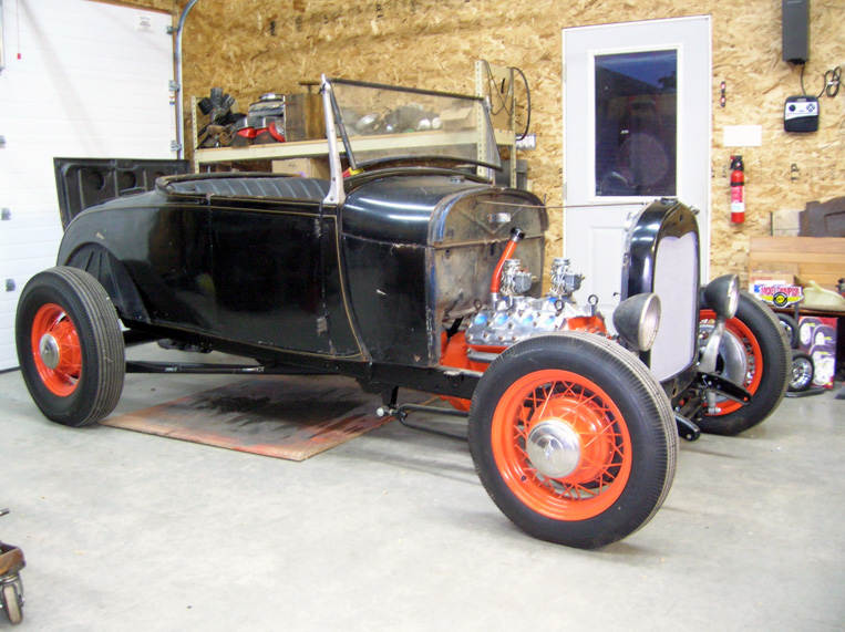

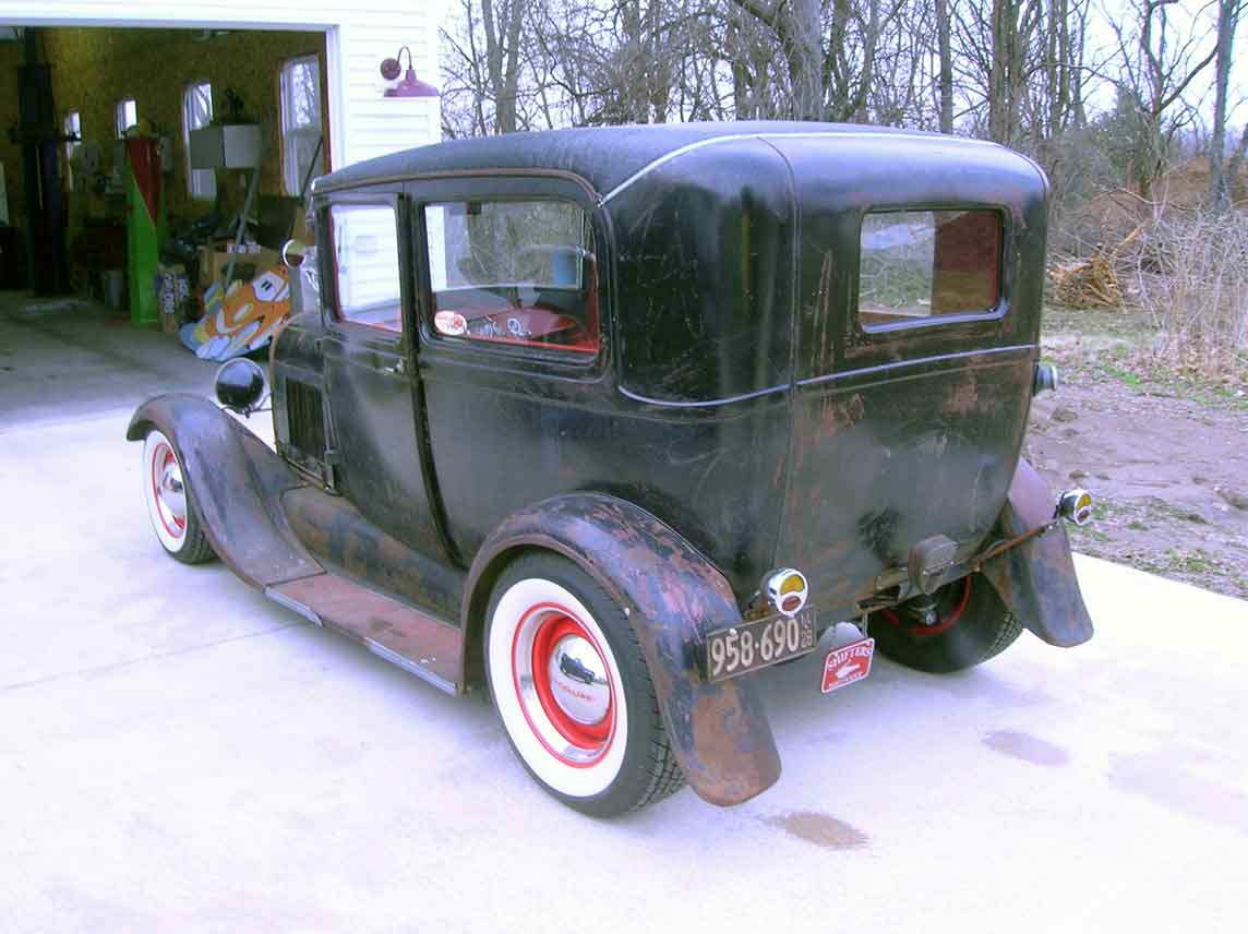

    Glad to see this car coming together. Stance is everything...heck, you don't even need to paint it picket fence shot.JPG if the stance is on. Here is a little inspiration. Im subscribed.
  13. Tim
    Joined: Mar 2, 2001
    Posts: 21,571
    Tim
    from KCMO
    Love it Ron! I think yours sits great and I agree the stance is everything.
    I used your thread as a guide for initial set up but I'm sure it'll take some fine tuning to get it just right as springs varie.

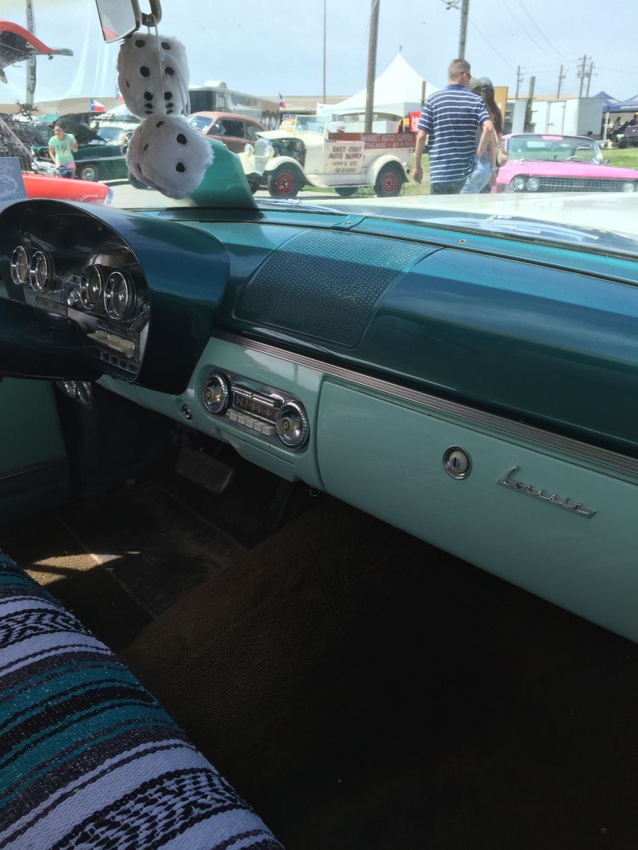

    We were keeping an eye out for era correct greens for the car and these came closest I think image.jpeg
    They look more blue in this photo but they are more green in real life.

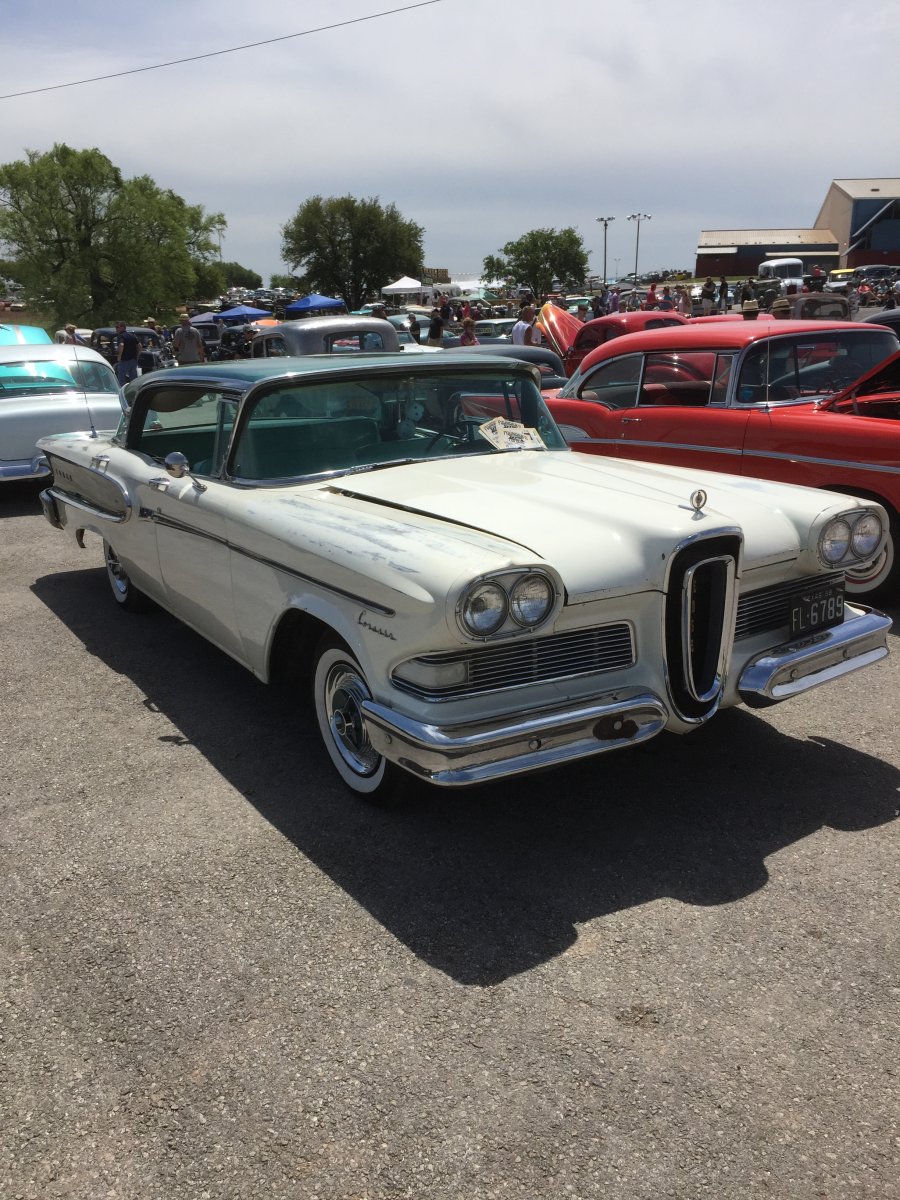

    image.jpeg Took a photo of the Edsel the dash was in hopping it could lead us to a factory color sample later on. The green outside of the car was an obvious repaint but the dash looked original. One of our neighbors down the street has a 56 Mercury that is a similar set of greens.
    Anyone have a name for them?

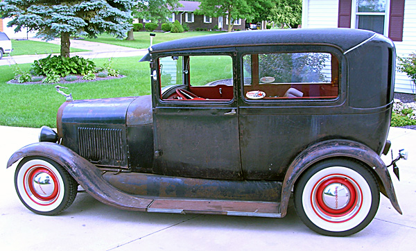

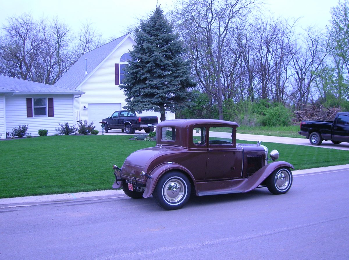

    here are a few Model A's I done in the past...

    Love em! That that third photo, the 3/4 rear shot is one of my favorite angles of these cars when done right.
    How did you set them up suspension/drivetrain wise?

    The Tudor & Coupe were Pete & Jakes complete ch***is... I can't say enough good things about them, It's the only way to build one. The Tudor had a ladder bar rear, and the Coupe had a 4-bar rear... the 4-bar was much more accommodating to exhaust, and rode a little nicer. Both cars were SBC, automatics. On the Roadster I used an original frame, boxed it, Superbell front end and a Posie Superslide rear spring. I also z'd the rear frame. I had hopped up V8-60hp, and a Model A Quickchange rear axle, 40 ford brakes... it was pretty traditional. If you plan on diving it.. the Pete & Jake ch***is is the ticket... it sits better, and is WAY easier. It just works, they have their **** together... I know you think you spending a bunch more for a complete ch***is, but by the time I bought a complete front axle, rear spring, rear axle, shocks, mater cylinder, etc... and then figure labor, I didn't save as much as you would think. You can pick a ch***is up at their shop, and be days/weeks ahead... there is/was a guy there named Jason that worked there and he is more than happy to help you with any questions.... he is great to work with.

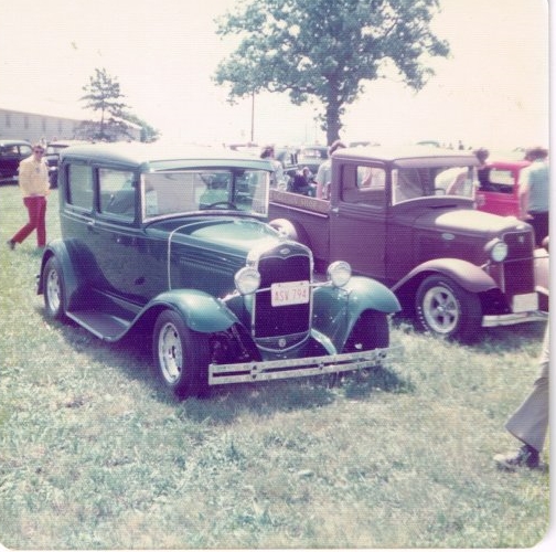

  23. To add more, some shots I have. I like this color combo and this plain style interior.

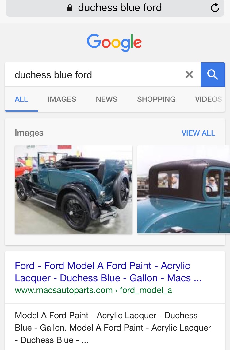

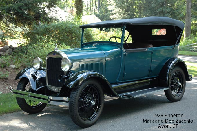

    Alright so Sarah was talking to someone who just happened to end up with a garage full of model A & T's and what should she find but the correct color!
    She asked and was told that it's a stock color so to google we go!
    Duchess blue is a stock 1928 color!
    Duchess blue body, black fenders, and the wheels and Pinstriping the yet to be decided lighter color.

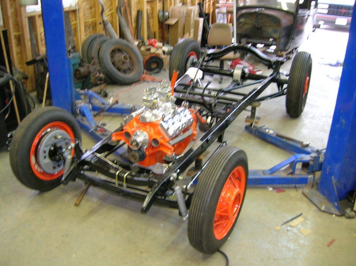

    Here's a '29 we did last year.

    I can dig it :)
