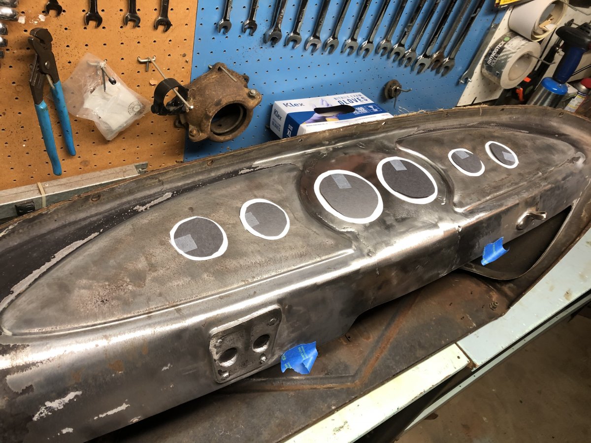

    Really only took three photos. Short on time today so even this will be shorter than my normal ramble.

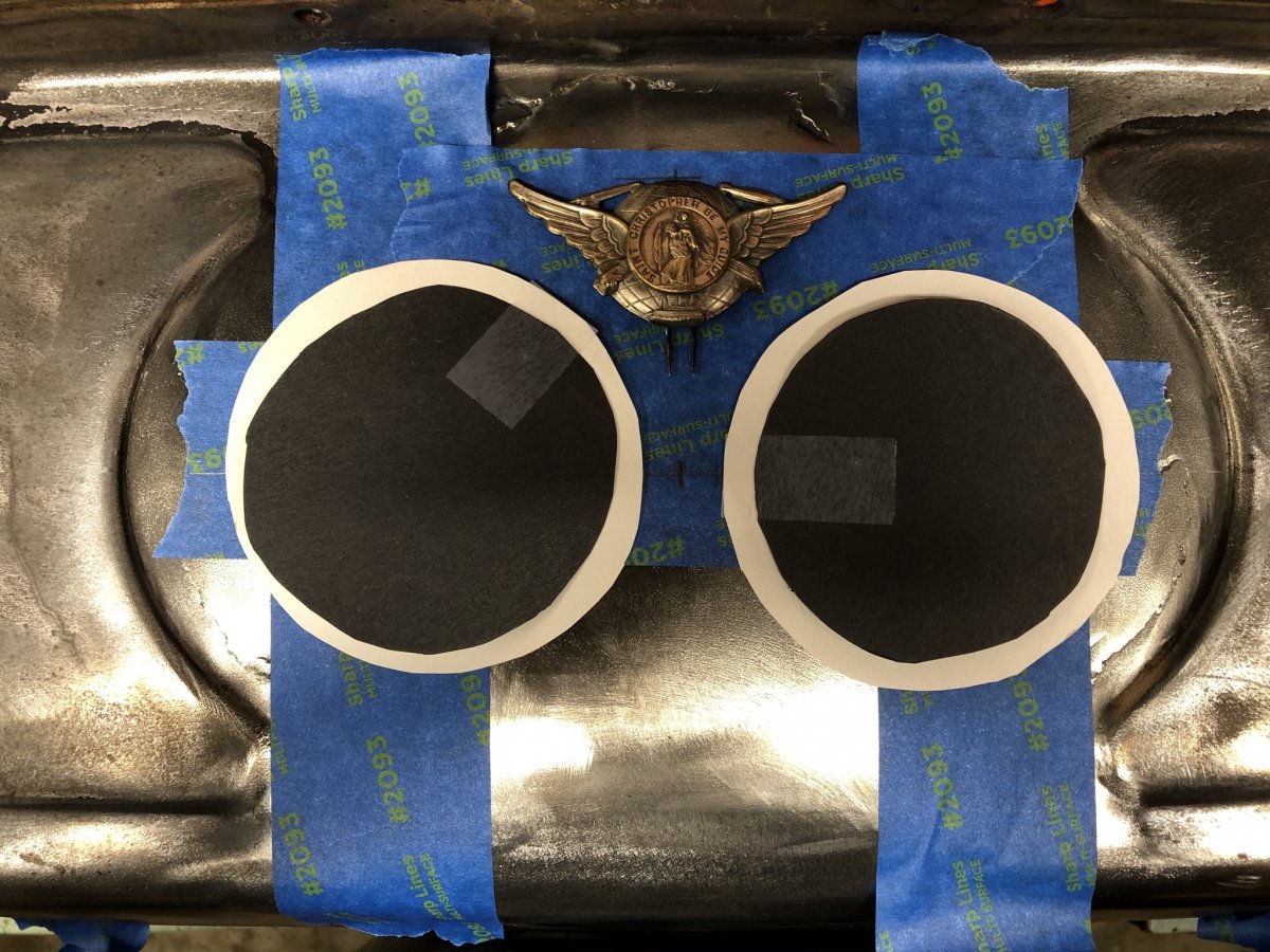

    Used mostly hammer and dolly and a some heat shrinking to get the center of the firewall close enough for mock ups.... I think. The fuel pump divot I used a cut off wheel and cut the sides and bottom and hammered it forward. I’ll deal with welding it and making it pretty later.
    tapped and marked center lines and mocked up gauge and medal placement.
    drilled two pilot holes and the. Two giant hole saw holes. First Pilot hole landed about 1/16- 1/8 off mark so I just made them both the same amount off from the mark.
    any how shoved it back into the car and tossed the dash bar on with a magnet before calling it quits.
    mill sit in the car and tape the 4 smaller ones on late tonight when everyone’s in bed. Might file the holes and slide the tach and speedo in while I’m there... 764D8FFC-83B0-4471-83FA-641526DE0C05.jpeg F6AEEEFC-A706-4403-970E-4E5290EDF9D1.jpeg 150BD62B-9B6A-4526-9C6F-5B060998F4A9.jpeg

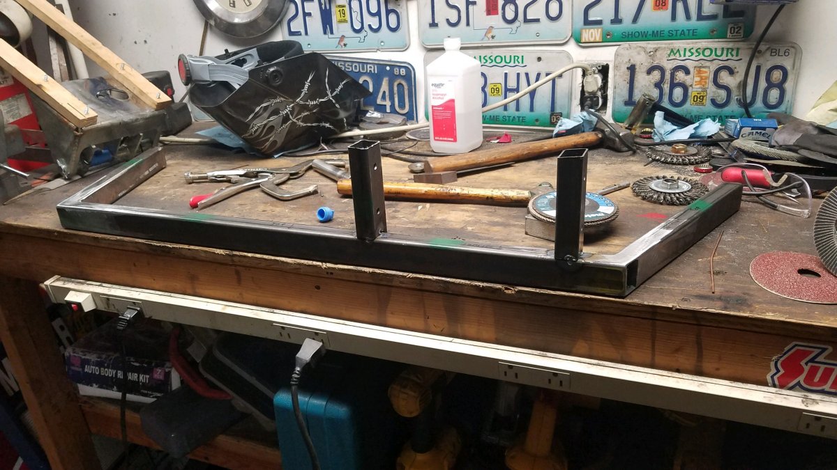

    Progress! 25408BB1-7E1B-42C6-89F2-6BA37FAD2F79.jpeg B9CAD0BB-9CC4-4725-B1F8-4D3F61F42336.jpeg All together, he used a small bit of cut off to fill the little gap at the end of the p***enger side of the cross rail.

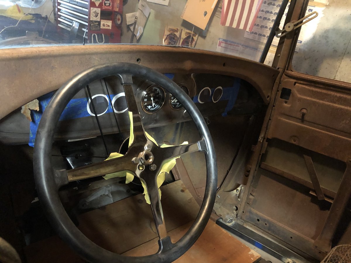

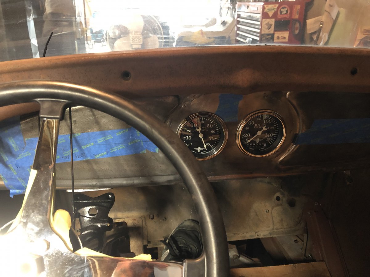

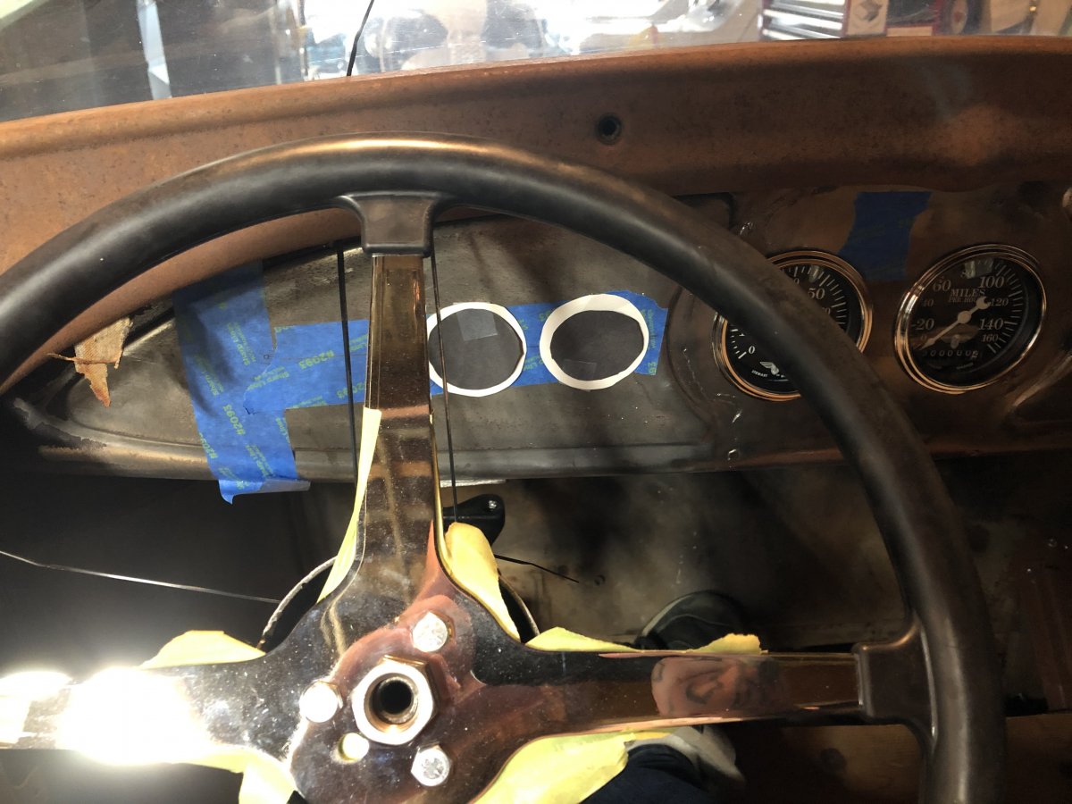

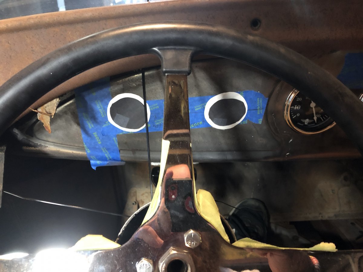

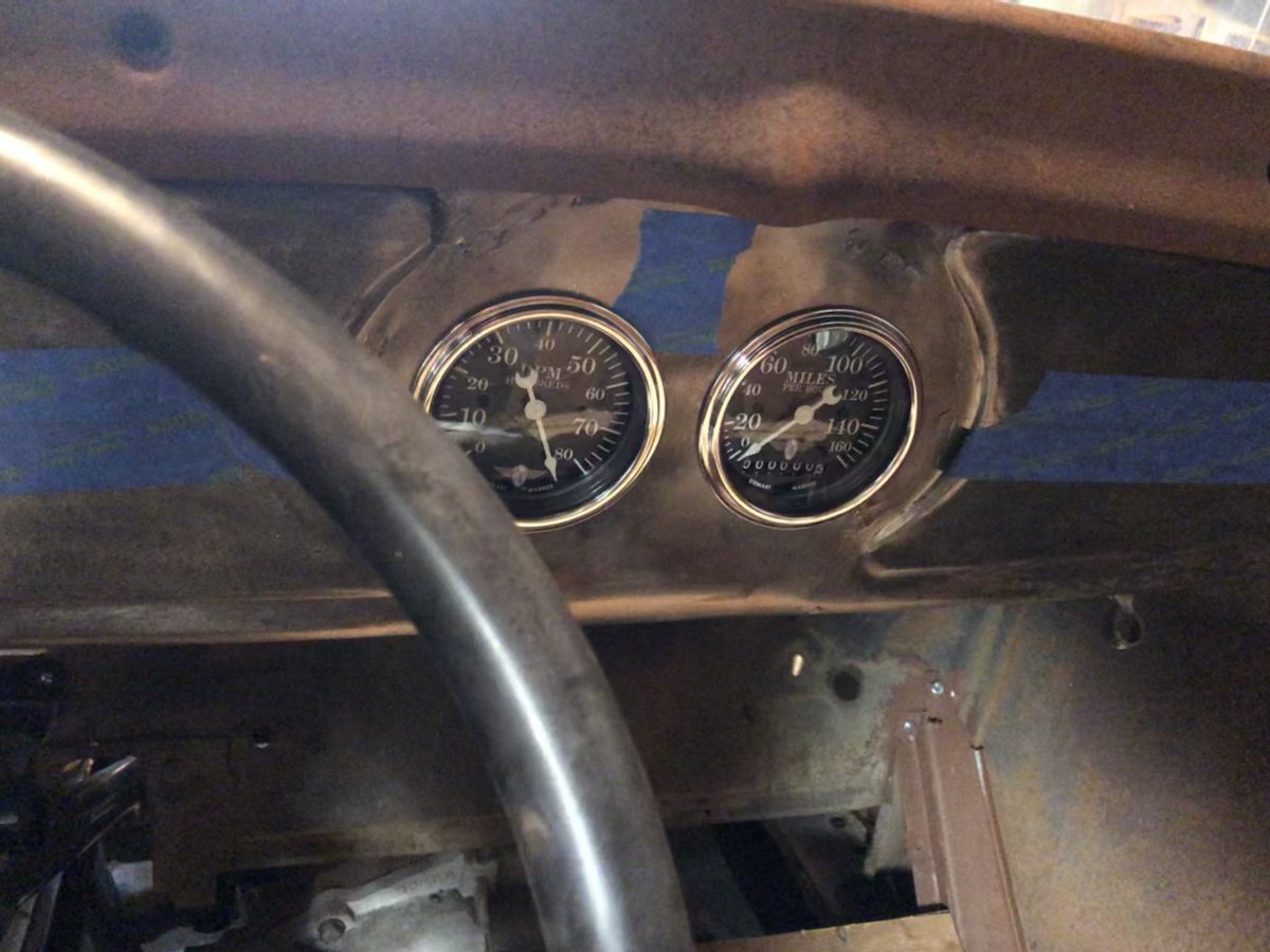

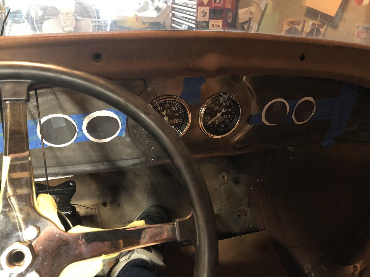

    Wrapped the body in tape and slid the tach and speedo into the dash 30563E9B-7A3F-4155-94B2-004A019E63D3.jpeg 5ACB794E-6D46-44DA-BED8-1A460D60FE27.jpeg buddy was giving me a hard time that I wouldn’t be able to read the tach but this is pretty much exactly how I see it from driving position 48989362-45EC-4E49-BF63-E64AB9C51009.jpeg 9D4E0189-D9F4-4264-BB43-610A5272BCFF.jpeg that thinking in mind I stuck the side gauges where I could see them in each quarter of the wheel. Split by the spoke I could see them just fine but hated how they look. 06003526-9A1D-4F91-BF9A-73124D8CCE30.jpeg 63434AF9-FEDA-4795-A72B-6BB2AD6A1495.jpeg E283B8C8-34E9-4BFD-A5A9-7900D35BEF5D.jpeg switched them to both being visible threw the wheel and I think it’ll probably make the p***enger side gauges easier to read as well.

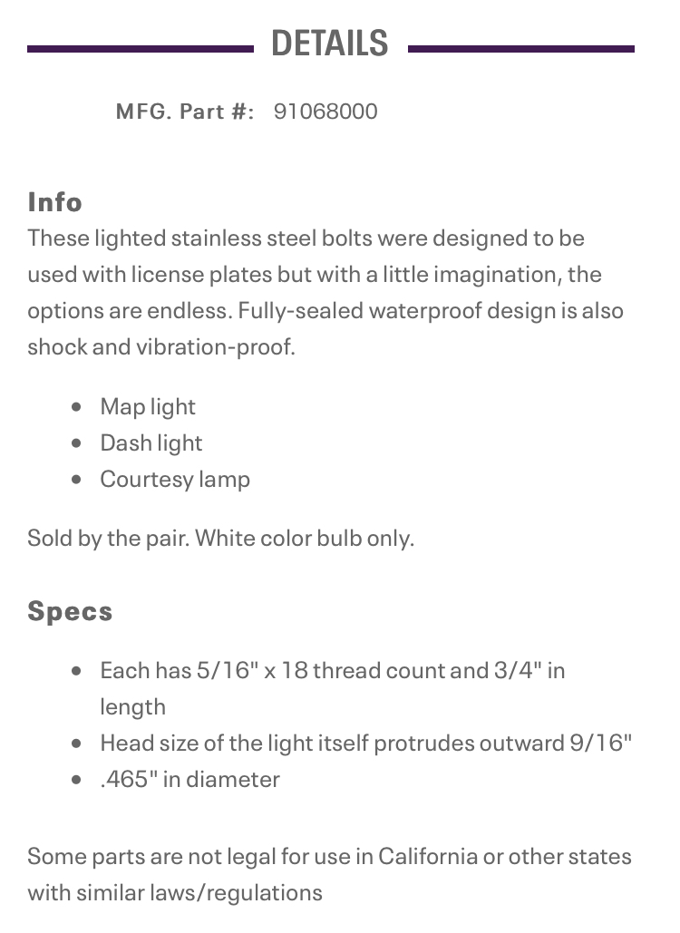

    Also, with the dash bar mocked up I have less room under there than I thought for hiding things. I want to put a little dash light over the st Christopher medal in the center of the dash hid behind the dash bar but it seems a normal built will be to tight.
    Anyone have a lead on a small dash light that’s maybe an LED but a warm tone?

    thinking these little license plate bolts/ lights might do the trick for lighting up the medal on the dash and maybe a bank of switches. Tuck them up under the dash rail and maybe tie it to the headlight switch?
