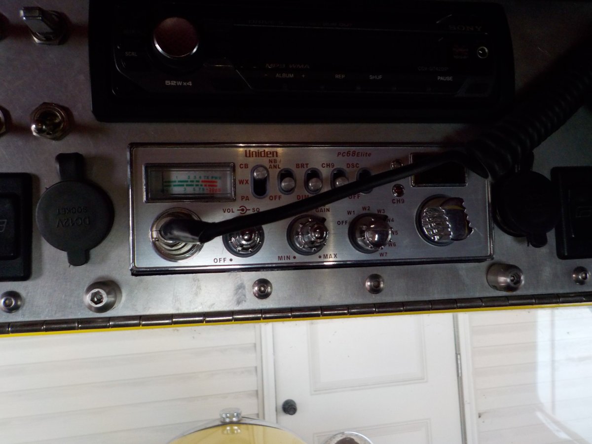

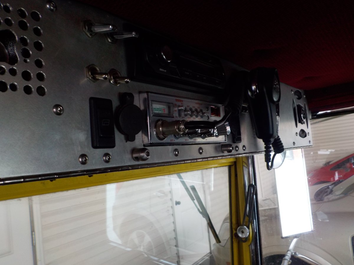

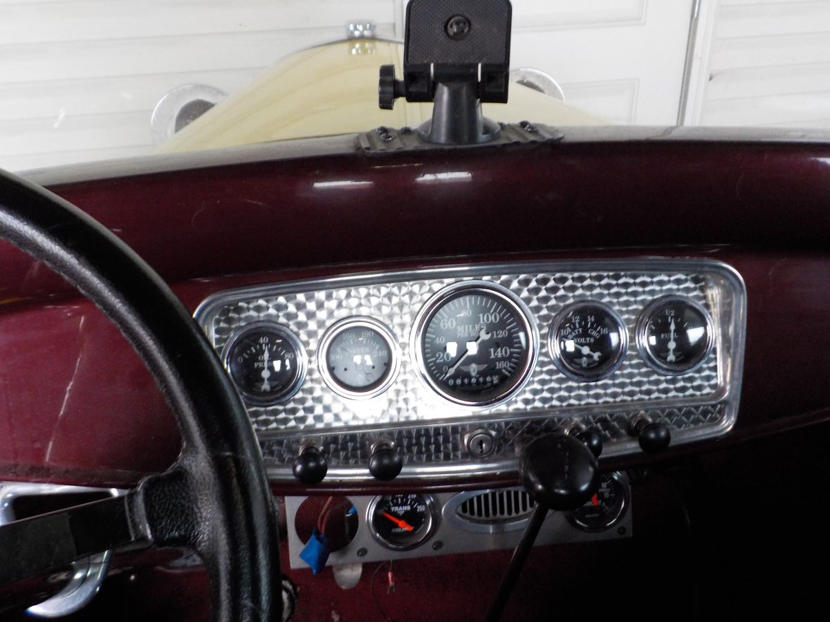

    Here ya go, I use them in the OFT more as interior light for putting key in. Use toggle switches in counsel. Ya know it's a old build with CB-lol DSCN6544.JPG DSCN6543.JPG DSCN6545.JPG
    Stogy, kidcampbell71, Tim and 3 others like this.
  2. Tim
    Posts: 20,782
    Didn’t see your post until today! Love the CB I guess there would be room enough there!
    looks like they are plenty bright based off the glare on your dash in the photo. Thank you for taking the pix @OFT

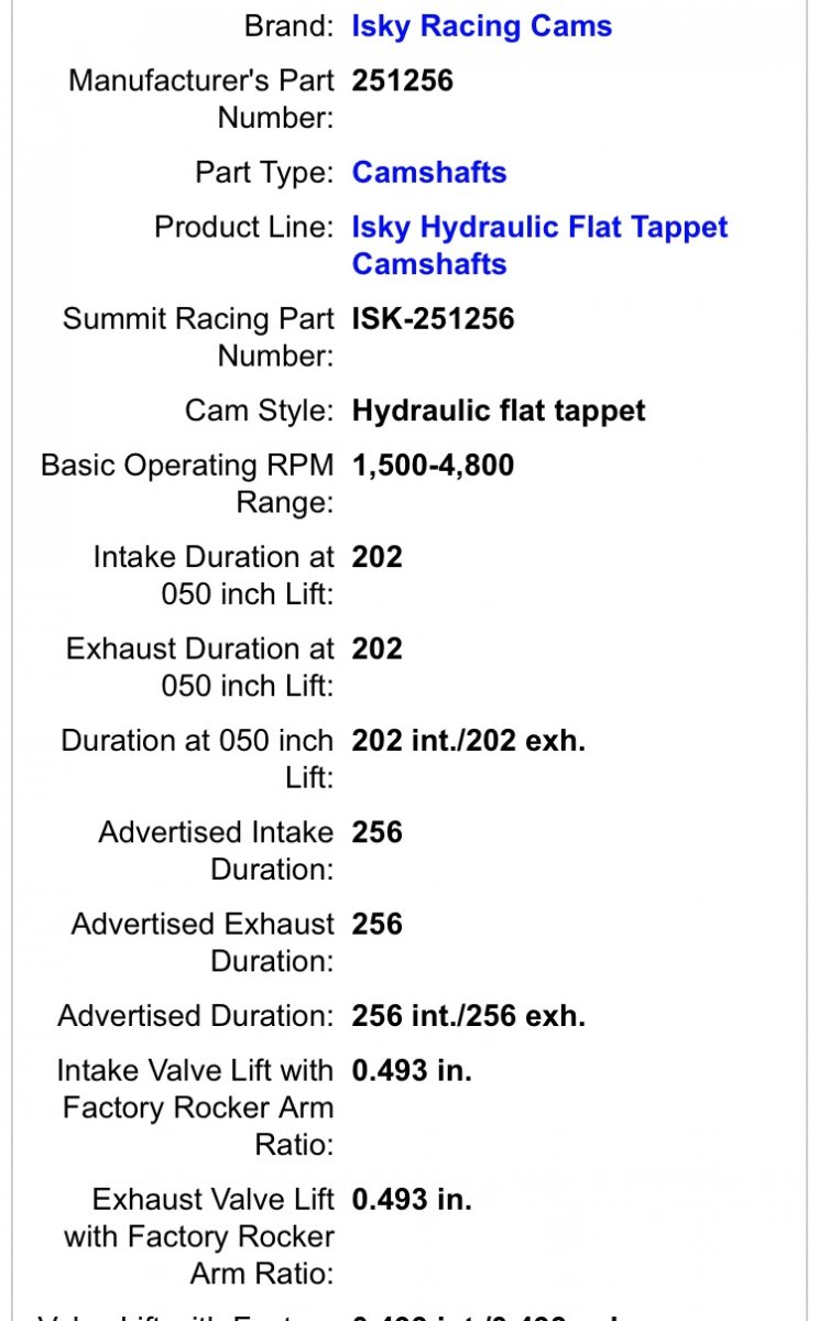

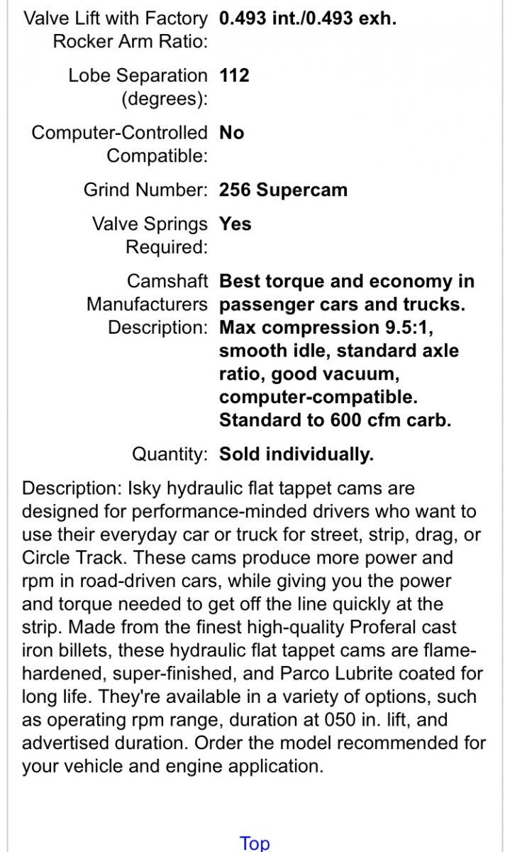

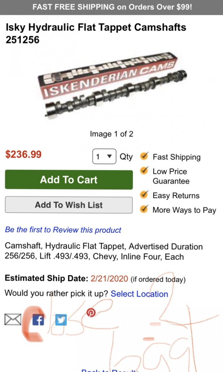

    Ok this is mainly engine notes to self.
    I’ve seen it mentioned that the boat cam for these engines is super close to an Isky grind. I eventually had to find a human who knew and they said the boat cam spec’d to 204 duration @ .50 lift and valve lift is 498.
    I looked for a comparable comp cams unit and didn’t really find anything though they offer a hand full of cams for the 153.
    anyhow here is the Isky cam B13F4AB3-07A9-49A7-A1FA-60EB8E74140A.jpeg 06439AA3-3292-48B8-A279-AFED946DF314.jpeg C744D23A-B58A-4D9A-AADC-3706E03954ED.jpeg

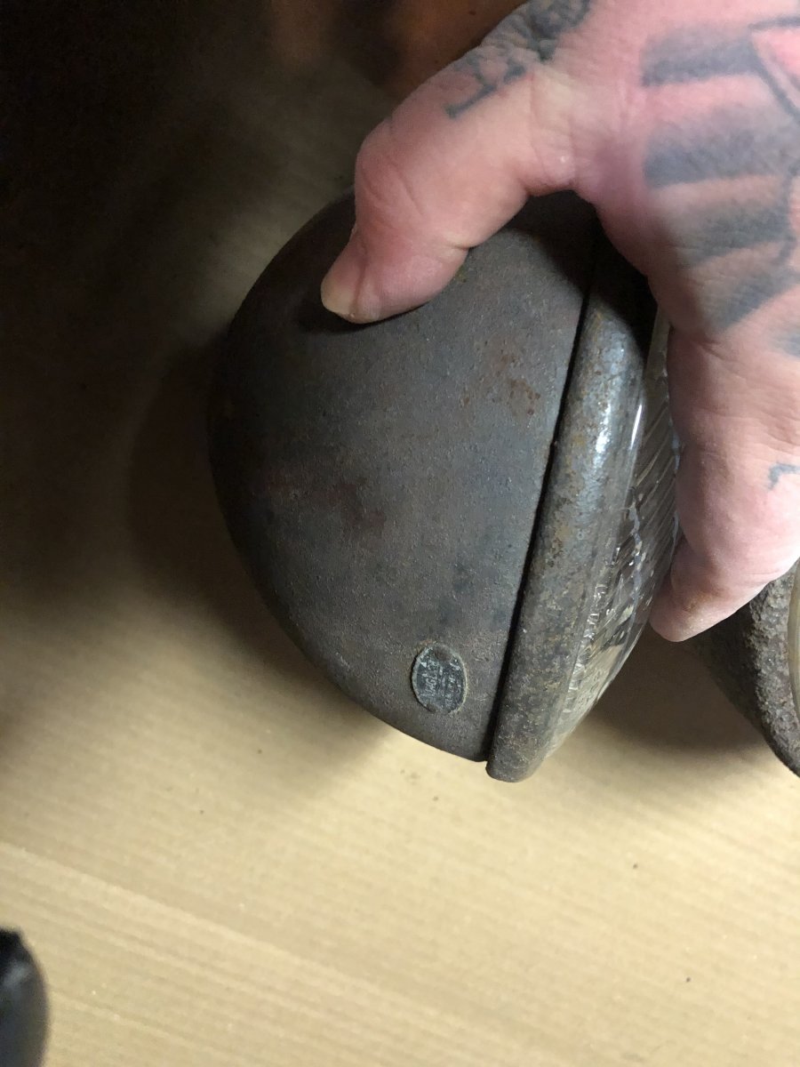

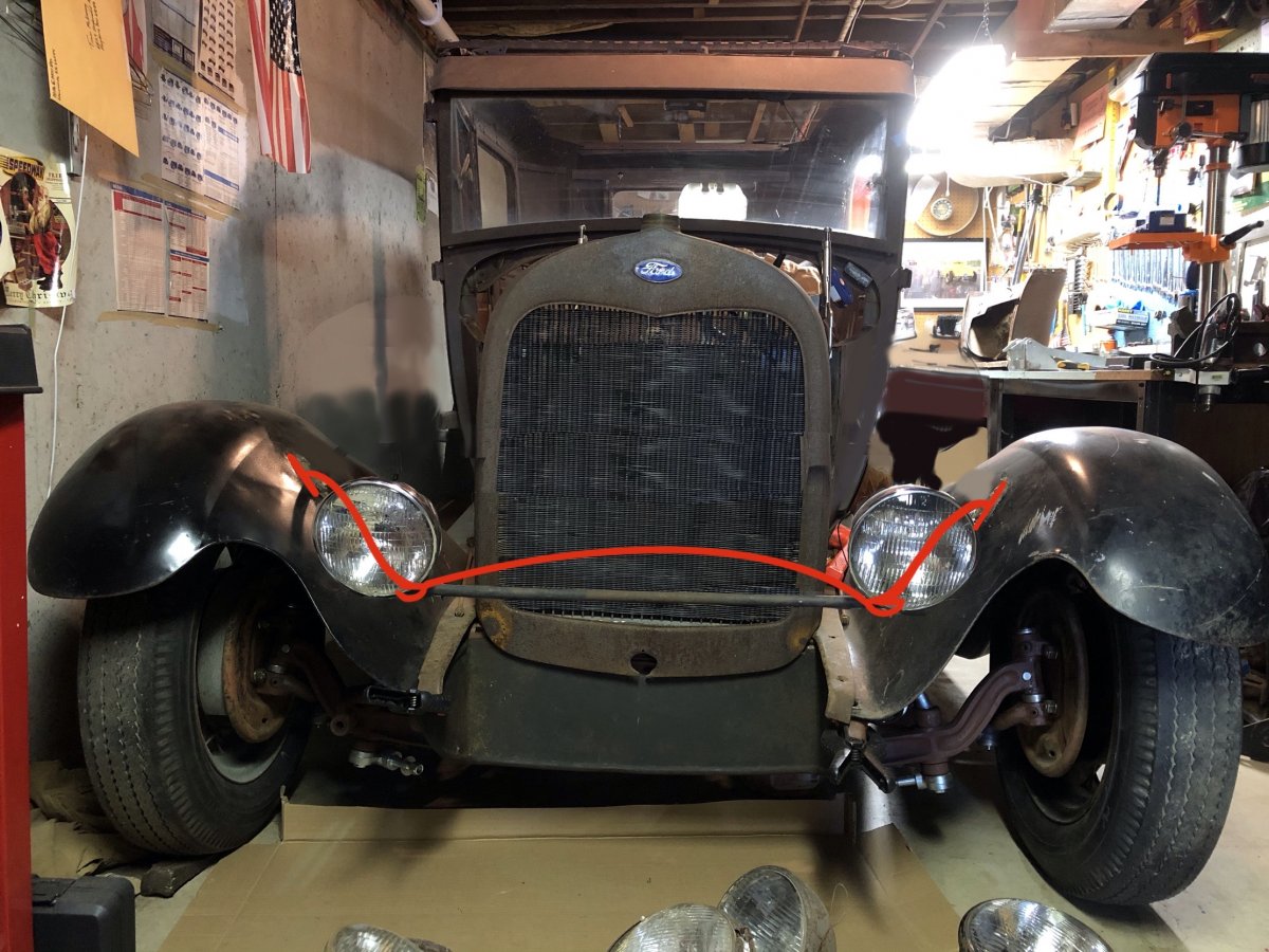

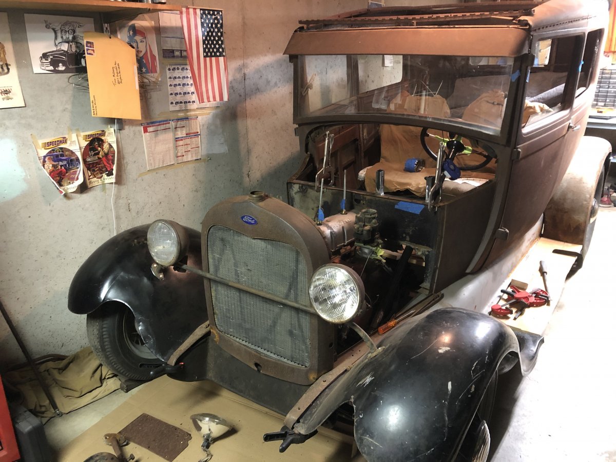

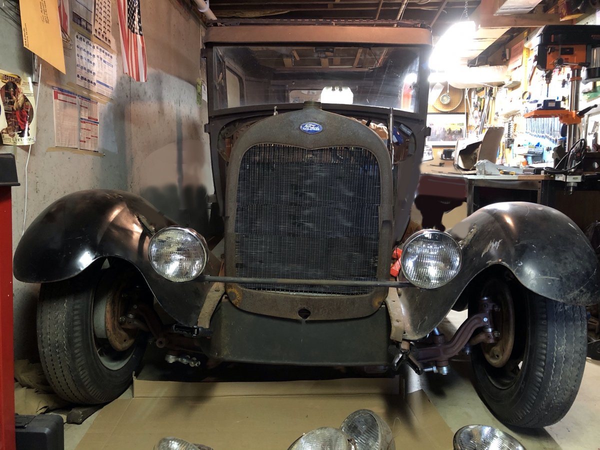

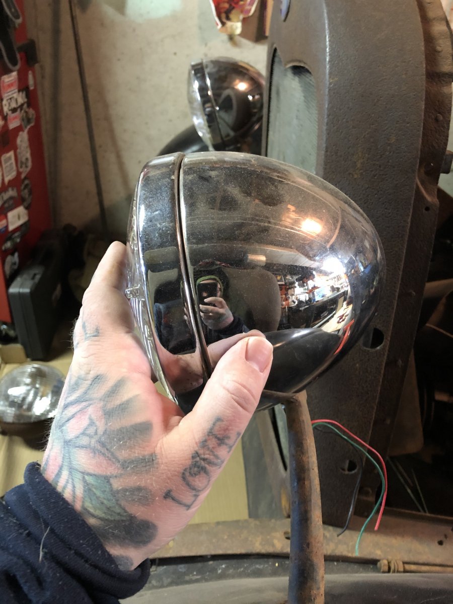

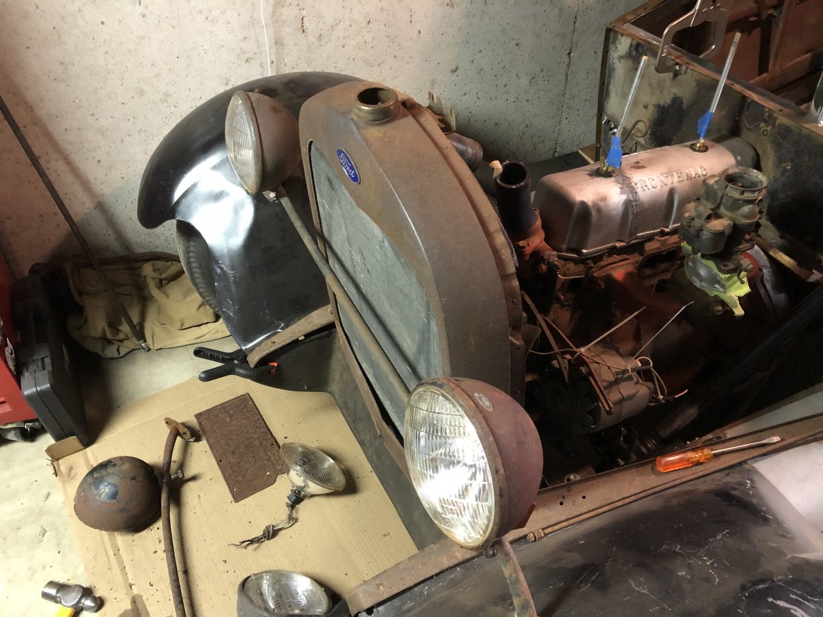

    Got a minute so I thought I’d share the new headlights / head light project :) 63DE658F-146D-43D2-94BE-18C04B9DC863.jpeg my good friend had these king bees and figured if I took them all apart there’s probably two good ones in there some where B60E9C5F-0376-4055-9878-2F432C1D2A5A.jpeg current mock up headlight with hand for scale B34FE217-975F-4B22-B185-A7BC6A548471.jpeg “new” lights with hand for scale.
    The new to me lights have a much shallower bucket and more of a round shape. And the bezel is thinner and rounder. Love both of those things!
    I’m curious if these old lights will adjust straight where the new ones havnt been

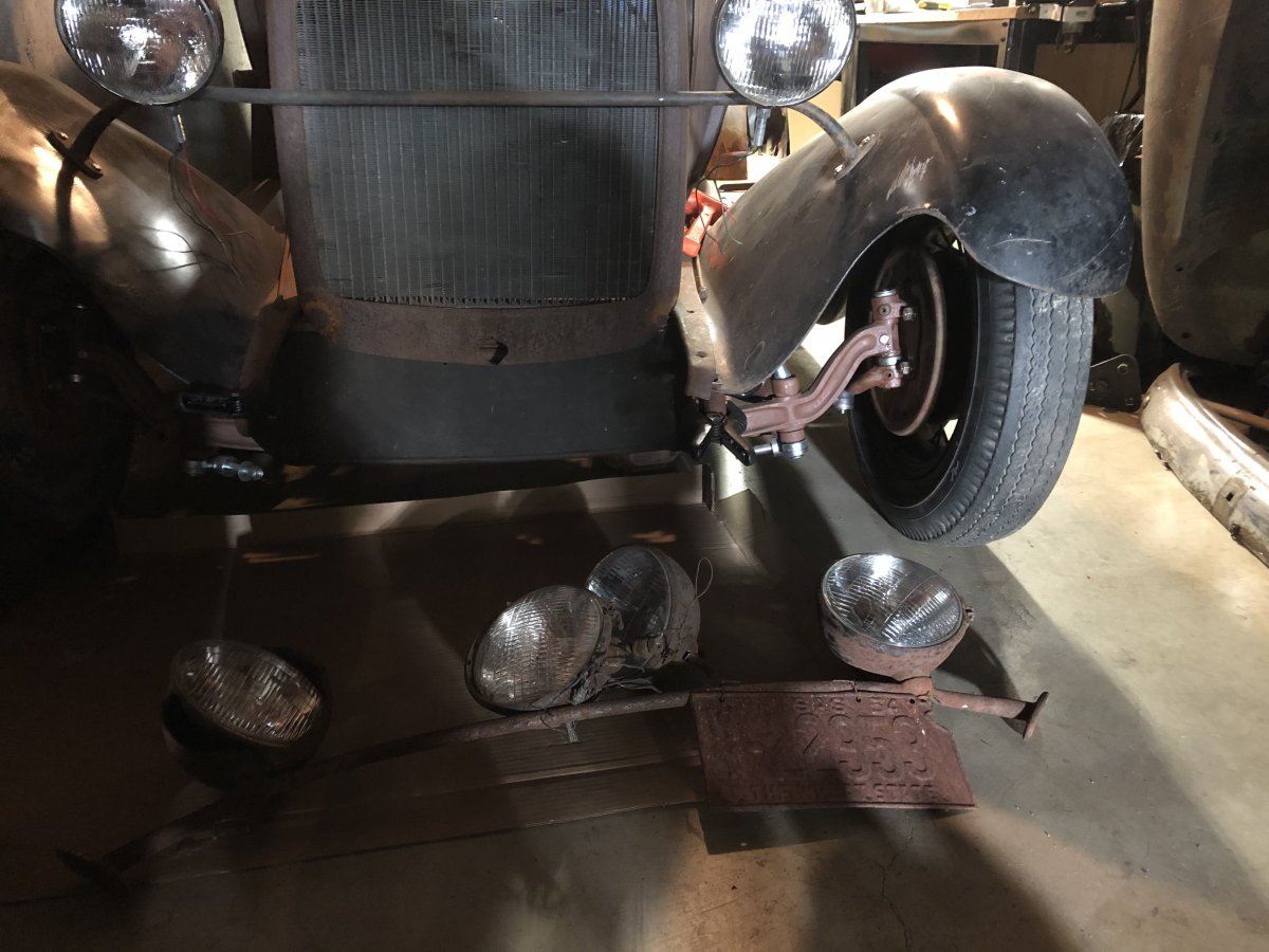

    And since I’ve always thought about building a second headlight bar that is either dropped and mounts on shortened fender braces, or mounts to the frame but has a tie bar between the two and ive got a 30/1 head light bar bolted to some of these lights I started playing around.
    wondered if anyone’s run a set up like brain b***’ red roadster has but with fenders?
    anyhow was ****ing around and rendered these. It would have the arch in the middle because I’d be using a later headlight bar but you get the idea.
    probably cut the ends off and rotate them up, reposition the tab. Trying to keep a stretched S shaped to it all.
    anyhow less rambling more pictures 5FE8DE34-C331-499B-A142-0CF922A226D7.jpeg 877A1603-B0BB-4A99-8F63-31A2D3AAD16C.jpeg D022FA8F-B617-4C64-B039-4190829BE38C.jpeg
    After the fact I’m wondering if I could just make the arch that a 30/1 bar has go forward instead of up. It could read sorta like a nerf bar?
    ****s so low it’s probably cleaner to just mount them to the frame rail threw the fender instead of make the ends have 25 inches of drop.
    either way I’d pull the fenders off and mock it all up to see what they look like for real. Just kinda like the idea of being able to run them with or with out the fenders.

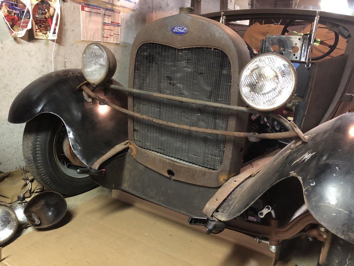

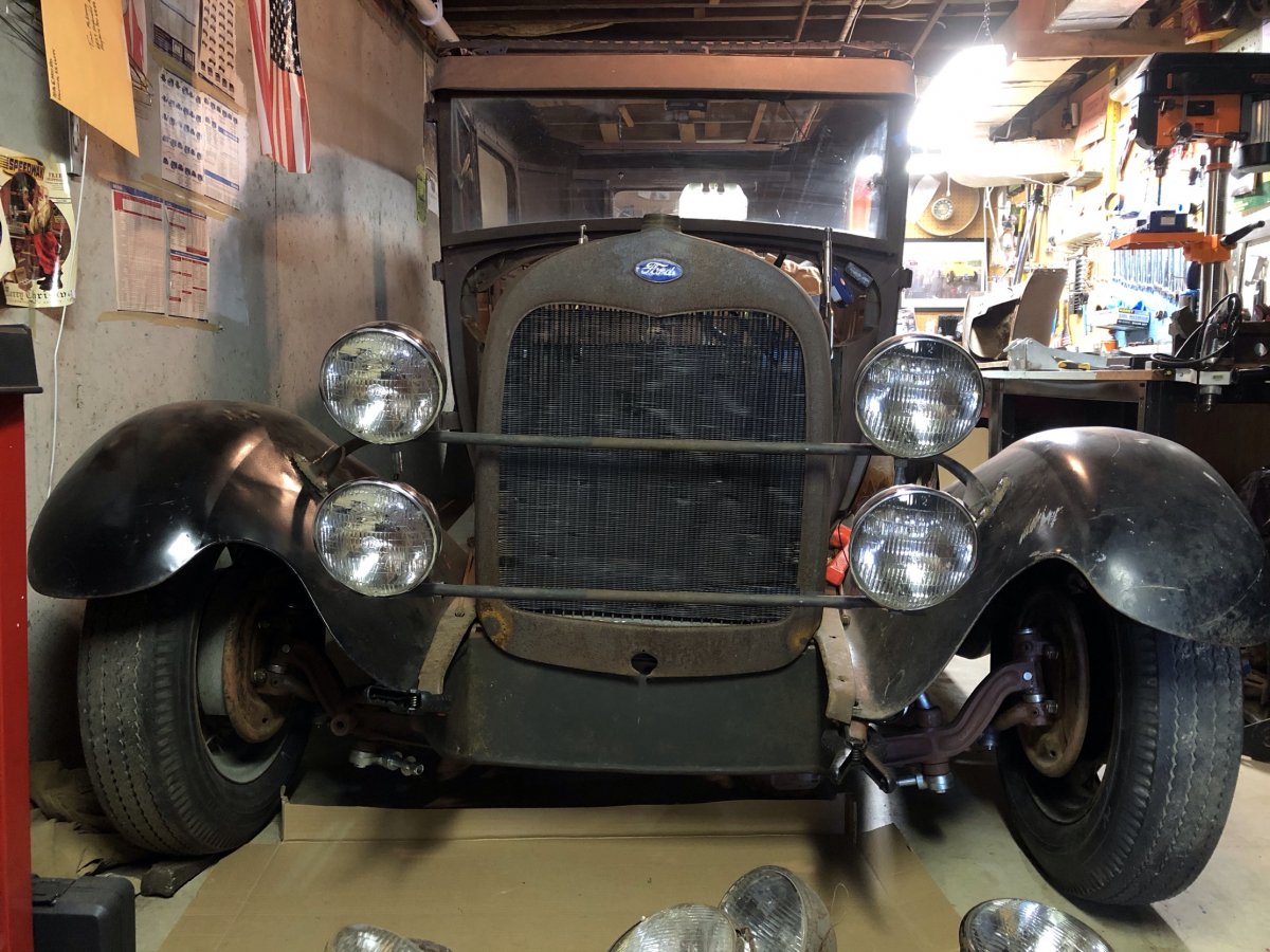

    Took some heat and a hammer but I got the two best lights free and mocked up on the headlight bar.
    One has a mounting stud that’s pretty rotted and the other had the threads beat to **** when it was forced threw the headlight bar to take it off.
    oh well. Either way some magnets and they are mocked up. They look more like what I had in mind and they do adjust all the way up to see the road 0304B404-48B1-40D8-B06D-22CA116E6766.jpeg B6F2B1AC-FB90-4A6D-A6F1-63E8091FD4F3.jpeg

    I keep walking by it tonight doing loads of laundry and I’m surprised by how different it feels with these lights.
    looking forward to tearing them apart and making good lights out of them. Whenever that is.
    for now I just want to cut new threads and figure out how to keep them on the bar with out magnets haha

    You could weld the lights to the bar and slot the bar mount holes on the fenders to adjust the lights.o_O

    The way drop or second look would be primarily for the fenderless outings. Just thought it would be cool if you could run it that way with the fenders as well.
    though for now I’m not gonna mess with it. Figured I’d mock it up for ****s and grins since I was thinking about it and move on.

    full perfect range of adjustment with these lights! I think part of it is these have a much smaller mounting stud so you have way more wiggle room to situate them

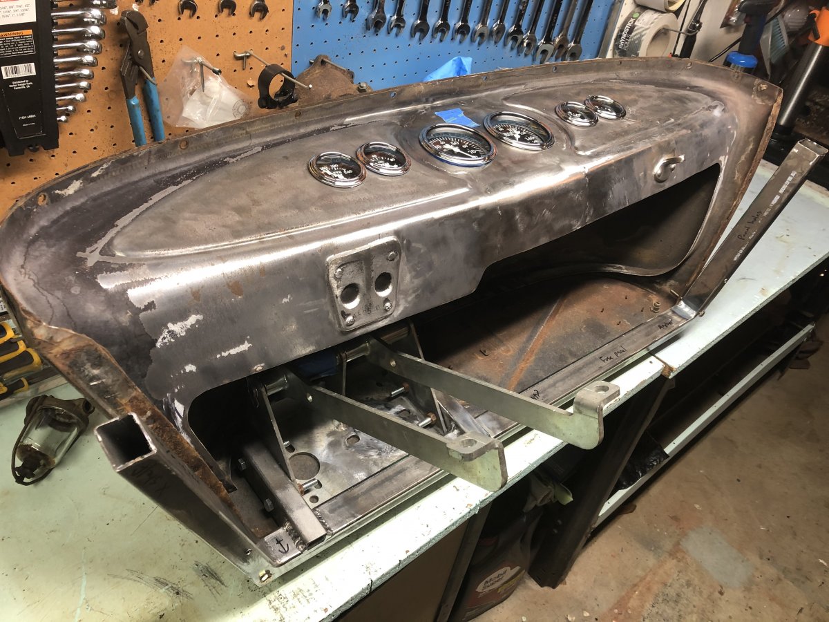

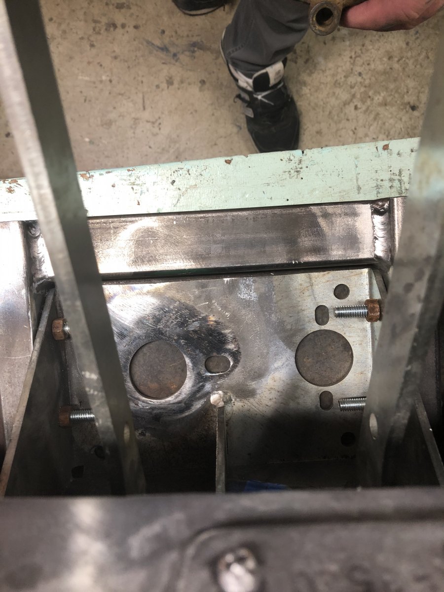

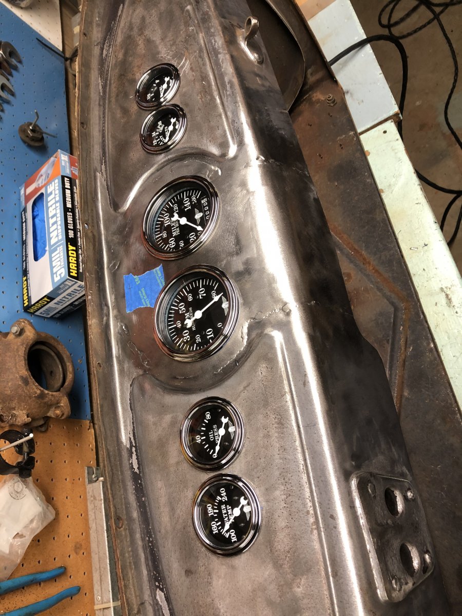

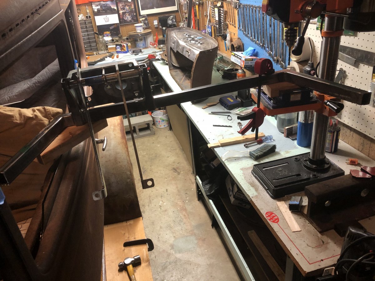

    A quick, very loud hand file and the dash is full!
    a quick p*** with a flap disc on my wavy upright and a little extra time tappering the top corner and I tapped the pedal box in with a dead blow.
    it’s not an interference fit it’s just got tiny little tight spots here and there. In the top view of that upright you can see how waved the sides all are. I must have had that section squished in a vice or? At some point that it’s so waves but what ever. It’s super beefy and no one but you and me will ever see it ;) next step is transferring centers and drilling the pedal box.
    I need to also fit the cowl top to see if it clears the pedals but I think I’m going to have to bolt the brace to the car first as I’m not sure how to clamp it with out interfering with the top going on.
    Anyhow... pictures 2BB57E79-2130-4247-AD30-4134F42CAB3F.jpeg 3CA23196-61AD-4D1A-8279-9DB2267233AF.jpeg 88EB4877-BF01-4D6F-AFC5-CC8A45FF1B80.jpeg

  22. Tim
    Posts: 20,782
    @s**** metal 48 thanks. I saw what @Tex***peed did in his roadster and that started me down the path of tweaking a stock dash like this.
    I’ve seen it done a couple times online and really like it. I’m very tempted to rattle can it but I know I’ll have to strip it all back off to body work and paint it anyways so I’m hesitant

    These aren’t rifle drilled like those. The wires exit the bucket instead of threw the stud.

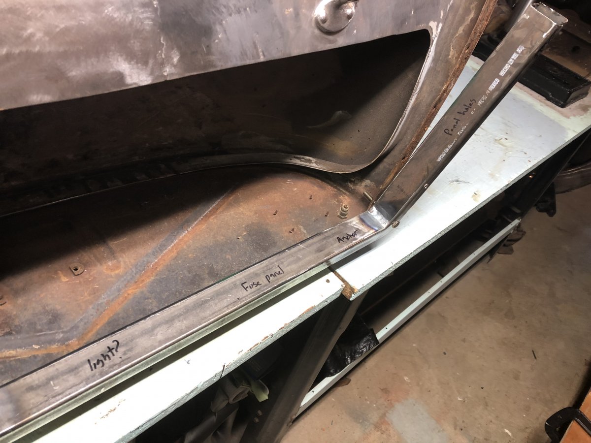

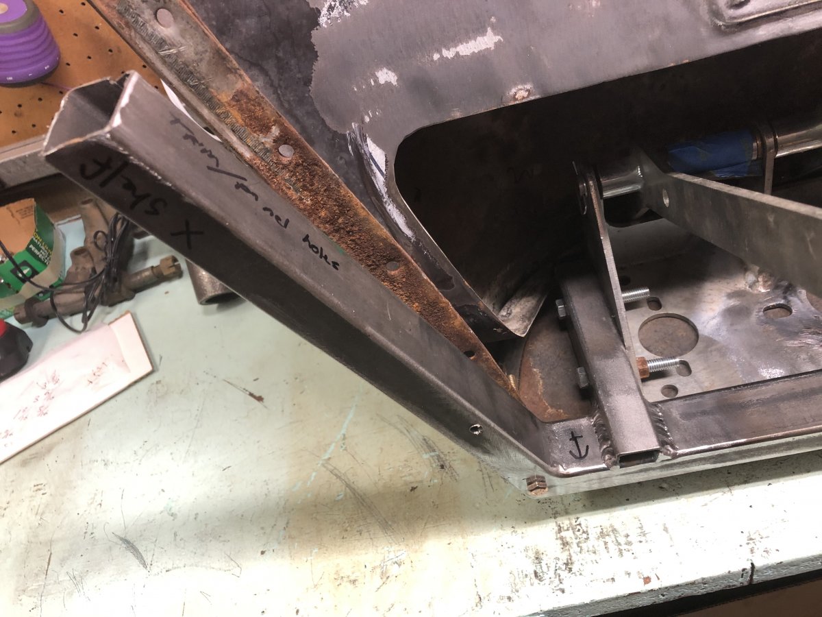

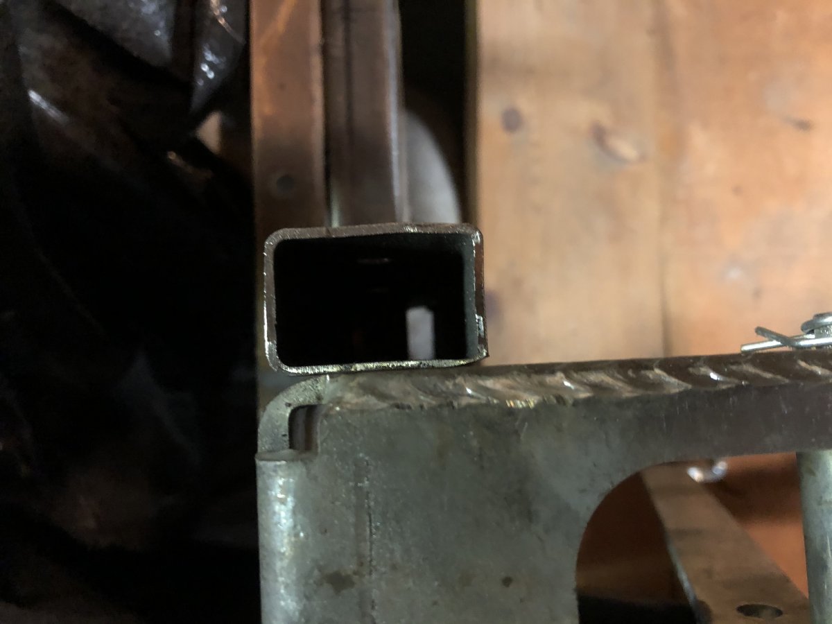

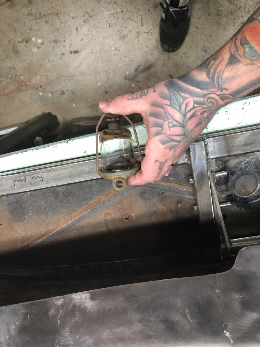

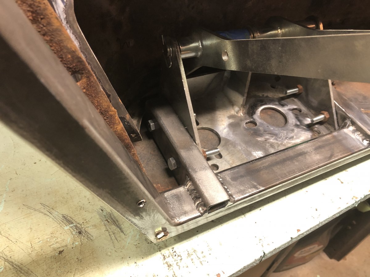

    Alright so quick update. Used my new transfer punch set and marked the 4 holes in the uprights for the brake pedal box and the four holes that line up with the cowl side/ top holes.
    pulled the brace out, which fits perfect but is so snug that you really gotta force it out, and drilled all the holes.
    Put the brace on the cowl sitting on the bench and put some bolts into the cowl to make sure it all clears.
    every thing looks good. Need to file one spot to give just a little more breathing room and it’s pretty much good to go on that end.
    was happy to find that neither of the masters seem to have landed on a bead in the firewall o I’m stoked on that.
    after realizing what a pain in the *** it is to get the brace in/out I decided to go ahead and drill all the additional “accessory” holes in the brace now while it’s out instead of pulling it back out a dozen times. I’m sure it’ll go in and out a few more times but I think I’d like to minimize how many times it really needs to be.
    I’m going to just load the photos all in a lump at the end but you’ll see that I sharpies the general area of the holes I need to add and what for.
    this includes, two or three bolts to hold the cross brace to the lower firewall. Bolts to hold a fuse panel board, bolts for grounds, bolt forgot a ground strap to the frame, threaded holes for kick panels to bolt on. I had the old fuel filter where I thought it might make a good light, That sort of thing.
    still trying to pick a good spot for a little cube heater.
    anyhow there we are. Got a small load of “new” parts to pick up in the next couples weeks so I’m excited to add to the pile as well and make progress on the actual car.
