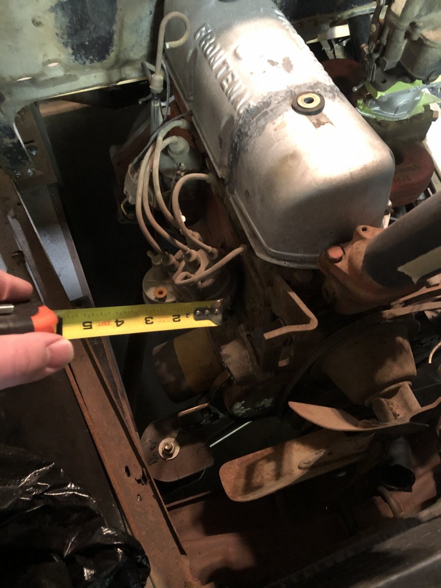

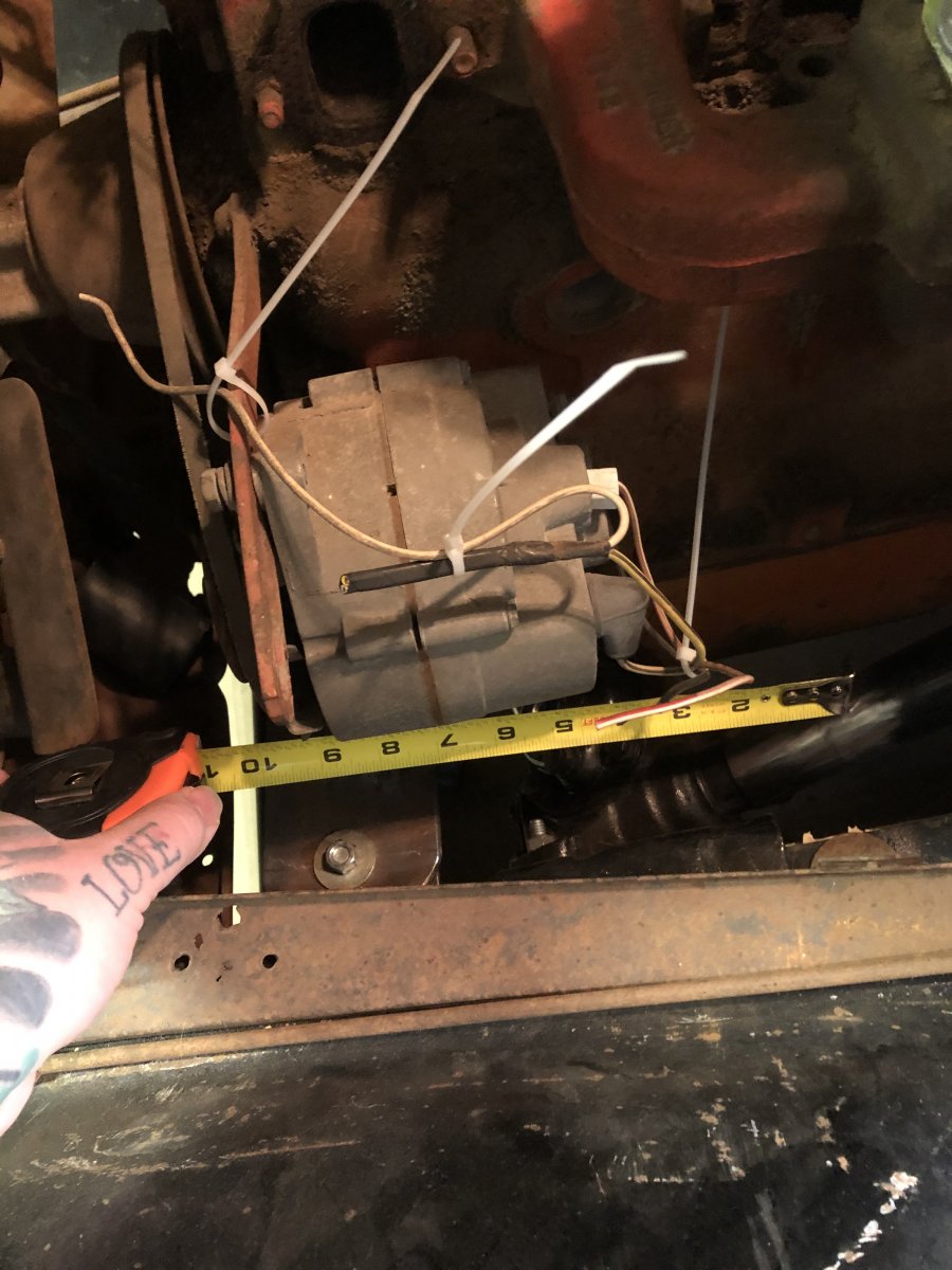

    I can get more measurements and pictures if you want. When I was thinking about doing this I planned to mount it on the p***enger side but there might be problems with the distributer. Remember these things were designed for engines twice the size of our fours.

    Yeah more measurements would be wonderful! And yeah with where the lower radiator hose goes in, and everything else crammed into the p***enger side it gets super full super quick
    that’s why I figured blower would go drivers side and down low, and the alt would be a super small unit mounted basically on the p***enger side next to the valve cover

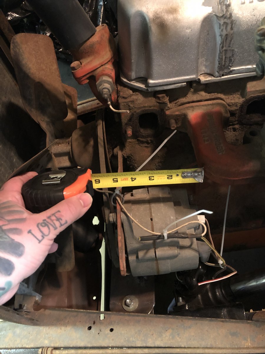

    Blower spot measurements - thoughts after photos 8359E9AE-83F3-4231-8D94-887A6AA87F38.jpeg about 9 inches from block to hood side 6E32DD1D-FA9E-4327-BB16-7B90CF07E563.jpeg I’ve got plenty of room vertically CC500B85-9E36-4509-945F-087AB24D2B17.jpeg back and forth room til I hit steering. EE469023-7E7D-45EB-9769-32B181E9B33E.jpeg Space until intake from mounting face 3907DED2-CB9A-4278-BEDB-324F18757AF8.jpeg tight spot I’m pointing at would be that primary for the header AC500578-0B0B-4A06-80FC-3DAA1A85B88F.jpeg this spot is were the alternator would go. The bracket is for a pulley that kept tension in its original use. Left it there for a lift point for now
    thoughts. I need more specific measurements because each end measures so different because it’s like you stuck a torque converter on a generator. But I think if you had it in place and worked your header design around it working that it’s feasible to get it to work. Might have to make a blister for the hood side but I doubt it would be much.

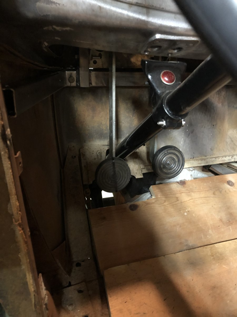

    In other news I got the brace in/on the car and the cowl on! 0B8A89BA-2965-4101-82C2-ACA7FC973DF6.jpeg 6416BA59-5F08-4355-BA24-A7EDC493DFAD.jpeg the one bolt per side is way less obtrusive visually than I thought it would be. Eventually I think I’ll use a ****on head Allen bolt. This is all just mock up random hardware AC311E4B-7AFD-4247-B8E7-32A03CAFD304.jpeg first time the cowl has been bolted back together in a loooooooong time. Even if I hadn’t messed with it I’m sure it would have required “the old ford dance” to get all the bolts in. Seeing as I did well, hammer, shrink, and all around **** with both sides it did take about an hour and a half to get the hardware to line up. And I still don’t have the cowl sides bolted to the top. I got the tank mounted to the dash bar, and the fire walls bolted together and figured seeing as it’ll come back apart anyways that was enough to ***ure further mock ups were wrong in placement.
    looks like the last to images jumped around I’ll edit them back in here

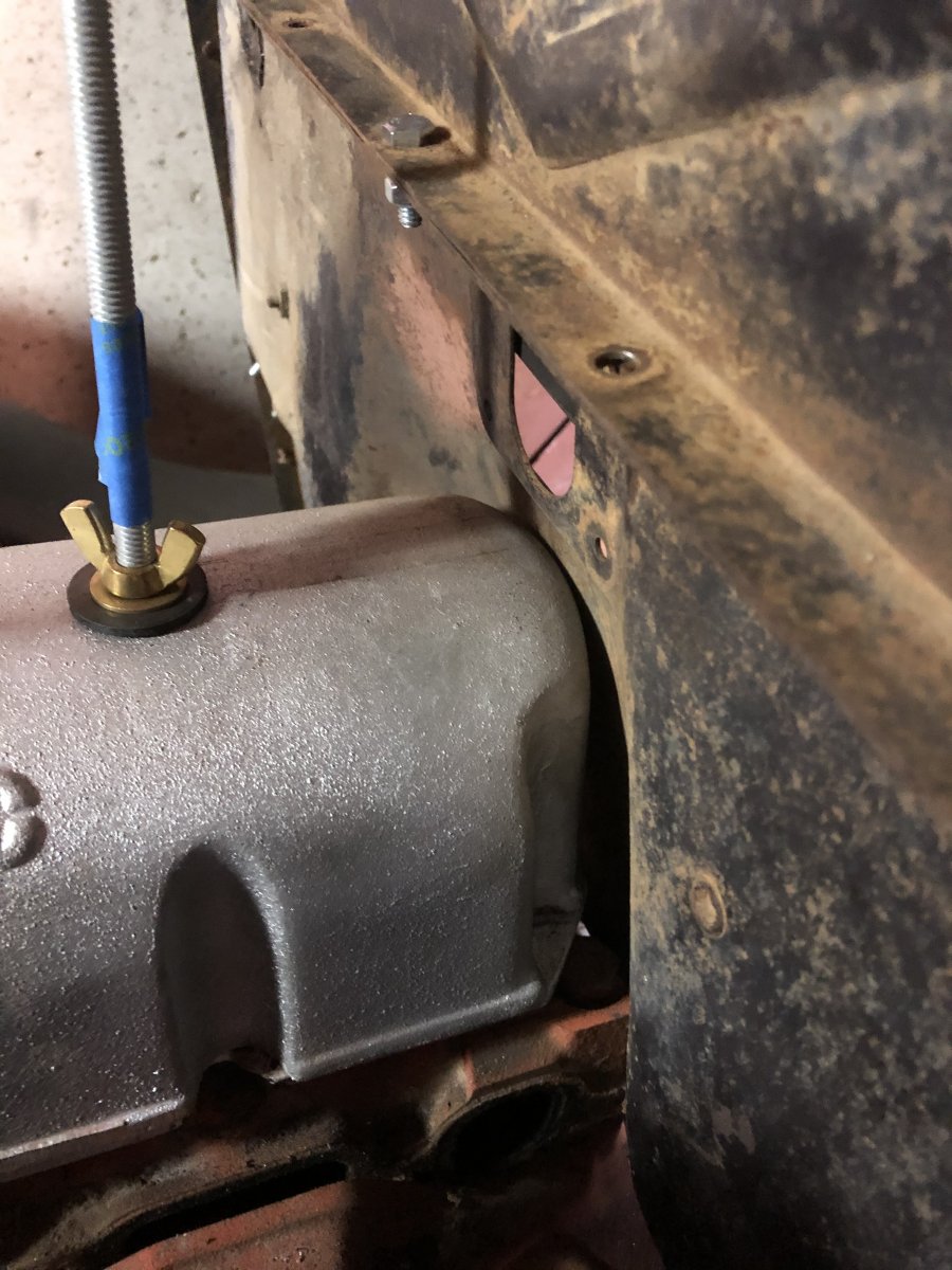

    you can see the cowl side bar in the one photo, and the tiny interference at the top of the valve cover in the second. It just barely touched the top but has plenty of room further down. I ***ume this is from me messing around with the other side
    shouldn’t be a big deal to m***age it a little later. The other side could still use a little attention as well but we are far enough to move forward 1FE37D97-DCDF-4424-AA7D-114A7ED3B918.jpeg 21DACAC1-3458-4D20-858B-4CE27D1451D0.jpeg

    Next moves are fitting the A pillar shelves. t******* these valve cover hold down bolts because I’m tired of working around them, and then making a filler between the steering column drop and the spot on the dash bottom it will mount to. I’ve got a few ideas. Might end up making it out of hardwood. Either way it’s likely I’ll build it in the car because bolting that’s tank back in was a real pain in the ***. I’m sure with welting in place eventually it’ll teach me lots of new curse words lol 3AC0463A-E50F-4022-8B26-468F922556FF.jpeg

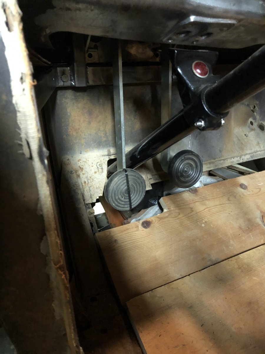

    Looks good, Tim! I want hanging pedals when I build my A so I’ve been watching your build closely.

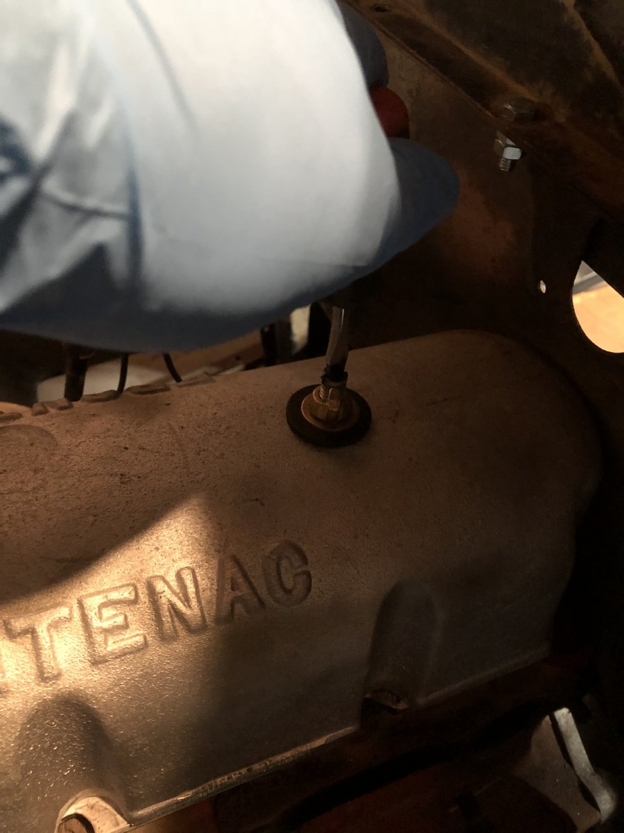

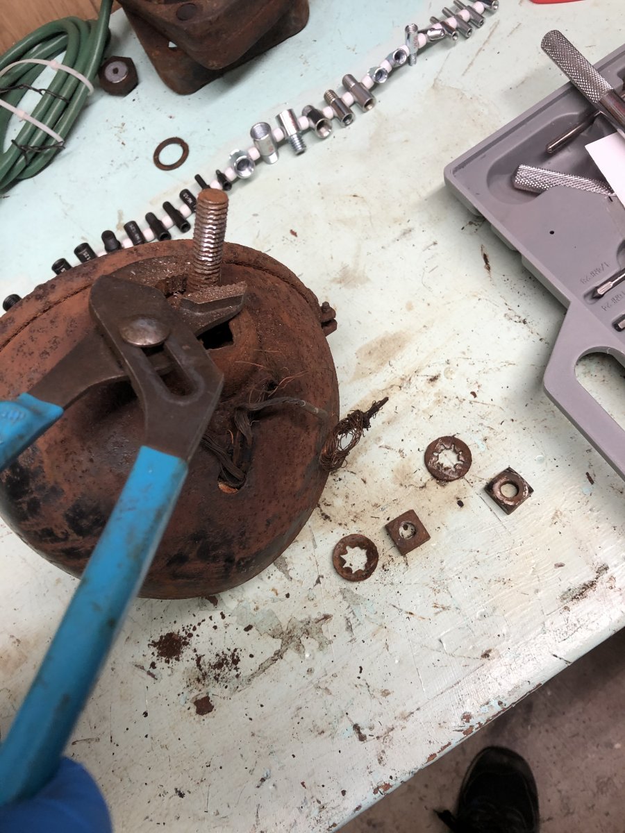

    Got the valve cover hold down screws cut down and slotted for a screw driver and stuck back on. 9E374DBF-7DE9-47C6-B63D-85D46A73363C.jpeg 7DDA620B-16B4-499B-9CBF-A090F7CC6320.jpeg
    Then I threw the radiator stays on. After welding the p***enger side fire well tab back on its wonky here and there.
    The firewall bracket was moved forward, the rod was S shapped and the tab on the radiator looks like it might be leaned forward a little.
    I think if I can get the stay rod straightened out it should be good.

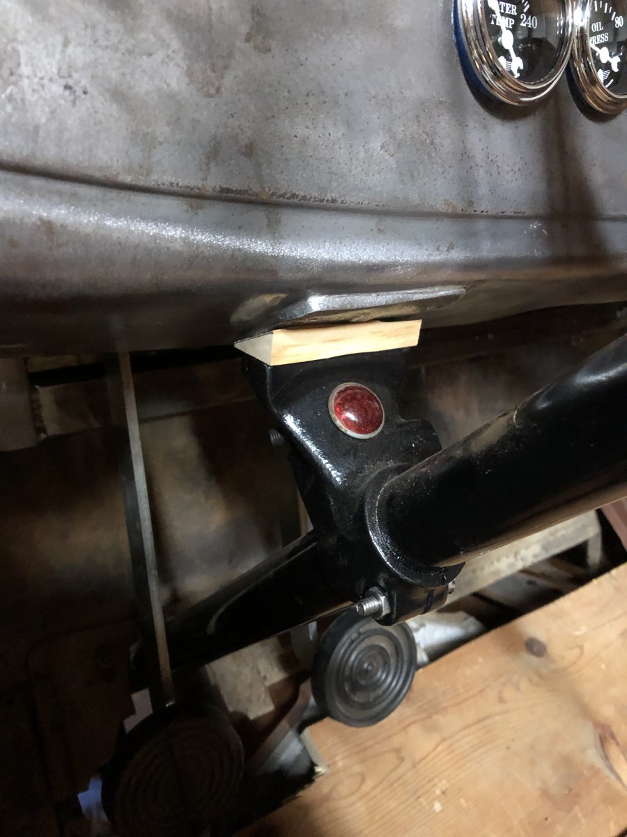

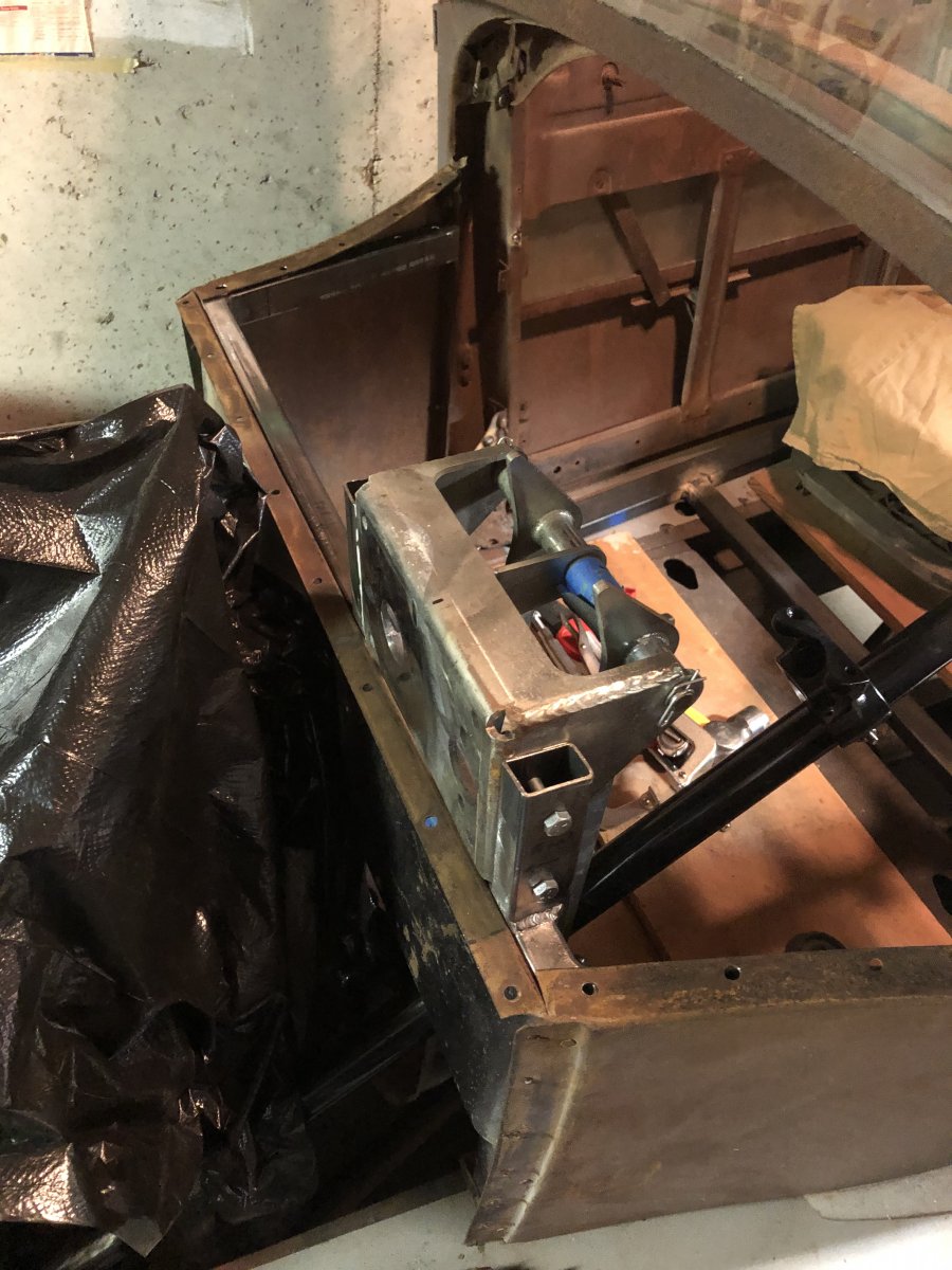

    Started mocking up the wedge for between the steering column drop and the dash. Got it all measured and marked on the wood just need some saw time.
    so I pulled the two best headlights and chased the threads on the nuts and bolts even though the bolts are pretty shot and will be replaced eventually. I needed my magnets back lol.
    Shook a whole bunch of rust dust out of them I’m sure they’ll be nasty when I get around to working on them 6547BDEE-24D5-438F-AE80-BA244BA3DACA.jpeg EF74AA60-38F7-4CCF-B1E8-75E61AEFDA31.jpeg 820A0CFB-3551-4CF7-8B5C-77294241DE16.jpeg 666A8670-E287-4F07-A207-4A3ABEAEB740.jpeg am I the only one who likes using a tap and die set and bending hardlines?

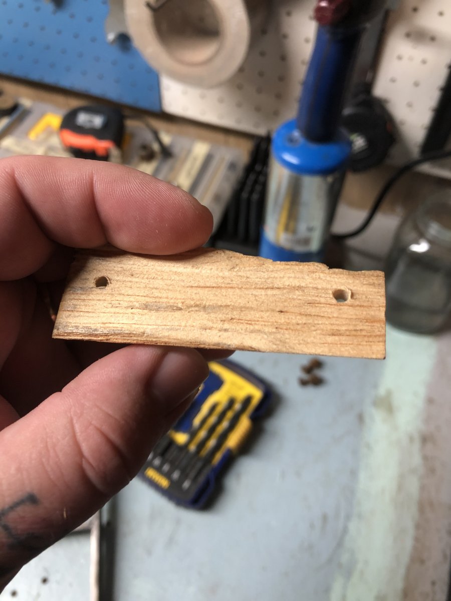

    Made a little wood block to fill the gap between the column support and the dash bottom. Originally I was going to move forward and make it out of steel but I’m really liking how the wood looks so I think I’ll make. Nice out out of a hardwood and stain/clear/ finishing to match the floor. FC548705-4F57-4D1A-ABD4-D03CB954C0AB.jpeg

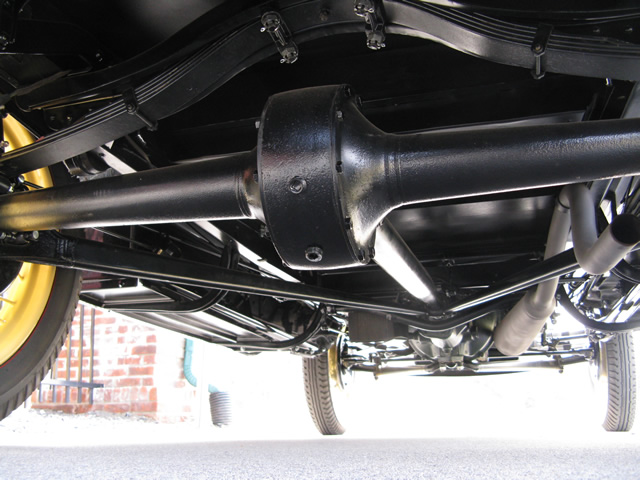

    Looking at different stock and hot rod routing of the tail pipes to get an idea of how to navigate the radius rods.
    stock looks to have a quick sharp rise over them but there’s not room with the car lowered this much. I’ve seen several hot rods make the jump toward the trans and just run along side the torque tube which seems like would give you a straighter shot at it.
    Just something to think about 79EDF5AC-EFE9-4418-829D-147D2E649BC8.jpeg 5FA85DFE-F62F-4F61-AAB7-EA87D486FDDD.jpeg

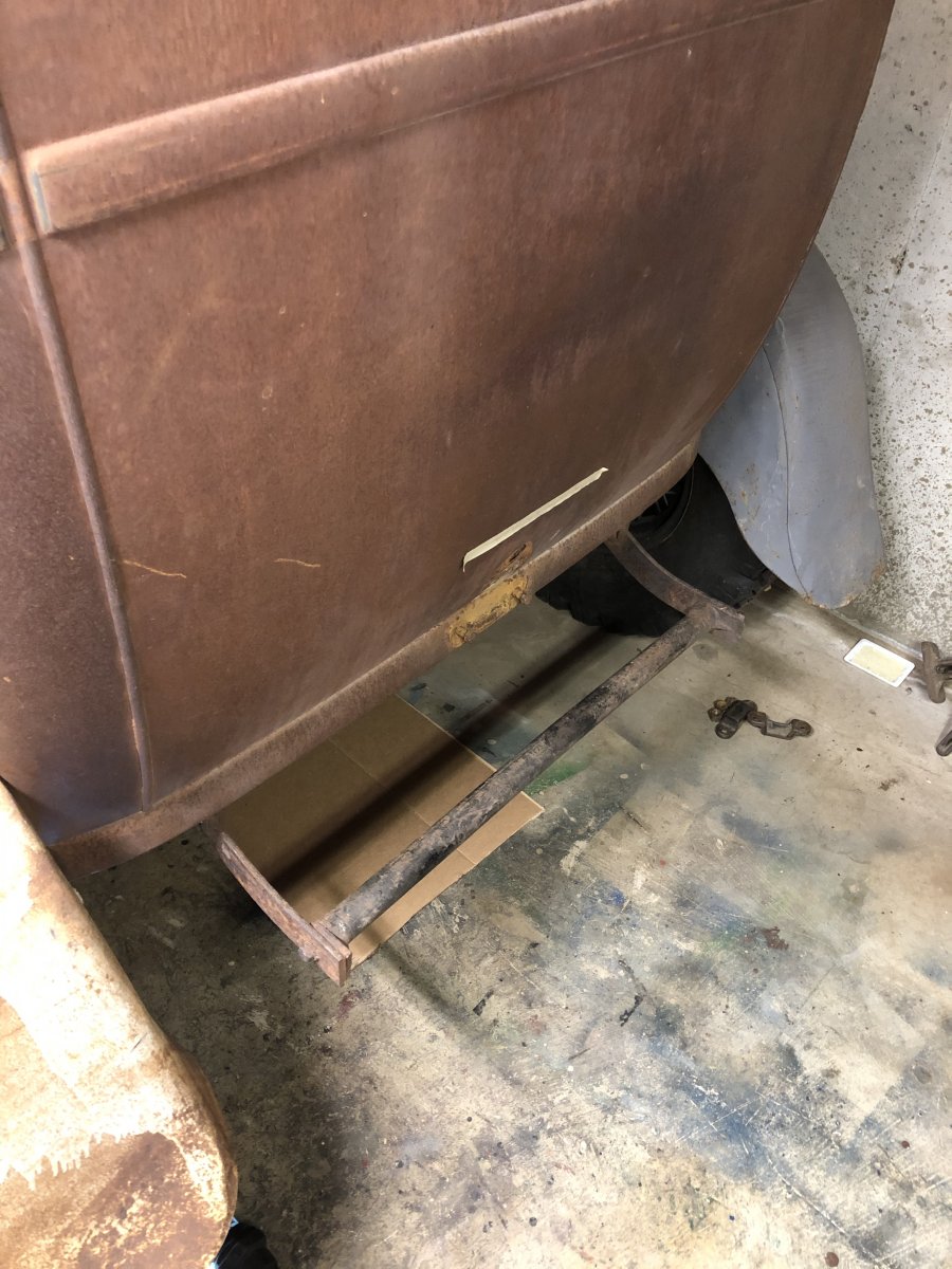

    @Rocky didnt have any running boards but I had some long boards lol. The plan is to make a frame from square tubing with flat plate for the top.
    I don’t really like the stainless trim on the edge of stockers and I just know the kids will jump on a set of re pops and oil can them in two seconds. Figure this way I can use them as running boards and not give them a second thought.
