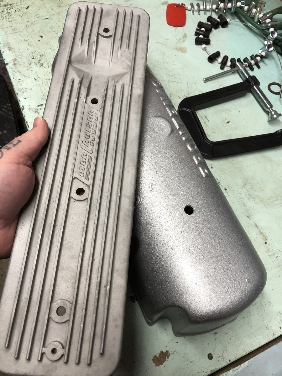

    Alright so I actually bolted something together for 6 ball ;) 4E9FCBCF-7B66-46F7-91BE-EF4DA9116417.jpeg I marked the center most mount- hiem joint?- from the inside with sharpie and used a center punch. Then drilled a pilot hole.
    took the intake off and started holding every together to mark the second hole. Used a step bit to pop it up to size and then drilled the hole for the linkage to p*** threw.
    What I’m using for stand offs were originally used turned around more like a washer to hold the carpet and firewall insulation down. So my bolts are to short by about 1/4 inch to bolt to the firewall. They Lon pretty much flush to the end of the cups.
    im trying to decide if I want to find some longer joints to use or if I want to use/ make what amounts to a threaded insert with a rounded/ ****on Allen head. Then they read more like a rivet at a glance. Edit: I googled female Allen head bolt and what I had in mind popped up so I guess that’s a real option
    if my favorite hardware store was open for walk in traffic id go browse then bins for a half hour and find my solution.
    probably still will by the time I’m back to work and have a few bucks for hardware they’ll be back to having the showroom open.
    not sure whats next on the list of stuff to **** around with without spending money.
    I guess I have the intake off so I could drill the firewall maybe I’ll file all the casting parting lines down and the lettering off it and make a block off plate for the old heat riser.

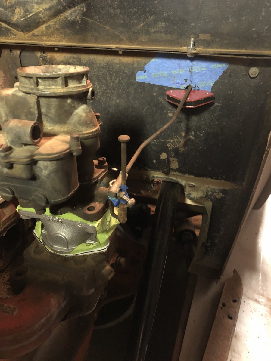

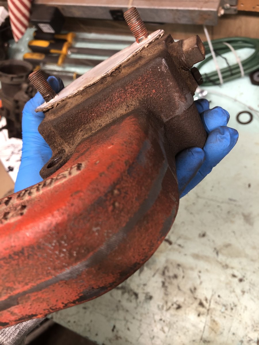

    Knocked the big horizontal parting line flash off the intake as well as the part numbers. I left the firing order numbers because I thought it was kinda cool.
    filed he holes on the adapter so it fit a little better and have been trying to figure out what thread the carb base bolts are. Not having any luck with fitting anything in it and am thinking I’ll grab my taps and see if any of those fit. Maybe it’s just one thing weird.
    made a quick cardboard template for the heat riser block off plate and threw it back on the car. I notice a threaded hole and bolt on the outside of the manifold that must have just held something at some point but otherwise serves no purpose. I’m thinking I’ll put a tab washer on it to hook a return spring and then weld a little ear to the linkage rod for it to attach to. Should be clean enough and I like the idea of the spring being close to the carb instead of close to the pedal.
    last thing I did was pry the valve cover off. Yup. Pry.
    It seems when I was hammering the firewall it tweaks just enough that it touches the top of the valve cover and that ****er did NOT want to come off. Well I got it off and threw some jb weld in the pits of the weld to try and even it out so I can sand it down and paint it all this week.
    I’m mulling over plans for clearancing the firewall for the valve cover. The stock cover has miles of room but it’s unforgivably ugly and the nice one 12bolt Tom makes it’s just the wrong style for this by a long ways.
    I had considered cutting half of a headlight bucket off and putting that into the firewall to clear. If I don’t have one the right size hammering a round shape out.
    but it seems most likely that maybe I’ll just cut three side free and bend it out of the way and then weld in a filler.
    though with such a small area I’m wondering if just cutting that 4th side and just making a new filler piece so that you only have one seam to weld would be worth the effort.
    dunno. Guess we’ll find out soon enough.

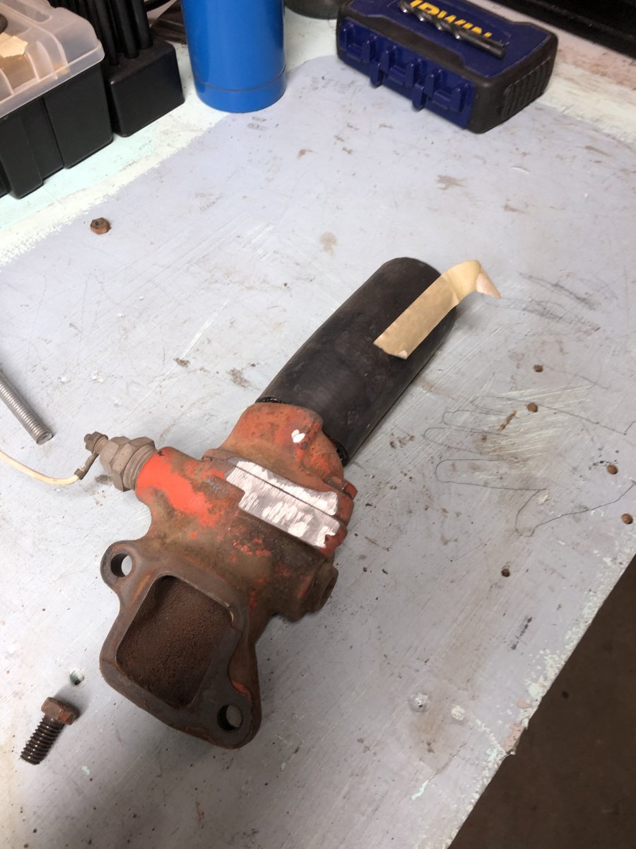

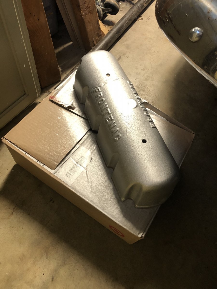

    Got a tiny bit “done” today. Painted the valve cover, I used a hammer tone silver metallic paint and it looks perfect. Very happy with it so far. You can see a little where I sectioned the valve cover but it just looks like an old repair which I’m fine with. There are a few tiny pieces that I need to go back with a small file or maybe a dremel and smooth out some transitions that seem obvious but over all I’m happy and a little touch up later after some more sanding is fine.
    I also pulled the water neck off the head, bolted the thermostat housing/ water neck on and took a grinder to the back side. Even the stock valve cover wanted to hit that dang thing and I see spacers available so it must be common. Either way I shaved about 1/8 inch at most off and leveled the surface for clearance. Happy it went well and fast as I’ve thought about it for a long time.

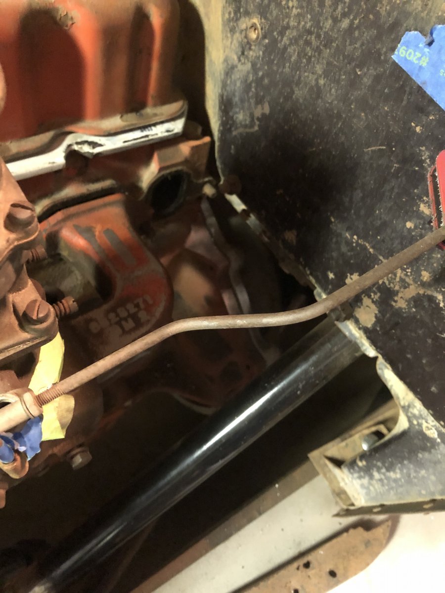

    also mocked up a Z in the throttle linkage. I have a couple rods with disconnect ends around and this one seems the flimsiest so I sacrificed it for mock up. The Z is stretched out a bit because it’s actually slanted when on the car. It drops the rod down about an inch and over an inch at the same time. No real easy way to have moved the pedal to make it a straight shot so this is my “compromise” to make it work how I want. Probably
    Mess with it more but for now the idea is sound.

    drdave, murf 32, brEad and 5 others like this.

    The valve cover turned out nicely.

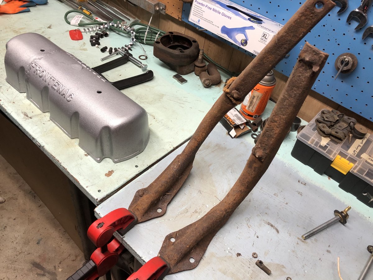

    last night I played with the running boards a bit and found 2 things.
    1: they do actually fit up size wise pretty
    Good. They don’t measure the same as the repops online or a few Ive measures in person in some aspects.
    But they fill the gap so it works for me. I see people slicing and dicing repop stuff to make it work all the time, and we have all bought old ford stuff that just doesn’t match up to the rest.
    Anyhow...

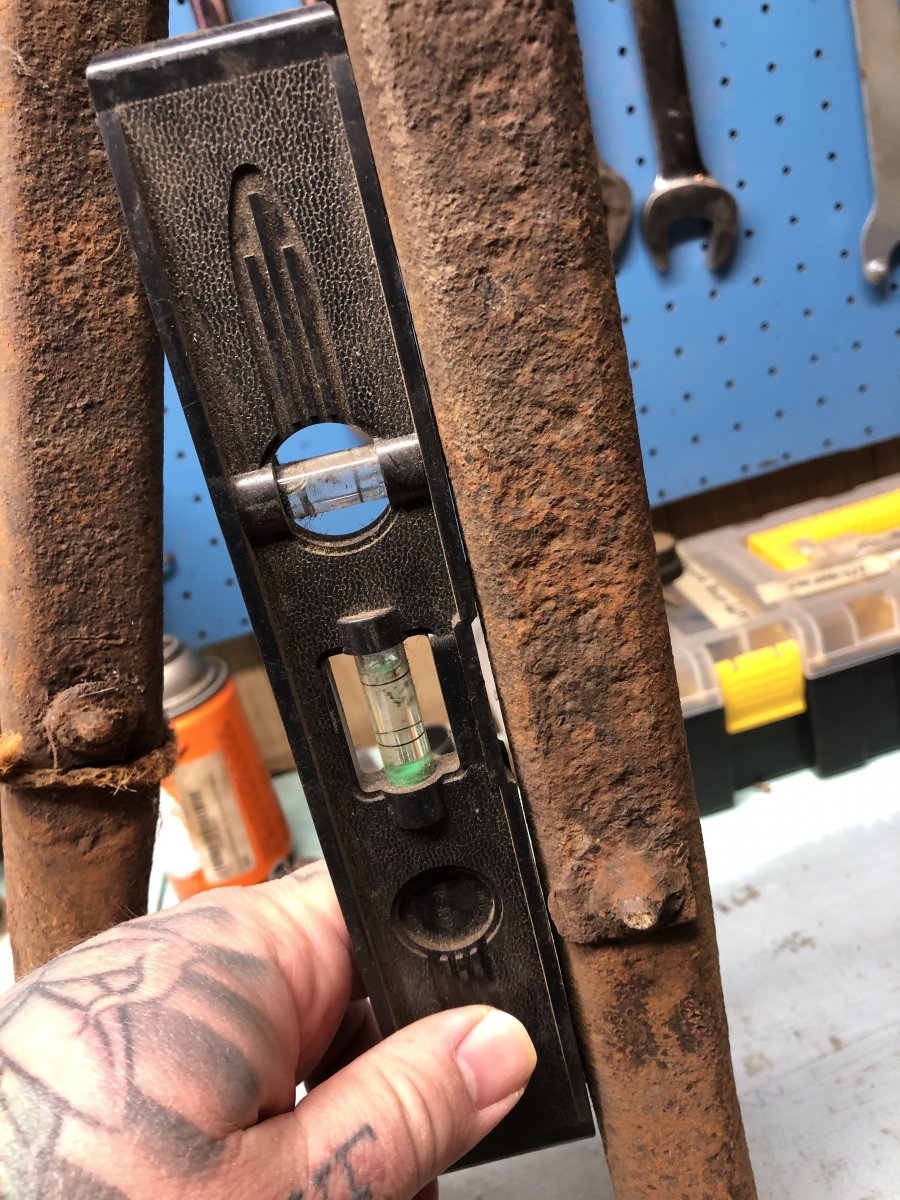

    2. the bolts on these have always made me scratch my head. They are scratch made and made wider in back for a widend fender but the holes for the back running board bracket is way way off.
    well I got to thinking and recalled there being a correct right and left hand rear running f board brackets. So I thought hey maybe they are slightly angled, if they got put on the wrong side and the angle is say 1/2 inch they would be about an inch off on the wrong side.
    So I grabbed some ****ty ones out of my s**** pile, you don’t actually throw stuff away do you? And stuck them on the bench to see if they leaned together or apart or were parallel.
    well clearly one of them is bent all to hell and that’s why it’s in the s**** pile but the other which seems to be un altered does lean! So may have to just swap them side to side and see what lines up.
    also took a quick photo of the size cover and the newly painted valve cover to se how they look together. I can dig it. Trying to decide what color the intake/ header/ block will be.
