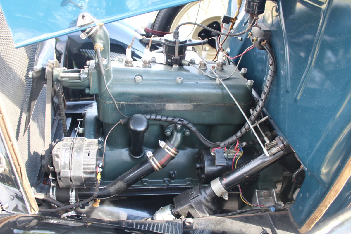

    Went looking for photos of the green I had in mind when I say the ford green 626F579C-A447-45B1-8777-9A0ACA63B578.jpeg this one obviously looks a little different because that red firewall is a high contrast but 064A43A5-88C7-4B04-9C8F-F195E163A6BB.jpeg this one actually has a firewall that’s the color I’m painting the car or at least close enough. The firewall will be black as well as the fenders and grill so I guess the play between the dutches blue and sorta olive color of the block won’t be as strong as I was thinking it may be. 8584042C-1171-4A28-84E8-505D6790E7CA.jpeg and of course a red one with some cast goodies...

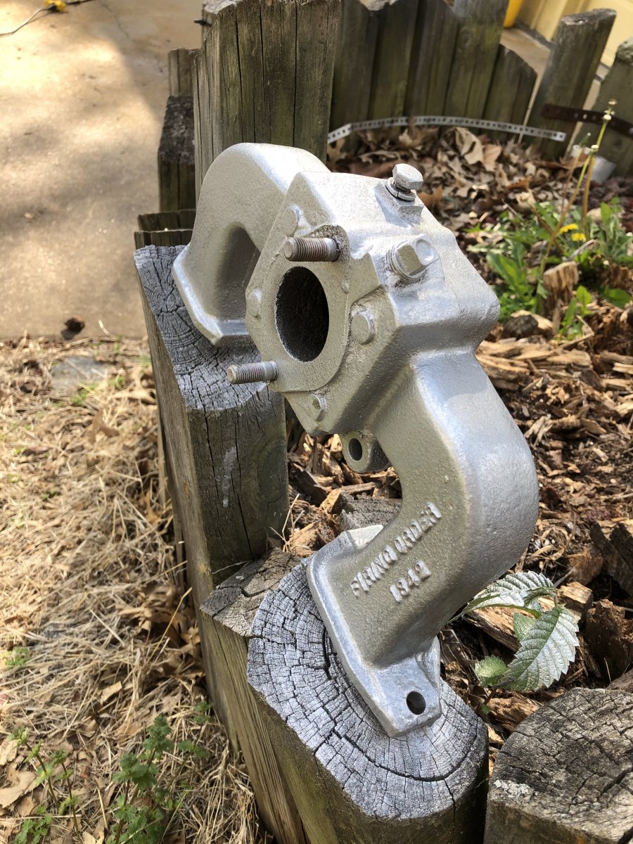

    Does look slick! I’d contemplated polishing the cast iron intake but it sounded like up keep I knew I wasn’t going to want.

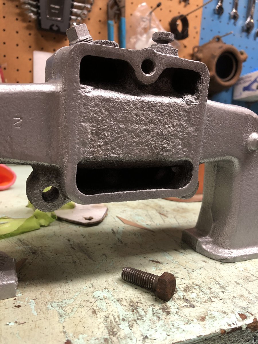

    CF7BBD0C-F9FE-4011-8ABD-BC0CBFED1B19.jpeg Knocked some more off with a flap disc and painted the intake, water neck and the o state housing.
    could have done better prep but it’s better than the last one so I guess it’ll work

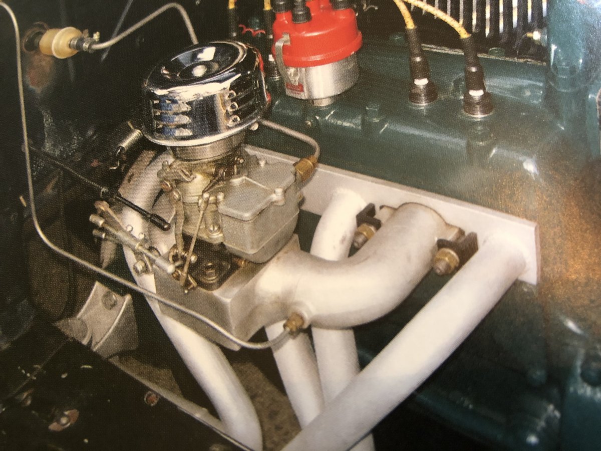

    Snapped this photo of a little detail I found in an 07 hopup magazine. 3E950ABE-411F-4F95-B07A-B68DB7C15D72.jpeg Check out the tabs on the intake/ exhaust bolts. The intake is bolted on top of the header flange and then bolted on. Kinda clever! Been playing with ideas of how I’ll bolt my stuff together.
    Thinking likely I’ll use thick header flanges and then weld a little shim/ washer to it to make up the thickness difference and use the stock hold downs

    :rolleyes:... @Tim, there are profiled cutouts in the flange to allow the intake p*** through to the flange to meet the Head/Block proper and the angle brackets hold the Header flange to the Head/Block utilizing the Studs provided
    If that's what your saying it doesn't read as such...and yes it's a banger masterpiece of course...
    That Header flage needs to be robust as with only 2 brackets holding that header Tight its easy to see the possibility of leakage outboard of those studs...It is what it is I suppose...and a design element of this engine.

    Oh you are right, I thought it was stacked as ice seen others stacked before.
    I was mainly focused on the little angle brackets. My engine has more bolts to hold it all on but they still use a bolt in the middle between the intake and exhaust with a little rocker arm looking piece of hardware to clamp each side down

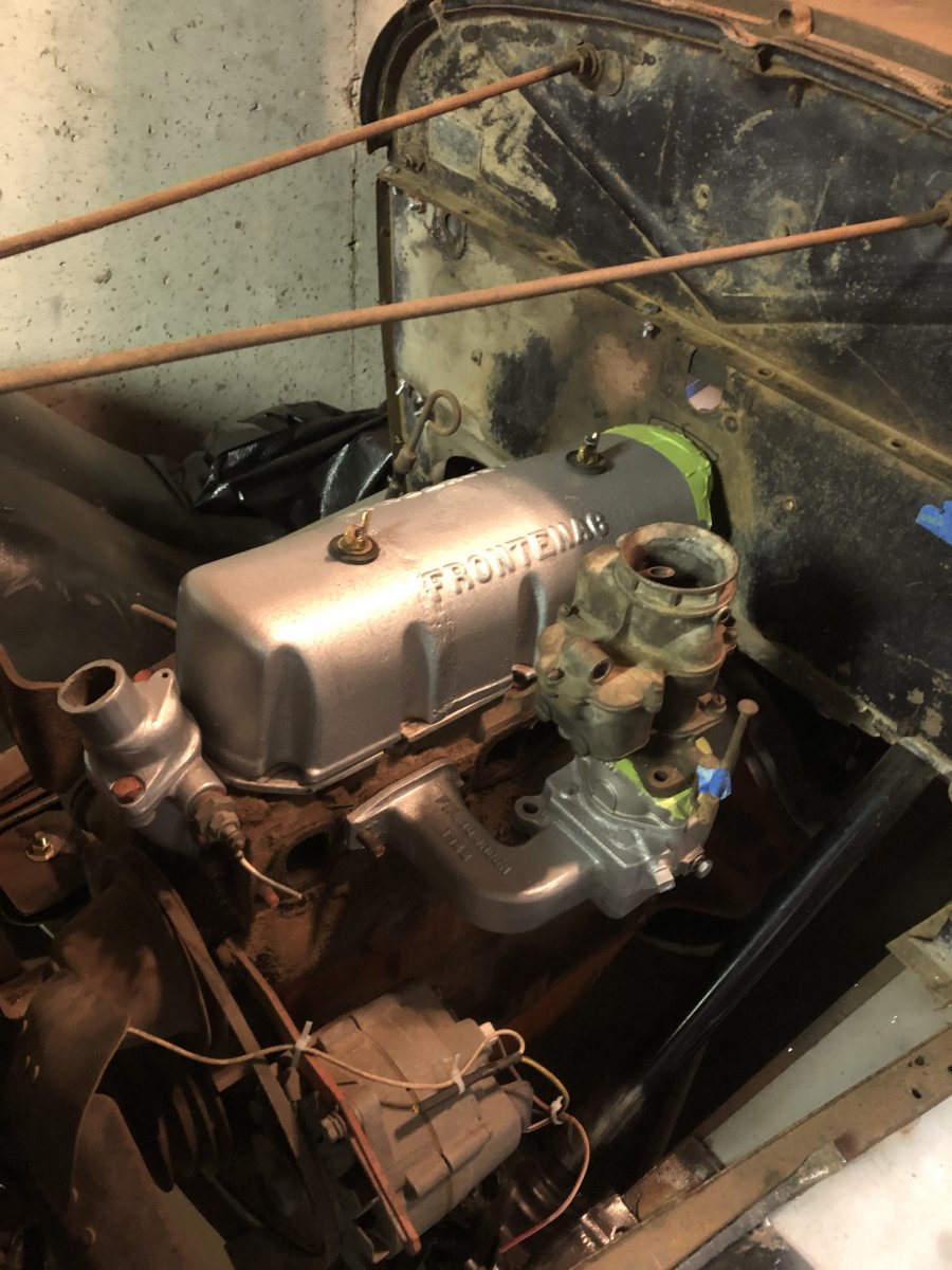

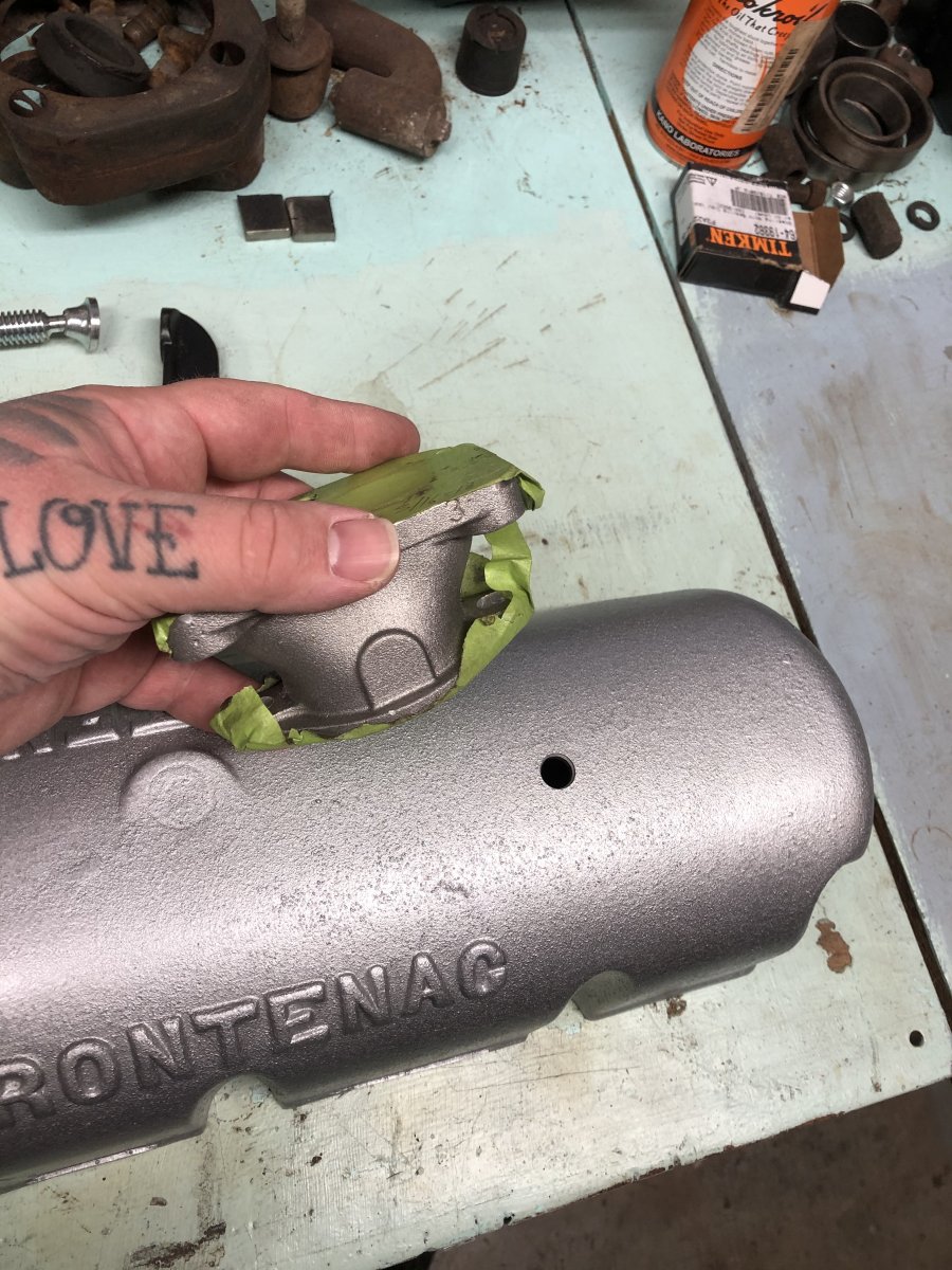

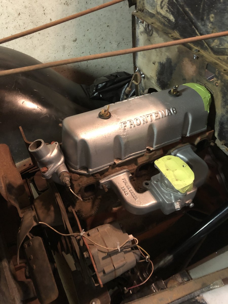

    Took a couple minutes and bolted everything together. Looks like the valve cover isn’t touching the fire wall it’s just close and it had shifted back a little when I was messing around with it when the bolts where out.
    still needs a little room but with the water neck off it went right on fine. I marked the firewall to make note of where I need to clearance it a little and I’ll do it when it’s easier to get to. Also need to take some more off the back side of the water neck/ thermostat. Maybe a 1/16 or 1/8 th

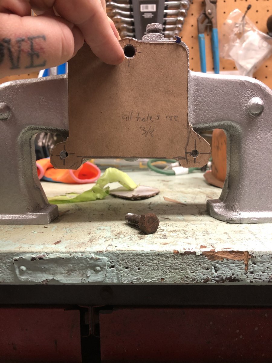

    anyhow I also got my template done for the block off plate. Cereal box, razor blade, hole punch and some transfer punches :) 68DA6F88-C06F-4D6E-A27E-DF6071E90DA7.jpeg 4575446F-D0AD-4CE4-A108-8E3F4D77AD49.jpeg A5CD46CC-3E05-4D8C-8BF6-B417A10AE524.jpeg 83CC5E83-B831-4CBA-9235-F1BCF5AF8BA7.jpeg looks pretty good all together :) though my crusty carb looks extra crusty now lol.
    thinking I’ll do the block red, the header matte black, the fan and pulleys black as well

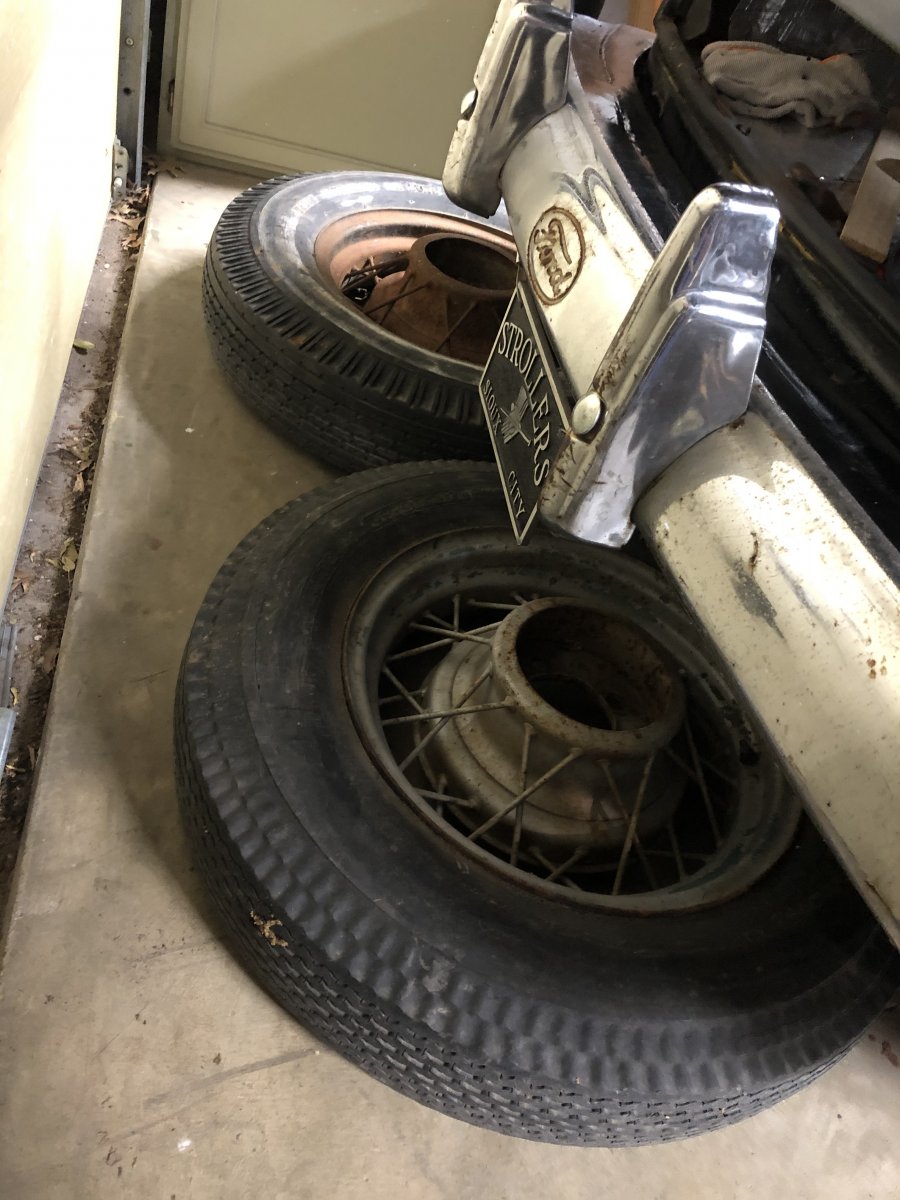

    Felt weird to do it but arranged a contactless pickup and got some more parts to move forward a little more on the A. I miss ********ting in driveways.
    anyhow scored this fantastic stromberg 48.seems to be NOS. If not I don’t know if it was ever run it’s very clean and dry. The ****erfly’s are dirty but it looks closer to shelf wear somewhere humid more than anything. 506611D9-382A-4F39-90F5-8AD2BBA7A753.jpeg i don’t really know anything about them outside of them looking like a 97 but flowing more with the larger venturis.
    Maybe @carbking can fill me in on these? From what I gather it takes the same kit/ parts as a 97. I’m also curious about the throttle arm on the choke linkage side on these. I see it labeled a hand throttle in places, the only thing I can thing of is maybe it doesn’t have a fast idle tied to the choke and so you do it manually? Either way I’m a throttle arm away from being g able to connect the pedal to the carb :)
    DBAA28BC-7D5A-4CCA-99D2-801CCD3FE262.jpeg also got another pair of 36 wires. I want to have the same wheels for the spares and figure if I have 6 I’ve got better odds of finding 4 good ones to run on the car full time. DB1E3871-8C3B-4C41-9138-28AAA14A2658.jpeg also got some reading material! Very excited after thumbing threw them quickly.
    I also got the parking brake lever ***embly but forgot to take a photo of it.
    havnt messed with the car much the last couple days but progress is creeping along

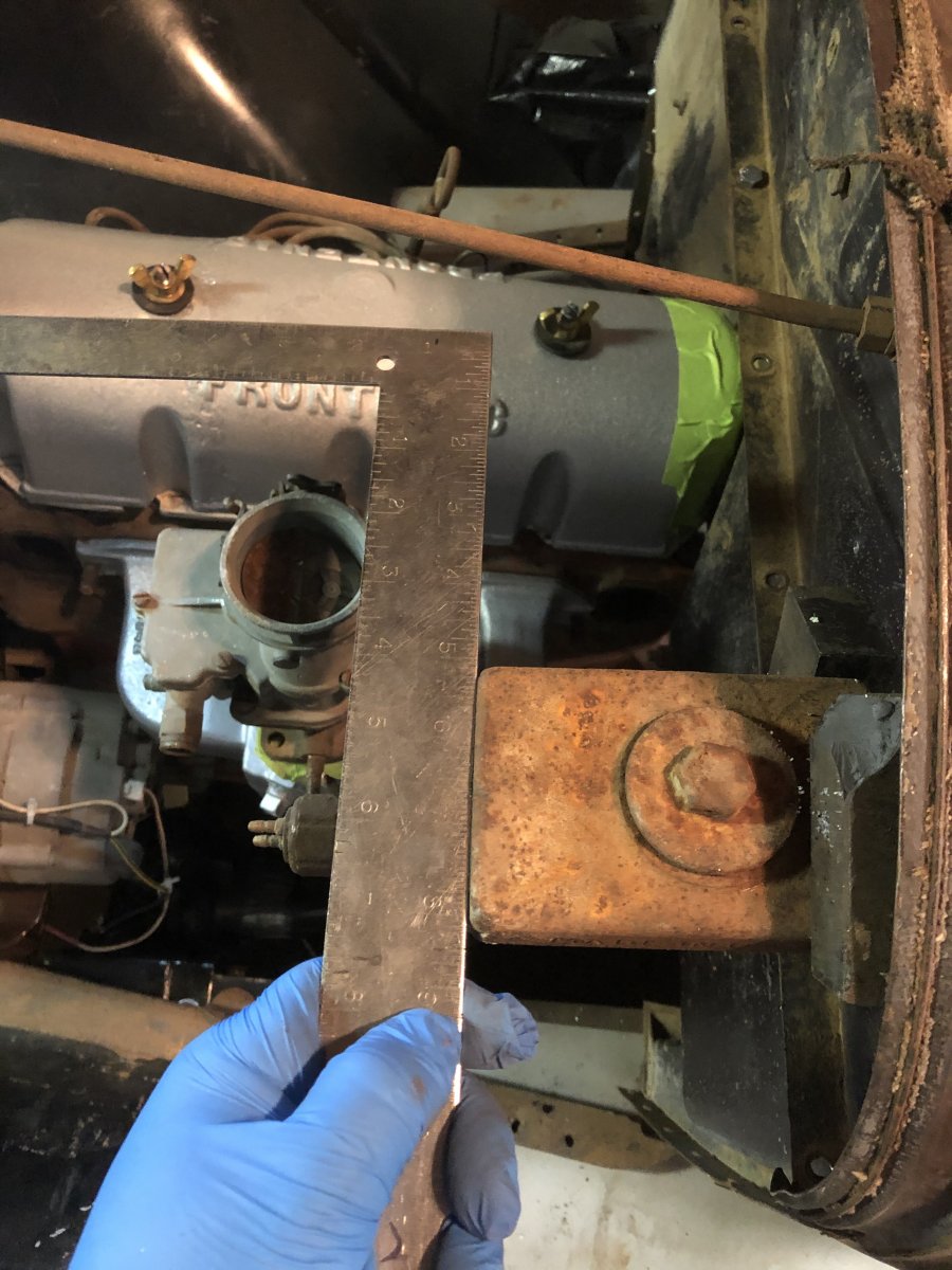

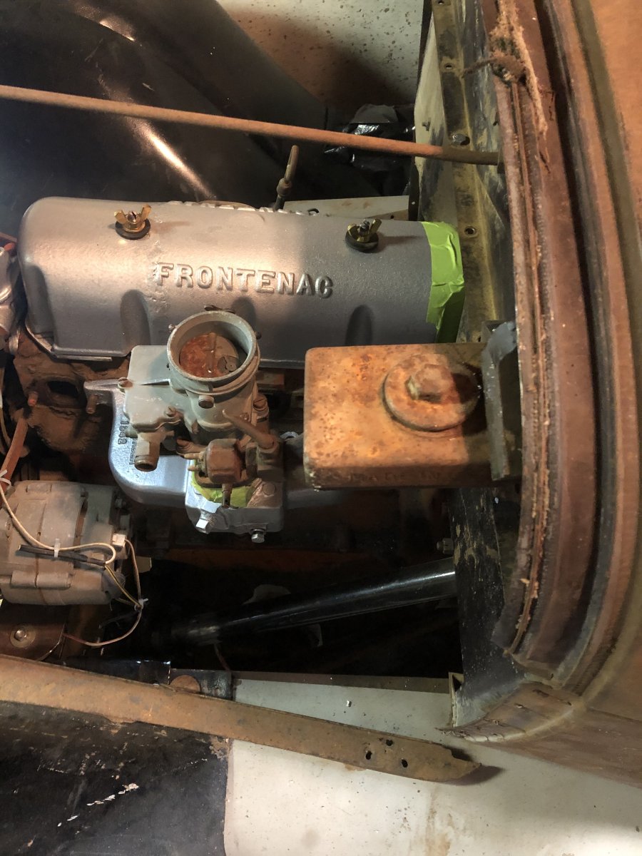

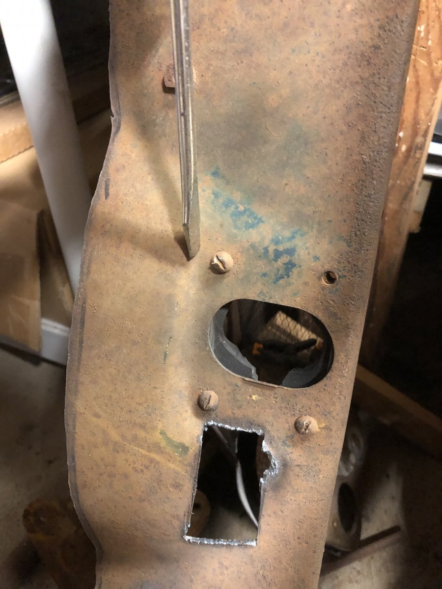

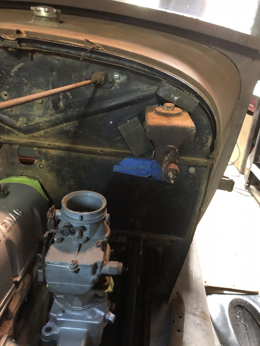

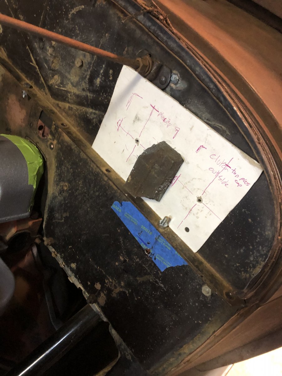

    Spent far to much time trying to make a jig to center mark the master cylinder holes only to find everything is so tight that I couldnt get a hammer in there anyways. Go figure.
    anyhow I stuck an old tracing on the firewall and measured a couple times and popped some holes in the firewall.
    They are a little off from dead center but I think they are close enough for a start. Not sure if I’ll try hole sawing it or using a jig saw to cut them
    Good enough for a quick mock up anyways you slice it.
    took a bunch of photos to kinda show how close everything is to the carb. I mocked up a 40’s ford master even though I’ve been talking about the wilwood unit because, well I have it. That and with their placement I might use them because they are shorter by almost two inches and will clear the hood easier.
    these photos have the master further forward than they would be because a 1/4 inch or more goes into the firewall and this one also has a couple fittings and a brake light switch attached to it where I would be more likely to run a quick 90 deg down or maybe a banjo bolt straight down. That shaves off at least an inch.
    still very tight when it comes to an air cleaner but there’s room 78E3A7DF-54A0-4048-A0C7-20698CD633FC.jpeg C93F7F2B-2A51-4E0D-B42A-5F9AC7918C31.jpeg 5DABAEB3-6013-42D6-AD84-F3AB55D0209D.jpeg 6D00FB1C-9C38-497F-9460-477EAAF39FAF.jpeg 35E5855A-7AEA-4EBD-8DB6-FE2F5BD1F85F.jpeg C502EAF2-E859-4154-9B61-B5D98D2BA924.jpeg

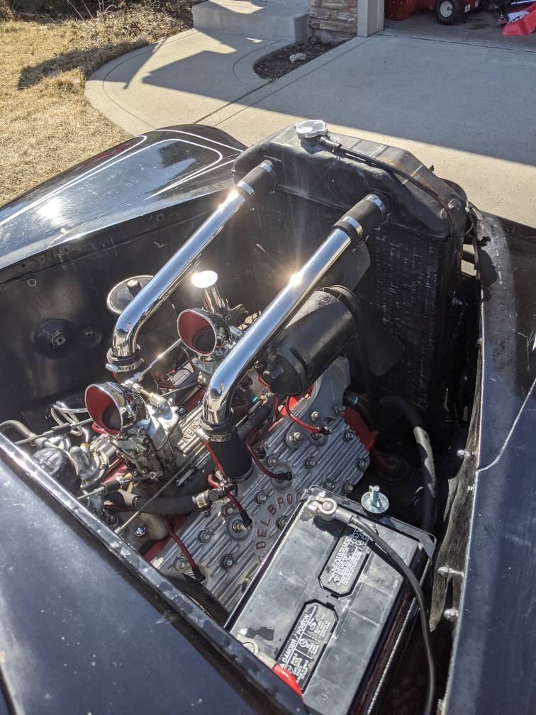

    Hey I might want in on this.. 3 flatheads there man he’d be up against almost 300 hp [emoji23]
